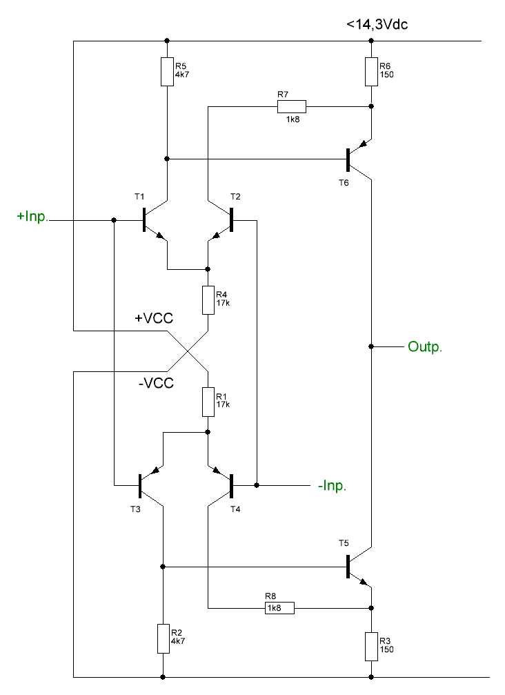

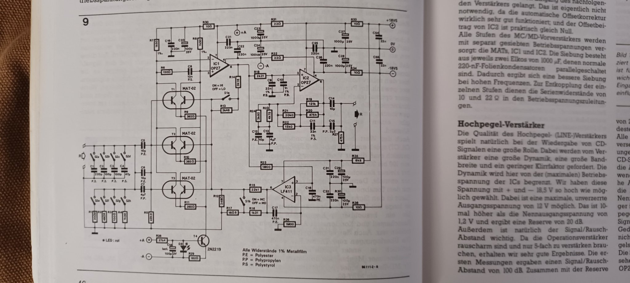

The discrete OP of the SUPRA-EQ looks slightly different from the previous working proposal of the OREAD-EQ. The original SUPRA had a kind of sweet spot at +/-17.3V to +/-18.8V rails.
Elektor gave the following specifications:
SNR > 86dB
THD < 0.001%
The noise is to be reduced by a factor of 2.82 by connecting 8 transistors in parallel in ac-mode.
SNR > 86dB
THD < 0.001%

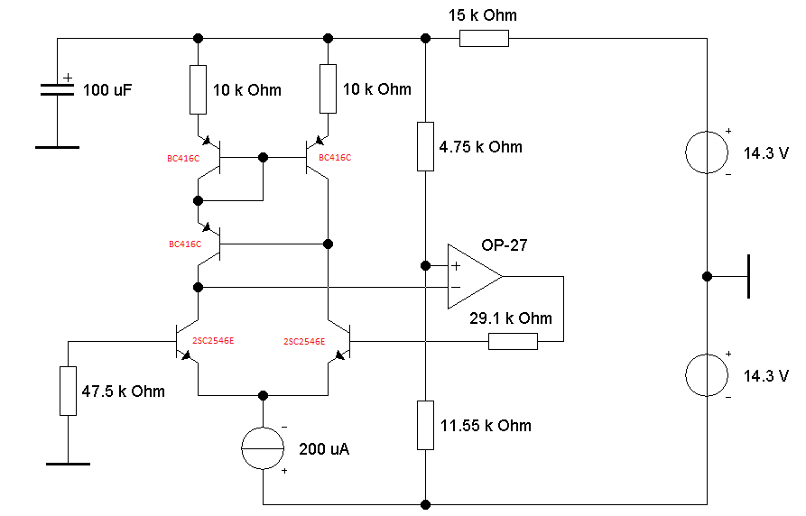

They probably measured with an unrealistic source impedance, for example 600 ohm instead of 600 ohm plus 500 mH.
Unfortunately, Elektor (1982) did not provide any further details on their measurement method and conditions.

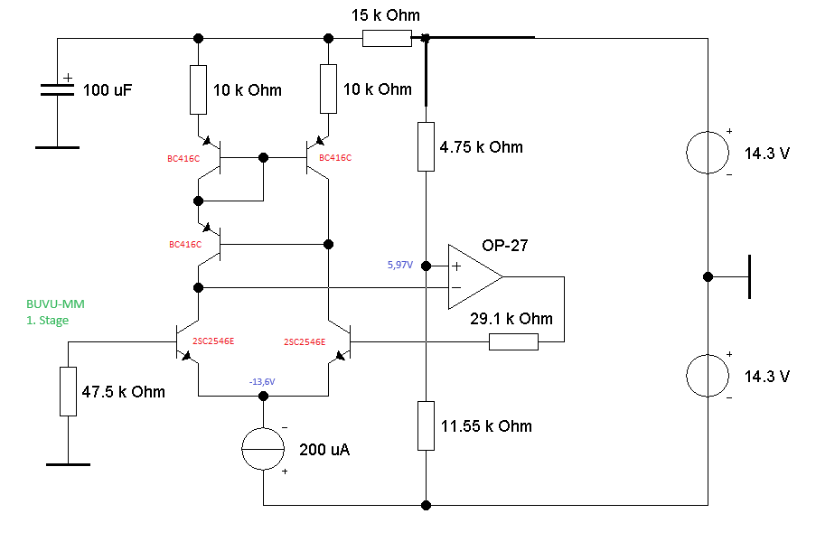

Burkhard Vogel's book "the sound of silence"
is another treasure trove, I am attaching a picture of his BUVU-MM input stage (page 191) - for further confusion or information.
Roughly estimated: apparently the (total) base current of the NPN input transistor(s) is just a bit more than 1.075 μA, the same holds for the base current of the PNP side and the resistor is a bit more than 47 kΩ. The total noise current will be about √3 times the noise current of 47 kΩ, so about 1 pA/√Hz.

R=47kOhm
b=20kHz
T=20°C
uR=3.899µV
"The 1*10^-12 A/sqrt(Hz)" additionally lead to non-correlated 6.647µV - are we actually allowed to say RMS when it comes to statistical normal distributions?
Two noise sources, and we are not allowed to subtract or add arithmetically. The magnitude ratio 6.647/3.899 = 1.7048 -> approx. sqrt(3) or 4.6dB - exactly as you estimated it' Marcel.
But an original SUPRA is not noisy, at least I don't remember that - but I could do a measurement at home at the weekend and terminate the input with an ancient MM. However, I fear trouble with my wife for turning our home into a laboratory so close to Christmas.

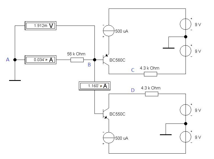

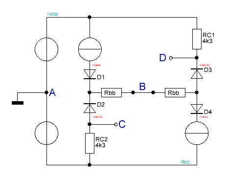

My point of view:
The thing is a bridge, ideal and static - considered point B is zero. The defect current of the PNP controls both transistors (Douglas Self will give a different model view) ... But what happens here dynamically, we cannot look into the line or the path resistance.
The random shot noise must be processed and considered statistically. Well, point B is flowing and we lash it with R=56kOhm to GND.
What happens now if we add the two new sources C and D, their noise does not correlate.
This question's concerns me with regard to the propagated SNR > 86dB and the fact that the circuit works fine - no disturbing noise, only split the tailcurrent ...

Addendum:
Of course we can now determine the optimal collector current - but for the case at hand?

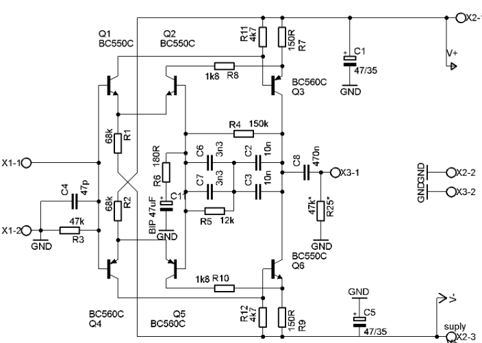

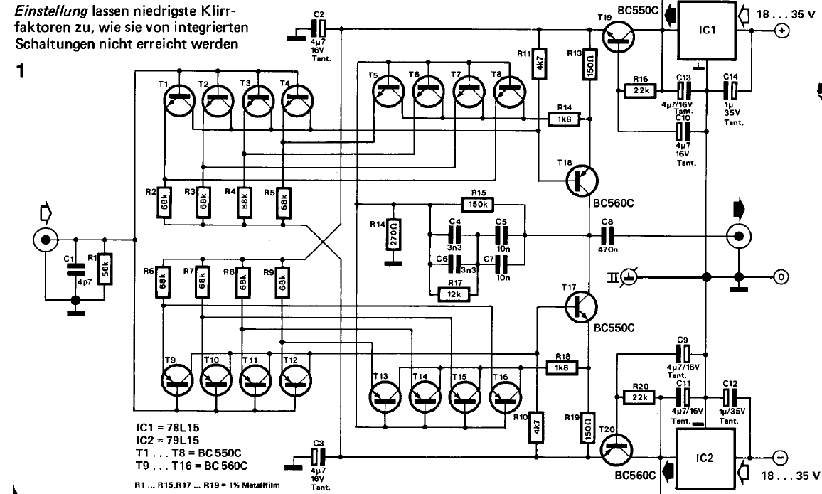

The PreAmp-1987 from Elektor operates with a total current of 5mA. 824µA dc per NPN. The technical data are excellent and there have never been any complaints or objections. Elektor even states a fabulous SNR of >92dB for the high level MM. The normal type is >86dB.
What have the technicians and engineers
did wrong or did not understand correctly (date 1987) - I ask myself?!
Is it due to the MAT-02 miracle or the low output impedance of the differential amplifier?

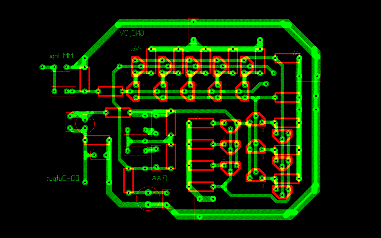

We could copy the legendary EQ of the AR A03. It works with five transistors and three diodes and operating voltages of +/-25Vdc. It has no temporary clipping problems and sounds like a dream, completely light, as if it didn't even exist. Its input pair shares just under 1mAdc tailcurrent, i.e. 500µA per 2SC2602G ... quiescent current of the output stage at least 8mAdc.
And the crazy thing is, I didn't hear it crackle or fire. However, I did not measure anything. Why should I, it obviously works perfectly. The pseudo current mirror is formed by a 2SA608k ... that could be OREAD, but unfortunately that would be a write-off.

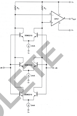

Hi, the input stage of this amp is more or less direct from the "SSM2210 datasheet for the "500pV/rtHz" amplifier. The input stage is probably best suited for HOMC pickups since their induction is much lower compared to regular MM pickups. The Ortofon red/blue/black series pickups are on other end of the scale...... The PreAmp-1987 from Elektor operates with a total current of 5mA. 824µA dc per NPN.....
..... did wrong or did not understand correctly (date 1987) - I ask myself?....
As for doing wrong, the current noise mechanism were well known, and if I remember correctly was more a focus for tape-head amplifiers in cassette decks.
Focus for voltage noise is more appropriate for MC and HOMC pickups, and voltage noise is easier to measure and understand for most. We did'nt have the internet to educate us the same way DIY-audio do today.
The PreAmp from 1987 you refer to had about 5mA total current in input stage, The supra with its16 transistor input had about 1,4 mA and the Tubeland DIY kit has 0,7mA (basically a 24 volt ersion of Supra with single input stage) https://www.tubeland.de/product_info.php?products_id=35
Attached also all 3 schematics for easy comparison. It seams to me that "tubeland" forgotten to scale resistors R7,R8, R11/R9,R10,R12 and hence Q3/Q6 is running current starved.
Regarding the original Supra. I'm curios if someone has an opinion using a diode instead of 1K8 resistor to achieve 0,6 volt drop instead of R12/R14
The ensemble in the SUPRA is not a classic current mirror!

You're absolutely right about the 1k8 resistor. In my eyes and measurements plus simulations, it is unfavorably dimensioned.
