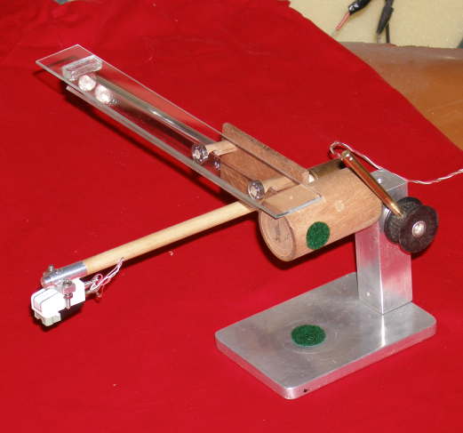

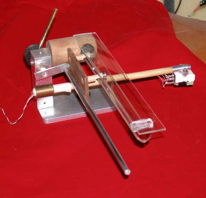

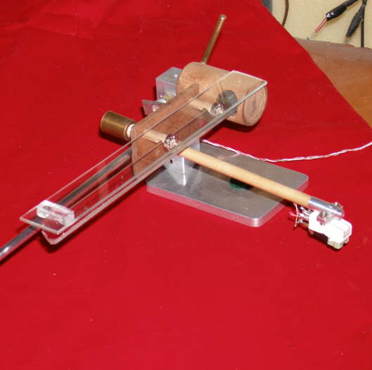

Hi JRKO,
Welcome and fun and good luck etc, etc. You can get a rough set of dimensions from almost any of the arm photos published in this thread by making some assumptions about known parts shown. For example call the distance between center lines of the cartridge mounting screws is 1/2". The distance from the outer groove to the inner grove on the disk will be something a bit more than 3". From the edge of the record to the label, about 4". The actual length of the tone arm wand can be anything, determined on where you want the glass track to sit relative to the edge of the record. The closer to the edge of the record, the easier it will be to change the record without crashing into the arm. So draw a full size plinth and platter sketch and layout something that suite your fancy. Then make some paper dolls of the parts and move them around as though they were actually playing a record. It is almost impossible to get a non functioning arm if you think it through and visualize how the parts work together.
I have found virtually nothing to be critical except for VTA, cartridge alignment, 90 deg from record surface (azimuth) and stylus tangent to the groove.
The following are the actual measurements of the arm in my photos:
Distance between bearing center lines 2"
Stylus tip to carriage 5"
Carriage to back extension of arm wand 2" (to hold counterweight)
Length of glass track 7"min Mine was about 9" but I dropped it, CRASH.
For bearings, mine are about the same as yours but I have OD=10mm, same ID and thickness.
For height of glass track I measure .300"
I think that a critical thing to watch for is the smoothness of the bearing outer race on the actual corner that rides on the glass track surface. A finger nail test should do. Reject any that exhibit scratchiness or nicks.
I have kept the weight of the carriage very light, Photos of the real Cantus show a heavier one.
For the arm wand length, I don't know what the trade-offs are. Maybe DTUT can comment on this, but I'm sure 5" is not too long. Cantus will scale a bit shorter (I think).
So there you have it. My arm is performing beautifully, I am amazed by how well it works and sounds. Let us know how you are doing.
BillG

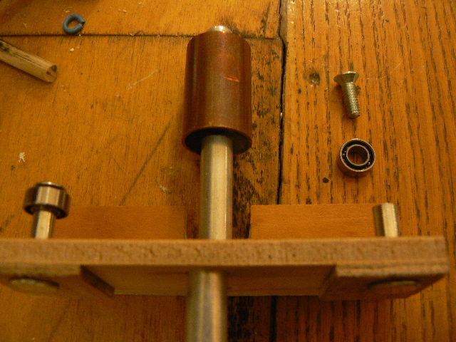

Thanks for your help and inspiration guys.
I've got pretty much all my materials now.
I really liked the flat'n'fat look of the arm nbocca made. And so I'll be using a home made laminate of 2mmx12mm carbon fibre batten sandwiched between 2 layers of 0.8x25mm carbon fibre batten. Its almost perfectly stiff apart from some slight bend under high pressure which it will never experience in use. Counterweights will be bolts dropped into a slot in the opposite end of the arm.
threaded posts like dtut uses for the simple reason that I can get an easily duplicated exact length.
Last thing to decide on is material & method to join bearings to arm - ply seems the simple and cheap route....
Copper tubing for the tube - options are 22mm or 28mm. The only downside to the larger diameter that I can see, is that the softer interior diameter slope would allow 'slop' in the arm so I'll go with 22mm unless someone says otherwise.
One last question if I may: is there a reason no one has extended the rods connecting the carriage to the bearings and placed counter weights there?

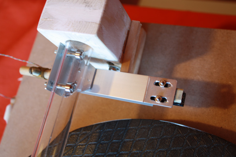

Sorry I meant this image of nbocca arm - I like the continuous width arm/headshell for its form, function & simplicity.
I was going to have my tube running low as possible, maybe even behind the platter and just take the arm out of the tube when a record has finished. A simple arm rest on top of the tube support structure to hold the arm when not in use.
How do you feel about cutting the tube down to a 'gutter', like a curved version of the '90deg- angle- glass' solution?

JRKO,
Thanks for posting that picture. That's a very attractive arm. That idea is worth stealing, the highest possible praise.
I'm curious about your arm-removal scheme and what it will look like when you're done.
I've considered a "gutter," especially one with a small diameter and steep sides. I never figured out a satisfactory way to split a tube and I think it will need external support. Again, I'm curious about what you might come up with. No one idea has to be perfect - or even much good at all - but they all deserve at least a bit of experimenting. Which brings me back to an earlier question of yours. Go ahead and try extending the bearing posts to make the CW stub and see how it works. It could have advantages that aren't immediately apparent.
