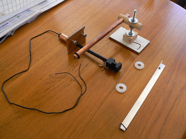

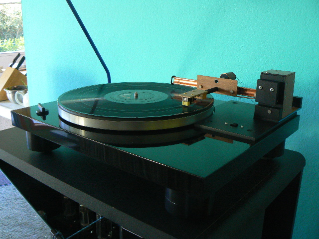

I built the rail with acrylic tube simply because... it is very easy to drill. With my poor toolbox I can't work with hard metals. I looked alluminium tubes in my DIY store but the inner wall does not look so smooth.
At this moment I want try to understand strengths and weaknesses of this first prototype.
I won't use grease or oil; but I can easily build others rails.. so I would try something like this one Dry PTFE | ROCOL - Industrial Lubricants, Metalworking Fluids & Traffic Management.

If you want to..
You can try any lubricant you want to try and let us know what you think. As far as the guy* who designed this arm and who has been building them for about 25 years now, zero lubricant is the recommendation.
You could check around to see if you can find someone to hone the id of an aluminum tube for you or just buy one and do it yourself. Glass tube is available uses a standard glass cutter to make the slot. Or you could take a length of aluminum angle (or cut a wooden piece) and line it with window glass for the same difference. Best regards Moray James.

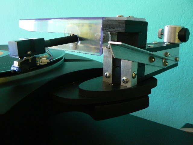

I've been working on a couple of inter-related challenges that LTs present. One is to get the vertical pivot point low and the second is that a low beam makes record changing difficult so I thought maybe a lift mechanism of some sort might be the answer. The LT with a hinged tower I posted back a couple of pages dealt with both considerations pretty well, but I thought it could be improved.
The articulated tower is my second attempt. It works pretty well, but it's complicated and the lift motion, especially with the arm at the end of the beam, is clumsy and unsatisfactory. The counter weight helped smooth the lift motion, but not enough. So on to another design which I'll post in a follow up to this one.

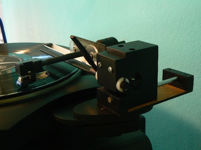

The third photo is of a kit I built for three friends of mine. I made the kits so they can be either bearings in a tube or wheels on a V beam. One of the friends has become LT obsessed and I haven't heard much from him since. I have a lot more respect for kit manufacturers, now. I figured out roughly how much I'd have to charge for these kits and was startled by the amount.

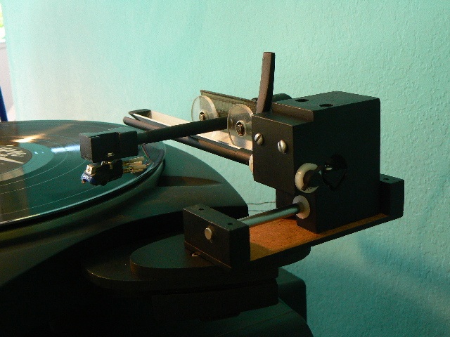

OK, second adventure. After my experience with the articulated lift, I decided simple was the way to go. Instead of lifting the entire tower, the cam lifts the arm and the tower slides back so the beam winds up at the rear edge of the record. This arrangement is very stable - no wild, scary motions - and the beam remains level at all times. The beam and lift cam are adjustable for level and parallel.
The tolerances had to be fairly tight so I built jigs and worked as precisely as I could. The extra steps paid off.
