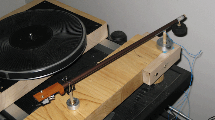

Judging from your pictures, it appears to me the platter and Technics tonearm came from the Technics SL-Q2.
It is SL-Q3 but it is almost identical to the SL-Q2. In fact is uses the same motor and servo electronics used in many Technics tables, including the 1200/1210. If you study the service manuals for all these Technics machines, you will discover that most ones using the AN6675 AN6680 chips have the same drive circuit with small differences.
I don't have pics of the electronics, and don't remember exact part numbers I modified but I can share some ideas of what I did:
1- I changed all electrolytic caps to Panasonic FC.
2- I discovered that the circuit is sensitive to the quality of power it receives (probably mostly RFI problems) so decided to isolate it and power it from a pair of Yuasa lead batteries (12V 7Ah). It can run 70 hours before recharge.
3- I connected close to the PCB a 22000 microfarad Panasonic FC capacitor pack (10X2200microfarad) to reduce impedance and provide instant current if needed.
4- modified the negative feedback loop network to make the whole thing underdamped. As it is from the factory, it is overdamped and after doing some A/B test by switching instantly between the factory network and the new one, it is obvious the change in sound. The moded version is much more relaxed and clear and all the distortion (similar to jitter in digital) in mids and highs is gone.
My benchmark for comparisons was a Clearaudio motor and servo electronics used to drive the acrylic platter rim with a belt. The big advantage was that I could almost instantly compare the sound of the Clearaudio belt drive and various stages of my direct drive mods just by removing the belt.
I like my moded direct drive version more than the Clearaudio belt drive. For me the direct drive versus belt drive subject is closed. It can be done to sound good, even with a "not top of the line" motor.
By the way, I used a stethoscope at every stage and listened to the noises in the plinth and arm mounts.

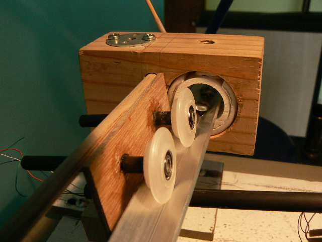

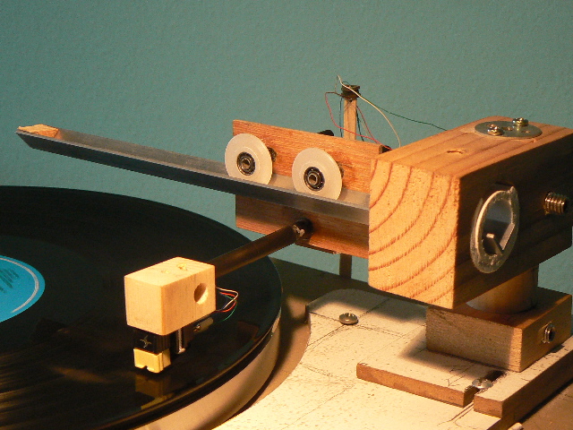

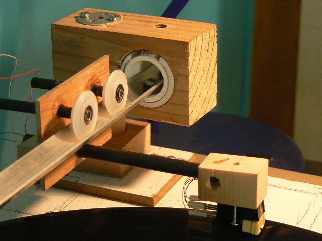

More fun pictures!
www2.hemsida.net/martinberg/Vinylsvarv.htm
___________________________________________
Thanks DD,
I really like this one. Simple, elegant solutions, attractive design. Rolling blades - what a great idea. In my experiments, I found that increasing the radius of the wheel magnified the problems with dirt or uneven surfaces. It may be that the sharp contact point helps with that, but I'd guess the V channel still has to be kept very clean.

Ever since I saw DD's most recent pictures posted above, I've been fantasizing about building one. Finally got a (ripped, stolen, cloned, homage) built. Sometimes I feel like a cover band. After building several versions of Cantus clones, I thought the rolling knife edge offered an elegant solution for vertical arm movement while keeping the passive rolling for the horizontal.
The wheels are reshaped nylon sliding door rollers. The bearings are from remote control cars, the tubes are broken carbon fiber arrow shafts, and the carrier is 3mm mahogany marine ply. The tower is adapted from earlier iterations of the Cantus and has adjustable VTA built in, which makes life far easier at tweaking time. The cartridge is a Shure 97ED.
The nylon wheels were shaped in a drill press used as a mock lathe. They're soft enough to be worked easily and fairly accurately with files and sandpaper. The combination of nylon and aluminum is quieter than bearings in a PVC tube like my Cantus clones. I use a mechanics' stethoscope for noise checks and the whole arm is very quiet. Following Moray James' advice, I put shrink wrap on the aluminum arm of the Cantus, which reduced noise in it to just about zero. I'll probably do that on this arm, too, although carbon fiber has very different vibration transmission characteristics.
The three-axis adjustment is a bit tricky and I still don't know of any way to accurately or usefully measure VTF. I have to do it visually by watching cantilever displacement as the arm is lowered.
The arm tracks very well in both axes. It follows warped records with no problem and no audible distortion and is OK with slightly off center holes. It doesn't like dirt in the track or on the wheels, which, considering how exposed it is, may be a problem.
OK, so how does it sound. Bluntly, damn good. Tonal balance is slightly bright, but overall very good. The major strength of this arm is detail. Music is reproduced as humans singing or playing instruments meaning very much like live performance. You've all experienced/heard/read all this before and I don't want to go on about it, but, man, I think this design has real promise.

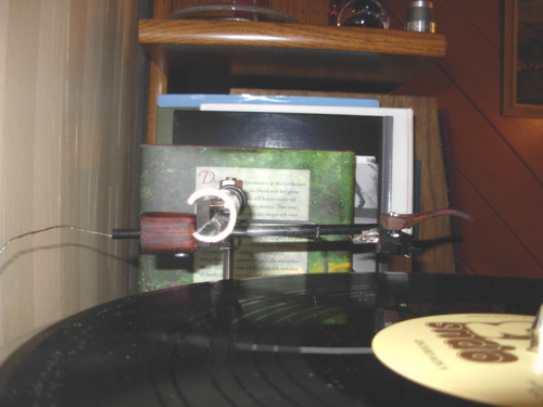

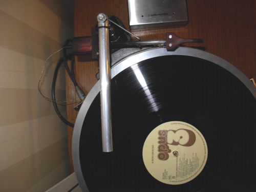

Well, I did it.
The present state of things is that I am using an aluminum tube because it was cheap and easy to maschine with a Dremel and carborundum cutting wheel.
I bought a 6mm outside diameter carbon fiber tube for the tone arm and had some rosewood kicking around in the cellar for the headshell, bearing support and counterweight. The 10mm o.d. ball bearings have ceramic balls and I cut some distance bolts from an old computer that I had. I flushed the greased bearings out with lighter fluid.
The wiring is also self made from OFC silver plated speaker wire. I used 4 strands per lead (twisted in my hand drill) and painted them with polyurethane paint (2 coats). I then colored them red, green and blue with a magic marker and twisted the left and right pairs together, then both of them. Very low capacitance and impedance. The heat from a soldering pen melts the polyurethane away, so there is no need to strip the very fine wires.
The tube assembly (15mm o.d./13mm i.d.) is held up with a stainless steel 8mm bolt 120mm long. All you have to do is make sure that the tube is absolutely parallel to the platter and that the turntable is level. This was MUCH easier to set up than the Keith Monks arm that my wifes plant trashed.
So, how does it sound? Incredible. Transparent, believable stage, wide bandwidth, good imaging. I play trumpet professionally and have a lot of exposure to orchestra instruments, this arm does a wonderful job with voices and strings as well as slam and pace with jazz band recordings. I am a happy camper. It is almost impossible to get this thing to skip. I have tried records with offset holes, warps and direct disc recordings with heavy dynamics. Pitch remains stable even with recorders, pianos and violins.
Next steps:
I will order the glass tube from Rauna as the next step. When it gets here I will also install a lift and probably an end of record auto lift. I am not 100% with one of the bearings (too much play and will order a couple of different models to try.
This project was so easy and sounds so good. I got everything done in one weekend including going to a hardware store to buy the parts. I give it a big thumbs up for DIYability.
Robin
