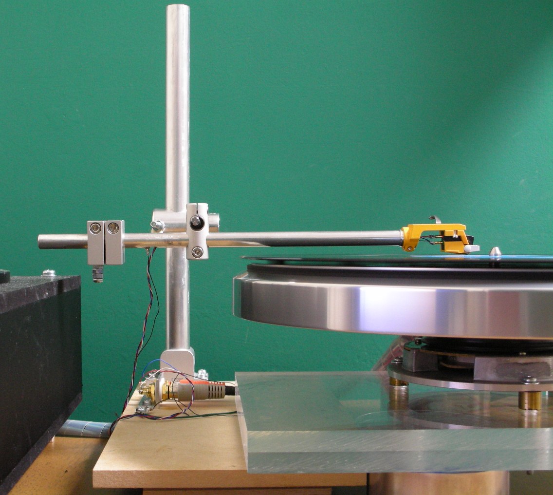

Hi all
Just noticed this thread and thought to show some pics with one of my own DIY tangent arms. This one was inspired by Souther/Clearaudio/Opus3 passive tangent arms.
I managed to make the arm to weight only 22 grams without cartridge and weight/counterweight. One of the problems was to make the arm very light but to have high dynamic mass to complement the very low compliance of the Denon DL103.
The arm itself (the wood part and wiring) is still not the final version but as it is, it successfully passes the tracking ability tests, tracks 6,7,8 side 1 HI-FI NEWS Analogue test LP and the Analogue Productions test LP track 1 side 2.
Also it does very well at the low frequency resonance tests. Lateral low freq resonance is 11Hz and vertical resonance is 9Hz.
Before this I built some other variations including one based on linear bearings. Later discovered that a guy from Japan did the same thing and posted some videos on youtube.
In my opinion this new version (the Opus3 inspired) is a better one, it tracks impeccable and do not skip at all if the turntable is properly adjusted (level)

Thanks for the great pictures. Beautiful work. I am sure that others will want to know how you fared cutting the slot in the glass tube. Did you use a standard carbide glass cutter? Did yo experiment much with bearings and what did you end up using? Your deck looks nice is there a story to tell there as well?
very nice arm...
chrissugar: very nice arm!
As Moray has asked, how did you cut the slot. Technically, this seems to be the crux of building one of these arms. And in this incarnation it could be built to pivot out of the way for inserting a record.
Yes please!!

Thank you all for the kind words
believe it or not it was the first time in my life I did something like this (I mean cutting glass) but I used my intuition and it worked from the first try.
I bought the glass tube from a medical accessories shop (have no idea what is the correct name in english for this kind of shop). External diameter 14mm, internal 11mm.
All I used to cut the tube was:
1-MICRO compound table KT 70 to mount the tube and advance it by rotating the handwheel.
PROXXON - KT 70
2-Mill/drill unit MICROMOT 50/E
PROXXON - MICROMOT 50 and 50/E
3-Universal holder UHZ for mounting the mill/drill unit
PROXXON - UHZ
4-Diamond cutting disc NO 28 840
PROXXON - Cutting discs
You need alot of patience to cut the glass. I advanced the tube 1milimeter per 15 seconds (very slow). If you make the calculus you need an hour to cut one row, two hours for two rows (the complete slot). Diamon disc should be almost tangent to tube to avoid breaking it.

Here are some pics with my DIY turntable (a 45 kilogram monster). Unfortunately I do not have pics of the complete table with this new tangent arm.
In these older pics you will see the old linear bearing arm mount (without the arm) and a Technics arm.
The latest version has this new tangent arm and a Rega RB250 Origin Live arm.
I hope soon to make some photos with the new complete machine and will post them here.
http://img.photobucket.com/albums/v292/chrissugar/TURNTABLE/08.jpg
http://img.photobucket.com/albums/v292/chrissugar/TURNTABLE/09.jpg
http://img.photobucket.com/albums/v292/chrissugar/TURNTABLE/10.jpg
http://img.photobucket.com/albums/v292/chrissugar/TURNTABLE/04.jpg
PROXXON - KT 70
PROXXON - UHZ

I used different bearing before but this one suited best my specific project. It is a 10mm diameter Japanese SKF bearing.
I bought them from RS-COMPONENTS Welcome to rswww.com
part number 285-0790
The only treatment I apply is after I mount the bearings I use high presure air spray to make them spin fast and blow out any dust particle.

chrissugar: "Here are some pics with my DIY turntable (a 45 kilogram monster). In these older pics you will see the old linear bearing arm mount (without the arm) and a Technics arm."
Great tonearm project! I really admire your craftsmanship.
Judging from your pictures, it appears to me the platter and Technics tonearm came from the Technics SL-Q2. Am I correct? I used to have that and butchered it and retained the platter for future belt-drive experiment but I abandoned it because I later found the SL-M3 and SL-M2 to be better and I also use them as motor to tape-drive a platter.
Do you have pictures of the motor and electronics and can you tell us how you modified the table? Sorry to be off topic as this thread is about tonearms.
