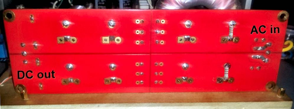

Before I build a bomb, where to connect the drain resistors at C1 & C2?
You can drain a capacitor by putting a resistor in parallel with the capacitor. See attached photo.

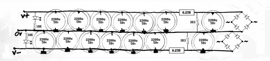

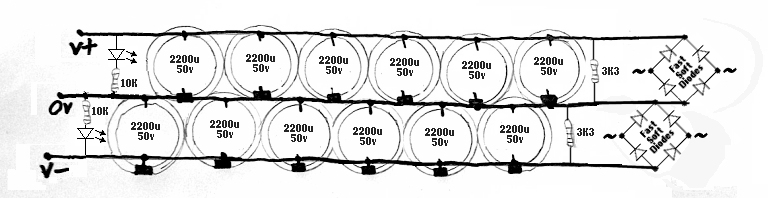

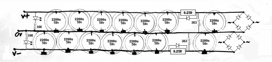

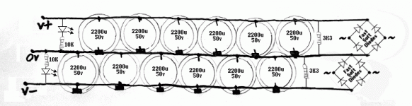

For the power supply building, here's a few examples made for dual secondaries transformer.
Basic power supply
First example is the basic power supply with good performance.
Ordinary CRC power supply
Second example is the CRC power supply with noise filtering added at the cost of increased rail sag. This ordinary CRC power supply works for monobloc chip amplifier.
High Power CRC power supply
Third example is a CRC power supply with added diode that limit the filter sag. The diodes turn on and "brace up" the rails when the total amplifier power passes 50w. This high power CRC power supply is nice for Stereo chip amplifier.
