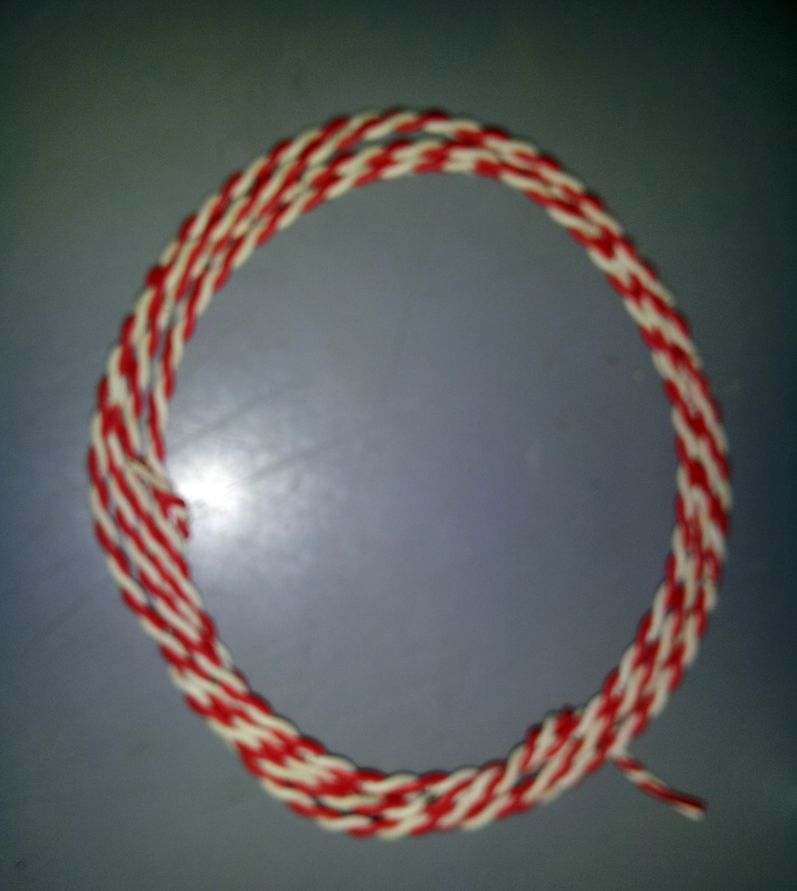

I can buy some "thermostat wire" for the umbilical Daniel describes, but I see some vendors list doorbell wire as the same. I have the solid bell wire - useable?

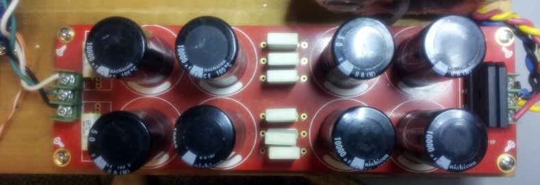

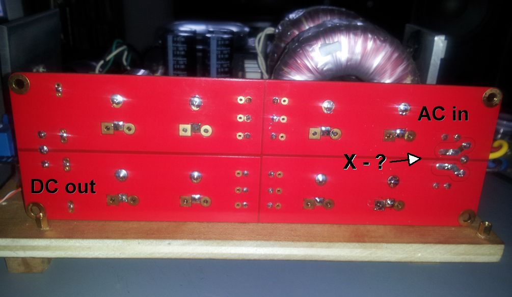

Sorry to be lagging so far behind but I am reading, enjoying and learning from the advanced discussions. For my part, this may be the time I venture into perf-board/P2P adventure to remove the size limitations of my current board - if a new PCB doesn't emerge.

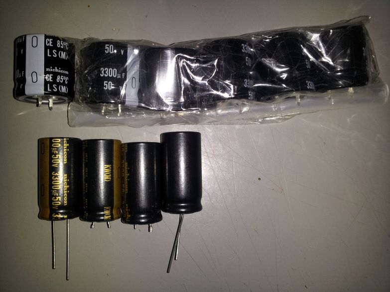

I did a quick check for 2200 and 3300 caps at RS and came up with $50 to $100 for the numbers needed. Even at Mouser they cost more that the full kit. I don't mind paying those amounts if the benefit warrants the cost, but I did find ten 3300 uF in the stash - but are different mfgs. Does mixing cause any problems (other than ugly) as long as the specs match?
At Mouser, 6 of 2200u per rail, there's two rails so 12 caps total, and at $1.50 each, 12*1.5= $18. 2200uF 50v Aluminum Electrolytic Capacitors - Mouser
I would suggest to buy 2 extra caps in case you want to adapt this to a CRC power supply.
Probably we don't want to mix different caps within a power supply reservoir.
Mouser also has the Fairchild Stealth diodes, which do cost a bit, but practically any soft/fast diode with at 16a or more and 200v or more will do. For center tap transformer hookup with one bridge rectifier, you might want four of the 16a diodes. Or, for dual secondaries transformer hookup with twin bridge rectifier you might want eight of the 8a diodes. There's not much difference either way, so whichever you like is fine.
Yes, probably, just check the gauge with your wire stripper tool and see.

Thanks Daniel. The bell wire is 1 mm on my calipers. I didn't see those Mouser caps this morning but that's not surprising 🙂 I'll place an order later today. Using your crystal ball, can you foresee anything, other than the diodes, I should add preemptively? I have the LEDs and resistors for the PS indicator/safety mod.

Possibly some favorable varieties (Panasonic FC, Nichicon FW, Nichicon KZ, etc. . .) that you can try for NFB caps and amplifier board power caps, especially since caps in that range are inexpensive and shipping is not.
And a pair of 0.22R 5w in case you want to adapt your power board to a CRC. Ordinary wirewound of 0.22R and less is not significantly inductive, so the inexpensive Xicon will do fine.
Also, a Nichicon ES 1u cap for a good "standard" hi-fi input cap performance, to have around for comparison purposes. If a fancy audiophile cap can't beat that Nichicon, well that's informative.

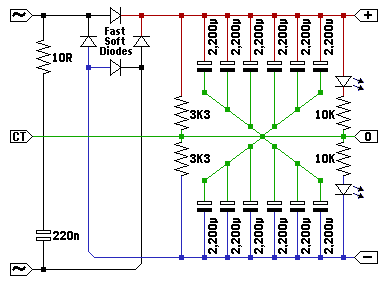

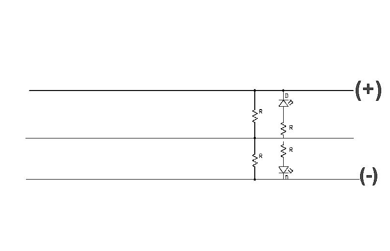

Daniel, Just a double check. Is this correct?
Well, that's really close to right, except that one of the LED's is reverse and won't light.
Remember 0v is 35v higher than negative rail.
That's a pretty good drawing except that some types of LED's are marked backwards, such as white high brightness is sometimes opposite of amber and red. They can break if installed backwards, and so, you might want to buy several LED's rather than just two.
see also
danielwritesbac said:
The spots for 3k3 are at least 1/2w resistors, the 10R is at least a 3w resistor, for longevity.
I do have a question: Do you have a center tap or a dual secondaries transformer?

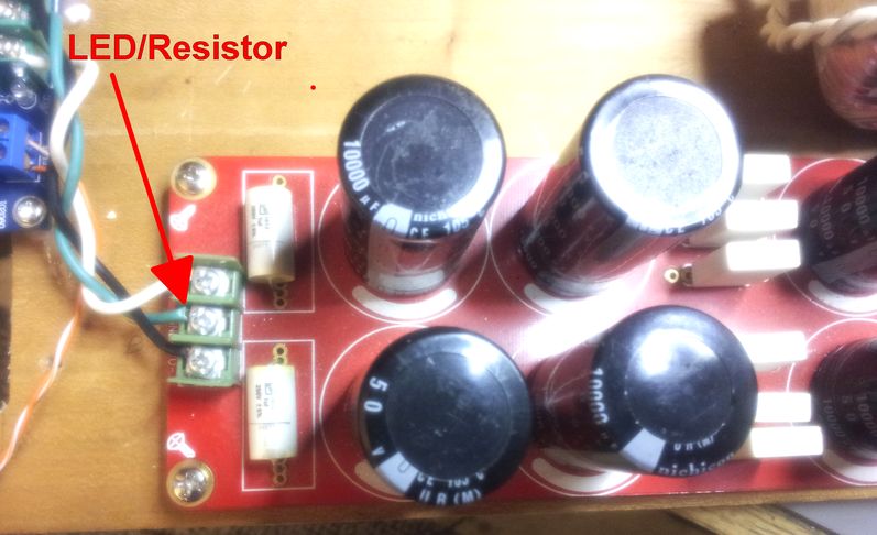

This is for the kit build PS I already have. The new P2P stuff is on order. From your post it looks like the drain resistors belong before the caps - correct?
I just flipped the icon in the drawing program but am aware of the LEDs polarity thing. I have about two dozen LED on hand from other projects - red, green and amber - but I'm one resistor short that I'll get at RS tomorrow.

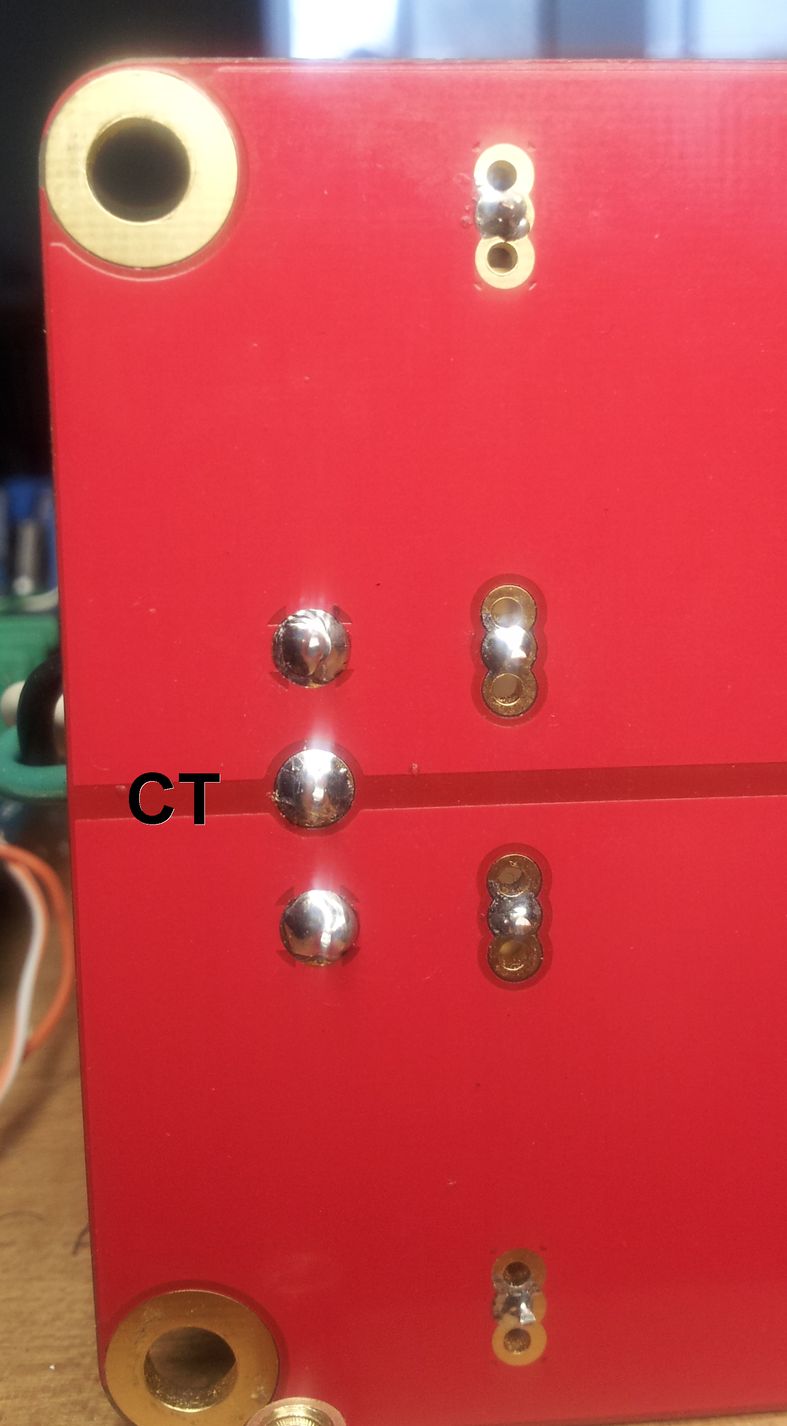

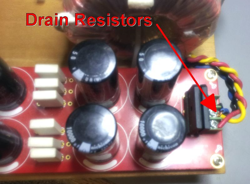

Ah well, the drain resistors don't go on the AC side, since we don't need to drain the power company. On that board, drainer resistors go underneath, at C1 and C2.
notes:
When using 1/4W resistors, 3k3 drainer resistors can be made up of 3 of 10k (3/4W 3k3) at C1, AND 3 of 10k (3/4W 3k3) at C2.
Both rails have identical drain.
That's an extremely light/slow drain--good for audio quality, bad for fingers, and therefore requires adding LED warning indicators for better safety.

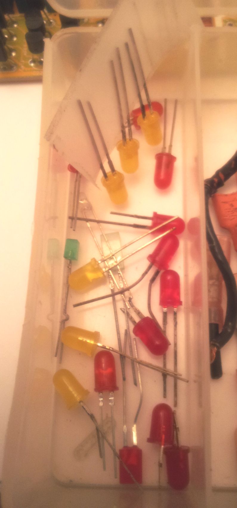

I have some of those yellow painted LED's and will go measure one of them to estimate an appropriate resistor value--painted LED's may have a voltage drop anywhere between 1.6v to 3.2v, so I'll go check. The schematic has the resistor value for a clear body red (1.7v) or amber (1.9v), However a white LED (~3v), regardless of the paint job would take a different resistor.

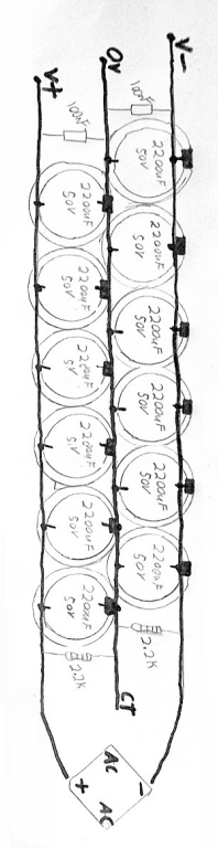

Bob, here (attached below) is a layout method, for perfboard.
This easy construction method has three thick solid copper conductors. That photo below is not specifically your power supply, but really the point of these simple power supplies is a good head start with decent performance. And, then you accessorize to suit for a given transformer--all transformers have unique needs. The cap tank is universally useful but there are many rectifier and filter options, so I will attempt to re-draw it modular and this will take a little while.

I didn't find the Radio Shack painted LED's but I did find several different models of colored body LED. They're all internally yellow LED's 1.86v to 2v range. You can check yours by just lighting one up (low current low voltage wall pack and don't forget the LED's series resistor) and measuring the forward voltage drop across the LED, with DC voltmeter.
Just enough current to light it is the diode knee voltage. Its slightly lower than the average figures, but knee voltage (switch-on voltage) is what we need for the calculator and for a bit of safety derating.
Next: LED Resistor Calculator
We put in 37 for voltage, and we put in LED diode drop of 1.86 (put your real figures here).
Current highpoint is led constant current datasheet figure multiplied by 0.43, which is max (and definitely try less, until the output just starts to decrease, which is the actual max). However, a 1/4w resistor is the real limiting factor here. Decrease current until the calculator's "safe pick" resistor is 0.250mw or less.
Result:
With 1.86 diode knee voltage, I get 4.27ma, or in other words. . .
8.2K resistors.
Of course, you could use 10k resistors--just slightly dimmer light.
