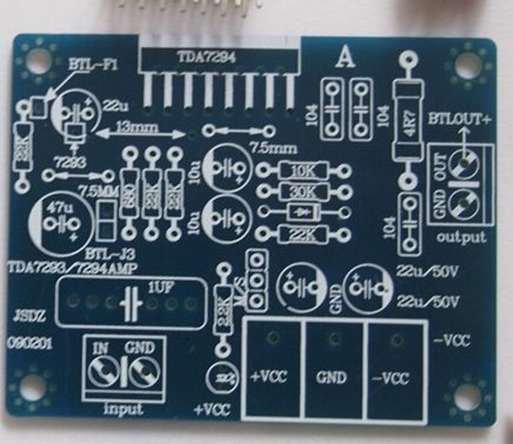

This is the board I'm using now:
Heavy Duty Supply.......
This is available at the DIY audio store.

Stanton was fine with posting the info on the board I'm using. It is the same standard design as was posted earlier but with english comments and little larger. I'm adding a picture of the board to be a visual aid for folks like me to understand which segments are being discussed.

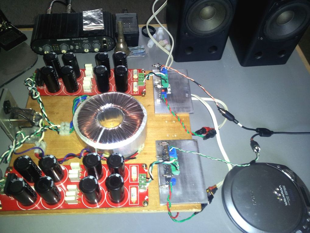

Sure, that's fine too.Daniel,Wouldn't the cap bank be ALMOST as easy to construct using an unetched double-sided PCB for each polarity, a la Terry Given? It should then have much lower impedance, right? Or am I missing something? Tom
For the photo in post#15, I just found it fairly easy to use 3 strips of 14ga solid copper, a scrap of phenolic, a bit of flux and a ~35w iron.

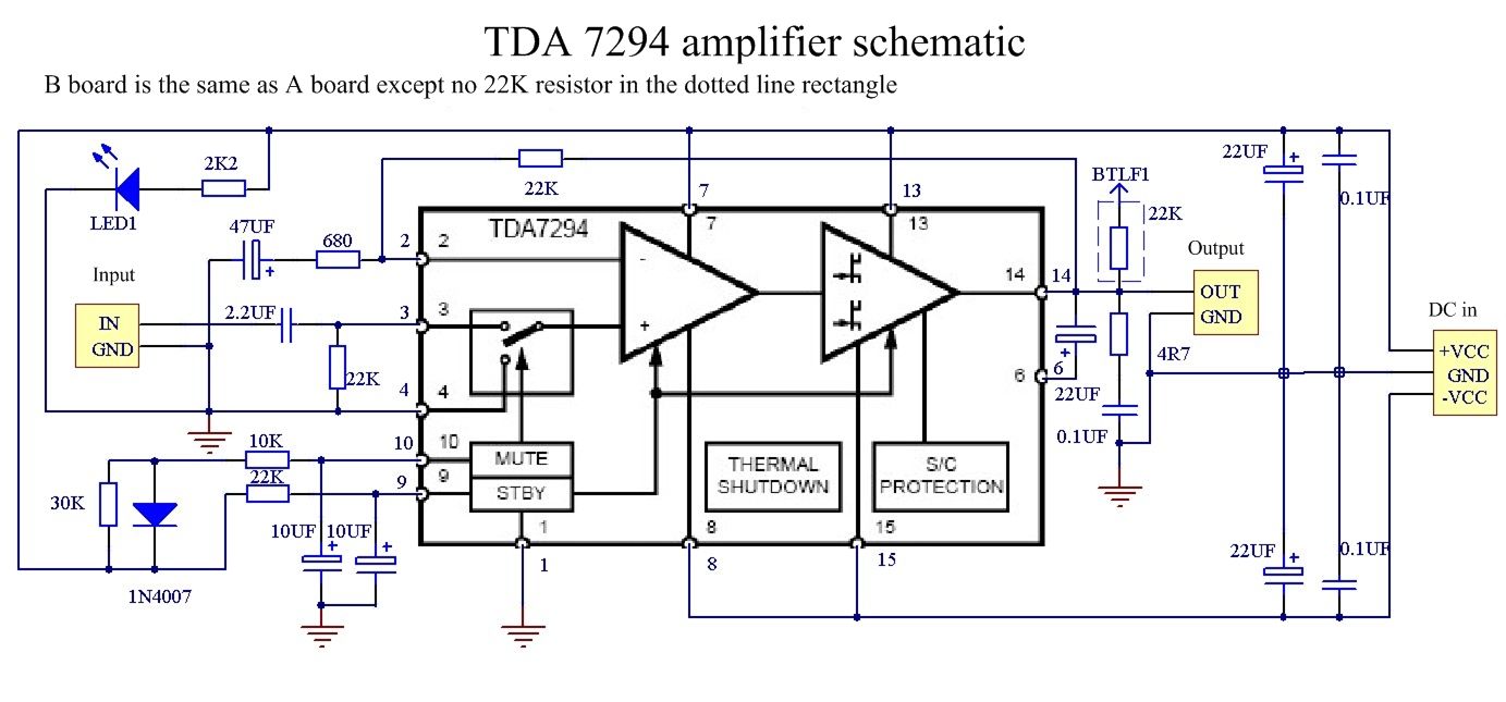

The datasheet has terrible quality schematics but good quality footnotes.I'm following along with this data sheet. Are we all based there? So va is arbitrary and derived - not being limited by a posted spec - correct? Daniel, How did you determine the number and size of the caps used in the ps you posted?

The transformer is charging the caps while the amplifier is discharging the caps.
We need to keep the caps fully charged if you want high quality clear bass.
That's why needed transformer amperage is decided by amplifier watts.
That's just fine.This is the board I'm using now:

You can use 3300u caps for smoothing (C1, C2, C3, C4) and 10,000u caps for reservoir (C5, C6, C7, C8).
It has a lot of capacitance, and, that's probably beneficial with that 200va transformer.

After this photo was made, the drainer/indicator leds have been added, they're amber, and the whole thing lights up. Without those additions, and without load, this supply stays fully charged (fully hazardous) for about a week. The white diode snubbing caps shown per each diode are 3.3n polyester. The red DC cable snubbing caps shown are 47n polyester. Those added polyester caps are unnecessary for your CRC power board. The power supply in the photo shows the estimated minimum 13,200u per rail for solid clear low bass and will do it if the transformer has enough amperage to keep the caps fully charged in all conditions. . . else double the capacitance or a replacement transformer may be indicated.

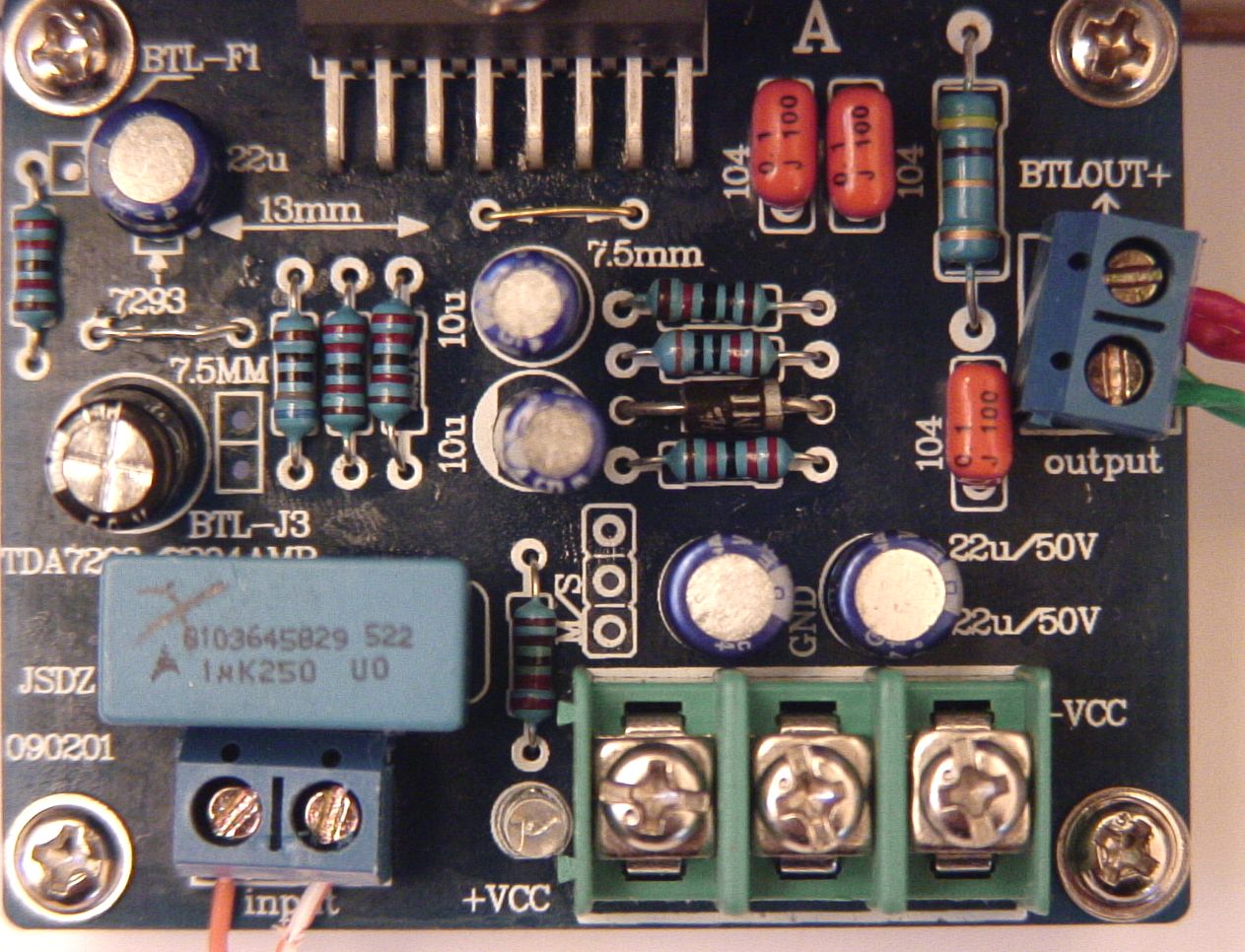

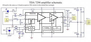

Problem: The datasheet example schematic shows overlarge power caps at the amplifier board, your amplifier's schematic shows undersize 22u power caps at the amplifier board. However, this amp is quite sensitive to small signal power. I think you're going to need to upgrade to some 220u caps (or 330u caps) for the amplifier board power caps. . . before fine tuning anything else.
This is a miller comp amp and that cap is required for function. Your schematic shows 22u from pin6 to pin14. This is slightly undersize. Some of the newer schematics have 47u. According to the datasheet footnotes, upgrading the bootstrap cap to 47u will do slightly better bass clarity.2. Bootstrap Cap
Adding a tiny cap to an ordinary quality large cap, to create an audiophile quality large cap. Each combination is unique. I suggest trying it at the NFB cap to improve the treble quality.3. Bypass caps
Your schematic shows 47u NFB cap series to 680R feedback-shunt resistor divided with 22K feedback resistor.1. NFB cap
5. Feedback-shunt
6. Feedback resistor
First lets figure the gain. Calculator keys 22 / 0.68 +1 = 34x gain.
That's a bit high for this amp.
Next, let's look at some audiometric NFB cap sizes with matching feedback-shunt resistor values.
150u with 3k3, and nearby values work
220u with 2k7, and nearby values work
270u with 2k2, and nearby values work
330u with 1k9, and nearby values work
470u with 1k2, and nearby values work
1000u with 680R and this isn't a good idea because it is hard to find small signal worthy 1000u caps and that much cap discharge can break the input transistors.
Currently, your NFB cap with 47u and 680R, on the schematic is a bass blocker and the source of poorer quality bass. See the datasheet footnotes where they advise that a bigger NFB cap can get you better bass.
Here's some options that don't have a bass blocker effect:
150u with 3k3 fs and 68k fb, 22x gain
220u with 2k7 fs and 75k fb, 29x gain
220u with 2k7 fs and 68k fb, 26x gain
220u with 3k3 fs and 75k fb, 24x gain
220u with 2k7 fs and 56k fb, 22x gain
270u with 2k2 fs and 68k fb, 32x gain
270u with 2k2 fs and 56k fb, 27x gain
270u with 2k7 fs and 68k fb, 26x gain
270u with 2k2 fs and 47k fb, 22x gain
330u with 1k8 fs and 56k fb, 32x gain
330u with 1k8 fs and 47k fb, 27x gain
330u with 2k2 fs and 56k fb, 26x gain
330u with 1k8 fs and 39k fb, 23x gain
470u with 1k2 fs and 33k fb, 29x gain
470u with 1k2 fs and 27k fb, 24x gain
470u with 1k5 fs and 33k fb, 23x gain
Output caps block DC at the speaker jack, about 6600u for an 8 ohm speaker can be made high quality with 3300u||3300u for low loss. This cap simply goes in series with the speaker+, blocks dc, and protects the speaker.8. Output caps
9. Speaker protector kit
Speaker protector kit from velleman is an alternative and the kit disconnects the speaker if DC is sensed at the speaker jack.

The TDA729X is further disadvantaged by its terrible datasheet schematic examples, its short gain capacity and its bizzare pinout that often leads to unoptimized PCB layout. Nevertheless, the part itself is of good quality.
Earlier I was speaking of the NFB cap, which is really not different from an Input cap (except that the typical sizes are different). Effective and easy bypass does include parallel same value cap; but it also includes 10n and nearby value polyester as well as 0.47u and smaller electrolytic. 4n7 and smaller ceramic can also work. And, combination bypass can be done.If bigger than 1/1000, a series resistor with the smaller cap may be needed. OR, as in my TDA7294 amps, I use paralleled caps of the same capacitance.
At the NFB cap, series resistor with a larger cap works. Here's a composite approach: 22u NFB cap with 10n bypass cap. Onto that is 220u+3R3, and that resistor is at groundside. And additional 0.47u electrolytic can be added to the 220u. Basically the smaller signals and vocals will go through the 22u, while the larger signals and bass will go through the 220u. The approximately 243u agrees with a 2k7 feedback-shunt resistor. It is a real example. This approach and either noise gain or anti-miller comp can be added to TDA7294 to use it high gain without a preamp. That is quite time consuming because the amp is not suited to high gain use. And, actually, the higher the gain on that chip, the more likely it is to be a mid-fi and/or make the fine tuning difficult.
But, of course if the amp is set to low gain, there's less gain put on cap peculiarities of any cap at the amp, so extremes of complexity would be unnecessary. . . or perhaps merely "relocated" to the preamp on clean regulated power not affected by jolts from driving a speaker, which makes the preamp a more sensible spot to have some gain. And, if at low gain, the TDA7294 is more likely to do hi-fi. There's many other factors, but low-ish gain probably makes them easier.

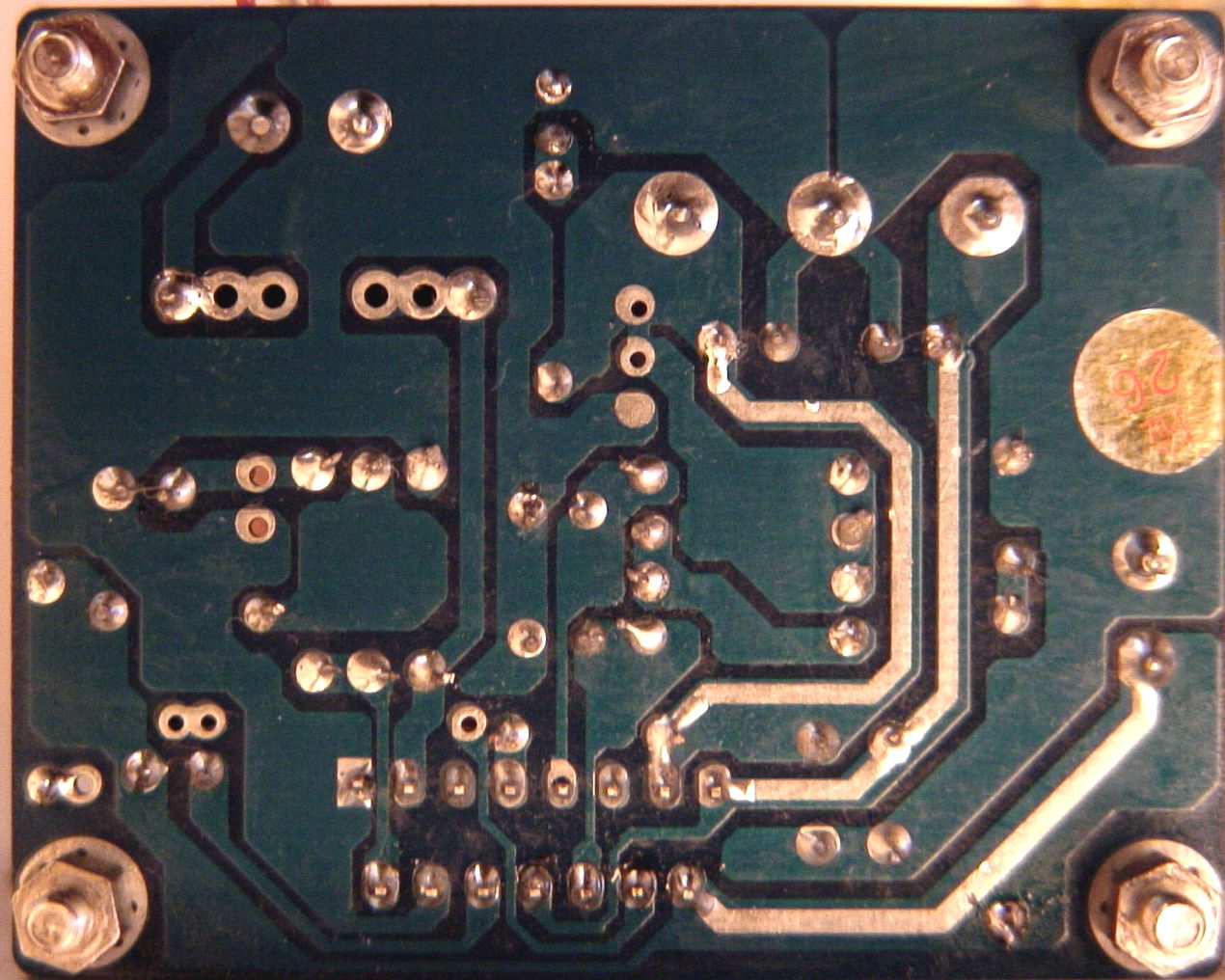

Do you have an image of the other side of that PCB?

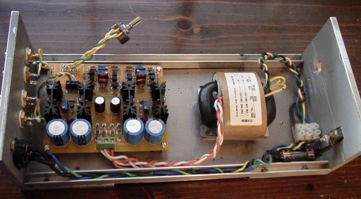

The power supplies I'm using now are 34.5 VDC. It is not a mono-block as both supplies are fed with one 200VA transformer. Havn't had a chance to try the discrete 125 VA setup yet, hopefully today. As stated earlier, I do have two of Peter Daniels bare Universal PS boards that I can put to use if that's a better option.
Jay - My speakers are the Sunflowers by Paul Carmody. I haven't used a pre yet, but my go to piece is a JC-2 clone from the same vendor. My other good pre is a Carver C-1 and I have a Mackie Satellite that is super clean. I have been using JRiver Media Center through a Mini2496 DAC with Dario Inserra's upgrades to feed the amps. The available SPL is more than suficient, though I think I'm hearing that more gain in a pre and less on the amp may benifit the sound quality. Is that correct?
gootee - attached a photo of the bottom.
