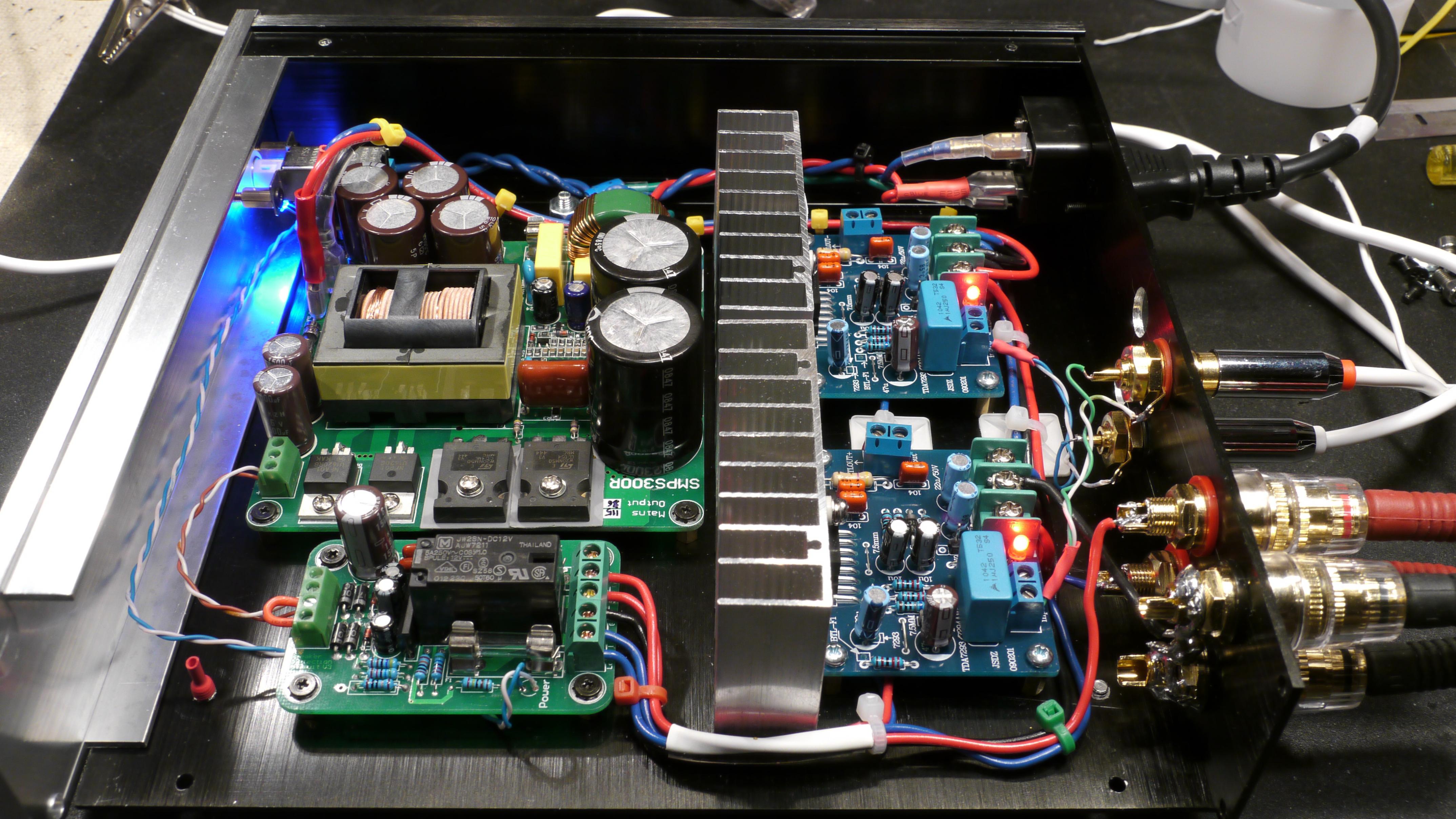

Bob - I just completed a small amp using the TDA7294. I went with stock amp kits from my favorite China vendor. No exotic parts swapped in. I haven't done a lot of critical listening yet, because the gain on my new Doug Self preamp just blows the volume up on all my amps that don't have volume controls on them! The 7294 also seems to be running a little hot (I guess, @ about 53 degrees C.) I don't know if that's normal or not. I think my heat-sink needs to be beefed up some.
Rick

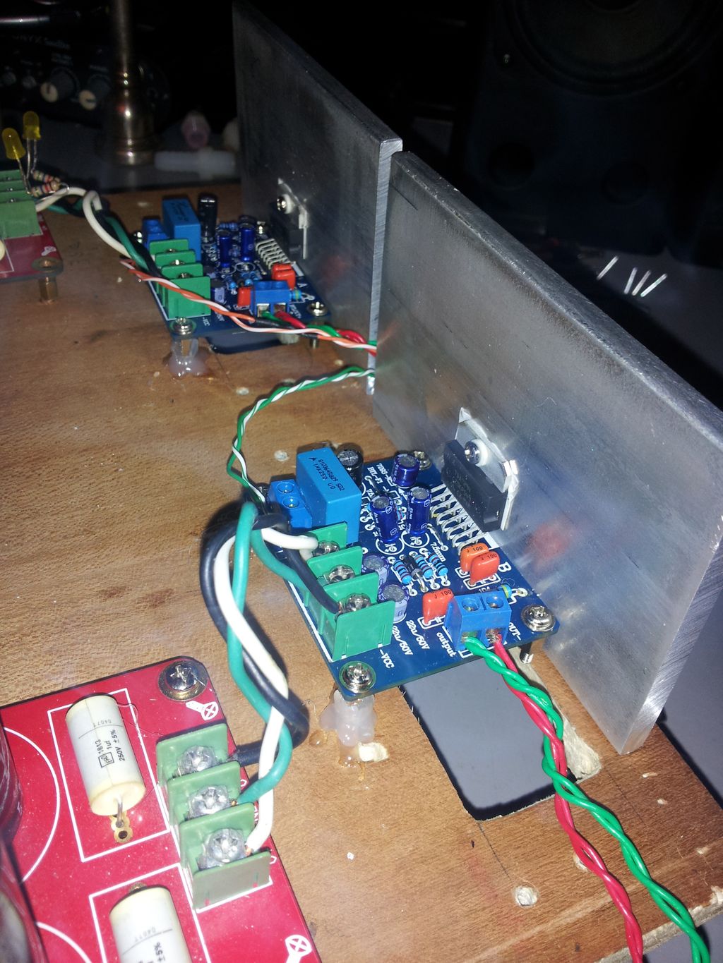

That's the exact same kit I have. I'm still on a slab of plywood. Your build looks terrific and I'm going to look closely for ideas.
I just have a temporary heat sink of 1/4" x 3" x 4" flat stock but haven't had any heat related problems even after extended hours of operation.
I'm game to try a P2P if someone can provide a BOM. Sounds like fun.
My setup is JRiver to a Mini2496 DAC to the amps. Haven't found the need for a pre, though I did put the JC-2 clone in for an experiment. It didn't help much as the top end of the amp still needs to be cleaned up. More of the same isn't better ;)

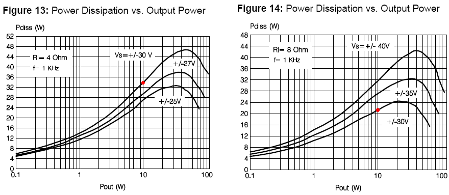

That's normal. The heatsink is very thin and of poor aluminum quality. I would go for no more than 20V supply (lower Pmax) with that heatsink.
It depends on speaker load and power supply rail voltage.
If I wont listen in high power (and have efficient speaker) I will prefer lower voltage to allow smaller heatsink and compact amplifier.

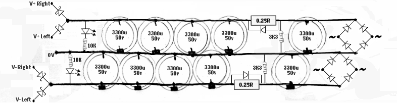

Non-independent mono-blocks? Okay. Will this do? With only one transformer, it doesn't cost much.
^ Yes, something similar to this. The xformer, rectifiers and main big reservoir can be shared while the sections after series resistors or other series elements (and in GND nets also) would be seperated between PCBs, being located on-board. Then a local GND bus connecting PCBs would establish a quiet and common GND. All this applies in case of mono PCBs (or multichannel >2CH), with stereo PCBs things would be rather simple; PSU (P2P or PCB), 3 wires, Amp-PCB.

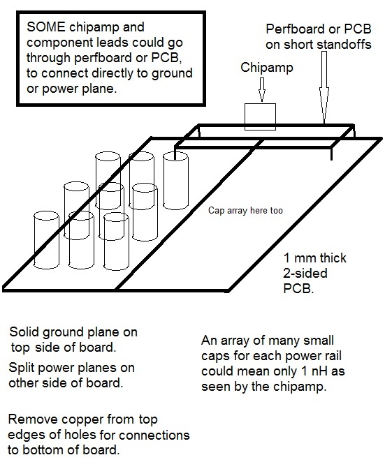

I guess there are a few general options, with trade-offs, to be considered.
Not needing an etched PCB would probably mean that a lot more people would build one. It would at least mean that it could be more-readily built, and someone who wanted to build one could start almost immediately.
If the sound quality could also be superb, and the result was mechanically good and easy to construct, then not using a PCB pattern would definitely be an option worth considering.
For the reservoir caps, I would like to have consideration given to something similar to Terry Given's cap bank board. It uses a non-etched two-sided PCB. All you need is a drill. Use a slightly larger drill to remove copper from edges of holes for connections to bottom side. Cut cap leads, bend parallel to copper, and solder. Unless two PCBs were used, it would have to have all ground plane on one side and the power plane side would be split into two planes, for the power rails. The chipamp could be located over the line between the power planes. Check out the link and see what impedance Terry measured with his network analyzer!
If a small piece of perfboard or PCB were used for only the chipamp circuit, that board could be mounted on short standoffs, OVER one end of the cap-array PCB. Then, the chipamp's power leads could go down through the small board and connect directly to the power planes. Any ground connections could also go straight down to connect to the ground plane. See attached sketch.
That configuration would also provide more freedom for the layout of the small board.
A set of links to the posts about the wonderful cap-array board is at the bottom of the post at:
(NOTE that Terry meant to say RADIAL, not axial, in the post at the first link!)
http://www.diyaudio.com/forums/chip-amps/224914-lm3886-component-selection-3.html#post3282640
Tom
Tom, that looks really nice for powering amplifiers with regulated front end, like this from Ilimzn:
This is great!
The regulators have served as the necessary series element so that we can put big caps to help the output devices do good bass, without making the predrive section unintelligible. I like this schematic for demonstrating have your cake and eat it too. It is compatible with Tom's power board description at post 119.
