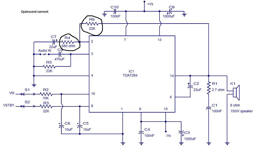

Hi, is any posibility to reduce de Negative Feedback and increase the quiscent current in a TDA7294 ? will have better sound and less gain ?
Santiago

I used 270K for R1, R2 and R3. And multilayer ceramic 470nF for C1 and C2. See figure 1 in the datasheet of TDA7294.
Take special care in the equality of R1 and R3 to avoid offset at the output.
I used these big resistor values to reduce capacitances and avoid the use of electrolytic for signal purpose.
The tda7294 has a minimum gain before it starts to become unstable.
I think its about 22.
You could change R4 to 1K but that's about the limit.
Manual say
CLOSED LOOP GAIN HAS TO BE >24dB
But it does not say it's because of possible instability.
I checked, I used it with low voltage gain.
Then I can say with certainty that there is no instability using lower gain.
On the other hand, I experimented IC overheating with the boucherot cell.
perhaps the boucherot cell has problems because of the low gain. Maybe that's what they refer to in the manual. But my solution is
NOT to use boucherot cell. My amplifiers are not used with long cables. then I should not have problems.
