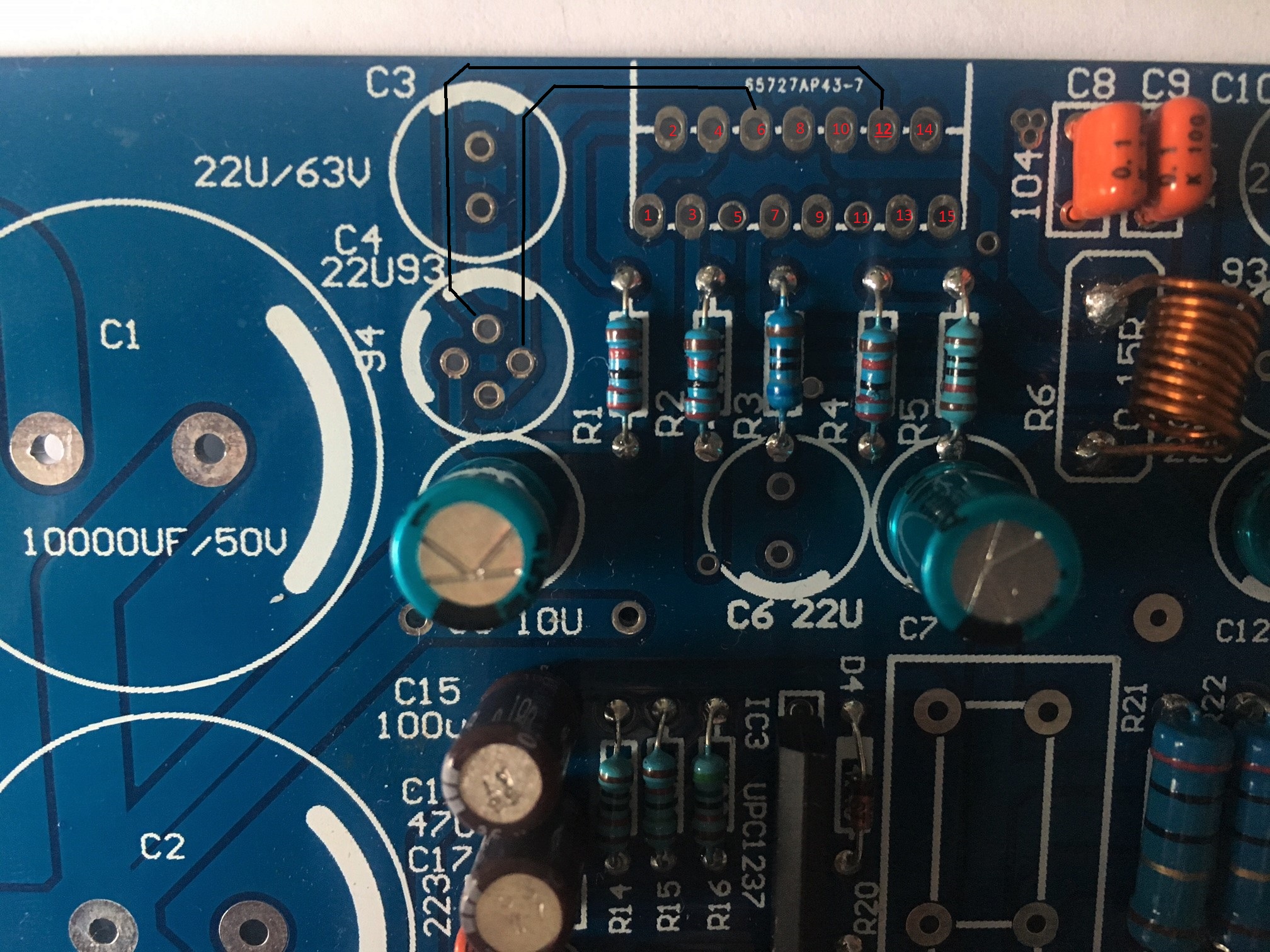

TDA7294 Stereo board Pin issue
I have bought a stereo board for TDA7294 with PSU and speaker protection all on the PCB. Sounded like a good starting point for building a first amplifier.
Probably not regarded the top choice here but I have some Motivation to finish it since I have it here now.
With the plentiful Information very kindly provided in this topic and the (kind of) corresponding TDA7293 topic I have tried to reconstruct the circuit.
One thing I have missed initially was that the bootstrap cap is connected to pin12 on this board instead of pin14. I have measured resistance between pin12 and pin14 of the TDA7294 provided and they seem not to be connected. So likely no fake TDA7293 with TDA7294 Label!?
Labeling says TDA7294 V6.
Well, to make a long story short: can I clip of pin12 and place a jumper to connect the bootstrap cap to pin14?
Unfortunately I haven't made a Picture before I started soldering but hopefully the attached one helps (some Details on my understanding of the circuit below). With NFB, bootstrap and power supply bypass provided as 22uF I haven't finished the board but ordered 220uF/63V (NFB, Bypass) and 47uF for bootstrap.
Help would be appreciated! I could also get more Pictures if this is of any help.

To the best of my Knowledge:
C3=C8 in datasheed=power supply Bypass
C4=bootstrap cap
C6=NFB cap
C5/C7=mute caps
R1=Feedback resistor
R2=Input load
R3=Feedback shunt
R4=Standbye
R5=Mute

solved, it's about the different options for C4
by now I have made it. The connection of the bootstrap (pic in post above =C4) can be made via the different positions of C4. Yet, the track is kind of hidden, at least for someone as new to it as me.
Still worth considering to clip Pin12 of the TDA7294 and make connection to Pin14 with a jumper there...if this would work out?

On that version of TDA7294, you can clip Pin12.Well, to make a long story short: can I clip of pin12 and place a jumper to connect the bootstrap cap to pin14?
See TDA7294 datasheet: http://www.st.com/content/ccc/resou...df/jcr:content/translations/en.CD00000017.pdf
For current production TDA7294 (both real and fakes), use TDA7296 datasheet: http://www.st.com/content/ccc/resou...df/jcr:content/translations/en.CD00000198.pdf
Same news, except for lower voltage. Pin 12 is still "N.C." which means you can cut it off if you need to.

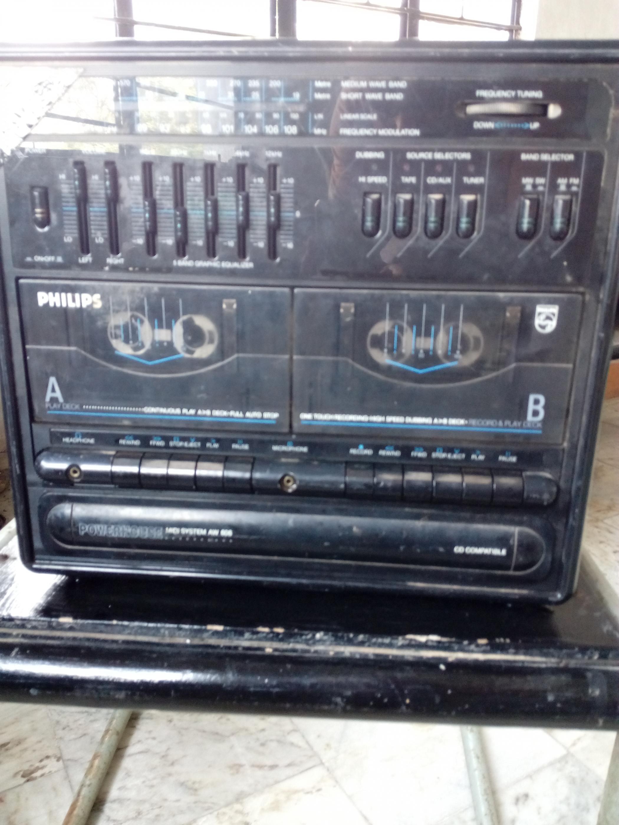

I recently purchased several Philips Powerhouse boxes, turned out to be Matsushita AN7161 power amps, and almost totally Rubycon and Elna caps...for a max. $3, in working condition.
A wash with soapy water, rinse with plain water, open, blow off the dust, spray the pots, check DC offset, and good to go...
I have run some of these with my computers playing MP3s, I need basically amps...can't get much cheaper!
Powerhouse was a series of boxes, dual cassette, tuner, equalizer, mechanical switch for selector... Later versions had a microprocessor for selection.

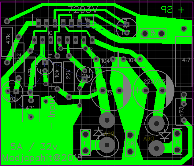

Blew TDA7293
I bought several 7293, i made PCB with my own design, and using sch as per Daniel using.
But when I connect to 32vdc symmetric, suddenly one tda7293 catch fire.
I ve recheck and reroute pcb and still found nothing.
Do my '93 fake ? I bought V6 czech version.
here my layout version.

http://www.st.com/content/ccc/resou...df/jcr:content/translations/en.CD00001887.pdf
Look at the block diagram, figure 1.
If pins 7 and 13, and pins 8 and 15, do not track together on power up; or if any of the connections are unreliable, then these particular chips will self destruct. This is a well known issue that these devices have.
All it takes is a bad solder joint, or a loose connection.
Chip start to glowing bright red, with extra thick smoke when powering up this chip about 4-5 second.
No input, No output, No dummy load.
@Fast Eddie D,
I ve recheck all route and joints, all joints are good soldered.
maybe I ll reconsider new layout with 2 layers for wider track.
with 15 pin and single layer, very thin path for V Rails, when joining pin 8+15.

About oscillating,
My device gain more than 26x. 47k/2K2.
I think it is not gain issue.
My PSU is good. Now still powering 2.1 LM3875.
I m using 20,000uf x2, 100n for decoupling cap. No snubber.
Since no problem in other amps. I think it s not psu problem.

Did you fit a dummy zero ohms load to the input?.........
No input, No output, No dummy load.............
Did you fit the Output Zobel so that the output could see a High Frequency Load?
You should short all the leads together while handling the chip and assembling the board. Don't remove the shorting wire until you're done soldering the whole board.
You can damage the chip while installing it or assembling the board, and then when you power it up it burns up.

I shorted Input with ground.
I always short input with ground when testing amp.
In the past, I ve burned one Ucd class d board, when no input presence.

My biggest question, why my chip cannot stand just +-25 vac.
On PSU Caps with multimeter, it read +- 34.8 V.
Measuring track after diode (im putting diode in every amp channel, in case reverse current) it s read +-33.9 V.
