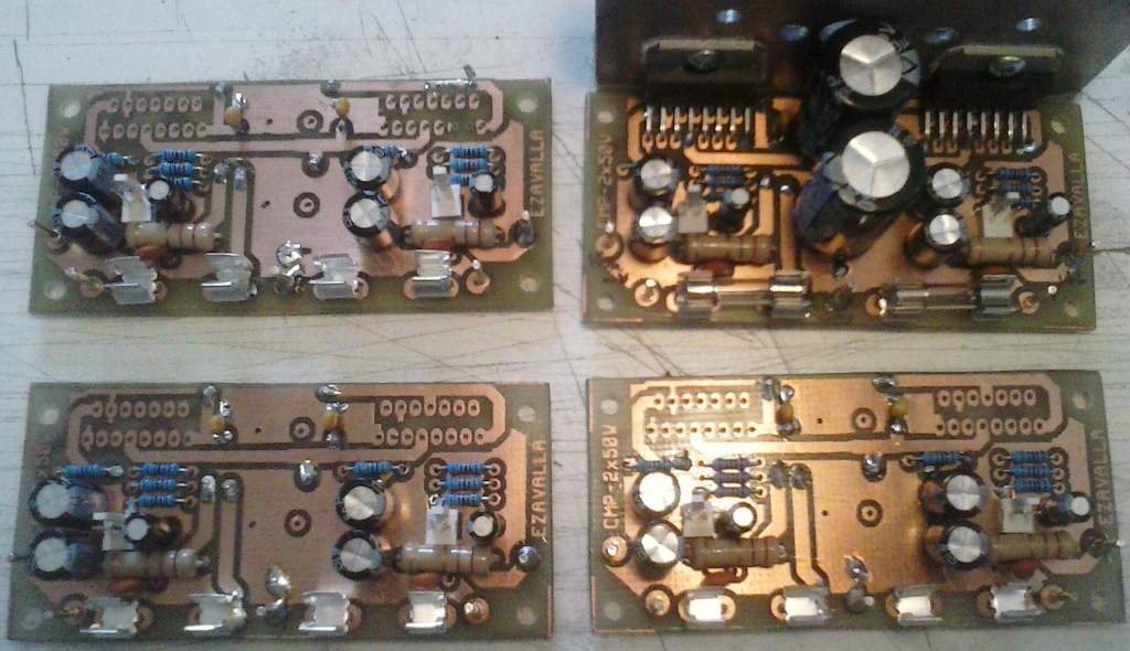

I have to say that it was a VERY short term test because it isn't a real operation condition and I hadn't got the right heatsinks yet 😱. The test was run more as a proof of "fake-or-not" device.
Even when it was a short test, there wasn't any inestability in the output signal. Not a visible one in the scope screen, neither in the FFT mode. As the datasheet says (and I believe 😉) this chip should be stable with a closed loop gain of at least 24dB, and using 27dB the nine chips I tested where stable in those tests. I know I should repeat the tests using an square wave, but I've got the heatsinks just a couple of weeks ago and I haven't got enough time to mount them..More than anything, the higher voltage and loading had hindered the stability enough to cause the temp to go up a lot. If at +-31vdc try TDA7294 with the gain set in the range of 35x to 37x. Note, at that voltage, if you had wanted success with the gain lower than that, use the TDA7293 chip for it.

You could try 220uF 50v caps (under board) parallel to those 2200uF caps, and, also, one (just 1) 2.2uF 250v cap from V+ to V- at the dc cable hookup point, and see if the amp runs better, with hopefully, less heat when you try +-31vdc.The value of the caps is as per datasheet: 2200uF + 0.22uF.
Both caps are decoupling ones.
That method is outdated, but it will fit and probably work. I sometimes use it for refit on production amplifiers.
I guess it's better to add a couple of 100nF (under board) just between +V/-V and GND very near the chip leads. But I haven't instruments to measure any effect they can produce, so... I'll keep the current configuration while the amplifier is stable.

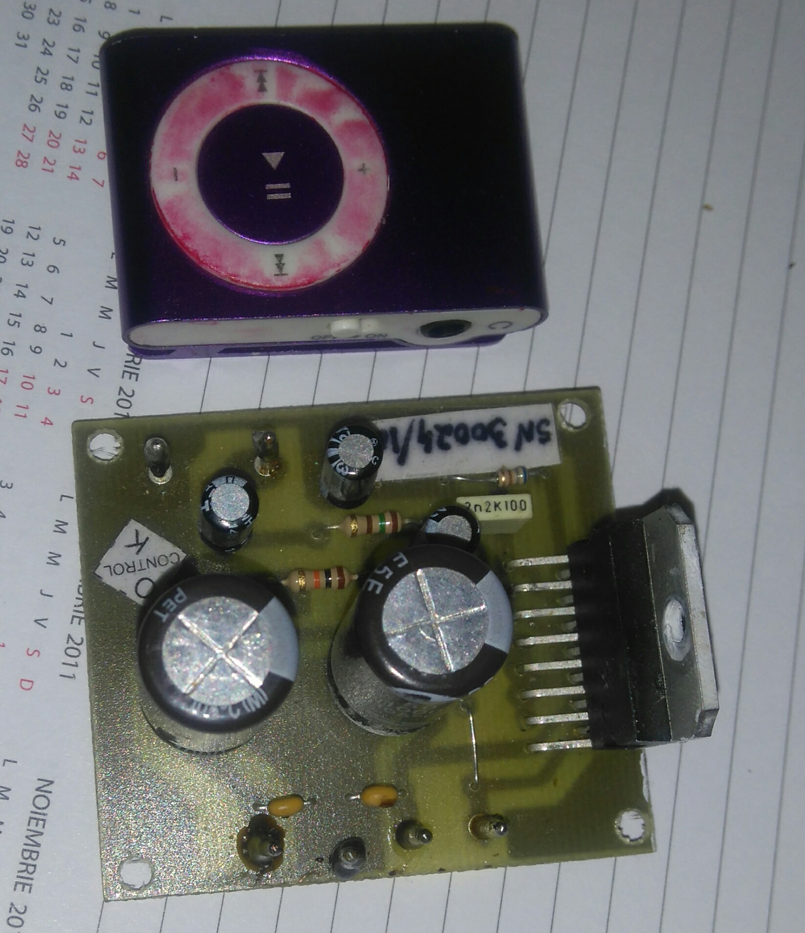

Here's the kits that I've bought a year ago (lol) didn't had a goood preamp back than and didn't used them.

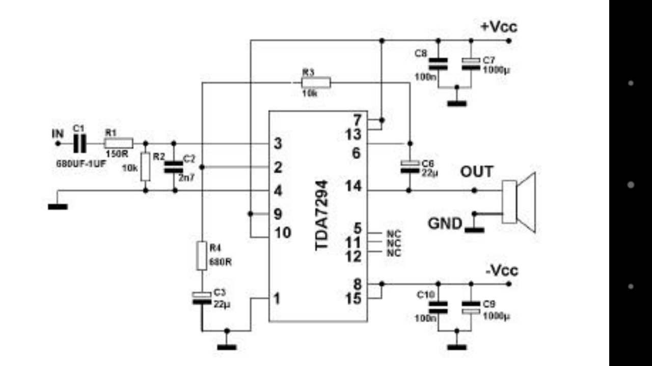

Why is r3 to pin 6 and than to output ( trough the bootstrap cap) not directly r3 on output?.
Even on the datasheet schematic r3 is on pin 14
On my board it is on pin 6
On that design, I think it is surely necessary that the power source voltage and current, be kept very far smaller than the amplifier's rated capacity.
Someone tried to use a gain less than 24db?
I used a gain of 2.0 without problems. Its perfect.
Now I need to use a gain of 2.9 and I am experiencing problems.
I have peak voltage of 12V from a preamplifier stage and I want to have 35V at the output.
The problem I have is that the TDA gets hot, even without load and without signal.
I am using:
+40V -40V
R1=33K
R3=33K
R2=17.2K
C2=22u
C5=22u
R6=2.7R
C10=100nF
Is this an unstable configuration? why?

This issue has been fixed by removing the Boucherot cell. But I must emphasize that you can use the circuit with less gain than 24dB.
