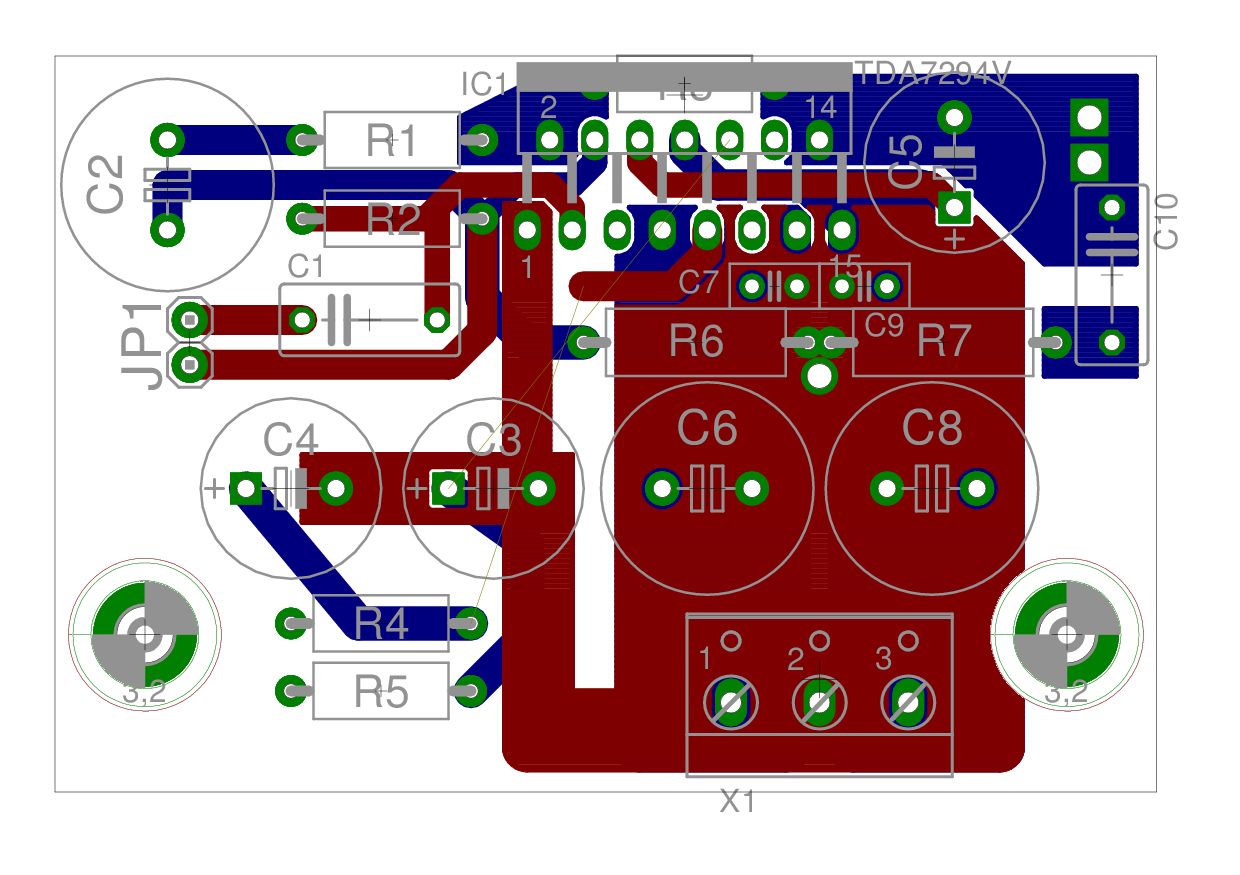

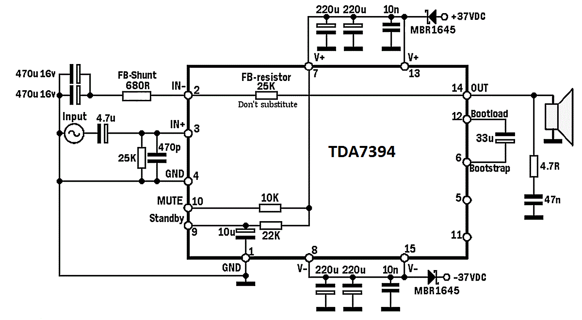

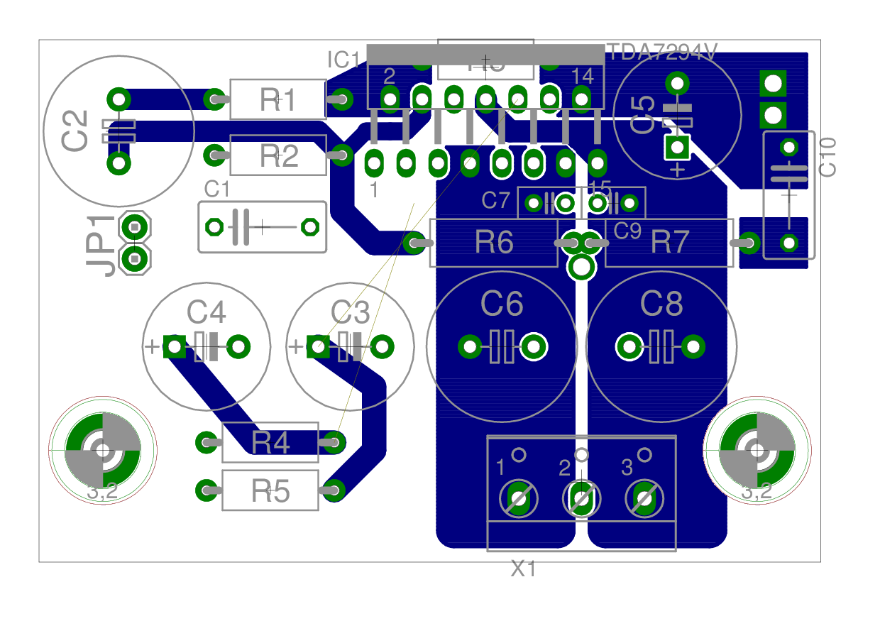

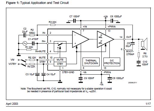

I think 1000uf+100nF is not very good either, but I wanted to keep to the datasheet schematic and to see what might be a realistic layout. Pin8 is in a bad location and makes things untidy.

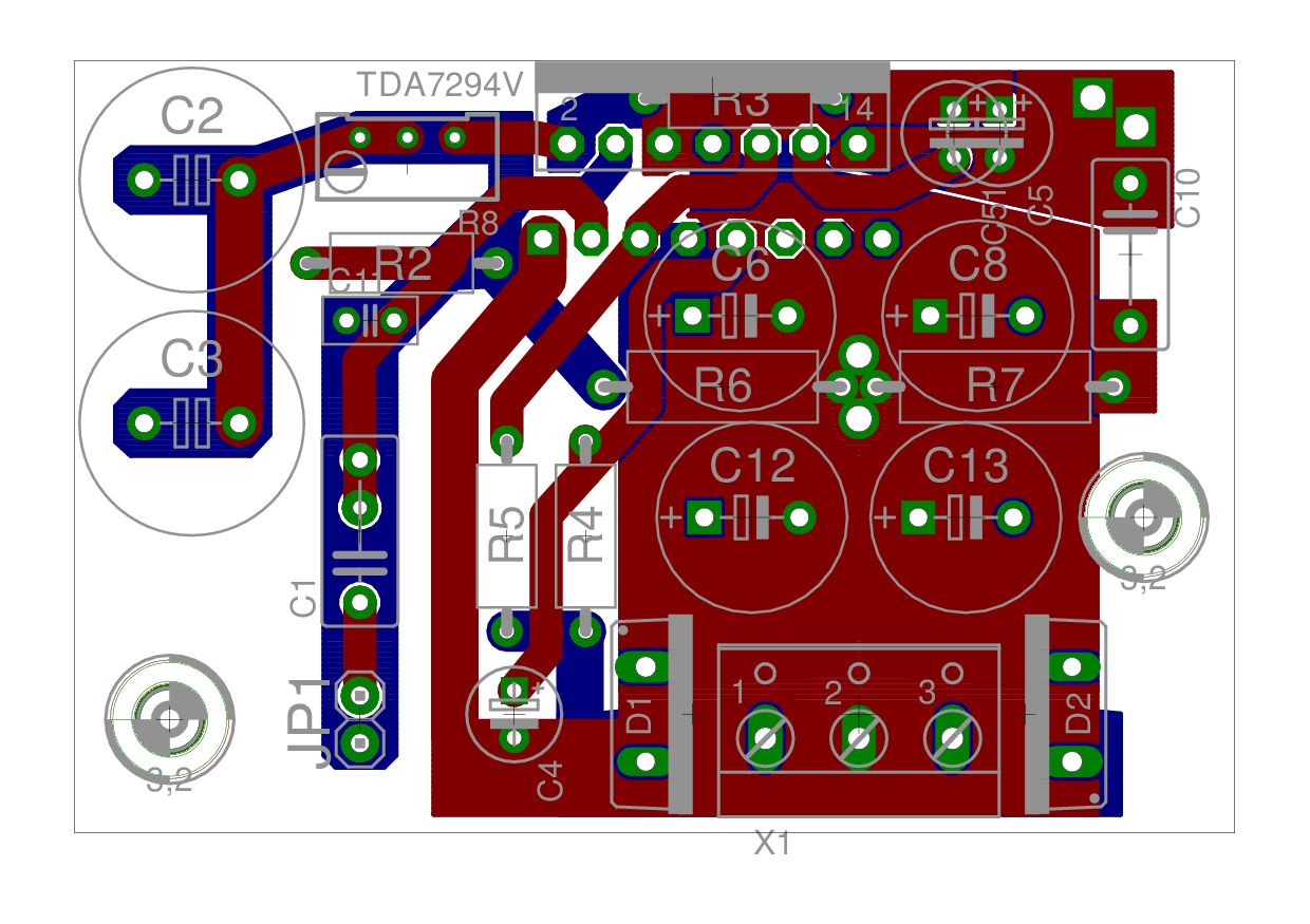

Increased capacitor size.

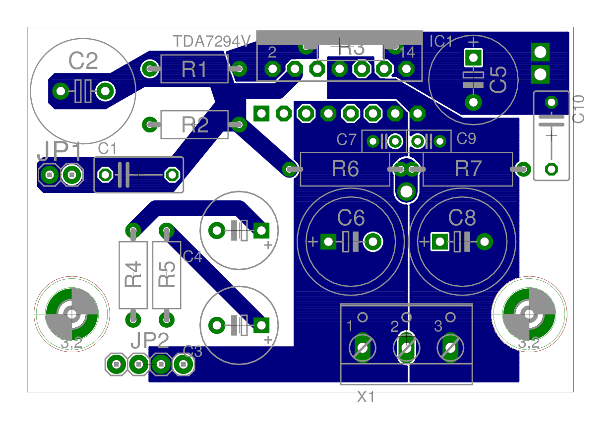

Nice work Mark! I haven't studied the routing and flow yet, but I like the first glance. I guess I don't see the problem with C5? One capacitor on one side of the board and the other on the other side. Solder one first, then the other. Very encouraging! How big is the board overall? I'm estimating 35 x 25 mm? Might be able to go even smaller by alternating placement of big capacitors top-bottom of board at other locations! (I plan to mount the heatsink to the chassis, and let the board float). Also, would it make anything easier if we spread out the pins on the chip between the front to back rows? I've done a quick check on perf-board and they can easily be spaced out 10 mm apart. Would that allow any better routing (two traces) between the pins? Finally, since pins 5 and 11 are not connected, can we just remove the pins at the chip, omit those 2 vias completely and use the gap between pins 3 and 7 plus the gap between 9 and 13 for other routing opportunities?
Sixto.
Sixto.
Placing the caps on the underside means that the board needs to be lifted 30-50 mm from the chassis and it is more difficult to solder/construct. The size now is 62x40 mm, would be nice to remove 2 mm.
It would have been nice not to have used pins 5 and 11 for routing so that the board could also be used for the TDA7293 chip.
It would have been nice not to have used pins 5 ....
Hmm, I just looked at the datasheet for the TDA7294 and it shows pins 5,7 & 12 not connected... (I've been focusing only on the '93, thinking the difference was just the bootstrap connections between pins 12 and 14) Am I looking at an old Datasheet? Anyways,the Clip Detector circuit is there, though I'm not sure how useful it is... My starting point in this process was testing out Rod Elliott's boards, his design ignored Pin 5 and also disabled the Mute/Stby circuits by connecting them directly to the +VS traces. Quite the minimalist approach, which I tend to favor.
It's a great learning exercise for me to follow your development of the PCB layouts, I am grateful for what you have shared so far, and look forward to see where it leads!

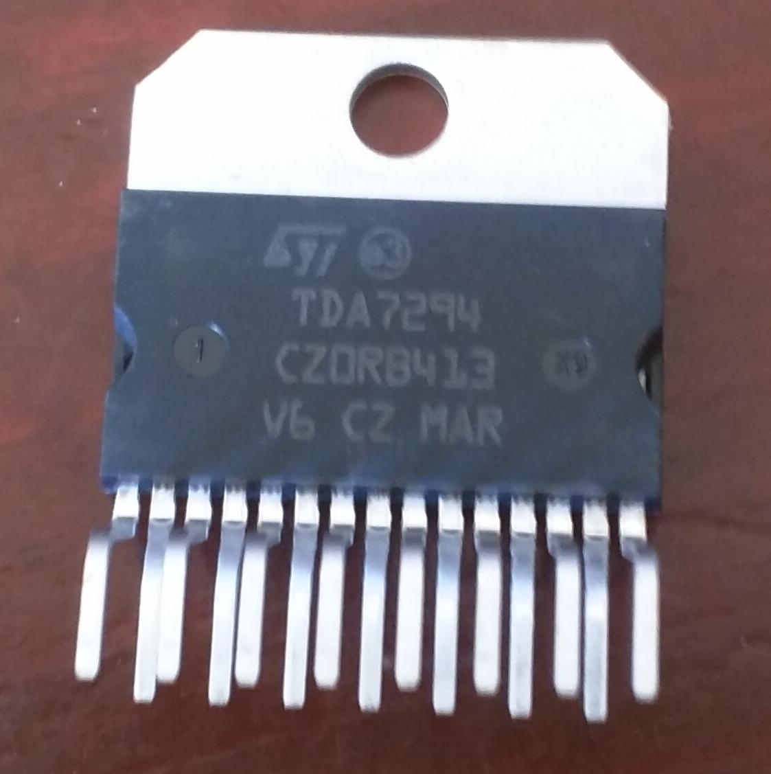

The different faces of TDA7294
There are 2 different TDA7294 datasheets.
There are 3 different TDA7294 chips that I know of.
1
On the rarest TDA7294, all 15 pins work, and it has a different datasheet, which is visually similar but also makes good mention of "Modular" just like the TDA7293 datasheet. It doesn't work well on a TDA7294 board--with all 15 pins working, it needs a board for TDA7293. The only difference between that full featured TDA7294 versus the TDA7293 is an internal setting suited to lower voltage. Today's $2 TDA7293's are the same thing, except the label is different.
2
Not previously rare, but is certainly rare today, the common TDA7294 shares schematics with TDA7295 and TDA7296, and it said "Singapore" on front. This one uses the most common TDA7294 datasheets, which makes no mention of "Modular" Also usable is the TDA7295 datasheet (and the real TDA7294 also said "Singapore" on front).
3
Today's TDA7294, says "Mar V6" on front and is usually not very stable; however, reducing the voltage to that which is suited for TDA7296 appears to fix it, and therefore I suggest to use the TDA7296 datasheet, mainly, much lower voltage.
Then, a question:
So, which "TDA7294" do you have?
Summary of the variants:
1 Actually a TDA7293 set up for slightly lower voltage
2 A real TDA7294, no longer manufactured
3 A TDA7296 with TDA7294 printed on it
Enjoying it may depend on identifying it first.

Hi all, I have been reading this thread in the past and a few days ago I received a TDA 7294 two board from jims audio. So I started reading this thread again. My old bookmarks lead to pages 41-42-43 and the assorted photographs.
But As far as I understand the latest proposed schematic, is the one on Daniels’s signature http://www.diyaudio.com/forums/atta...3316-optimizing-tda7294-output-tda7293dan.gif , but I am not sure there is a photograph of this schematic on the separate two boards.

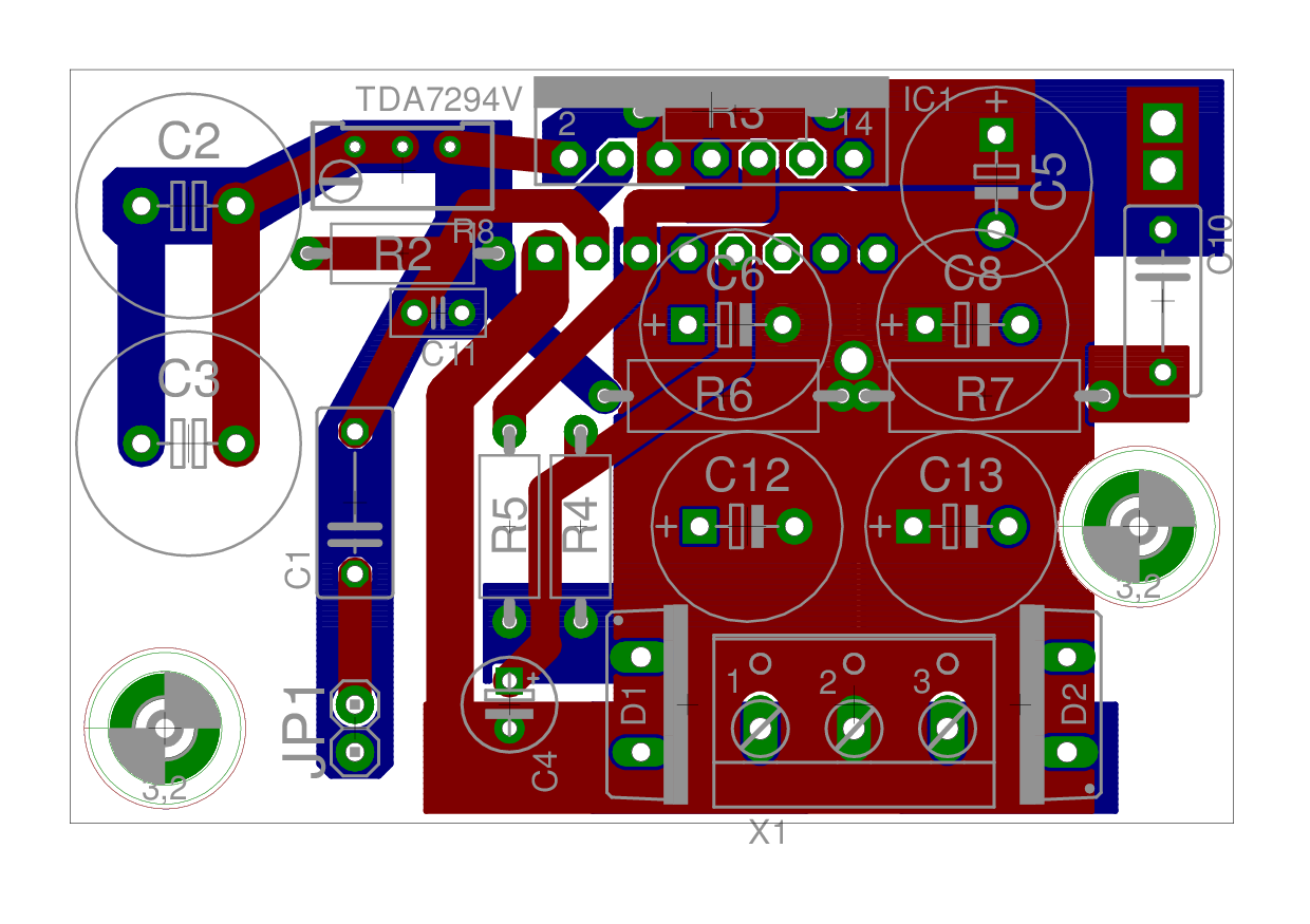

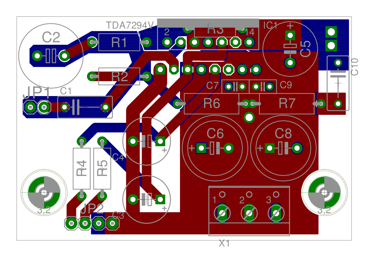

That layout is getting attractive!An attempt at Daniel's schematic, only not for TDA7293 because of pin 5. Problem with C5 still to be fixed.
TDA7294S/TDA7293V6 and TDA7293V7, use pins 6&12 for bootstrap cap hookup. These are the higher quality chips--all 15 pins work. They cost $2, exactly the same chip from both eBay and Mouser ($7) And, these versions with the higher quality bootstrap cap hookup, might be worth your time, possibly.
TDA7294V6/TDA7296 can't use that same bootstrap cap hookup, but rather those use a much lower quality arrangement instead. I suggest to save yourself some time and do not provide everlasting support for the lower quality editions. I already stepped in that one, and can verify that it would be pleasant to avoid it.
Board space:
The Inverting input coupler(s), (C2, C3) see 3vac at most, and those can use 16v rated polar caps, if you like. That's a lot smaller.
As for decoupling caps (C6, C8, C12, C13), see what the 220uF~270uF 50v caps are listed at for the size of Panasonic FM, FC, and Nichicon FW, PW.
There's sometimes two versions, but always choose the "tallboy" tall and skinny version for decoupling.
Bootstrap cap, 33uF (C5) is not very big (not as big as shown). Also, it sees only the voltage difference + 1/3rd, because signal.
As for input cap, the inexpensive Elna Cerafine Black 4.7uF works great for TDA7293's input (C1) cap, or Nichicon Muse ES 1uF for TDA7294's input cap. So, C1 needs an additional pad to support electro's too.
Omission: If C2 and C3 go through R6 for ground, that's a bad cap simulator circuit or "tone control," via RCR in the feedback (the tiny rc effect will get amplified due to gain and sound like C2 and C3 are bad caps). A good patch that keeps your groundlift theme intact is to add a tiny value capacitor in parallel with R6 to prevent treble droop. Alternatively, don't groundlift anything at the inverting input. So, at least there are those two options.
Still not completely understanding all the different versions. I will just keep to the datasheets.
Your suggestion on moving the inv. input ground. It is important that both inputs are connected to the same point (somewhere near R6). If we connected one to agnd and one to pgnd then the voltage over R6 creates an error that is amplified.

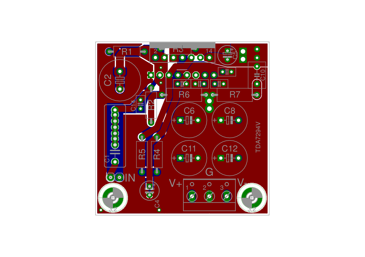

Here is smaller layout, 5cm by 5cm.

This previous version was much better in those two ways--such as making the quality control of the electrolytics, built right in to the design. No custom caps needed with that. With the electrolytics positioned closer to the chip, it will achieve lower gain more stably, therefore yielding Much higher resolution.
I certainly haven't seen a better board than this one!
TDA7293-specific bootstrap cap hookup is for quality, so I do suggest to use the TDA7293 datasheet for the pinout information.Still not completely understanding all the different versions. I will just keep to the datasheets.
What I don't like here (beyond being difficult to build) is the ground layout. The power star point should be above the larger C6-C8. Doing this, separates the returning audio currents from the capacitor charging return currents. It looks like a ground plane, in reality, it is trying to be a very wide trace.
