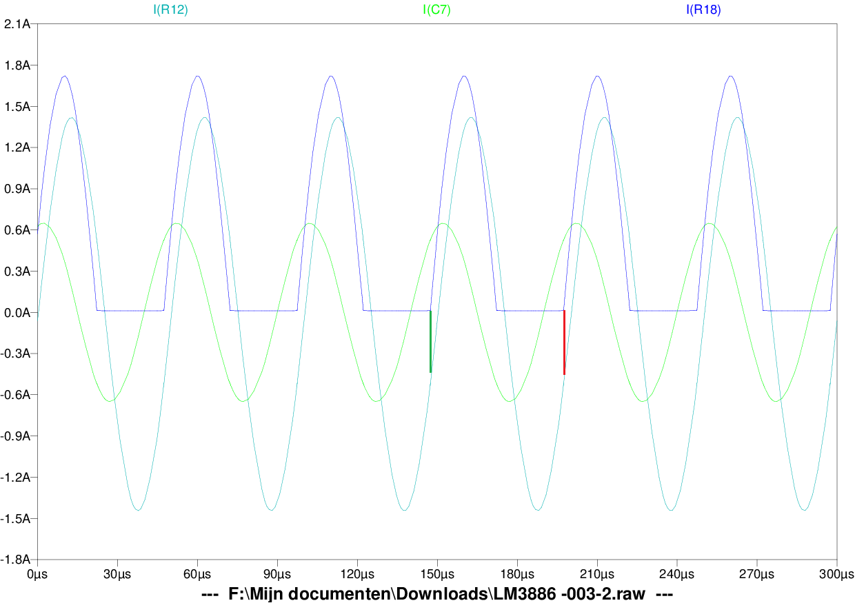

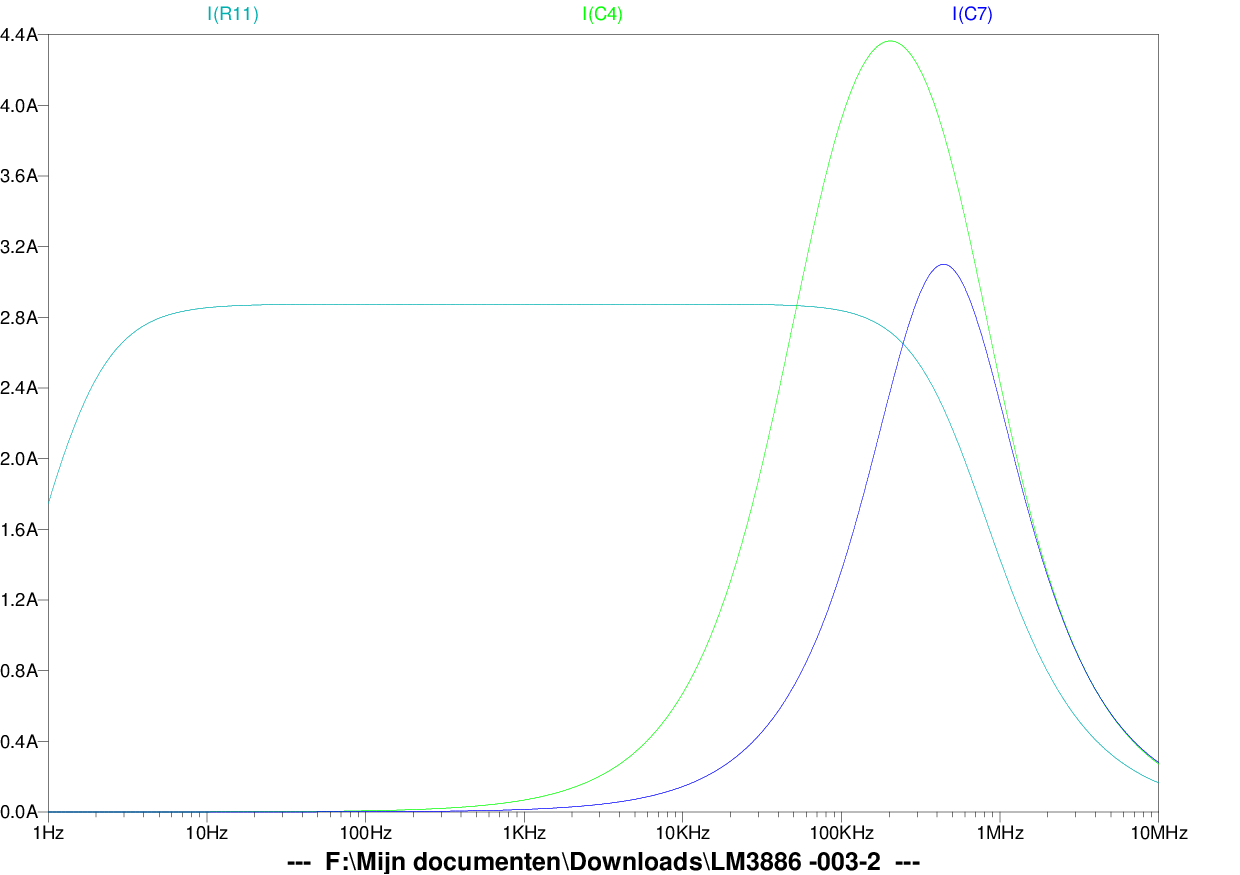

For output zobel, let's say that I used a 4.7 ohm resistor, and then what would be a reasonable cap value range?
If I'd have used 470n, that's down by 3 at 72000cps, down by zilch at half that, and probably won't clip the audio band, right?
But, that cap sure does look too big, on just appearance, at least.

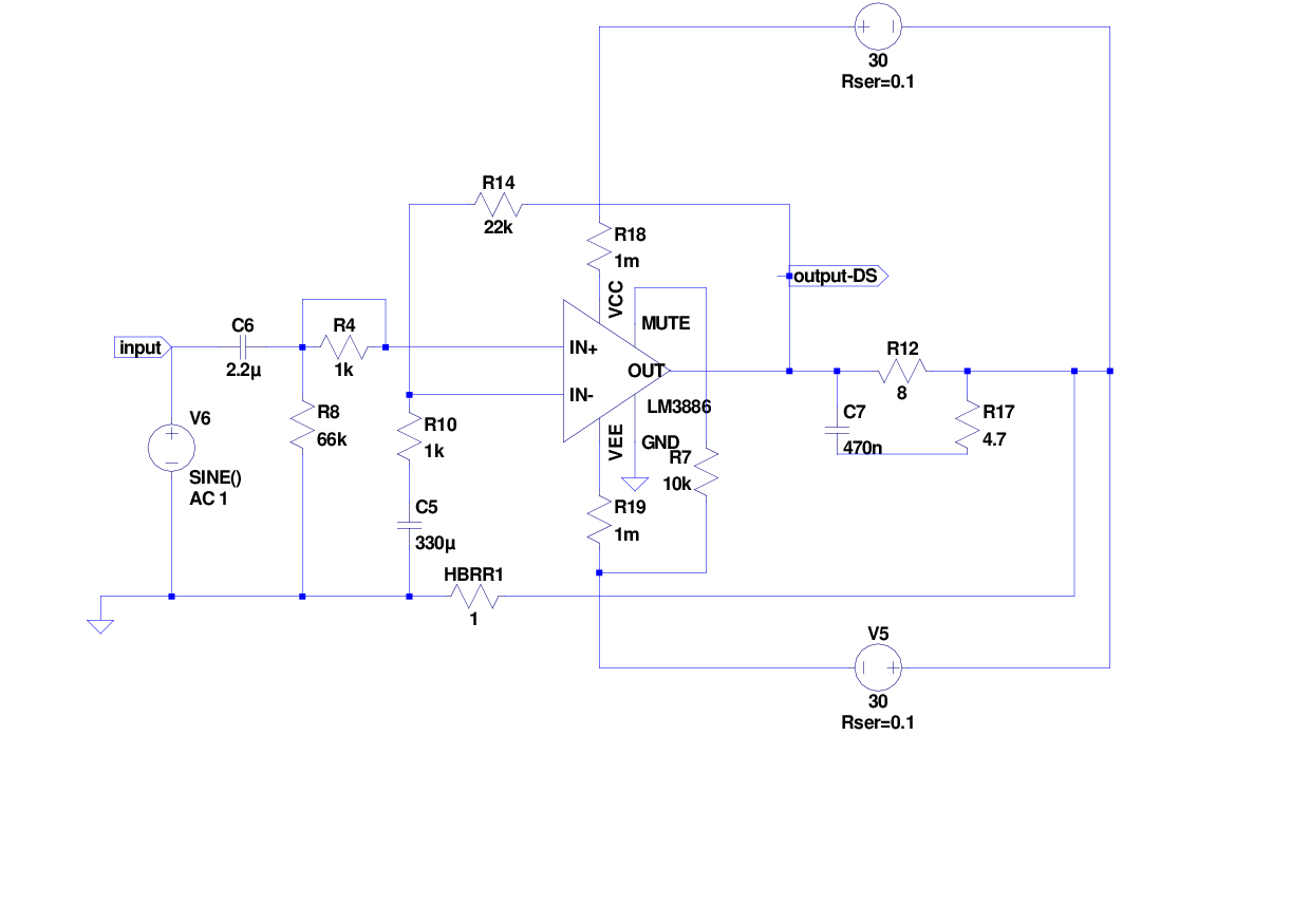

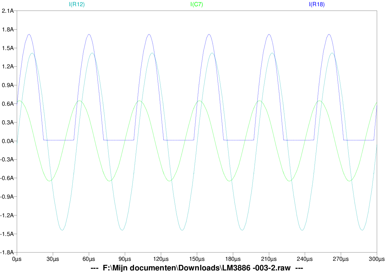

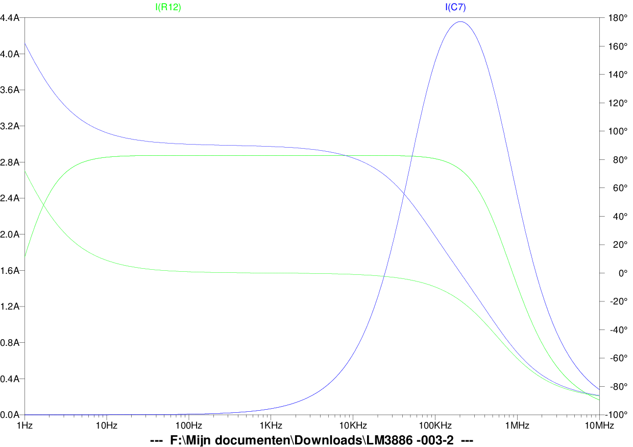

Not sure if this is correct, perhaps somebody else could check. This is the load and zobel currents at 20khz, 8R load with 470nF+4.7R zobel. The third current is from the positive rail.

Here we can see feedback at work with a capacitive load (470nF zobel + 8R load).
Although the load current is positive (or negative), for a small part of the time it is supplied by the opposite rail. Difficult to understand?

I think your sim modeling is correct.
The 470nF is far bigger than any I have seen in any sch. The normal range is 47nF to 220nF, with the vast majority using 100nF.
Bigger nF does mean more dissipation in both the resistor and in the esr of the capacitor.
Use a low esr high voltage capacitor.
The capacitor voltage rating does have to be de-rated for high frequency duty. The few I have looked up need a lot of de-rating.
I use 250V MKT in either 47nF, 100nF, or 150nF for the Zobels.
I tend to use multiples. it is some years since I last used a single Zobel in a Power Amplifier. The last is in the Pi output filter with the R+C across the speaker terminals.
This "spread" Zobel philosophy recently suggested by R.Cordell allows lower value capacitors to be used, but with the same total capacitance.

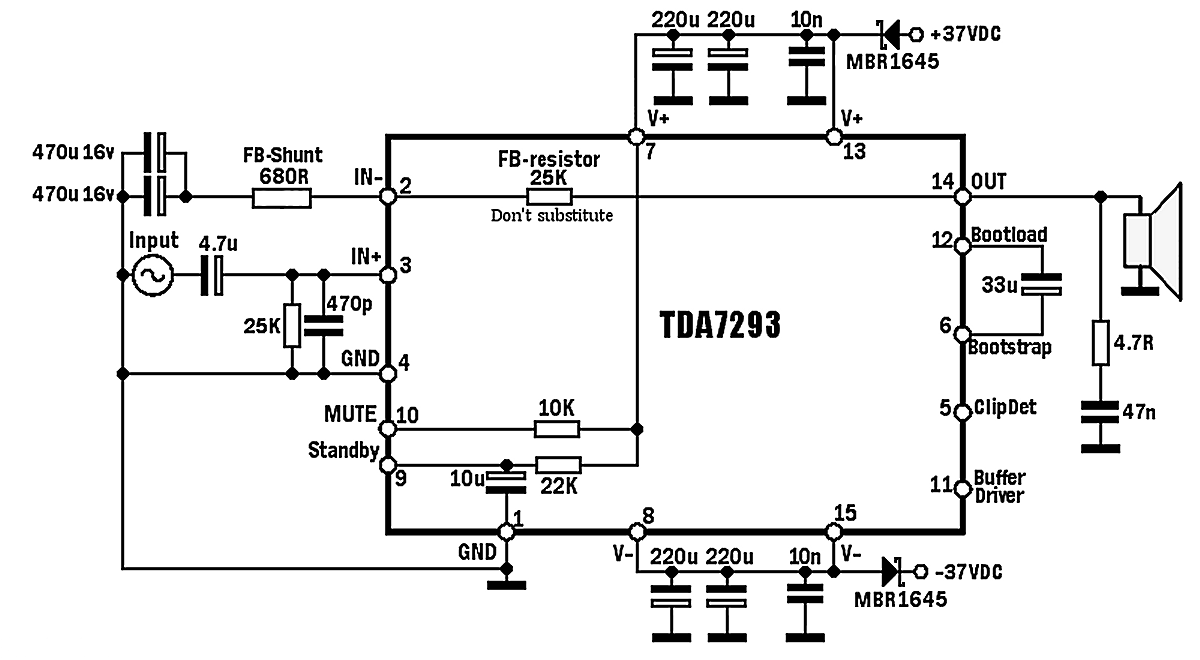

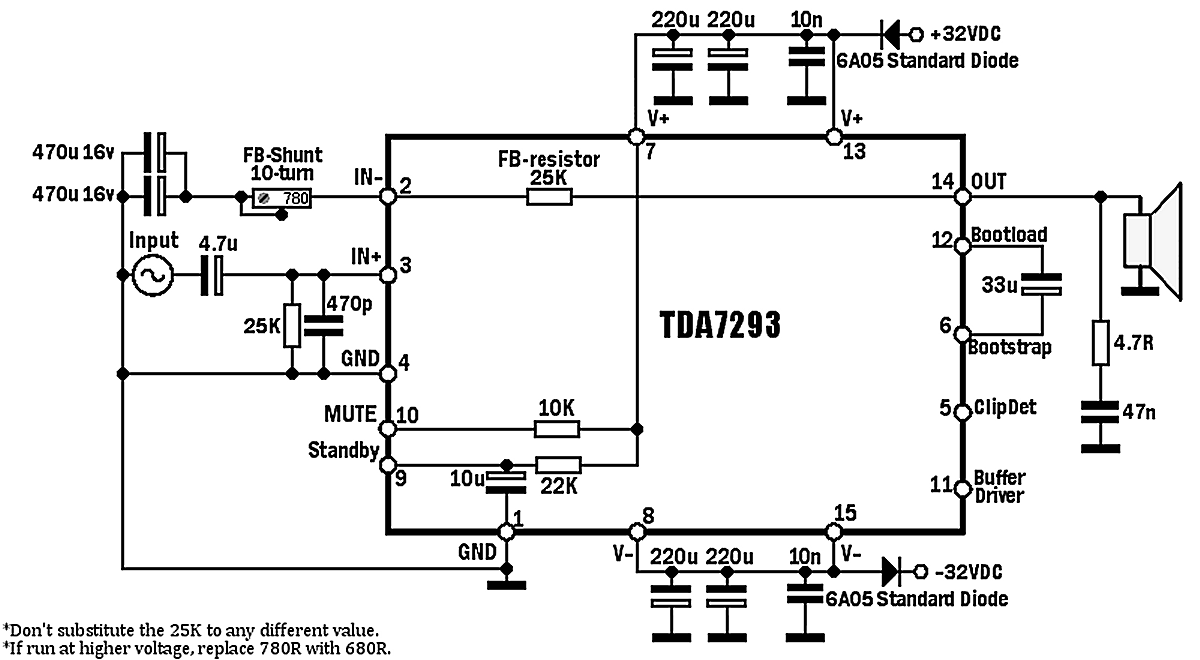

Thanks! And, then we have these (attached).
We're not likely to see any "in the wild" because this is DIY and they're likely to get modded (no matter how nice they are if not modded). Therefore, the normal usage for these is the solid place to start that was not provided by the datasheet.
The under-volted 45W example will image better (used along with 20-0-20 and 22+22 transformers). At the expected voltage (printed on the schematic) and with the assumption of excellent compact (I mean tiny!) layout and route the gain divider's resistors most directly (rather than most decoratively), then the cermet trimmer is set to 780R but can be fiddled to support different applications, including different voltages and other modding. Of the two schematics presented below, the lower voltage example has higher resolution. Sounds like a hi-fi.
However, the #1 most popular mod for amplifiers is a push for power build. So, I generated a second schematic showing the higher rails and different gain setting involved (used along with 25-0-25 and 28+28 transformers). Note the cheap little 680R film resistor has not performed optimally as a base stopper; however, if you replace that with a cermet trimmer, you can dial it to 730R. Also, the series elements are high efficiency MBR1645 schottkies, which have smallest voltage drop but still work just barely well enough to secure the excellent power decoupling necessary for clear audio.
Some of the imaging/3d/realism quality of the undervolted 45W example isn't accomplished by the higher power 65W example, and that's the cost of 20 more watts, which won't boost the speaker output by so much as 1.5db--certainly not worth the compromise, except for people who equate watts with quality. That is actually popular. The higher power version (with higher voltage rails), has a pretty tone and will certainly work well enough to rock the house for a party and for woofer amplifiers as well. Sounds like a party amp.

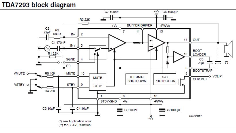

5) The datasheet calls for a single 1000uF in parallel with the 100nF.
Since we're not using the amp in quad rail form, then in this simpler form, some of the energy to power the speaker will come out of the decouplers. When this is done, it works for harmonic support and should not be sized large enough to power midbass fundamentals--we don't want the shields dropped very far down and we don't want an overlong timer delay to outwait before proper function returns.

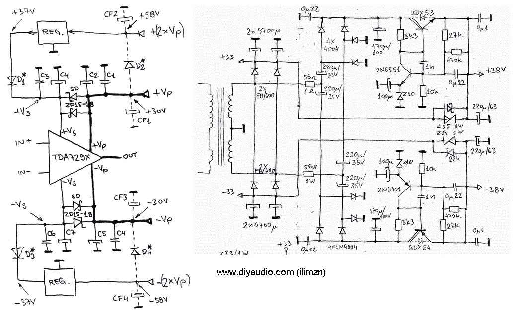

Quad rail:
Connect a high efficiency shottky clipper, such as inversely parallel pair of MBR745, between pins 8 and 15 to prevent explode. The diodes must be considerably more efficient than the parasitic capacitance inside the chip, else it will crack the substrate and burst into flames. It is only after you've bypassed that problem that you can play with quad rail power.
Next, then you can see that the 220u caps go on pins 7 and 8 and then the 1000u caps go on pins 13 and 15.
That's where the 1000u caps go, and if you don't have quad rail power, then likewise you don't need any 1000u caps for this amp.
See also Ilimzn's materials at post#58 and elsewhere, including here:
320317d1356838465-optimizing-tda7294-output-tda7294_ilimzn.png]Quad Rail
For when you've got different rail voltages, Ilimzn has shown the schottky+zener protector for the chip substrate.

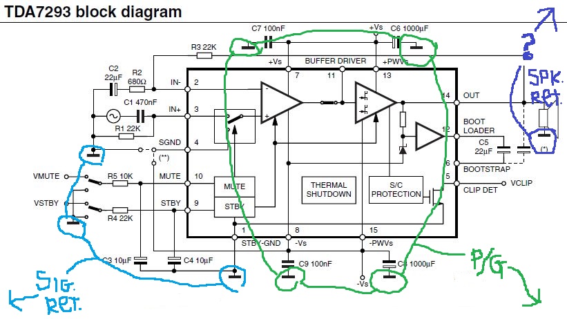

Hi Daniel, I'm not ready to go to quad-rails quite yet. I'm all for simplicity as shown in your Higher-fidelity, lower voltage / Lower gain configuration. Dual 220's or 270s are fine with me. I'm even less likely to run out of gas with narrow-band amps, right?
I'm currently researching grounding schemes for amp boards. There is a lot of information, much of it is confusing. I get the basic idea that signal and power should be separate. But, don't they all lead to the same place eventually? How do we keep one ground from picking up noise from other grounds? (hope I can find some nuggets in Bob Cordell's book arriving tomorrow)
I've attached an interpretation of the datasheet schematic grounding scheme...Lt-Blue on the left side is Small-signal return AC, the 4 center Green nodes should all return to the high-current 0-voltage DC power ground, Dark Blue on the right is amplified AC signal return. The grounding is similar to other TDA7293 schematics I've seen. Any suggestions from the membership to minimize signal contamination?
Thanks - Sixto.

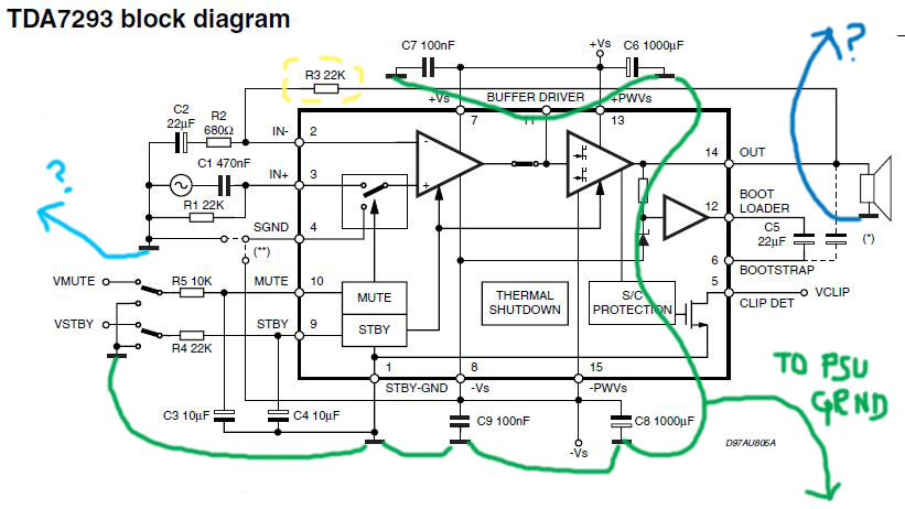

Hi Mark,
I've revised the datasheet grounding (attached) per your recommendation. Still have questions about what to do for grounding the Small Signal Return and Amplified Signal Return.
I highlighted R3 to address your second comment, I may have inadvertently erased part of the datasheet on the previous attachment, but there was no intent on my part to change the location of that resistor (still between pins 2 and 14) I am planning to use Daniel's 33K recommendation, though.
Thanks! - Sixto
