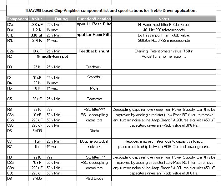

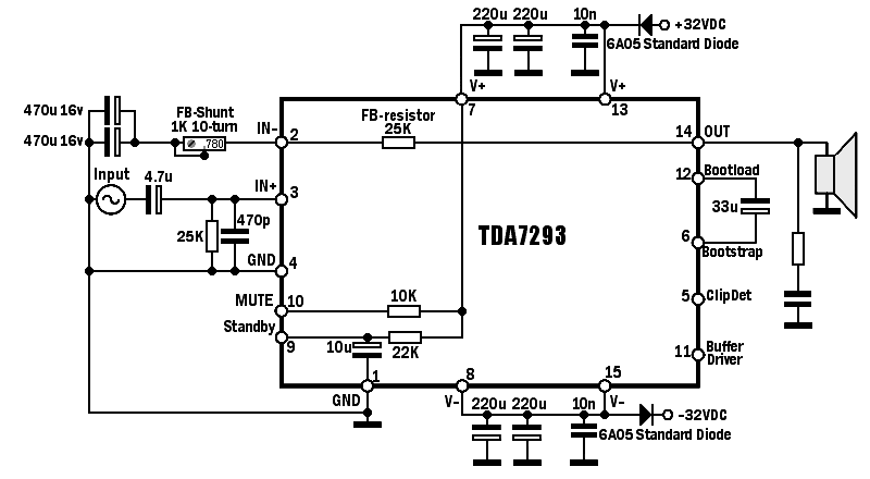

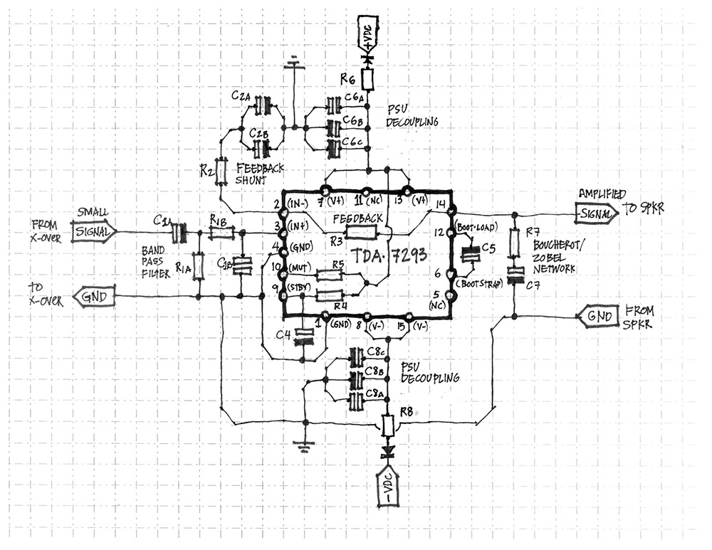

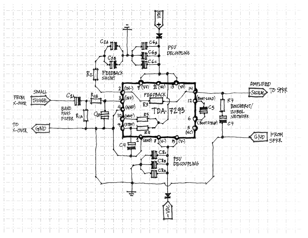

So here are two sketches - (variation on one of your schematics) One shows just the Diode, the other one shows a Diode plus a Resistor.
I'll follow this up with some BOMS that spell out where I am changing component values from one-amp to another to fine-tune frequencies to each driver.
Cheers! - Sixto

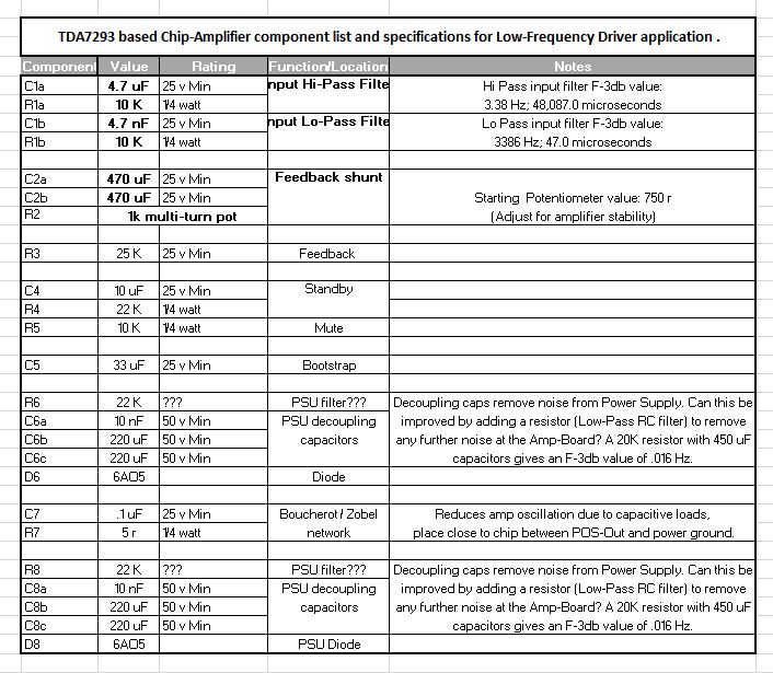

Here they are, preliminary values for each of the 3 amps: Low, Mid, High frequency. I've noted in bold the values that change from amp to amp, and their corresponding filter values (where I could calculate it)
I did not provide filter values for the FB-shunt because I could not figure out why when I try to calculate 1/2PiRC for even the Low-Freq amp (970 uF Fb-shunt, 730 r for multi-turn Pot) I get results like .22 Hz which seems too low, and would go even lower if I added-in the FB resistor value. Instead I simply reduced the capacitance of the Mid and Treble amps by the same ratio that the input filters are reduced. (using the lowest frequency of the bandpass range)
Curious to hear back what you all think. At this point, unless there are some glaring mistakes - I may just go ahead and start building and testing to see if I can hear the differences when I use different components. It will take time. (maybe by year-end?)
Thanks for all the advice so far, keep it coming! and remember I am such a newbie at this that it may take a few tries before things sink-in.

It isn't good news. The power circuit has wrong size parts (overheat and ringing result), the bootstrap is slightly undersize with slightly increased chance of explode (correct size is 33u but they substituted a more convenient 22u), the rf filtering is lacking (what? was there an ink shortage?), the gain is low enough to get the amp a little nervous at the published voltage (if you had wanted to drive a speaker, that is), and the unnecessarily complicated mute circuit takes up so much space that the majority of board layouts position the decoupling ineffectively farther away from the chip. It is a lot of elementary errors, but the sum of that, is high risk of disaster. A lot of these chips do burn up because of following a generic schematic.
I worked hard on my TDA7293 schematic, to stay as close as possible to reasonable looking. Philfr worked hard on his LM3886 schematic, which is also reasonable looking, and quite similar. A considerable amount of your input went into both (in the form of goals to try for).
Both of these will, confidently, beat the datasheet generic schematic.

I did take a look at the datasheet for the 6A05, and it specifies "Low Voltage Drop", so I'm having a hard time figuring out how the diode which I thought was primarily a check-valve, is now functioning as a resistor (which also varies with temperature).
Check valve function, and the "R" for a CRC, are both true. Remember that my amplifier is made with capacity for excellent bass power. Therefore the diode used for series element is a high current, low voltage, sort with the current versus voltage drop graph in the datasheet looking much like a straight up wall, and the minimal voltage variance is necessary for minimized sag--It covers a wide current range far more suitably than a resistor could do.
It would be far too much work to change to a different resistor value for each different position of the volume knob.
Also, an actual resistor would eat your bass power by promoting sag; however, this difference is not relevant to a low current tweeter-only amp.
These series elements are positioned at the edge of the amplifier board, in which locale, cannot hinder the charge-up of the power supply reservoir.
The approach can be enhanced by applying various means of RF blocking (RC's, 3u polyester cap at rail to rail, or FB43 ferrites) at the spot where the DC umbilical cable has contacted the series diodes. That is probably also true of low current applications that have used resistors instead of the diodes shown. That is a great place to add additional RF filtering.
The diode works like a variable resistor. At low current the resistance is high and at high current the resistance is low. This has a lower power and voltage loss compared to simple resistor.
You could also try placing a resistor parallel with the diode.
For a 100W into 8ohms Power Amplifier the R value could be around 0r1 to 0r2
For the front end of that same amplifier, the R could be around 20r to 40r
For a preamp, or crossover and similar use a value for R of 10r to 200r depending on the Vdrop acceptable and the current draw of the device.
I posted a half crossover with rCRCRC where the two R values were 165r to drop the main supply down to suit the jFET stage.
Feedback for low frequency driver/amplifier.
R1b is high, too much noise?
C6a & 8a seem very small.
Is that a datasheet recommended value?
I would (if the datasheet allows) fit 100nF to 220nF on the power pins and link them together with the shortest possible leads.
C6b,c &8b,c don't need to be split. Link this junction the the junction above. This is your Power Ground.
Just fit the biggest you can get fairly close to the chip, anywhere from 470uF to 1m5F
D6 and D8 serve no useful purpose as shown. They just drop useful voltage. The dynamic impedance of a diode is too low to make a useful high pass filter.
Change them to 1N4002, or higher and place them to link the output rail to the supply rails.
Add two more to link across the decoupling capacitors.
The Zobel does not help with capacitive loads. it is a high frequency load seen by the amplifier to help control gain at HF and thereby improve the stability margins.
If you want to add capacitive load tolerance you need to add an L||R between the output and the Speaker. Typically 1uH||10r but that 1uH is for a wideband amplifier passing upto 90kHz to the load. For mid, or bass duty it could be made higher value.
If the crossover is screened and the power amp is screened then external interference can't get in.
If all your signal connecting pairs are twisted then these limit internal interference . On that basis you may not need any input filters between the cross over and the power amp.
I don't know which of the chipamp ground pins is clean, or dirty.
I don't like the haphazard linking of all the signals to these unknown gnd pins.
I would separate the input signal (it is not GND, it is a two wire connection consisting of Signal Flow and Signal Return), from them completely and invoke HBRR. (IN-) and (IN+) are the signal input pins.
If you are wiring up as a non inverting amplifier then Signal Flow connects to (IN+) and Signal Return to (IN-) This is your arrangement. For inverting you would swap.
The NFB lower leg MUST connect to Signal Return, definitely NOT to the decoupling. Note that the internal upper leg NFB is already connected to (IN-).
