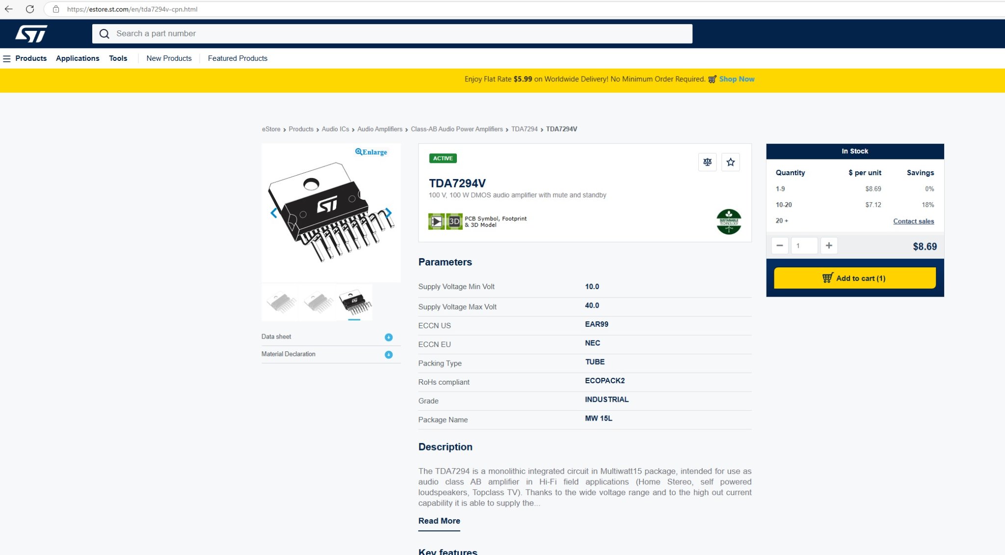

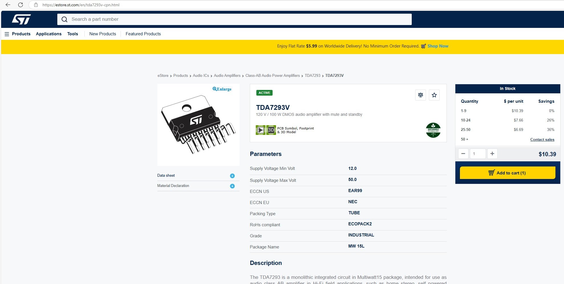

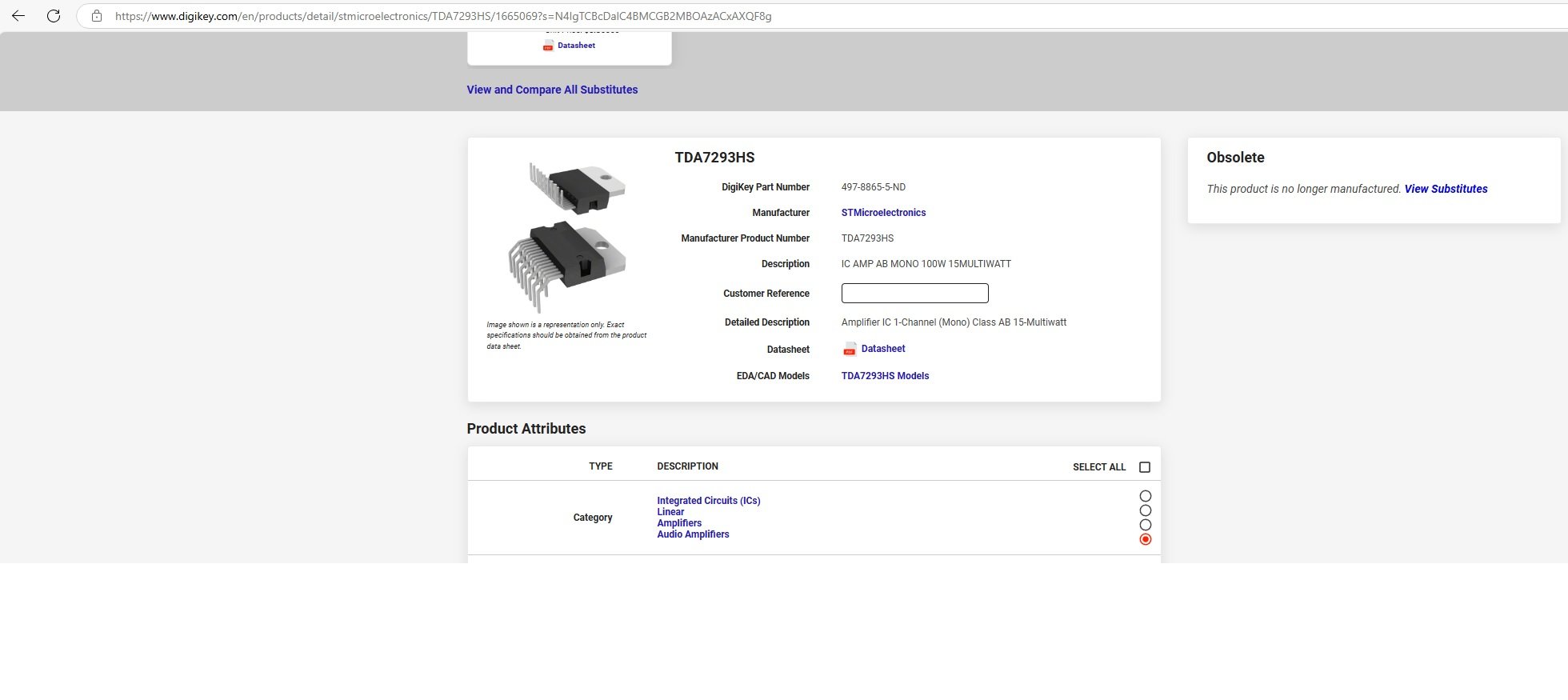

"Only one is still in production."
That is not accurate, as we speak, both of the tda7293 and 7294 are very much active and available to purchase at most of the trusted distributors including direct purchase from ST.com .
The only discontinued TDA7293 is the TDA7293Hs.

Yes, Mouser has them both in India, single units in the $10 price range, when I checked on the ST site last year one was not even listed.
Bear in mind they check your location and tell you what is available for you.
