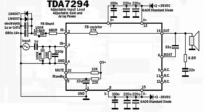

Well, amplifiers can sound different from one another; however, the adjustable schematic at the bottom of post#474 can be set for system symmetry or you could dial it in to imitate a different amplifier if you wanted to.
The parallel amp can use a larger input cap and should use a larger bootstrap cap; but otherwise, the solo and parallel (master chip) can use that same schematic.

On the second part of your post, most chip amplifiers show exactly the same 22k vs 1k or 22k vs 680R with some odd random caps for generic datasheet schematic. . . despite the fact that the chips differ in internal design. Be careful! That sort of generic schematic is for showing where the parts should go. But the component values are nonspecific/generic, and that may cause overheat, sound like a caffeinated Basset Hound, install a severe bass blocker, cause audible distortion or even cause breakage. I would not be able to explain this thoroughly, since I'm not an engineer, so here's Eddie on the topic of changing the generic schematic to something more specific that supports the chips:
Solo amp bootstrap cap range is 33u~47u.
Parallel amp bootstrap cap range is 68u~100u.
See also AndrewT's posts on the topic of NFB-Shunt cap sizing for clear quality bass.

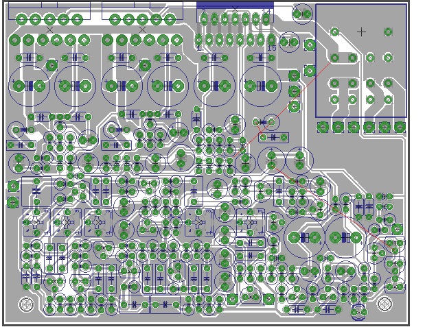

What you say about this design?

nice !!! I like the elco arrangement, very neat !

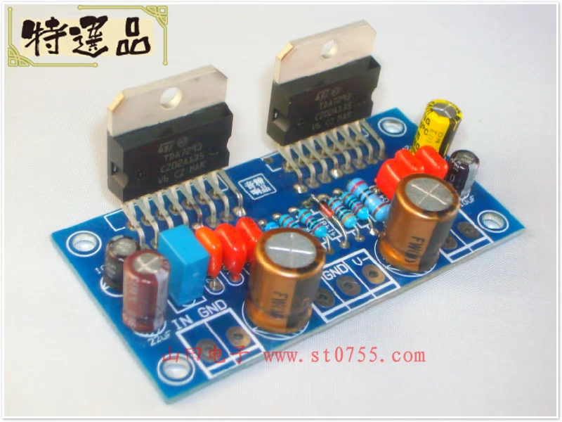

Favorite new style design: 2pack TDA7293 Parallel 170W Mono Amplifier Board Kits 29 | eBay
With the two pack of compact dual-layer boards in the link (ebay# 190862927141), it is possible to do higher quality builds like a pair of monoblocs, or dual-mono or virtual dual-mono with regs or virtual dual-mono with diodes.
And, when upgraded to fine tuned values, it can do very low heat output and good system symmetry.

Either of those parallel boards could use this schematic, except that the 3-chip model would have a 100uF bootstrap cap.
