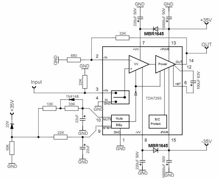

First of all, the TDA7294S Datasheet (all 15 pins work, like TDA7293): http://www.startfetch.com/fidelityforce/datasheet/tda7294s.pdf
And next, in the the attachment, that TDA729X "Hi Fi" schematic that has been floating around the internet for some years. That thing was prone to explode so I have edited it to replace the BY diodes with more efficient MBR diodes to decrease explosions.
I didn't design this one!
It looks somewhat impractical and may produce speaker burning offset. Also 50x is beyond the 43x maximum, so the gain divider is serving up a catch function rather than helping resolution. That doesn't look appropriate, but it may produce interesting tone effects.
Now the good part:
The power circuit is worth a closer look . . . in the attachment. This MBR schottky diode bypass can allow playing with separate rails, without cracking the chip's substrate.

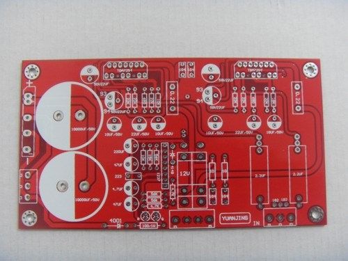

I recently bought a TDA 7294 board from Ebay for $6/- + shipping. The TDA7294 chip was bought locally. All parts were bought locally. Even the difficult to find uPC1237 protection chip was bought locally. I was concerned about the relay as the local one had 8 terminals. I just had to snip out the extra pins and everything works well. Great sound ! It's not the best you can get but it IS good sound. HF is not silky smooth , but on good recordings it sounds surprisingly good. No lack at the extremes also. As always a good input cap plays a big role. If the preamp or DAC output already has a blocking cap then don't use any input cap.
1pc TDA7294 TDA7293 Amplifier Amp DIY Board PCB | eBay
Note that only the transformer is off board ! It's a great kit.
