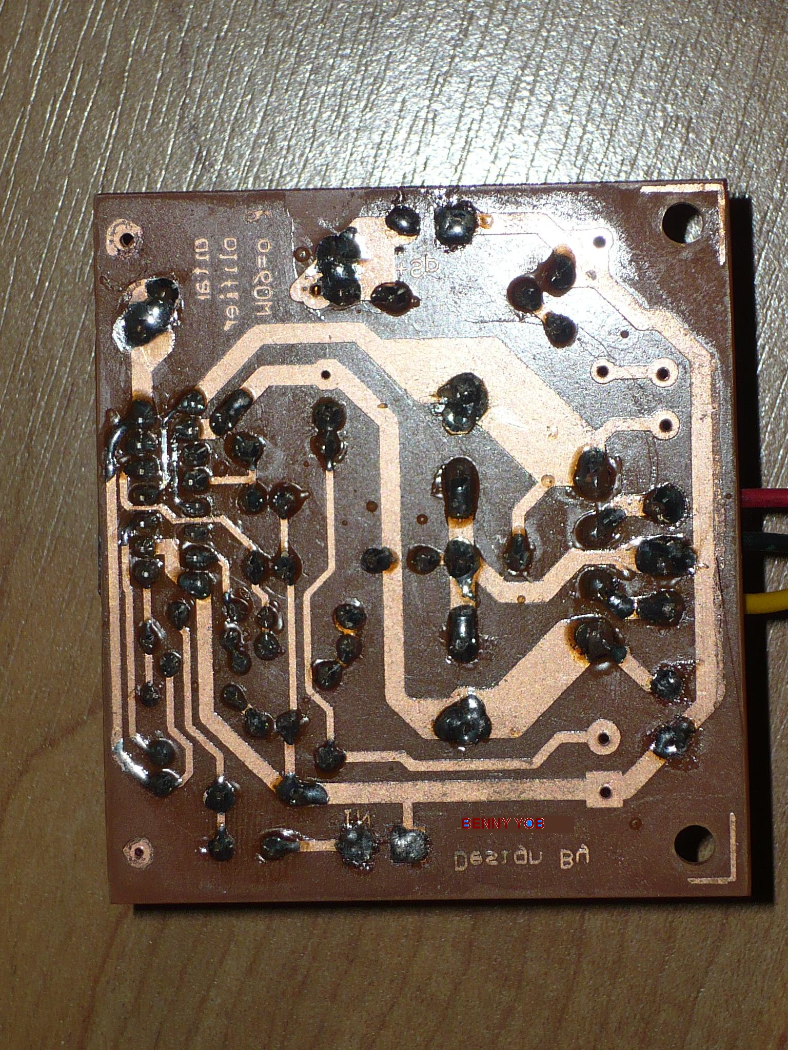

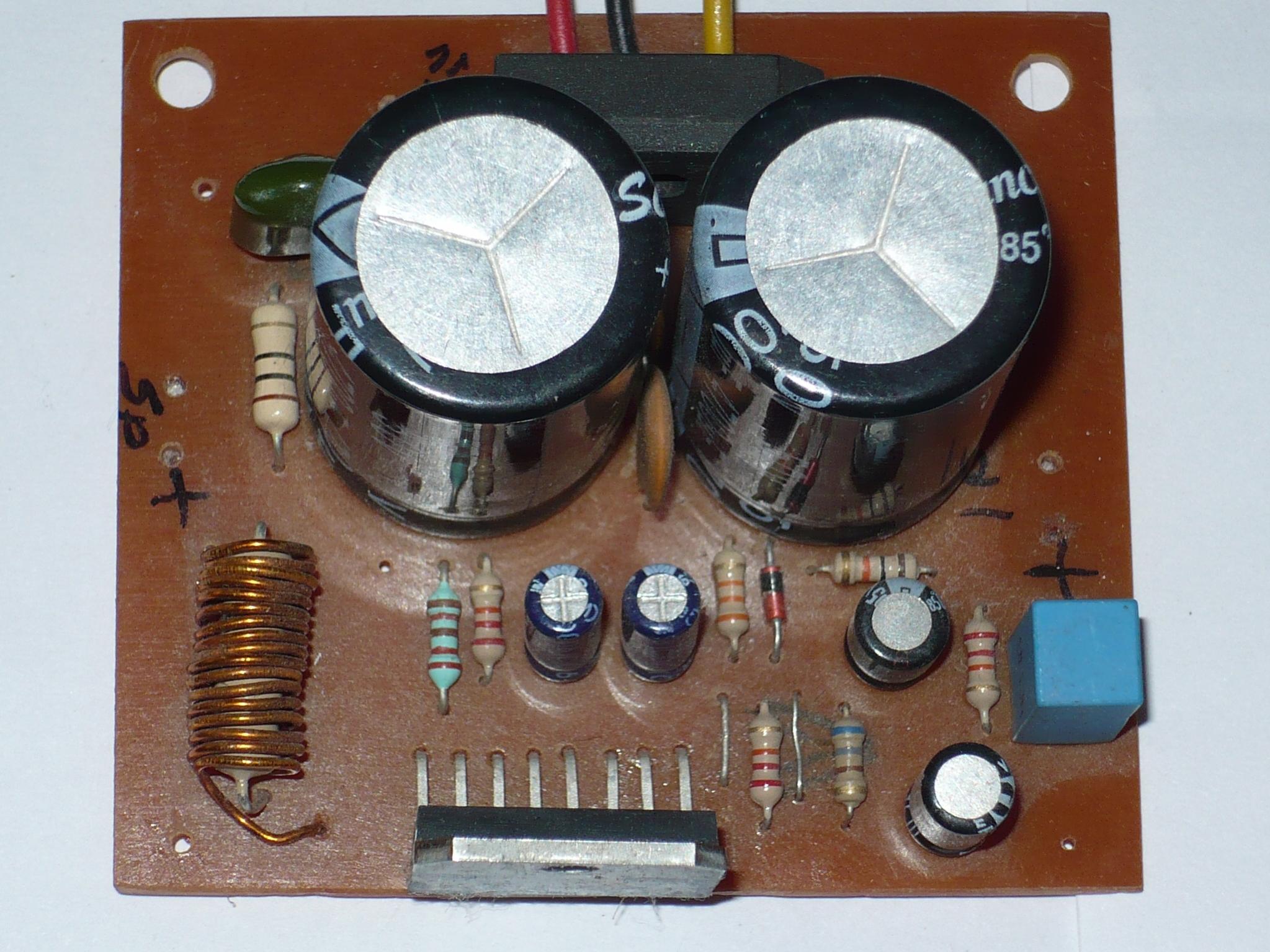

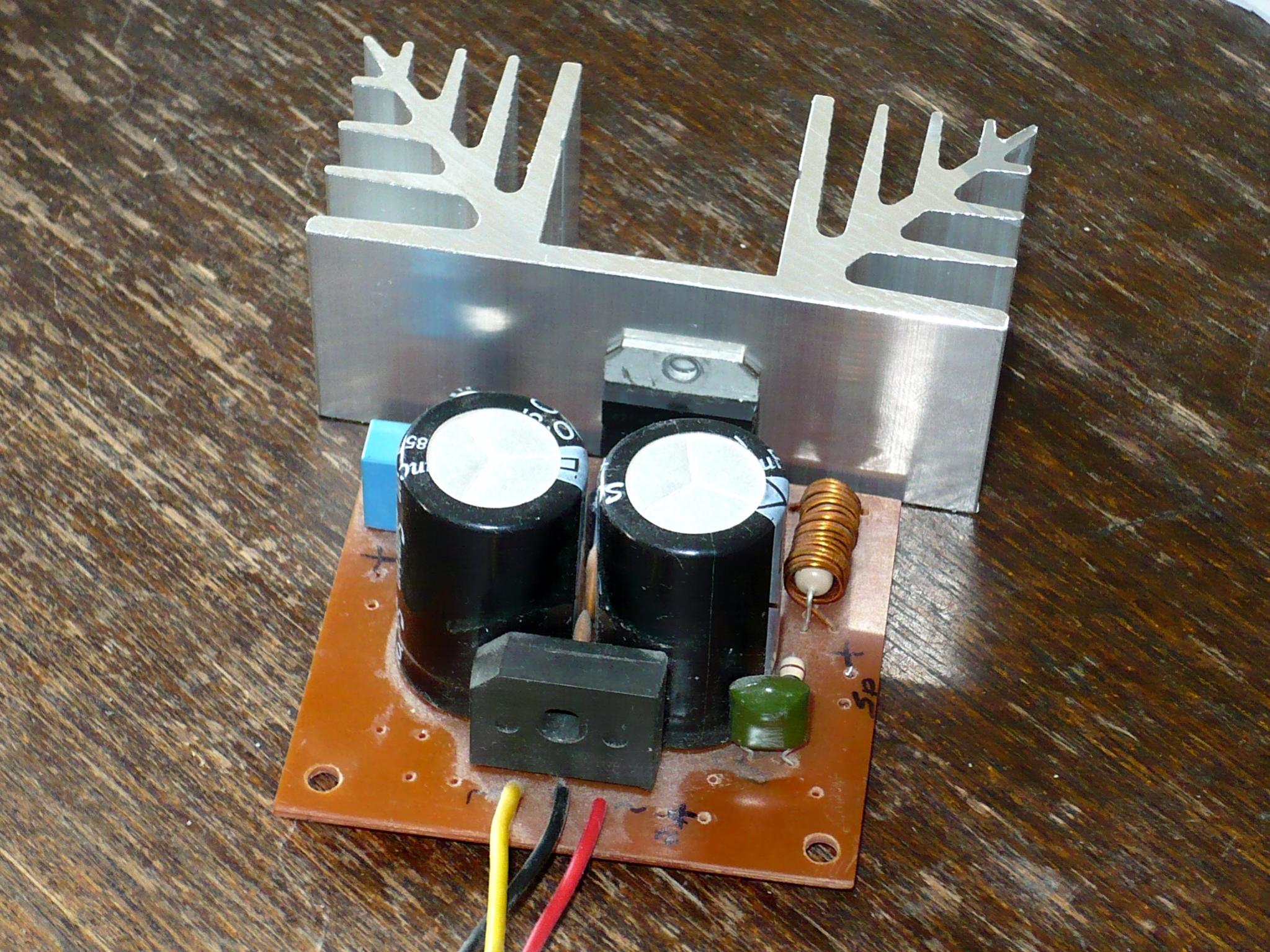

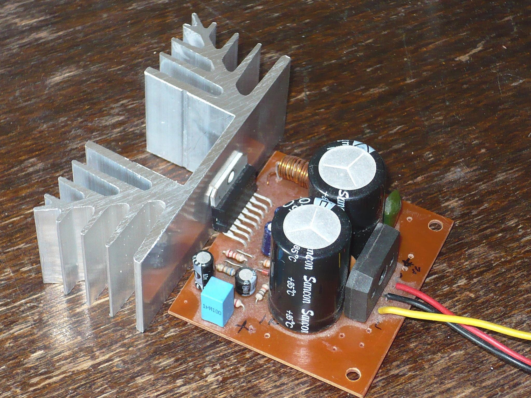

AComplete audio amplifier with TDA7294
Hi guys!
Here I've made audio amplifier with TDA7294 and it works great!
This amplifier is complete with power supply!😉
Greaz of 8A and 600V
2 electrolyte of 4700uf/50V.
I enjoy the sound!!
cheers!

Very interesting! That's Surprisingly compact for single layer! Do you have PCB layout photos for it?
PCB layot is in Protel 98😉Very interesting! That's Surprisingly compact for single layer! Do you have PCB layout photos for it?
Can you open it and then hit printscreen, paste into photo editor, and then make screenshot photos of the layout?PCB layot is in Protel 98😉

Rear of PCB,...PCB-top,...Can you open it and then hit printscreen, paste into photo editor, and then make screenshot photos of the layout?
4700mf capacitor is not at all enough for this chip amp. minimum is 10000mfd.considering the output mosfets.
a short length of cable from power supply to amp board acts like choke filter which I always found healthy in all my amps,which means I will keep the Ac diodes far away from chip.
what I mean is, one should try connecting the scope to power lines and see with music on.
