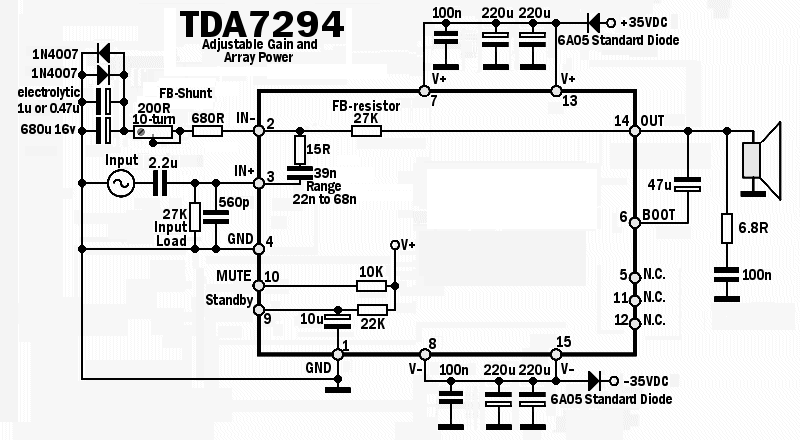

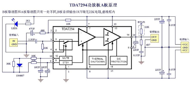

Adjustable gain
The attached schematic shows adjustable gain for precise audio quality control.
Materials:
A 200 ohm 10-turn trimmer (the little blue box with screw on top), which we're going to employ as a variable resistor; and, you might like to have a range of caps to try out for supplementary compensation, 22n, 33n, 39n, 47n, 68n.
Function/benefit:
These materials will let you adjust the amp gain and speed all over the place, and you can adjust the speed separately from the gain. Simply dial it in for the best audio quality. That dial is shown on the schematic attached.
Notes:
At my house, I'd be using a 100 ohm multi-turn trimmer; however, I've put the 200 ohm multi-turn trimmer on the schematic to accommodate people who want to install lower gain. On audio quality, the amplifier will no doubt inform you of the setting it wants, and the trimmer is far more precise than fixed value resistor guesswork, and so you're a LOT more likely to get good results with the trimmer. Even more importantly, need of compensation and also the ideal gain setting varies by operating voltage and load, so I think that the trimmer dial should be mandatory for optimal audio quality. Function of the trimmer is adjustable gain, but benefit is "audio quality dial." I'm sure that we should use it.
I have two final questions before ordering the last of the parts.
1) Is the 2.2uf cap on the input a non-polarized electrolytic such as I use for speaker crossover work
2) Is the resistor in parallel with the speaker output 6.8ohm or 6.8kohm. I feel it is the latter but want to be sure. Or should this value be varied depending upon the impedance of the speaker
You can use the output RC that comes with the kit. No need to buy more. The value can be varied somewhat, depending on need. Most reasonable values outperform omission by far.
The input cap can be 1uF, 1.47uF or 2.2uF, so I suggest to collect some of the little green Bipolar Nichicon ES series, in sizes, 0.47u, 1u, and 2.2uF to test drive and find out which you like. They're very high resolution performers at low cost.
For input cap there exists other charming options, such as an Elna Cerafine in parallel with a tiny value polyester.
I've used the 0.47uF little green Nichicon ES bipolar electrolytic in parallel with my NFB-shunt cap for enhanced clarity. It is generally trouble-free for use as a bypass cap. A really ordinary 1uF electrolytic cap *may* do a similar job for bypass tasks.
Ah, but don't forget to get multi-turn cerment trimmers (little blue box) in either 100R or 200R value. In three days of soldering effort with resistors, the best performance was from the schematic that shows the trimmer.

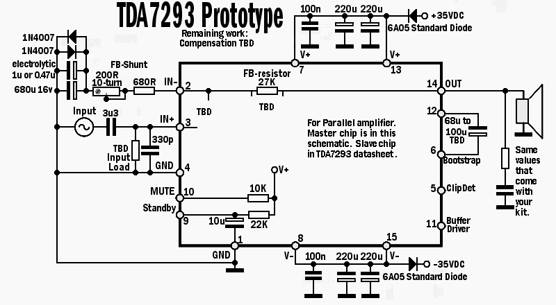

So far, progress on the TDA7293 Parallel amp. . .
It works without supplementary compensation added; however, I'll be trying out some new compensation from Keantoken to see about the resolution and imaging possibilities.
Consider the attached schematic a work in progress as it is not quite finalized. Without using supplementary compensation, it is stabilized by gain and it sounds best stable. It does play rather nicely. A 100R or 200R cerment trimmer (little blue box) is good and with no "wrong" setting, just dial it in for pretty audio (and definitely not an arbitrary gain setting). Suggested trimmer startup value is exactly 50 ohms (if your power board is driven from a 25+25vac transformer like mine and if your speaker is 8 ohms like mine).
Input load is marked "TBD" and plausible range of input load is from 12K to 27K whereby the 12K is more forwards or the 27K is more laid back, so adjust within that range as you like. The plan of adding compensation should broaden the range of the "sweet spot" and make the amplifier easier to adjust and use, and I'm working on that.
This is the one I'm using to refit my receiver, and since the receiver's power circuit is slightly different, including voltage, I'll definitely be needing the trimmer to dial in for audio quality.

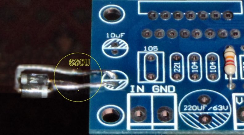

I'm doing up some build photos like these:
How to relocate the feedback resistor and the feedback shunt resistors
348298d1368403830-tda7293-parallel-kit-ebay-modular-slave-style-no-lossy-emitter-resistors-tda7293-parallel-resistors.jpg
How to fit a large size nfb-shunt cap and antiparallel 1N4007's.
If a 680u is unavailable, a pair of 330u or trio of 220u will fit for 660u.
Not shown: treble bypass, 1u or 0.47u electrolytic, fits under-board
348696d1368566875-tda7293-parallel-kit-ebay-modular-slave-style-no-lossy-emitter-resistors-tda7293-nfbs-antiparallel-047.jpg

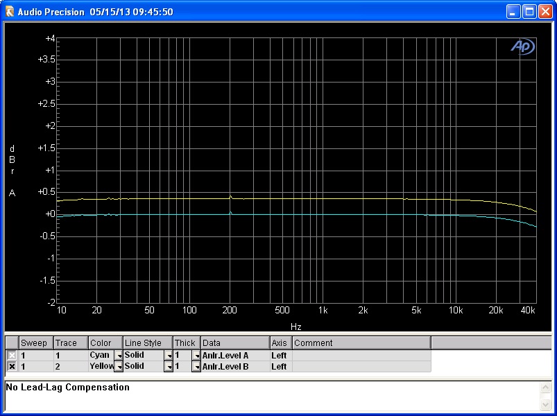

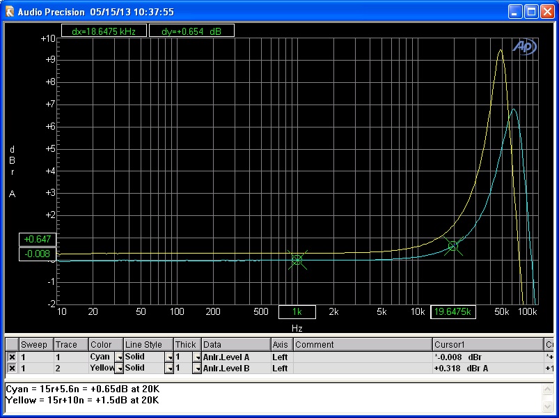

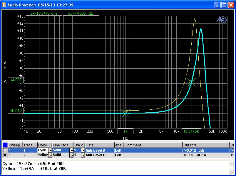

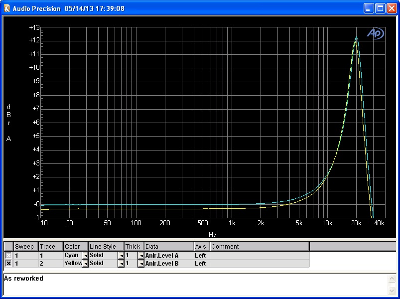

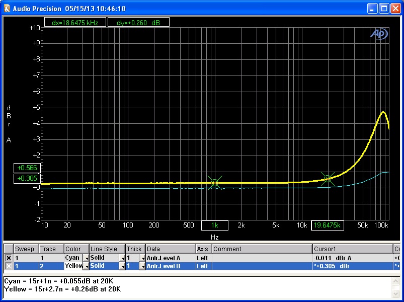

Guys - just FYI. I built in Daniel's circuit on top of my AudioSource AMP-100. Essentially, this is a mono TDA7294 for each side. I want to thank you guys for all the hard work that's being done.
I did want to report back, though, that the "lead lag compensation" circuit is a really bad idea. I took a frequency response curve of the amp and there's a ~+10dB boost at around 20KHz with this circuit in place. No, that's not a typo. Basically this circuit seems to be creating an over-damped filter, and the ringing occurs smack dab in the treble region.
FWIW - I had used a 15 ohm + 68nF.
When I removed this circuit, the FR curve went back flat. I'll post pictures tomorrow when I get back to work and have access to my AP again.
I did verify that the issue is in the amp circuit only. None of the other preamp circuits on the AUDIOSOURCE are presenting the same boost. So, the issue is wholly with the amp.
I would recommend that someone else try this test - it's pretty easy.
With the desired circuit in place, play a 997Hz sine wave. Measure the output from your source and also measure the output from the amp. Then play a 19000Hz sine wave. Again, measure the output from the source and measure the output from the amp.
Essentially, you should see no differences whatsoever in the RMS voltage level for either measurement. If the level is changing coming out of your source, then your source (like a computer) likely has some processing applied. Find a different source, or remove the processing. If the level is changing out of the amp, then something is wrong with the circuit of the amp. This latter case is what I discovered.
Again, I'll post back tomorrow...
OK - So here's the data requested. Again, I'm doing this on an AudioSource AMP-100, which is essentially the same as a mono TDA7294 per channel. I've verified that none of the preamp circuits in the amplifier are affecting the signal, so these frequency response graphs are wholly the responsibility of the TDA7294 circuitry chosen.
My circuit matches Daniel's last one posted (on page 43 or 44 I think) with the exception of the fact that I used a 1000uF NFB capacitor instead of a 680uF, and I used a single 732-ohm feedback shunt resistor instead of a 510+220 solution.
Personally, I would remove the lead-lag compensation all together. It is creating an over-damped low-pass filter with significant ringing. I cannot fathom why this circuit would aid the chip in any way. The only reason I can contemplate is if your power supply is extremely noisy and tanking the out-of-band noise is providing some benefit.
However, the power supply on my Audiosource AMP-100 is pretty decent, and the ones being designed by Bob and others are far superior to that. So - again, I say remove it, but you guys can make your own decision. If you want to leave it, I would recommend NO MORE than 4.7nF.
Here is the picture of the 15R + 68nF.
attachment.php
Here is one channel with 47nF and the other with 27nF.
attachment.php
Here is 10nF and 5.6nF. It shows roughly +12dB at 20KHz:
attachment.php
Here is 2.7nF and 1nF:
attachment.php
Finally - here is NO lead lag compensation:
attachment.php
