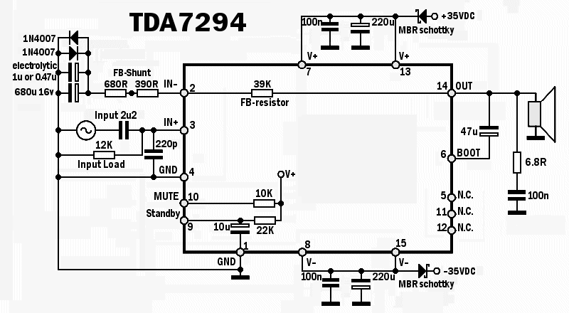

That's a lot too strong. And like every good compensation, needs more compensation added. Howabout an alternative?
pin2 to feedback-shunt resistor to resistor paralleled with tiny cap, to nfb-shunt cap
Is that a bit more tame?

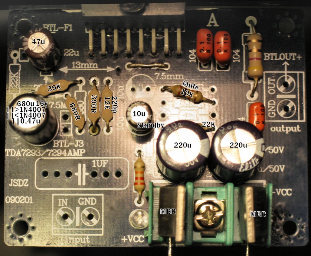

With the settings that worked for the Parallel board (27k vs 730R) the Solo board exhibited front end overcurrent symptoms, treble droop and a midbass blur. Of course, the front end or predrive section of the Solo chip is working harder because of much less output current buffer.
Current compensation:
So I tried 47k vs 1.270k for the solo board, in an attempt to resolve the current discrepancy. This is meritorious for tone and sounds similar to the parallel board for mids and treble. However, the solo board plays with the same good bass. . . until you turn it up and the bass goes missing. Is it the on-chip limiter or is it undercurrent from somewhere else?
Still working on the solo:
I need to find the bass. Possibilities include, average of the above two settings, array at the power circuit, bootstrap cap, shield section piece added to the power circuit, separate the front end power, or my chip might be a re-mark, or perhaps it is working normally. I do not know yet. Still exploring.
Eddie's approach really did resolve the bass and tone issues and it provided interesting imaging; however, it also requires additional compensation for which I don't have the skills or tools.

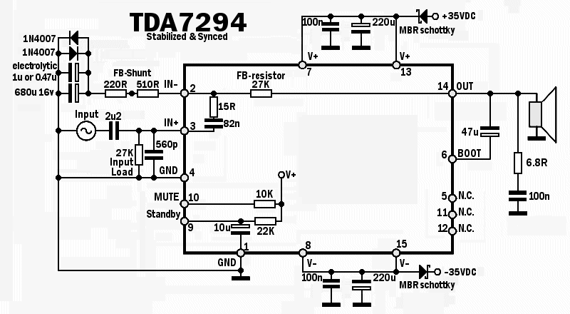

Schematic, and some options.

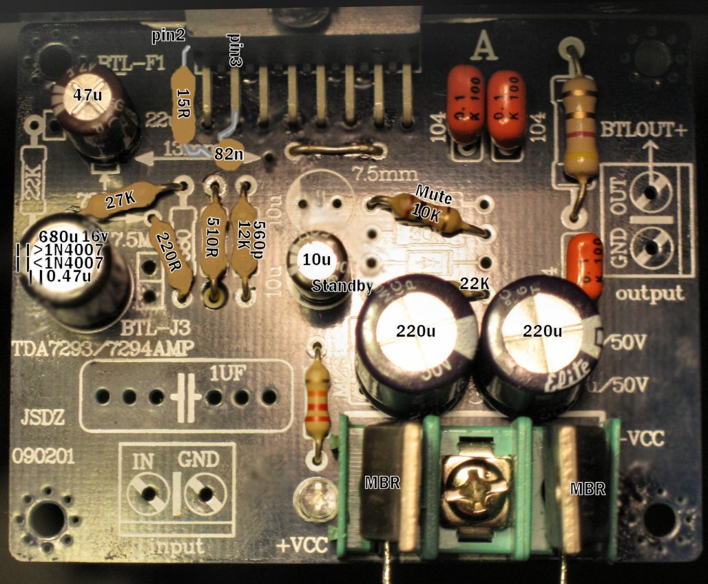

I'm probably about to "go on break" for a short time (test stuff not at same local as enough parts), so here is the TDA7294 at an even balance setting.
And here's what the board looks like with the components on it.
Of course, you could get better results by subtracting the sound of the board like this: Relocate the 39K feedback resistor directly onto the chip, pin14, pin2, and then also relocate feedback-shunt resistor(s), bottom side of the board, in a direct line from pin2 to NFB-Shunt Cap. It fits easily.
The input load of 12k shown is for direct drive from computer, but you can change it anywhere in the range of 10k to 33k, and the factory equipped 22k is the average anyway.
At 35+35vdc rails, the amplifier has a gain range of 37.5X to 42X. However, if using lower voltage, you may be able to set it for lower gain--do set it low enough for good bass but don't set it low enough for treble droop. That's easier at lower voltage which makes available a greater variety of settings that work.
At feedback-Shunt, Instead of 680R resistor series to 390R resistor for trim, you might really like to replace that with resistor series to trimmer for adjustable gain fine tuning, like this: 1k resistor series to 200 ohm multi-turn trimmer/potentiometer (center pin of trimmer soldered to one of the outboard pins of the trimmer creates a variable resistor).
That will let you dial the gain from 33.5x to 40x, so just dial the gain as low as you can without causing treble droop and you've got it. Just glue the 200 ohm trimmer, under board, right next to the NFB-Shunt cap (and connect to cap+), and then reach the 1k resistor from trimmer to pin2.
Don't worry about the multi-turn trimmer's affect on quality; those are composite material. Now, your FB-Shunt resistor is variable; and, I highly recommend an adjustable gain upgrade because your operating voltage, personal preferences and speaker load might be different from mine.

Or would you rather have a stable amplifier? Stable sounds better to me.
Thanks to Kean who spent a long time teaching me about compensations. I've been working on this all day long, and now you have much better sounding and much more powerful amplifier. They run better when stable.
That little RC (15R+82n shown from pin2 to pin3) will do more for your sound quality than any amount of audiophile caps. It takes a bit of precision to do lead lag comp with a chip amp, so if you change anything, you may also have to change the 82n to a value slightly lower or higher. When you purchase this cap, I suggest to also purchase options of a 100n in case you set the gain slightly lower and a 68n in case you set the gain slightly higher. For reference, I used 25+25vac 8 ampere transformer and an 8 ohm speaker, and this amp has been synchronized for high dynamic power. Input load does make a small tonal difference; so, depending on your source, you might rather have a 12k or 22k or 27k input load resistor for the amp.
The actual test sample has the feedback shunt resistors underneath the board from pin2 to NFB-shunt cap, and the feedback resistor is directly on the chip from pin2 to pin14, and thus no "board sound" at all. However, now that the amp is stable it is also less sensitive to layout differences.

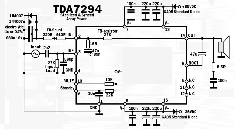

Array power and prettier sound.
Packing my suitcase, rounding up the critters and heading to the farm today, Before I go, I thought I'd try bracing up the front end shield with a simplified array in order to dial back the compensation for a faster speed. Arrays are good in theory, but making them work usually involves active devices for series elements. This was astonishingly easy. . .
Cleaner
I changed the MBR schottky to ordinary old 6A05's from the radio shack. No need for the terminal block. These diodes plug right in to the V+ and V- pads of the amplifier board. V+ diode's stripe touches the board. V- diode points away from the board. DC cable connects to these. 0v is connected direct to the board's 0v pad normally. Now we can add more reservoir aboard for more clean power like this:
Stronger
Under the board, I soldered an additional set of 220uF capacitors. Now the power circuit has 220u||220u (low loss quick 440u) per each rail. That's your array power and it looks like: A set of 220u capacitors on top of the board AND again on the bottom of the board (high quality 440u per each rail). The diodes have allowed array power to work quickly, and likewise, regulators (optional) should work as well.
Faster
With the stronger shield providing better dampening (darn that single layer board!!), enough ringing has been removed, that now we can set the cruise control to higher speed--change the 82n lead lag cap to 47n (you can test drive 39n for treble difference). Wow, much less compensation needed.

Here's the corrected and stabilized schematic for the single layer Jim's Audio TDA7294 kit.
