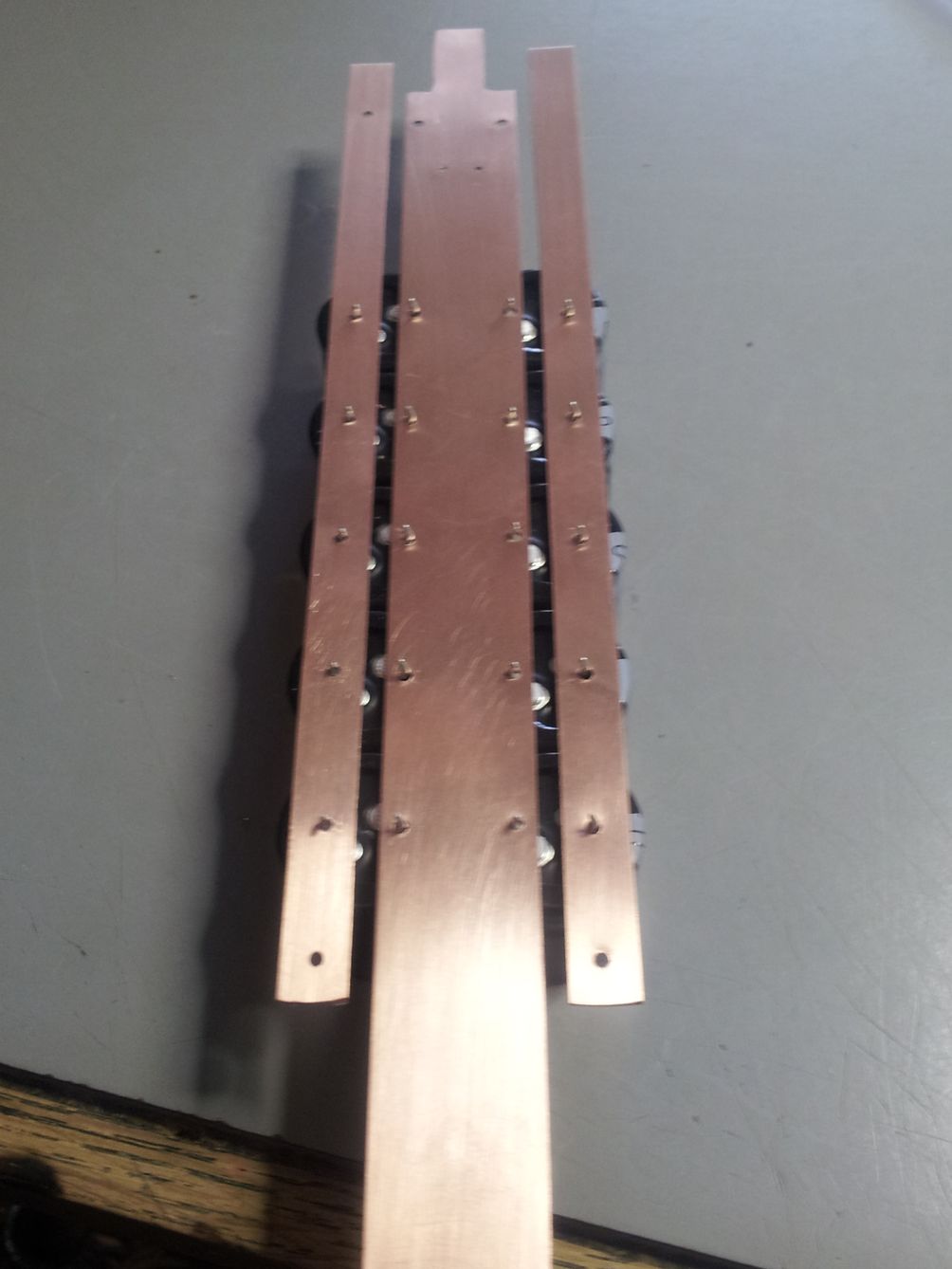

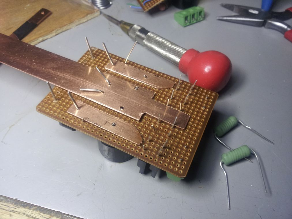

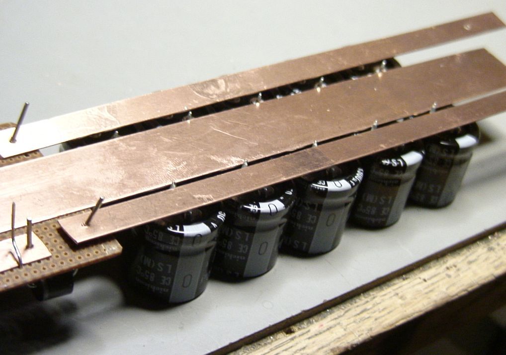

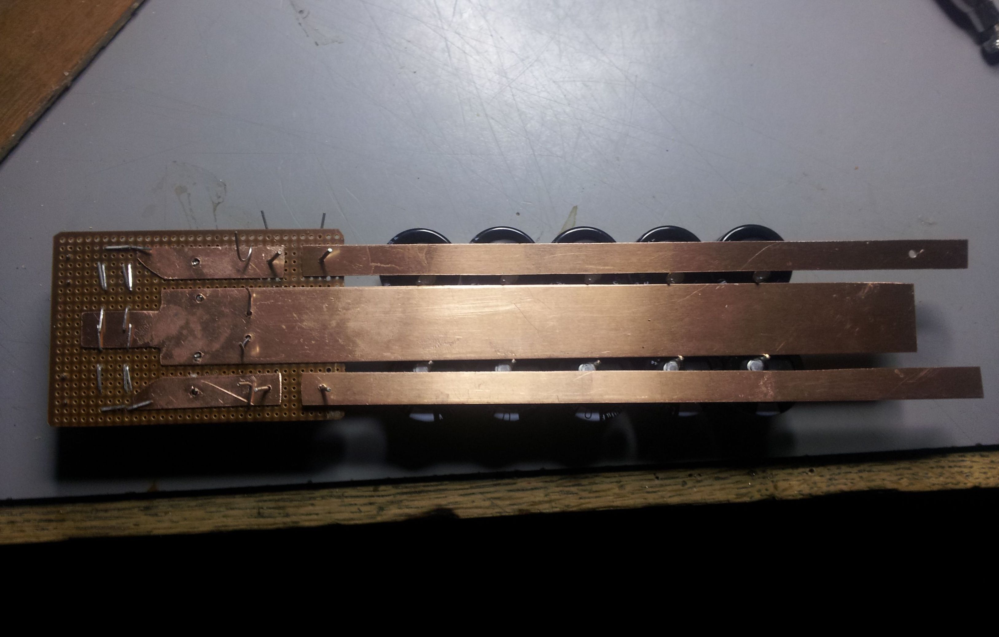

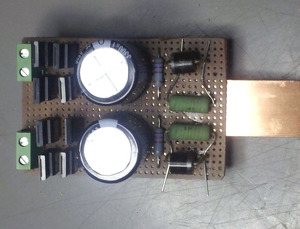

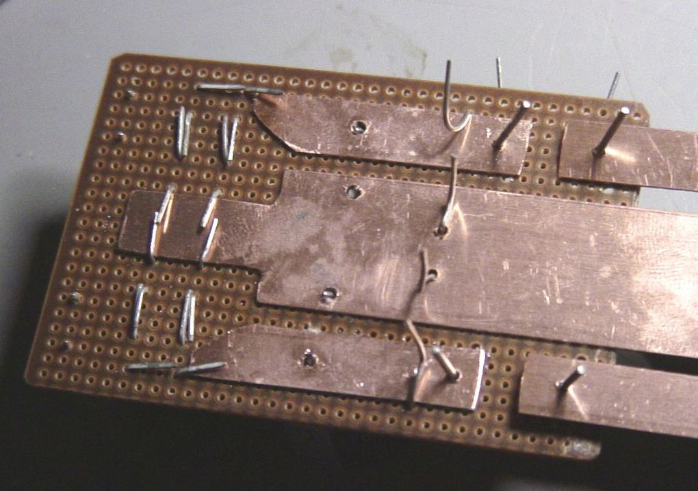

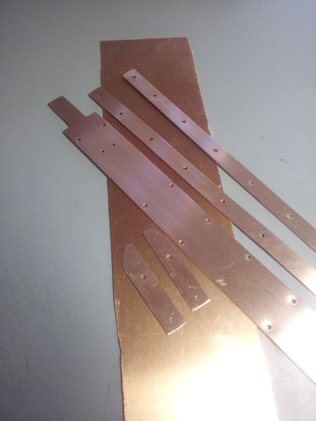

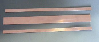

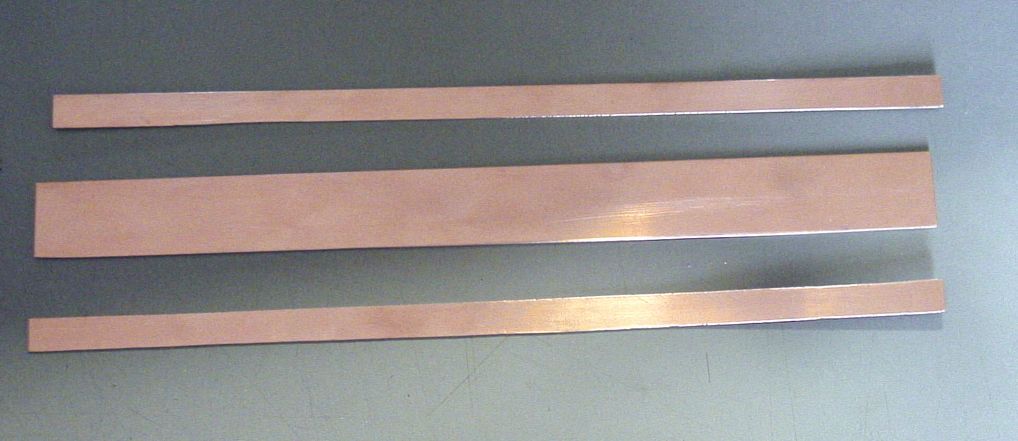

This is what I came up with. A quick trip to the local hobby store gave me the choice of real rails (brass HO train track stock 😀), solid brass tubing and a 6" x 10" x 1/32" solid copper flat stock ($6). The sheet reminded me of some pictures I've seen on the forum so I chose it for this version. I'm hopping copper is copper and this will perform the same as the Romex.

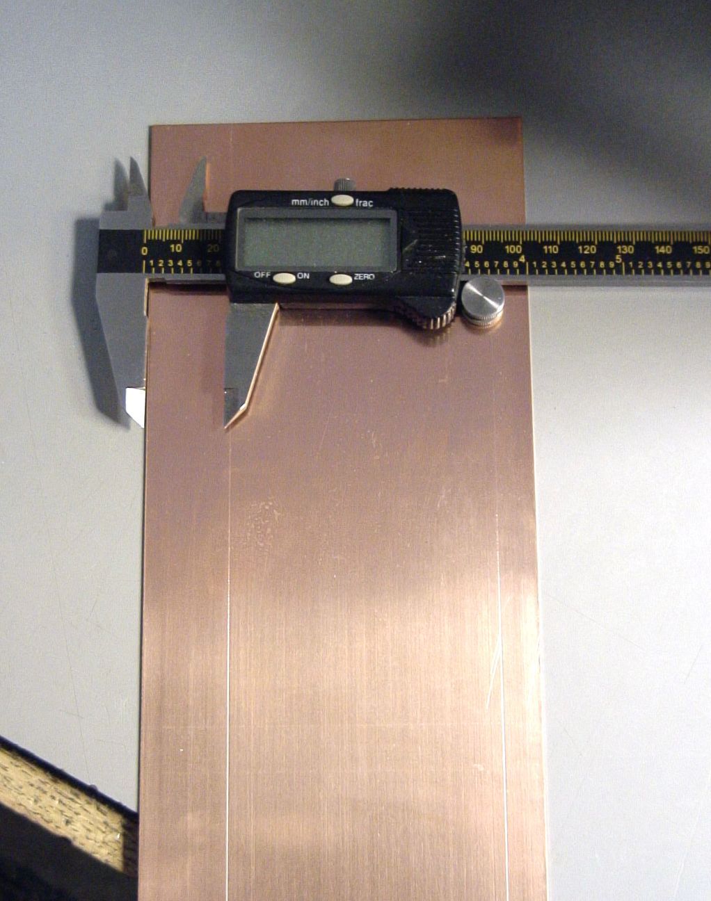

Strips were marked (22 mm & 8 mm), cut on a band saw with a temporary fence and cleaned up with a file and sandpaper. Some parts are mounted through hole and others will be bent and soldered. I couldn't find any perfboard long enough at the local RS so I used chunks from my parts drawer. May have to devise some additional support. The DC out will have the same green screw pads as the AC In. A little more layout and drilling and I'll heat up the soldering iron for pre-tinning all the joints and final assembly.

Looks good bob. I was thinking of something very similar with the 0 volt connections as I have a piece of copper left over from the fe enclosure. I am thinking of using 12 awg for the +/- rails to keep the distances at a minimum and then cutting a piece of the flat stock copper to be equal to a 6 awg wire.(based off daniels recommendations ).
I really like your perf board layout, and the terminal blocks are such an obvious convenience, great idea.

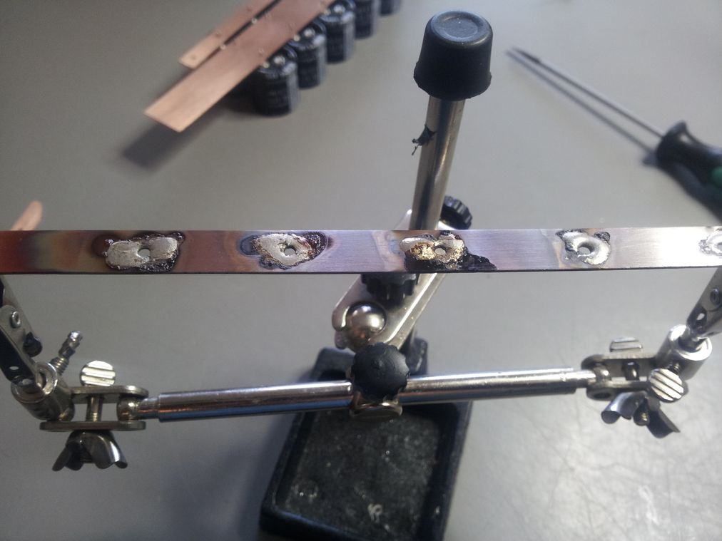

I am interested to see how well/difficult it will be to solder to the copper sheet. Keep us posted.
Thanks, I'm planning to scour the copper with Scotch-Brite, apply liquid flux and tin everything using a mini torch before final assembly with the soldering iron. I'll epoxy the copper to the perf-board first.
Yesterday, I was wishing there was some way to steampunk a power supply. I was also wondering how to make the power supply compact instead of long and zigzag (happens when I try to "crowd" the caps to minimize distance to the 0v rail). Today, you taught me how to do both. Awesome. Thanks!
Possible errata:
I think there might should be a little bit more space between the rails so that you don't have to lacquer them for spark avoidance. Avoiding sparks usually takes about 1/4" space. But, if you're going to lacquer, that's good because it keeps perfboard from stinking when it gets hot (in this case, lacquer the top of the perfboard before mounting the caps). The wal-mart has black, white and clear Rustoleum spray Lacquer in stock in with the spray paint section. It hardens quickly. I'd use the clear lacquer on bottom, just in case you'd want to show off those big copper tracks. 😀

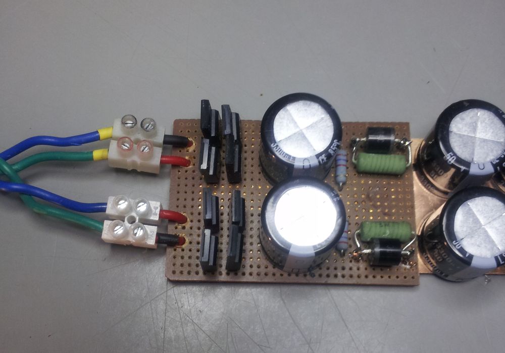

Known hazard:
Those little green screw taps are known to loosen, slip incessantly, cause static and generally degrade both quality and safety. For power supply, you need euro type with big screws, not china type with little screws.
And,
In that layout of the bridge rectifier, you'll want to reinforce the insulation of your AC leads jumper from bridge rectifier to screw terminals with some shrink tubing just to give it some extra durability. The wire type used for jumper probably needs to be insulated solid copper so that it doesn't wander about.
Or,
I don't use any screw connectors with mine but rather have little holes drilled through the perfboard in the right spots to connect the transformer cables directly. In my case, the transformer cables are inserted through the top of the perfboard so that the transformer cables don't criscross anything, and my cables are soldered securely. My transformer cables are bundled as 2 groups of twisted pair as is typical for dual secondaries transformers.
Generally, I like everything about your build except for the frightening miniature screw connectors. And man, those gotta go--they don't match your build quality.

A question though. I know when designing pcbs it is advised to avoid sharp angles when laying out traces, is there any use for that rule when shaping the copper plate traces here? Bob I noticed some of your corners were rounded, and was wondering if that was why?

I considered the space between the buses yesterday. I thought the only way I could increase it was to attach the pins to the edge of the copper, but after looking at it I see I had almost a 1/16" off center to play with and still have a full circle to solder.
There is a half sheet of the copper plate left so the next one will use all the suggested changes. Should be finished in a few hours and I post more pics then.

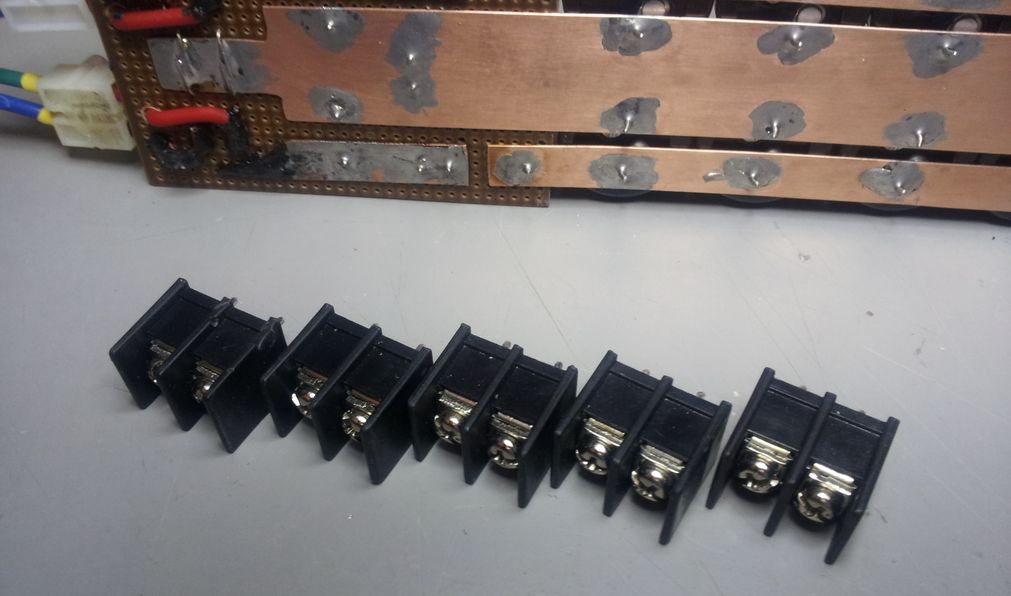

The surge of current delivered at startup and hopefully for bass beat too, is far beyond the safe capacity of most convenience connectors. We need something sturdy that doesn't degrade, spark or loosen over time.
There is a type suitable for power board use:
A barrier terminal block.
The metal plates under the screws are springy, maintaining a secure connection that doesn't loosen over time.
Mouser search:
Barrier Terminal Blocks | Mouser
These are sturdy enough to withstand the charging surges and peak current of a power supply board.

Seeing those dreadful little green blocks makes me annoyed, anxious, afraid and sad. Please remove them.

It could be good to have several millimeters more spacing between the rails. That center track could be reduced slightly in width, and a little adjustment is probably enough to avoid an erratic sparky noise or weird static. Remember that your signal does travel through the power supply, so that area is actually important to audio and it needs controlled/refined a bit so that we don't end up spending a lot of time chasing errata. After you do what you can to adjust the spacing, then you might consider spraying it with several coats of clear lacquer.bcmbob said:I considered the space between the buses yesterday. I thought the only way I could increase it was to attach the pins to the edge of the copper, but after looking at it I see I had almost a 1/16" off center to play with and still have a full circle to solder. There is a half sheet of the copper plate left so the next one will use all the suggested changes. Should be finished in a few hours and I post more pics then.

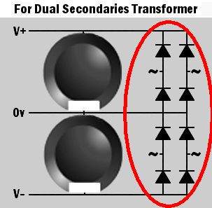

Due to surge currents involved, connections to and from a bridge rectifier need to be approximately twenty times stronger than a typical speaker connection. If you wouldn't use the dodgy little green blocks for speaker connectors, the matter is only twenty times worse at the power board. Quality control: Mail all of the green blocks back to China.

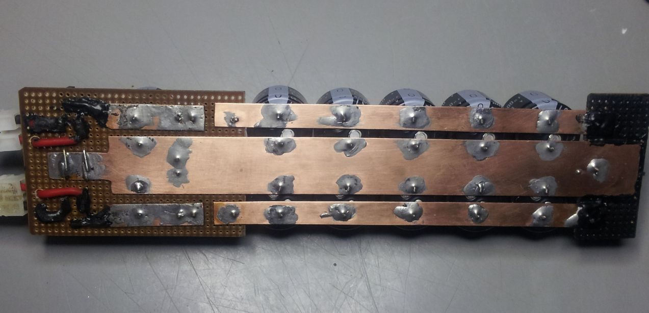

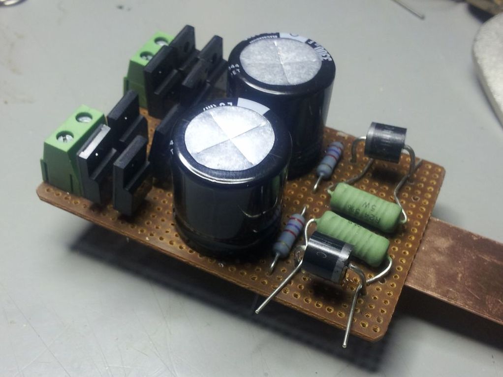

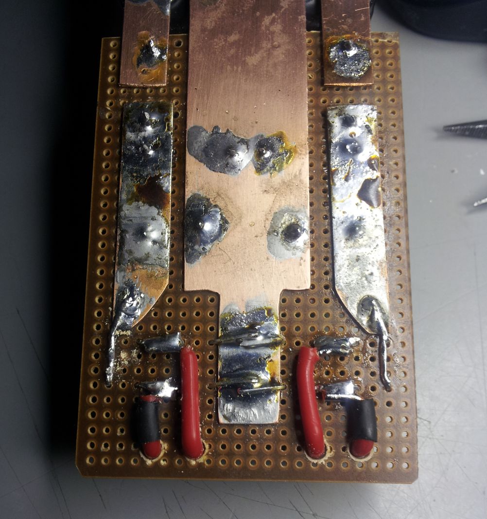

Well, It's close but no cookie. In short - no explosions or stinky green smoke. The PS works but the values are not correct. I'll just run through the photos.

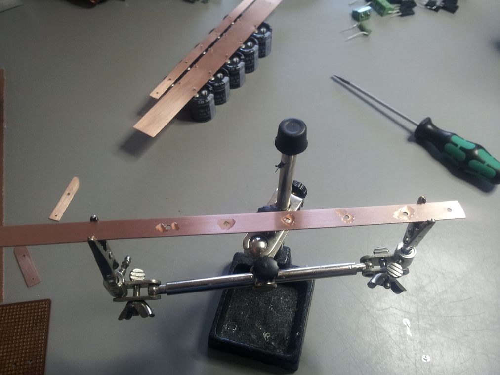

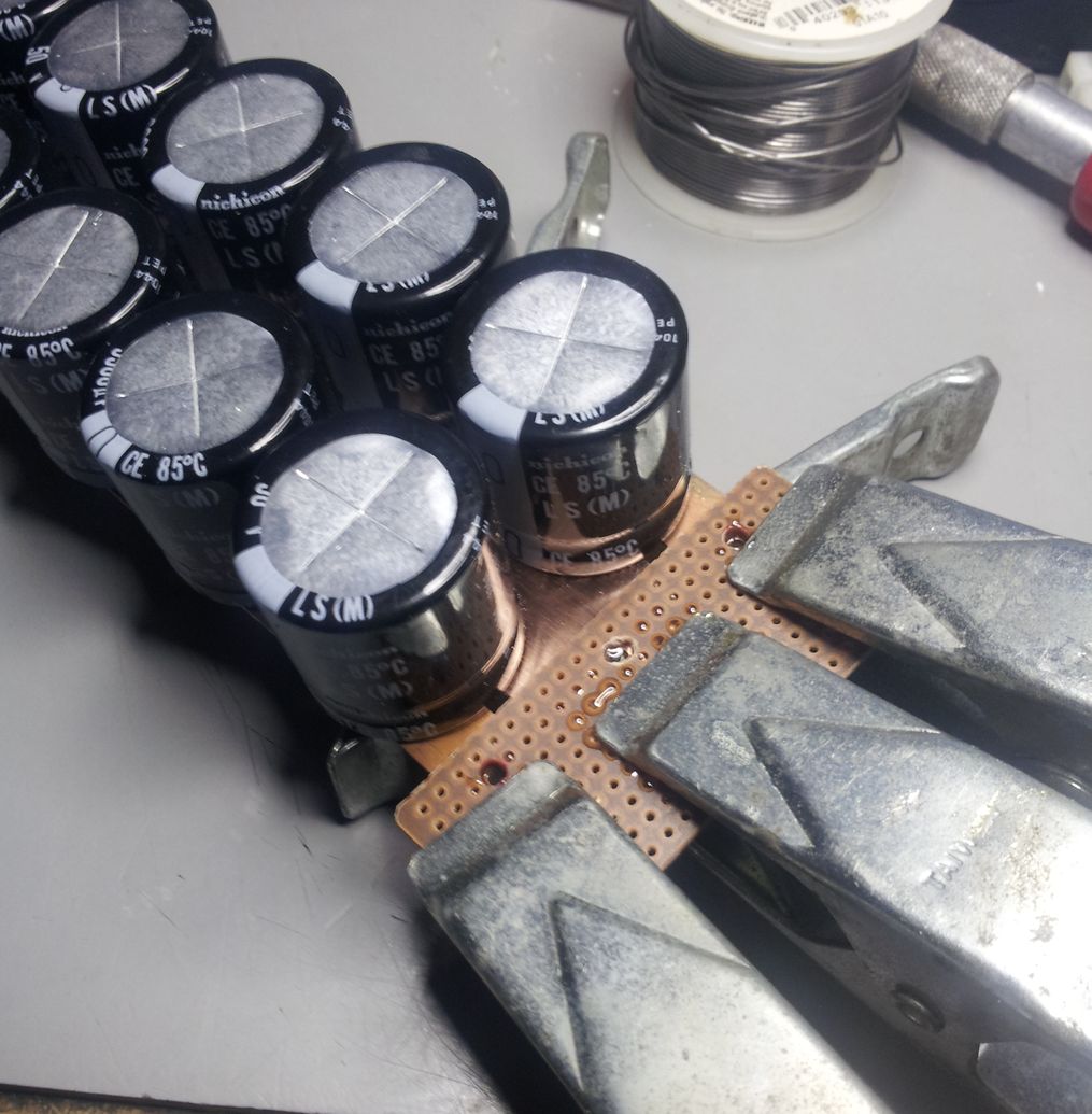

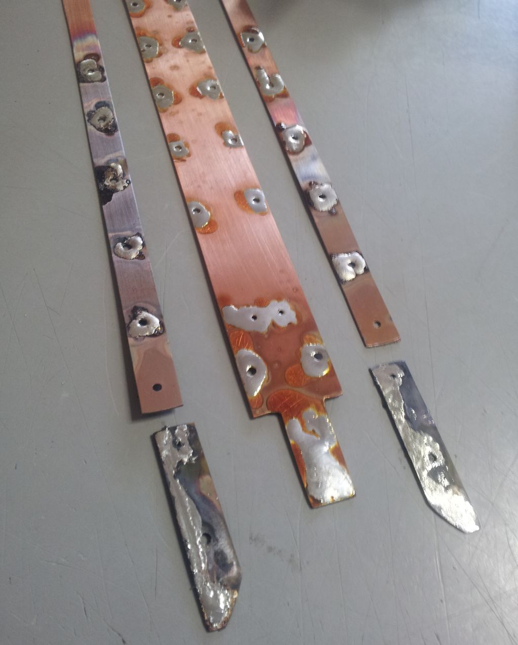

Copper pieces cleaned and scuffed.
Strips fitted on caps. Could have drilled closer to the edge.
Tinning process.
DC end fastened with epoxy.
Solid Cardas jumpers installed.
Insulated with Liquid Tape. Probably on all copper when finished.

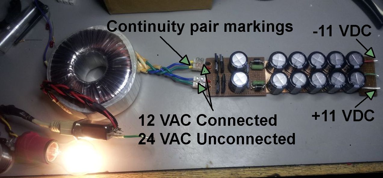

Identify AC#1 and AC#2.
Hook-up.

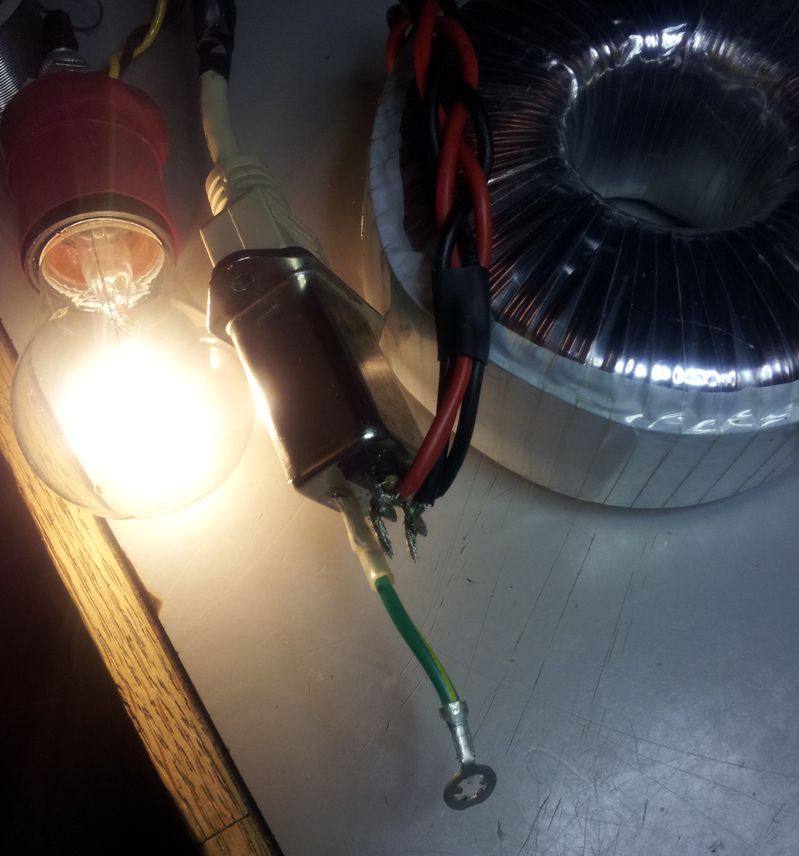

So the first problem was the bulb tester didn't go all the way down. My temp gun showed no component above ambient after three minutes of operation. The first DC output check showed a range between 9 - 11 with constant fluctuation.
I went back to the AC end and found both rails read 12 VAC. When disconnected they are 24 on both.
Now here is where it's good I don't get embarrassed easily. When soldering the caps I reversed the orientation (should have stood on my head) compared to the diagram. To avoid de-soldering, I reversed the diodes - meaning the marking ring on the negative rail pointed back toward the AC end, and the positive installed toward the DC end. Although the PS is working (kinda) the polarities are reversed. The relationship between the diodes and the rectifiers may be more complicated that I assumed.
All in all I'm pleased with the progress so far but,
Help Daniel !!! Get me out of this
Oh, my. Well, you're going to want to de-solder all of those caps anyway because you need an insulator (like some perfboard or fiberglass board) between the cap and the metal rails. The cap bodies are aluminum and their label is very thin, and although I'd like to offer a quick fix, there isn't one.
After you turn the caps around, you need to remove and check the health of the 0.25R to see if they're not open circuit. And you need to remove the 6a standard diodes.
Leave the 0.25R and 6a off until you check out the bridge rectifier and first caps (this step is checking the power supply with just the first two caps active).
Next connect the 6a diodes and check the rest.
Lastly, reinstall the 0.25R.

As soon as my head hit the pillow I realized I had not done a full inversion. The rectifier flow pics you posted popped into my head.
