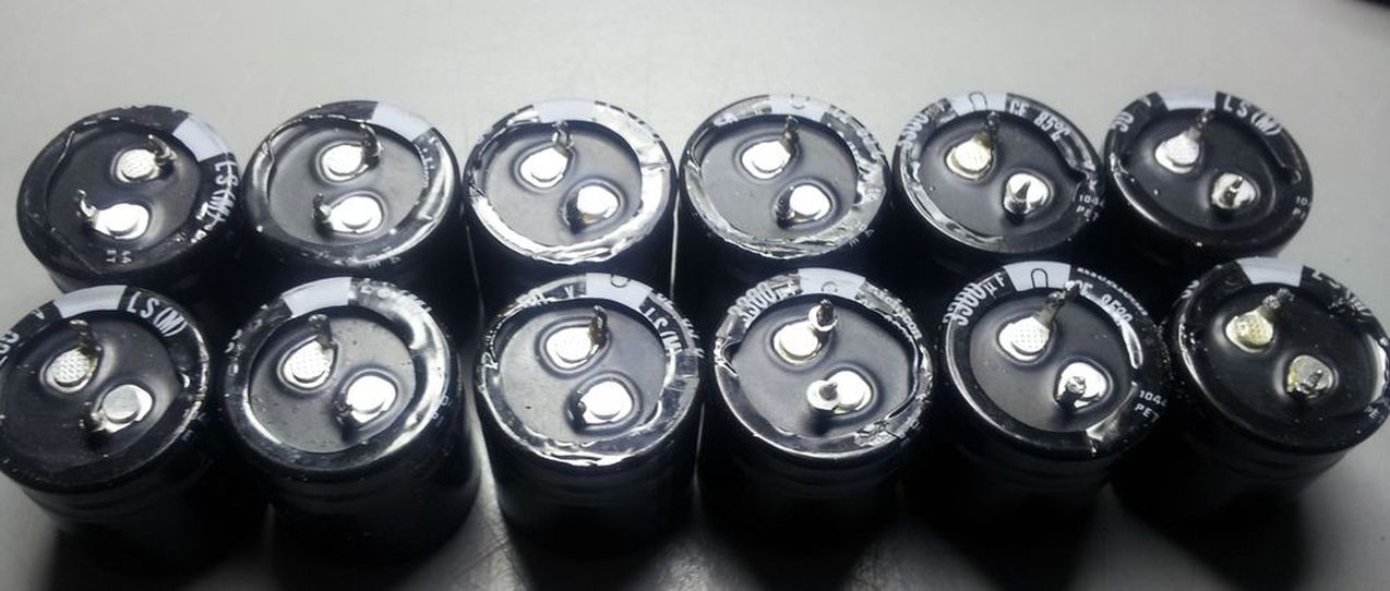

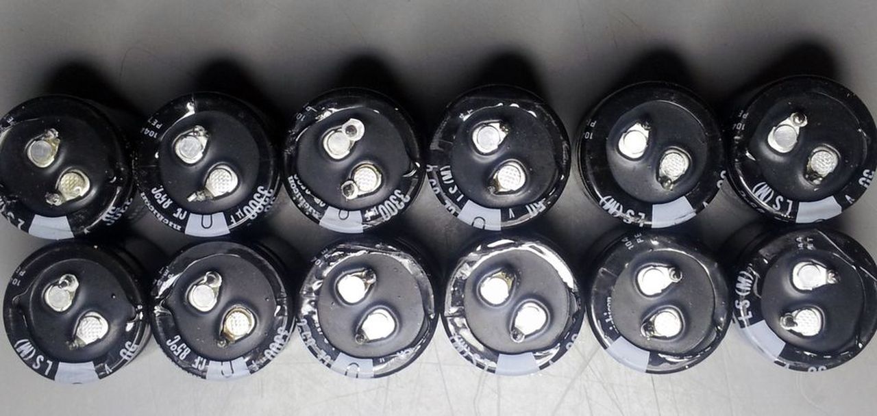

Looks like the caps survived the high heat. The plastic shell warped at a few spots but the paint on the aluminum shell is intact. I'm going to try simply putting them in the correct rotation (with a couple coats of the liquid tape between the caps and the copper) before I disassemble the rest of the build.:xfingers:
Edit: And turning the diodes around to the original orientation. 🙂

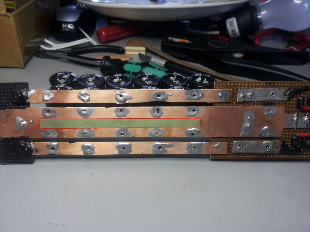

Bob, I had an idea for your 0v bus. This would be a little labor intensive but it might help you localize your heat while soldering. As you can see from the attached "professional" rendering that you could first drill out larges holes to create voids in the sheet and then cut the rest with a bandsaw or scrollsaw etc. You could also drill your through holes closer to the edge which I know you mentioned. This should give your heat only one direction to escape and keep it where you need it just long enough.
The only problem I see with removing material is then the awg equivalent starts to drop, but I guess without some math we really don't know what it is now.

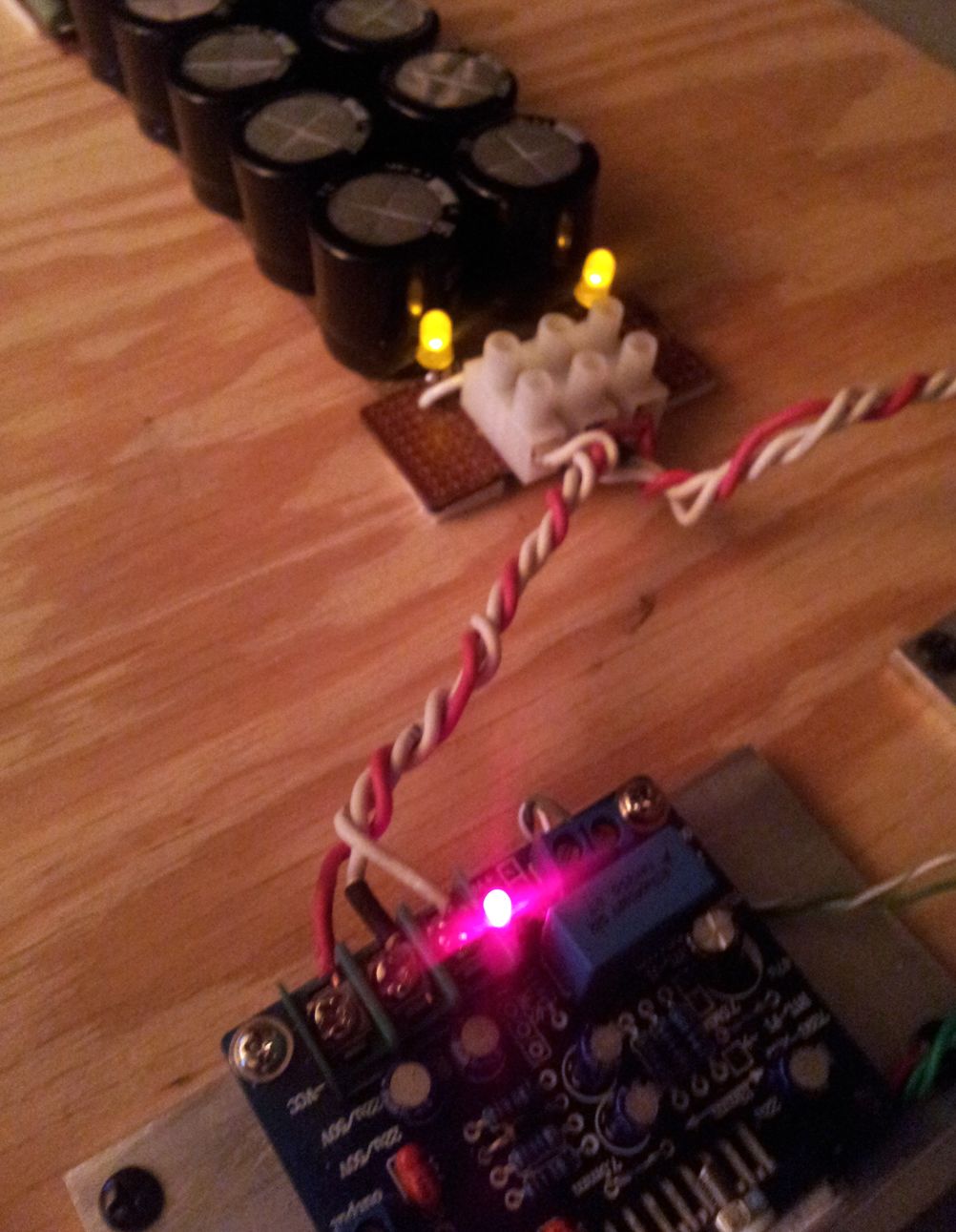

I've been working on a liquid cooler for the discrete amp I'm testing and thought about the leftover 1/32" (.75 mm) automotive paper gasket material I used. Will glue some on the copper for extra insulation.
Fear not - 😀 - I will do a build with all the suggested improvements after all these bugs are worked out.

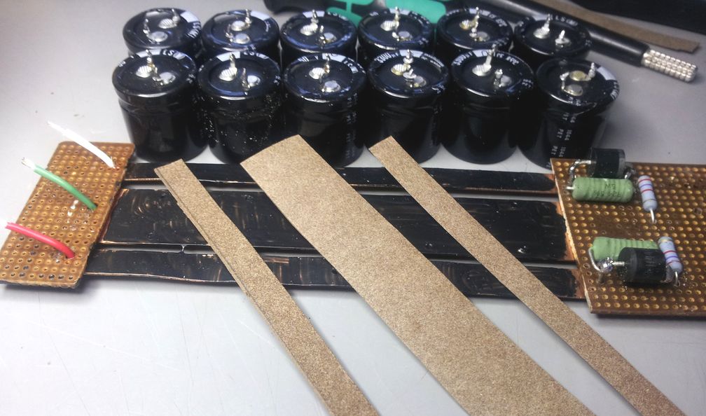

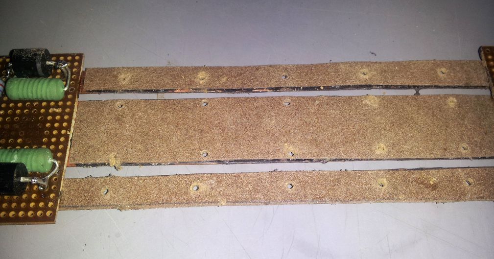

Thanks, I might try that on the next one. As you were posting I was about to off to the hobby store to replenish my Dremel bits and cutters. For now, I'm going to give what's in the picture a try on this one. I'll keep the remaining copper as least as wide as the outside rails.
In any event, the support of a full length perf or fiberglass board will be added.

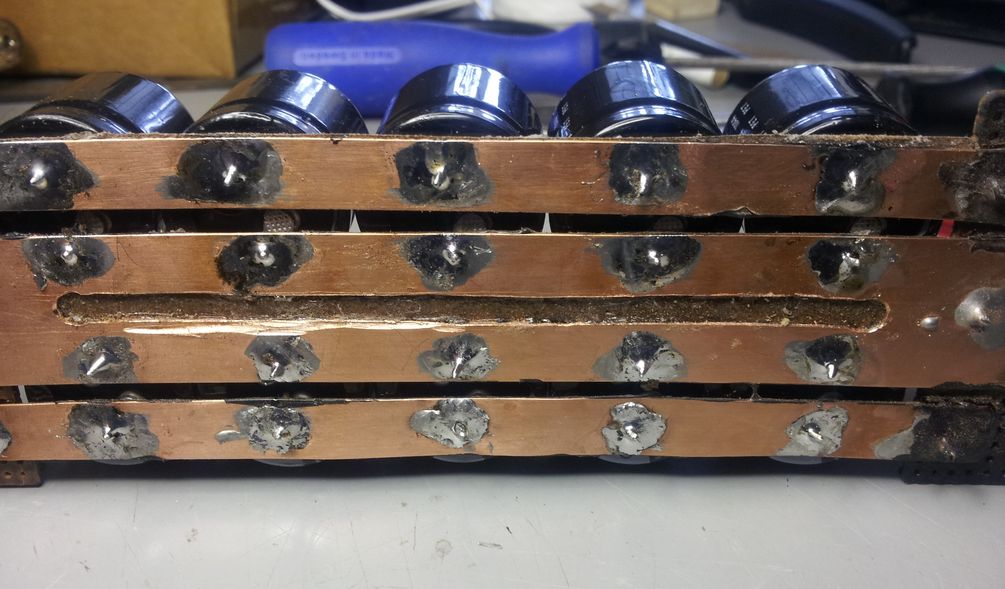

So the moral of the story is not only "R T F M", but also "Build it as designed".
The rebuild produces + 33.1 and -33.0 VDC... 😀
Thanks for hanging in there with me Daniel, and SoIL4X4 for your support.
Been a fun trip !! Now I are a expert.:usd: 😱
BTW: A pic of the gasket material applied and the cut-out. Soldering was a breeze this time.

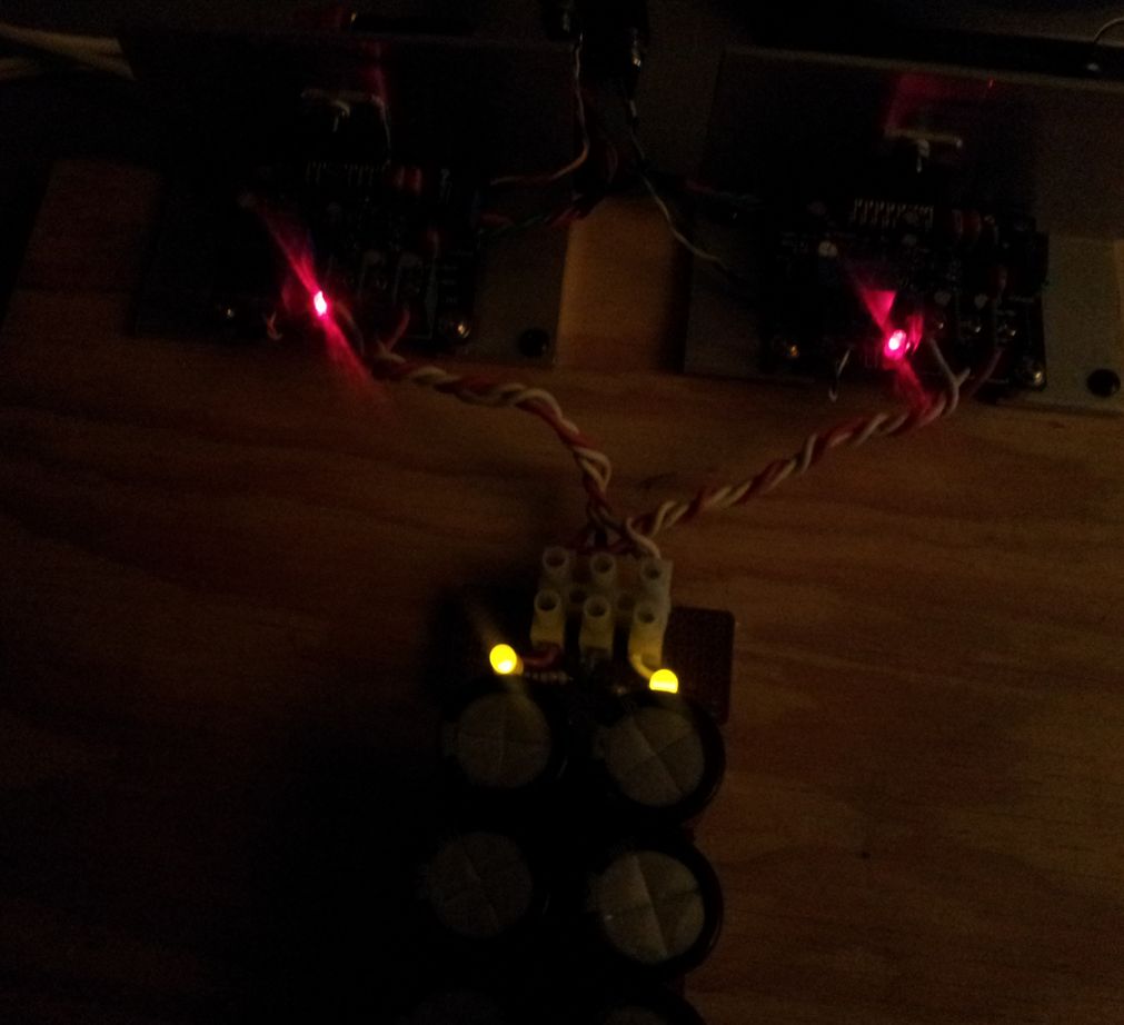

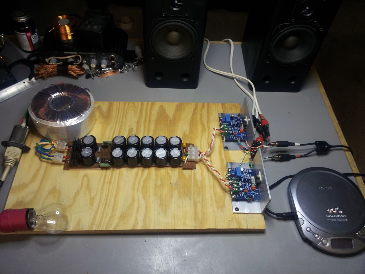

CAN YOU HEAR THAT ????
I almost forgot what all the power supply stuff was about. 😉 The amps are playing, the bulb tester is out and everything is at room temps. I am again really impressed at the quality of this chip (even on these tiny speakers) and am anxious to get on with the optimized design.
Thanks to all again. :cheers:
Thanks Will, it was well worth the effort. The power supplies are great - providing very stable and responsive energy for the amps. I plugged in a regular power cord and the amps are really singing. I'll hook them up to the big speakers in the morning.
Oh, that's good to hear. KUDOS!!! 😀 😀 😀
You just made a successful hi-charge (high dynamics) CRC (low noise) power supply. YAY!! And you did the audiophile features by layout, by design and by component value so that it didn't require audiophile parts. YAY!!!

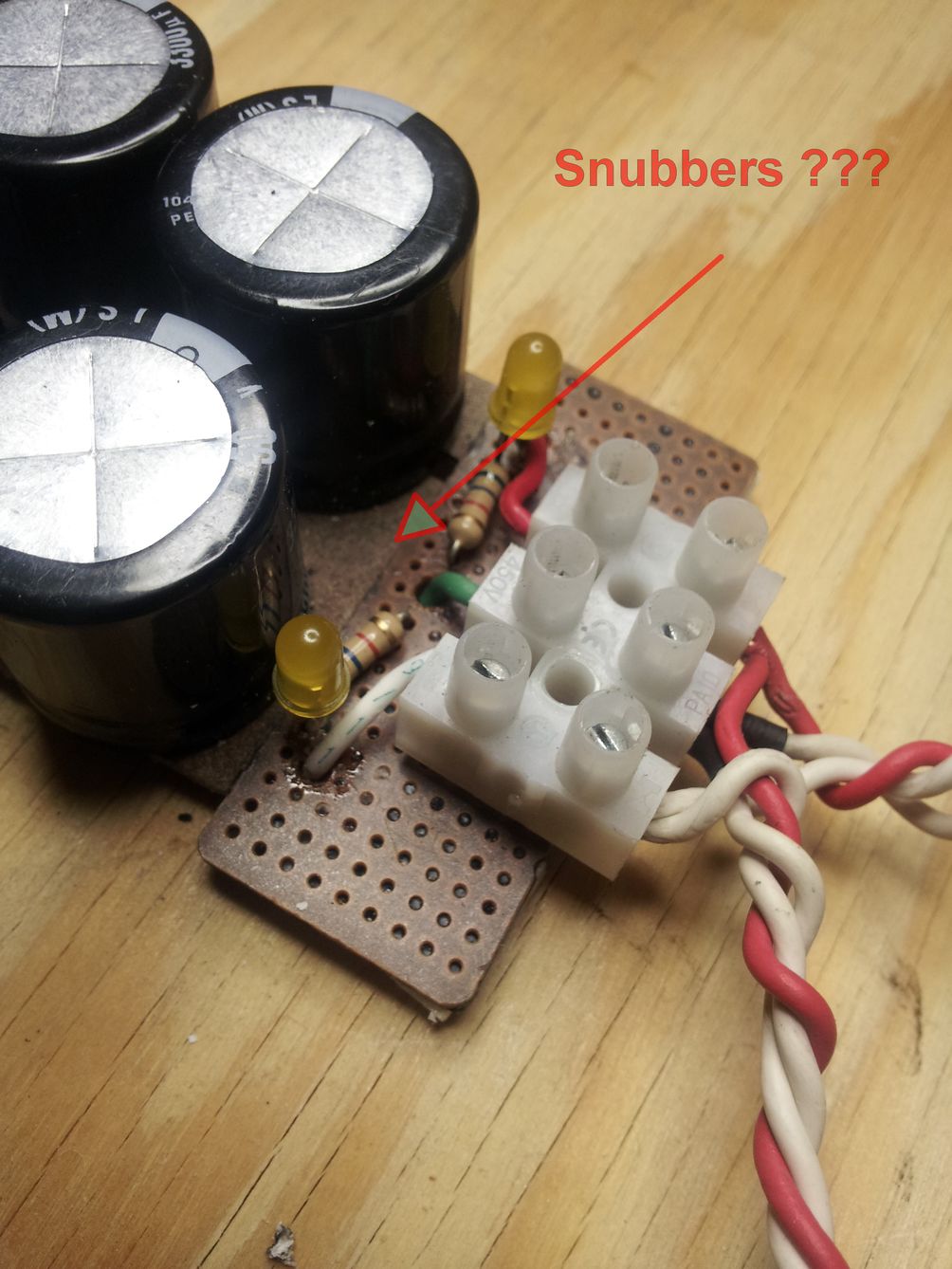

........... We forgot to snub the secondaries for audio quality. Instead of those little green blocks, you can install Kean's 50R trimmer + 2u polyester cap (variable RC to snub the secondaries) at that location. ..............

Keantoken's snubber dial. . .
You can install the variable RC's where you had previously installed the little green terminal blocks. That potentiometer works, but you can use a less expensive model if you want to. First you put its center pin onto either one of its outboard pins to create a varaible resistor. Next you put it series to a polyester cap of 1u or 2u or some similar figure. Now you have an RC--a variable RC. This is to snub the transformer secondaries. Variable RC = old fashioned tone control dial. In this case using it on the AC (transformer secondaries) side, muffles the power noise, not the audio.
With your voltage output reading (last time) indicating that one of the transformer secondaries is "louder" than the other, start on that side, with unloaded supply and the voltmeter hooked up. Set the snubber for lowest voltage, so that we're pretty sure it does something. It may vary only a volt, so an analogue meter might make more sensible readings. Next, dial in the other side for same voltage. After you have both equalized and lowered the noise powered voltage on both rails, that's "in the ballpark" and you can reconnect the amplifier and fine tune. This prospect may take some time. The settings are unique per each transformer.
This is like a top-secret audiophile thing where engineers will spend hours with their scopes. . . but Keantoken gave us a convenient and easy little dial to do that job. Awesome.
