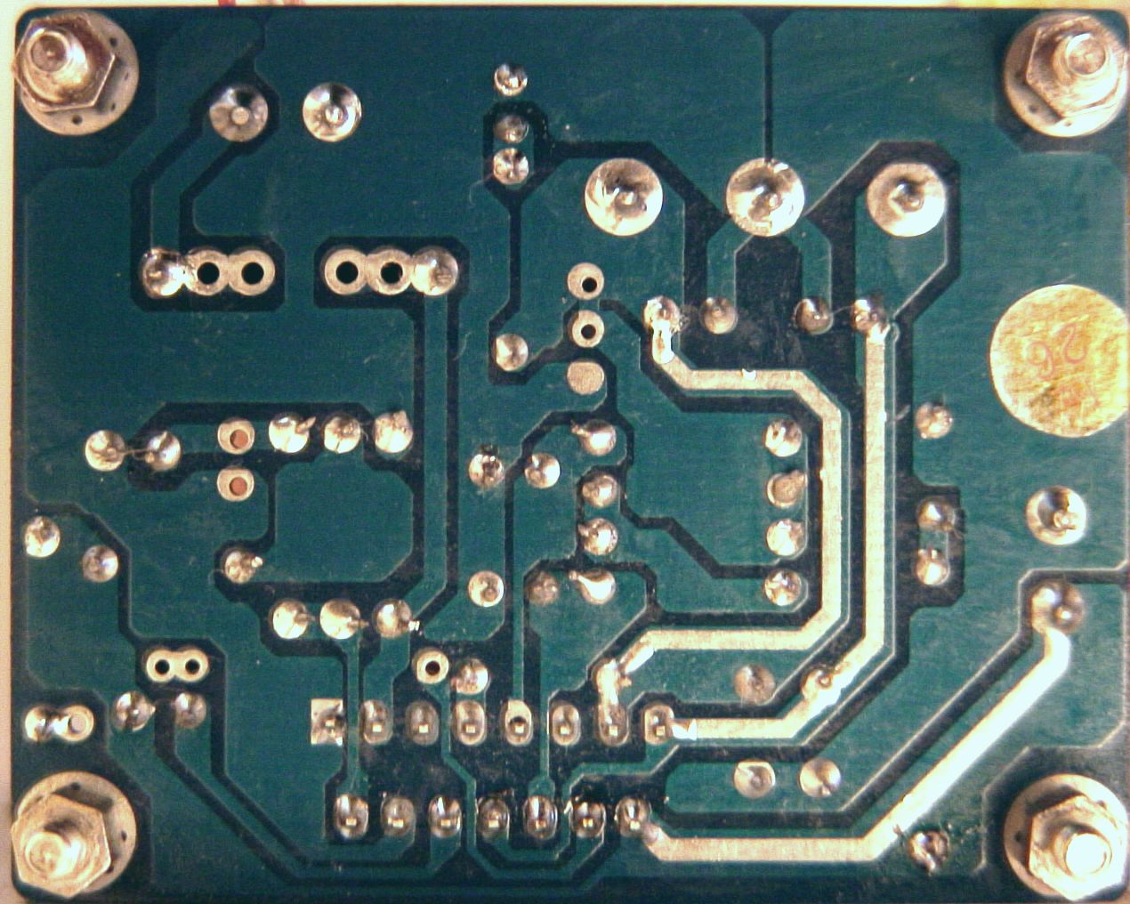

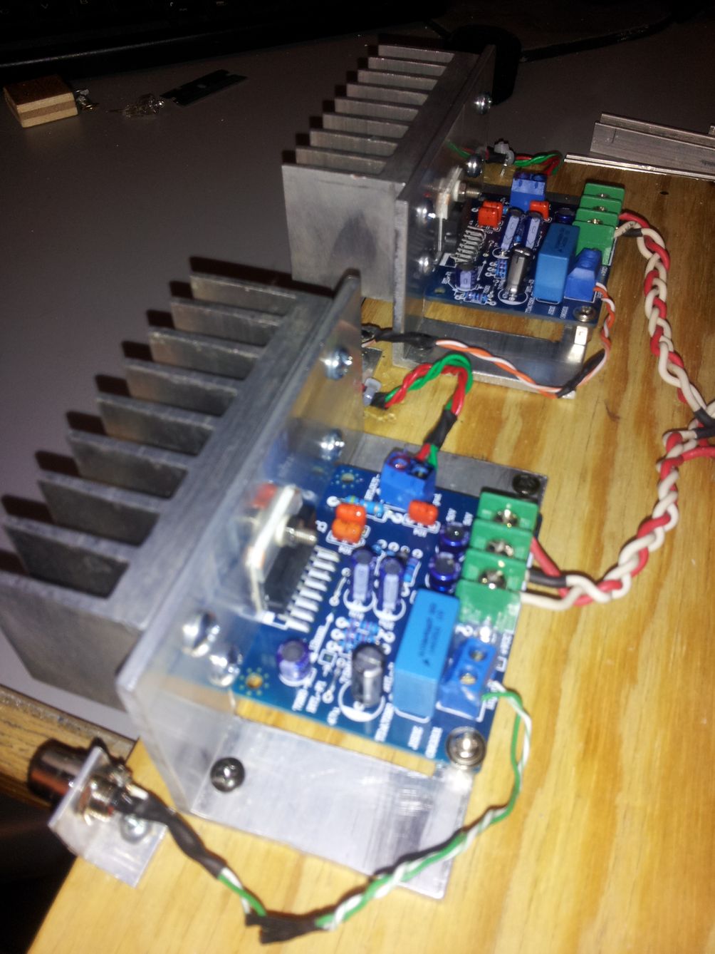

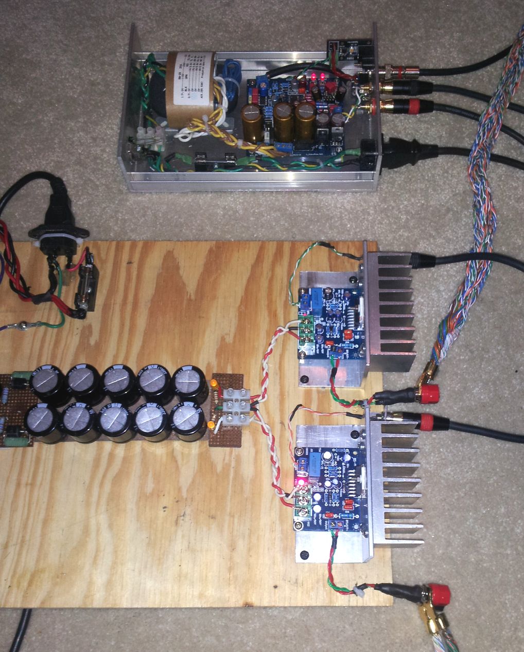

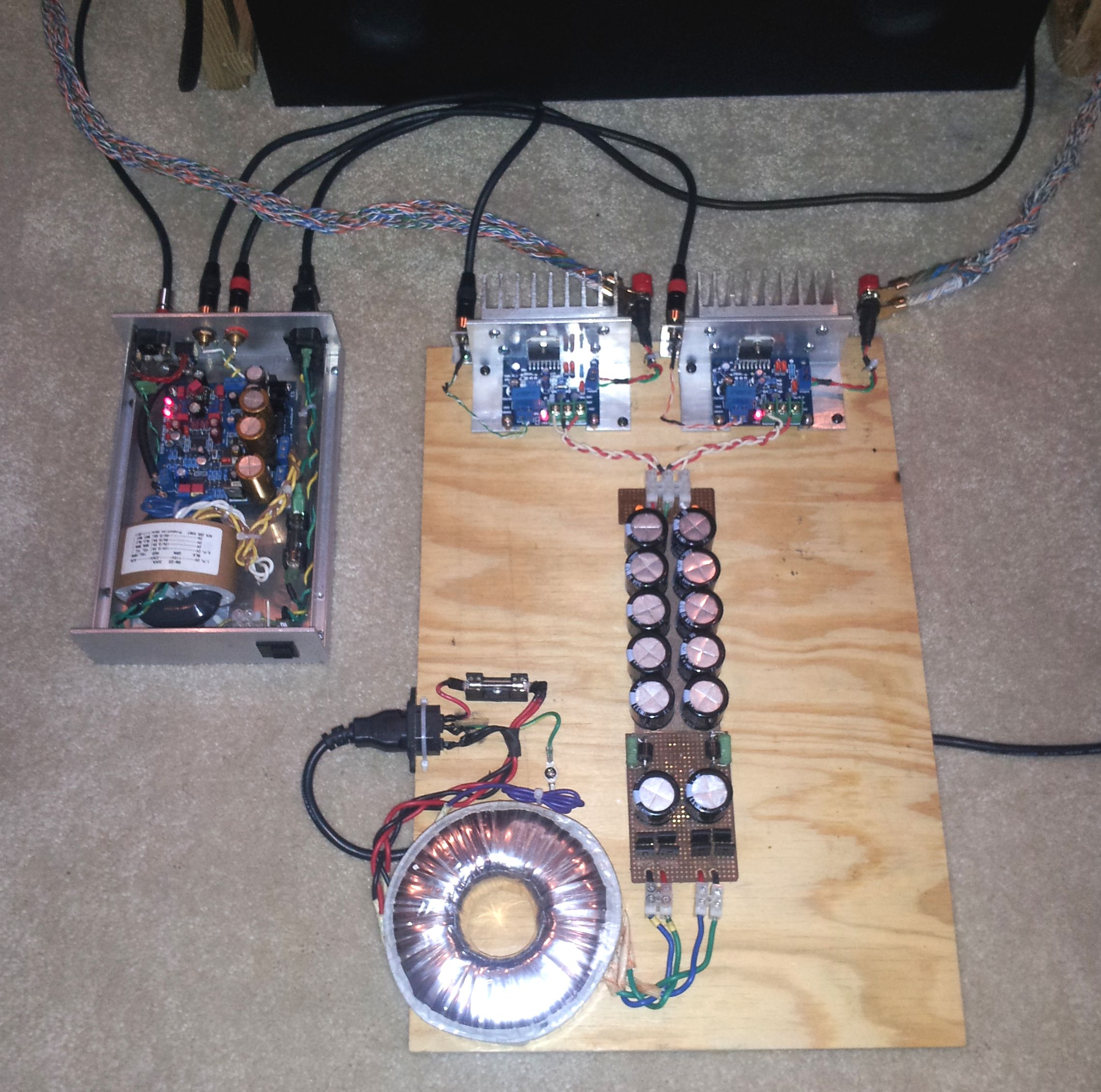

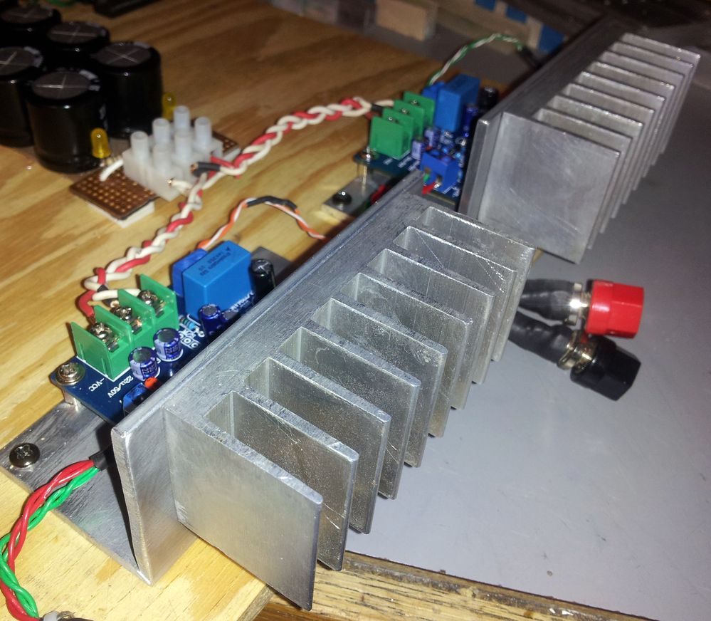

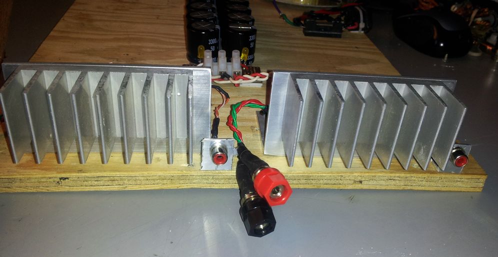

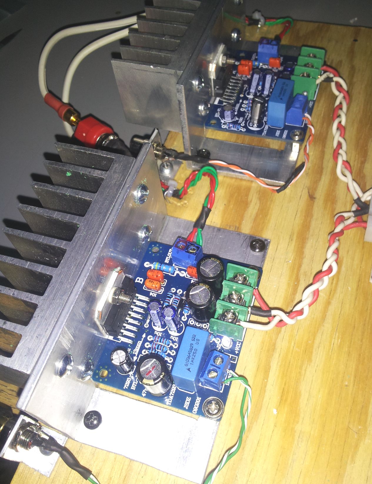

Made some progress on the TDA kit project. Added more metal to the heat management system and tidied up the power and signal wires. The build sounds great on the big speakers (shown here with mini 2496 DAC driving Sunflowers)
The new power supply made bigger improvements than I had anticipated. My biggest gripe with the stock build was a low ceiling before the sound got mushy on the top end, as well as what I interpret as IM distortion. For the most part, that lack of headroom is gone. The natural clarity and warmth of the chip can be heard well above 90% of the volume slider as opposed to trouble near 65 - 70% with the old power supply. The amp is still limited in sparkle and shimmer compared to some of my LM3886 builds, but the dynamics are full and immediate. The low end sounds more stable and accurate but no sensation of extension is perceived. There is nothing missing but I'm used to a heavier bottom output from the MyRefs/FEs.

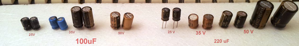

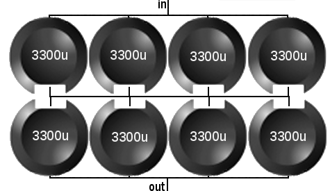

So the next step is Daniel's bottleneck. I'm wondering if I can use one of the 220 uF caps I have instead of two 100s. The pic shows what I found in the stash.

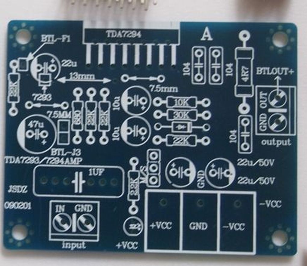

We're not quite done with the power circuit. Louder mids at the amplifier board power circuit sounds exactly like poor treble combined with poor bass.
With your report of both insufficient bass and treble, I recommend increasing the 22u amplifier board power caps up to 220u caps before proceeding with other small signal fine tuning. On your board, this is the pair of caps located at the DC screw terminals of the amplifier board. The only reason I can think of for the kit to have come with such a bizarre value is that the smaller caps aren't as easily flattened in the mail.
For example 100u would be slightly too small (albeit quite clear at the cost of the mids being somewhat louder than both treble and bass), so I've no idea why that kit board has 22u, which is not really valid.
For TDA7294, amp board power caps of 470u would be too large and maybe dull, so at that point you'd need to step back, try the rail to rail cap and possibly try multiple parallel 100u caps or parallel 220u caps. But, I think that simply swapping the 22u for 220u and then using a rail to rail cap, could be a home run.
For example, if you want to use small power caps on the amp board (not smaller than 100u), then a great trick to turn down the mids while increasing resolution is one ~2u polyester cap from V+ to V- (rail to rail) at the DC power terminals of the amplifier board.

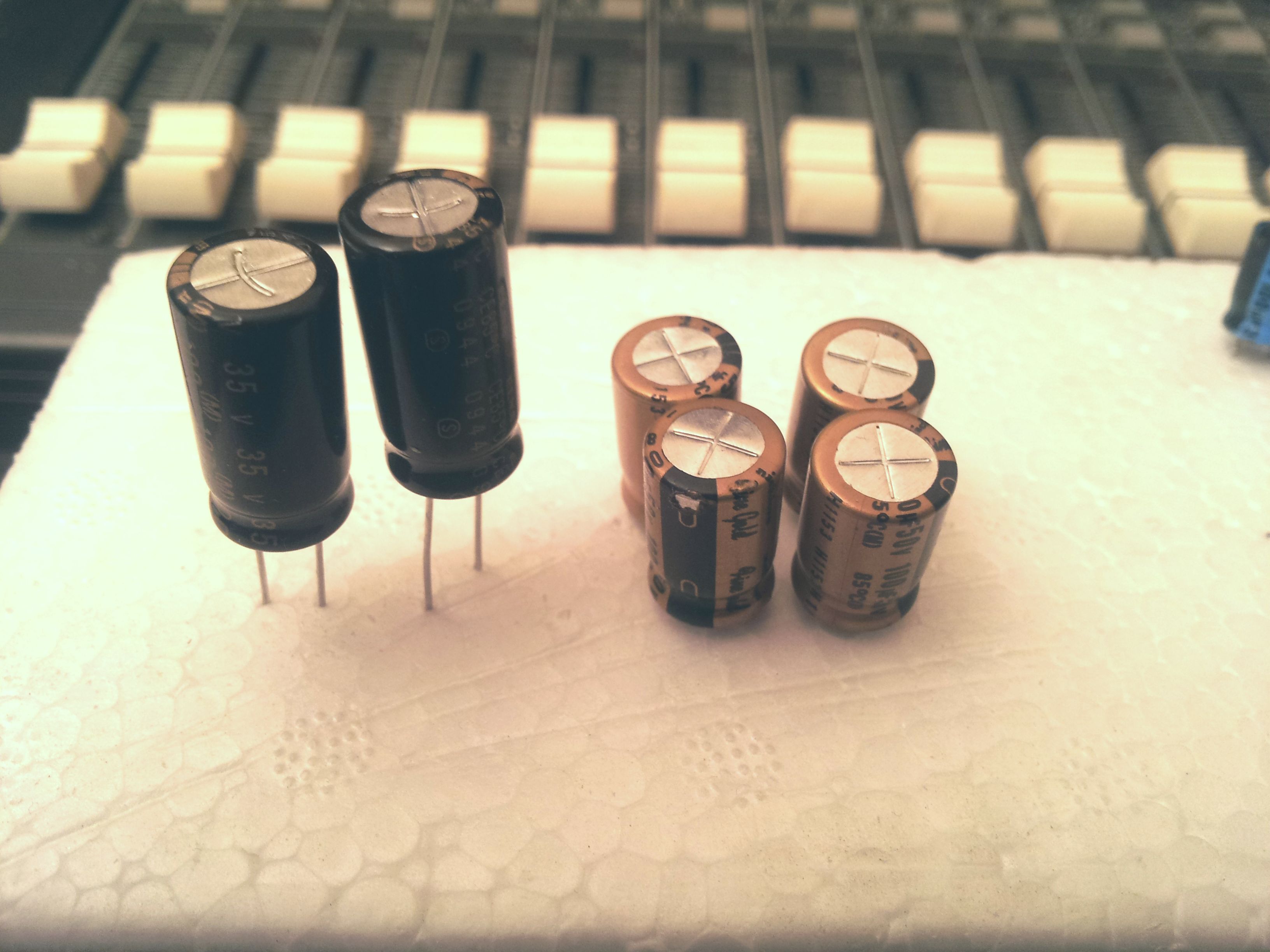

EDIT: On your caps photo, I see some 50v compact 220u caps that could be ideal for amplifier board power caps (to replace that pair of 22u located at the amp board DC terminals). We must undo the shout at the power circuit before removing the extra warm bottleneck at small signal.
After turning down the midrange loudness at the power circuit so that we have a chance at hearing the bass and treble, then we can try a couple of other things.
Fix the bootstrap cap bass blocker (install 47u).
Fix the NFB-shunt cap bass blocker (see post#27).

No Green Smoke

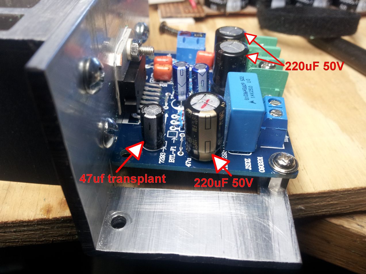

As luck would have it the only 220/50 caps on hand were used, with little stubs for leads. But the handy-dandy Dremell tool (cut off some green plastic), pointy needle nose pliers and a tiny drill got everything to fit.
The board with the new caps runs ~ 3-4 degrees warmer topping out at 84 on the chip flange. HS is ~ 91 with the bulb tester.
I'll let it marinate for a time tonight on the tester and the bench speakers while I create some good mono tracks for comparative tests in the morning.
Upwards and onward. :cool:

I have a bunch of small caps from the MyRef FE tuning process and already started sorting them out. A lot of 22 - 47 nF Wima and CDE Mica.
I tried to fit some 100/50 (new but with short leads), but it would have taken too much fiddling. I'll order two more of the 35V with long leads to match what I have and shoot for 200 on the nose.

At first I couldn't hear a lot of difference with the cap transplants. With mono sources I separated my bench speakers to 20" and stuck my head in between them.:rolleyes:. I perceived a definite increase of highs and dynamics with the new caps in that position but could not hear as much when I backed off to about 4 feet.
Again, with the big speakers there was nothing that jumped out at first. Then I realized no matter the distance from the speakers it sounded like I had wax in my left ear. The modded amp is definitely brighter, clearer and more responsive - I'll guess ~ 10 - 20% or so. I think that's the "clearing the bottleneck" Daniel has been talking about. I plan to keep the other amp stock through a few more upgrades.

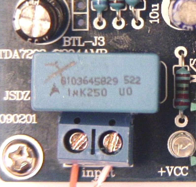

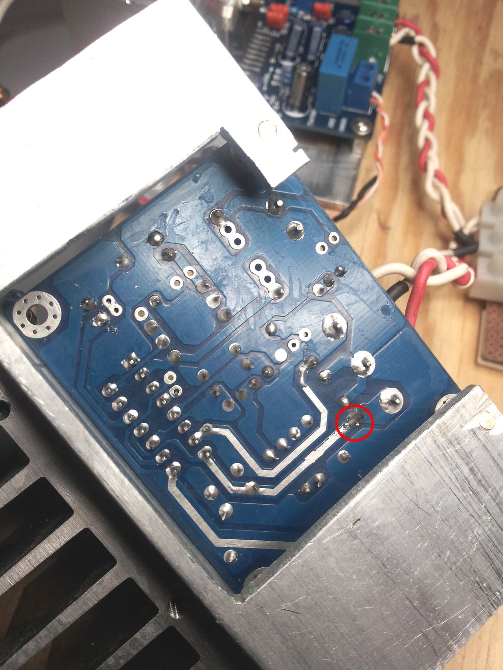

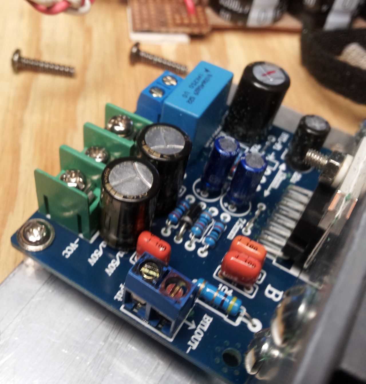

Daniel, If you would please paint in the Z extensions you suggest. I looked back at the photo you posted when you received your board but couldn't decipher.
Also, I'm still using the stock input cap (i believe) and noticed you have an alternative. Any info?

Yes, non-audiometric values are like ears full of wax. :) That weird pressure is foldback distortion of the bass from allowing more bass into the amp than it could pass through. If you didn't change the resistor values, then there is actually a lot of bottleneck still present. See again, post#27
True that TDA7294 can't do high end sound unless bass is allowed to pass through the feedback-shunt RC intact. Ways to resolve this particular bottleneck is:
Decrease input cap size (1u or smaller).
Increase NFB-Shunt cap size (greater than 199u).
Increase Feedback-Shunt resistor value (greater than 1.1k).
I'm after both increases.

Leftmost photo (in your post above), the spots marked 1uF and 47uF are both signal caps, there's gain on them and it will take some experimentation, such as "contest of 5 peers" interviews to find ideal capacitors for both locations. The "z extensions" are nothing other than homebrew pins that stick out the top and give you room to test drive at least 5 capacitor candidates (plus find them attractive bypass cap partners) quickly and without wearing out the PCB traces or desoldering iron. A touch of normal soldering iron will free capacitors from pins so much more quickly and in that way you can conduct interviews more easily. The pins can be removed and the "winning" caps can be installed normally after the "interviews" are finished. May I suggest current production high availability parts?
