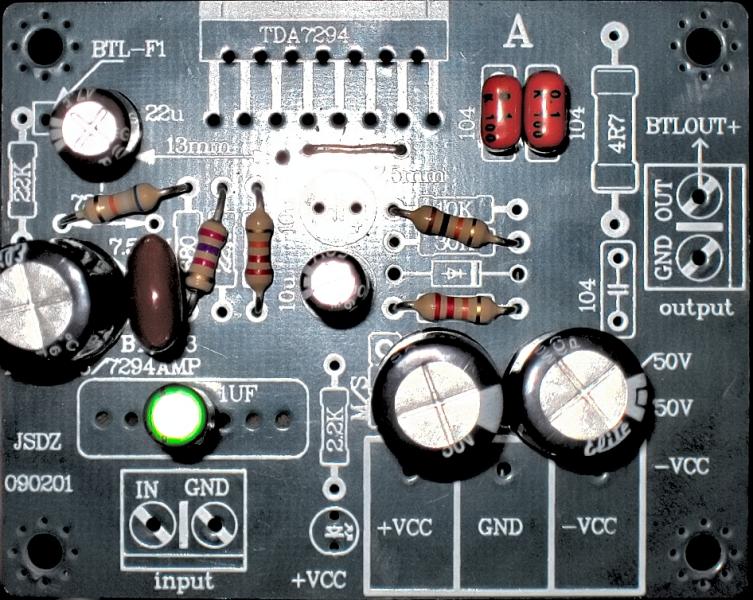

Board came in
I really like like Kean's idea, post 240, and will try it as soon as I get a 50 ohm multi-turn trimmer (to use as variable resistor).
The TDA7294 ebay kit, same board that Bob is using, has arrived in the mail.
My first first steps included, simplify the mute circuit for power/midrange quality, use audiometric size NFB cap for bass quality, increase the 22u bootstrap cap to 47u for bass quality, and. . .
At first, it looked possible to set the feedback resistor closer (as in the photo below); however, this is still out on the end of a long thin trace shared by the bootstrap cap, the long thin trace is inductive and running maximum gain for non-audio signal is poor design. So, actually, the feedback resistor needs moved trackside, to directly under the chip from pin 2 to pin 14.

Here's some options that don't have a bass blocker effect:
150u with 3k3 fs and 68k fb, 22x gain
220u with 2k7 fs and 75k fb, 29x gain
220u with 2k7 fs and 68k fb, 26x gain
220u with 3k3 fs and 75k fb, 24x gain
220u with 2k7 fs and 56k fb, 22x gain
270u with 2k2 fs and 68k fb, 32x gain
270u with 2k2 fs and 56k fb, 27x gain
270u with 2k7 fs and 68k fb, 26x gain
270u with 2k2 fs and 47k fb, 22x gain
330u with 1k8 fs and 56k fb, 32x gain
330u with 1k8 fs and 47k fb, 27x gain
330u with 2k2 fs and 56k fb, 26x gain
330u with 1k8 fs and 39k fb, 23x gain
470u with 1k2 fs and 33k fb, 29x gain
470u with 1k2 fs and 27k fb, 24x gain
470u with 1k5 fs and 33k fb, 23x gain
