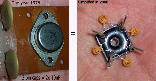

Dan, snubbing the secondary will not affect rail voltage at all.
On an unloaded power supply, my voltmeter reads 1v to 2v lower figures after snubbing a bridge rectifier.
Similar to what Mark Houston did here.
But I did it like this, same as Technics circa 1975:
Dan, it could be EMI fooling the meter. I've anguished my meters several times on oscillating amps and so on. Try hooking the meter up with 10k resistors in series with the probes, and a 100n cap or so across the probes.
BTW that's not snubbing, just capacitive bypass or decoupling.
Those rectifiers must be emitting TONS of EMI. I would not trust a meter here. Even so a volt or so rail difference should not matter; One should not expect the mains voltage to be exact and the Technics designers would not have made this mistake.
Perhaps without the bypass the rectifier area resonances were at high enough frequencies to stomp the AGC? In any case the bypass won't remove resonances but it will lower their frequency and localize the diode snap to a smaller area.
Dan, are you measuring AC voltage or DC voltage? It should not change DC voltage.
