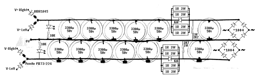

Simple power, wasn't so simple.
Hey smart guys, I need your estimates for these additions:
Cap and resistor values for RC (or RCR) across each DC rail, and located near the bridge rectifiers.
Cap and resistor values for RC (or RCR) across each transformer secondary winding. X2 caps can be used if desired.
Data:
1). With this capacitance, I believe that one may assume 24.5+24.5vac dual secondaries transformer, probably toroid and an average 270va (range 240va to 300va), but the exact model of transformer used by the constructor cannot be predicted, so please aim for "mild" RC values that will in all cases be better than omission.
2). Given the habits of diy audiophiles the exact model of bridge rectifier diodes used by the constructor cannot be predicted (could be terrible MUR, could be fantastic Fairchild Stealth, might be KBPC1004), so due to vast variance, there is no snubbing of individual diodes.
3). The remainder of the available data is shown in the attachment below. Since the last time you saw it, some simplistic RF filtering has been added, capacitance has been upgraded to support a "normal" range of transformers and the resistors have been upgraded to non-inductive types. Now it needs well estimated RC's added before-and-after the bridge rectifiers, and I couldn't calculate the values for them. Help?

I typically use a total series R of 1x..3x the transformer winding DC resistance. With your scheme of diode//resistor I'd put (part of) that resistance in front of it to have some lossy resistance in series to the diode's high capacitance, and increase the parallel R to about 1R or even more (and perhaps two series diodes), depending on which specific soft-sag characterisic looks best for the application.

Daniel,
If you are talking about snubber networks, to damp unwanted resonances that might be excited by the diode turn-off, there is NO good generic recipe, because the resistance that does the damping needs to be set equal to the characteristic impedance of the specific resonant LC tank that needs to be damped i.e. Z = sqrt(L/C). And the L is probably/usually/often from the parasitic inductance in the transformer secondary, while the C might be from what the diode junctions become as they turn off.
The resistance does the actual snubbing. The C is there so that only the unwanted frequencies cause power to dissipate in the R.
Both values need to be determined AFTER the circuit is built, using a procedure similar to: http://www.diyaudio.com/forums/powe...lm-caps-electrolytic-caps-30.html#post2828689 .
Tom

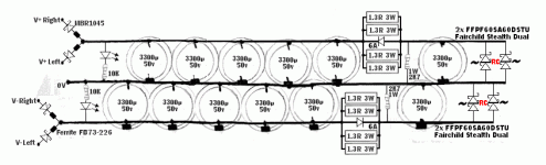

Also yet more research to dump the need of dc side snubbers by swapping to Stealth schottky diodes, but was concerned about the hazards of complexity, and therefore, some sort of prefab is needed. Then I discovered that the dual series package is conveniently same width as the rails, and the "confusion factor" is reduced considerably (there's only 1 package per each transformer output wire). Wow, nice low parts count. Higher surge tolerance and less voltage drop than KBPC1004's.
A new question:
Are 4 of these (datasheet) big enough for the job of stereo TDA7294?

Transformer secondary's leakage inductance will depend on how it was manufactured. But ONE particular 25VRMS/300VA transformer I can get a number for has 43.3 uH there.
The snubber resistor value should be set to
Z = √(L/C)
I was thinking that the parasitic capacitance was dependent on the diodes. And it will also depend on the layout, etc.
But IF you were to use 43.3 uH and 4.7 nF, then the optimal snubber resistance would be sqrt(43.3u/4.7n) = 96 Ohms .
For the series capacitance in the snubber network, you should use 4 to 10 times the parasitic capacitance. Using 10x would give a little better damping by the resistor at the expense of more power dissipated in the resistor.
The series capacitor's value would be in the range of 18.8 nF to 47 nF, for your case.

Perhaps 15uF+10R would do it. This sets the corner at 1KHz, low enough probably to get both my 14KHz and 5KHz resonances (hopefully not creating a 1KHz resonance). If your secondary output was over 28VRMS you would need more than a 1/4W resistor. I believe 28VRMS~39.5VDC? In any case I would choose a low-ESR lytic if possible. If the ESR of the cap shares a significant voltage with the R, then the cap will be dissipating a share of the heat, and we don't want lytics self-heating.
Aren't there some people who use 47nF caps across each rectifier diode? I'm assuming somewhere around 10nF capacitance at the input of the rectifier, but a large variance here could be an issue.
So, what could you do with a 2u2 polyester like http://www.mouser.com/ds/2/315/ABD0000CE29-44537.pdf And, they are rated safe for this application.Perhaps 15uF+10R would do it. This sets the corner at 1KHz, low enough probably to get both my 14KHz and 5KHz resonances (hopefully not creating a 1KHz resonance). If your secondary output was over 28VRMS you would need more than a 1/4W resistor. I believe 28VRMS~39.5VDC? In any case I would choose a low-ESR lytic if possible. If the ESR of the cap shares a significant voltage with the R, then the cap will be dissipating a share of the heat, and we don't want lytics self-heating.
Technics production units had 10n caps per each diode (pair of specialty 3-pin ceramic caps internally like "pin-10n-pin-10n-pin"), and Mark Houston's gainclone has 10n polyester dip caps per each diode. Both cases, measured unloaded, produce about 1v to 2v less junk after snubbing the diodes. That looks silly expressed in volts; however, it looks impressive if expressed as a percentage. Smaller scale amplifiers are sometimes shown with less capacitance due to hit or miss audio caveats when the capacitance is too large.Aren't there some people who use 47nF caps across each rectifier diode? I'm assuming somewhere around 10nF capacitance at the input of the rectifier, but a large variance here could be an issue.
I wanted to do something similar except avoiding the DC side, thus avoiding caveat.
So, far, I like the idea of a "snub the secondary" RC with a big enough resistor value to guarantee that it doesn't act like a cap. It would be nice to assure that whatever we did with the cap went into a known location--heating a resistor slightly. Based on the available data, I guess the resistor value to be somewhere in the range of 16 ohms to 96 ohms.
Can a resistor near that range be matched up with an X2 cap to create the needed RC?

Again, capacitance does not snub.
For such a low-frequency resonance, you will probably just need a large-value resistor across the secondary, with no capacitor. If you could calculate the characteristic impedance, you could use the optimal R value.
If you know either the L or the C in the LC that is resonating, you can calculate the other one, because you know the resonant frequency.
Here is the usual procedure:
1. Measure the frequency of the resonance or ringing, using an
oscilloscope (or a circuit simulator, if you've modeled the parasitics well).
2. Add a shunt capacitor and adjust the value of this capacitor until the frequency of the ringing is reduced by a factor of two. I've left out the math but the value of this resulting capacitor will be three times (3X) the value of the parasitic capacitance that is creating the resonance.
3. Because the parasitic capacitance is now known, the parasitic inductance can be determined using the formula:
L = 1 / [(2 · Pi · F)² · C]
where F = (original) resonant frequency and C = parasitic capacitance.
4. Now that both the parasitic capacitance and inductance are known, the
characteristic impedance of the resonant circuit can be determined using the following formula:
Z = √(L/C)
where L = parasitic inductance and C = parasitic capacitance.
5. The resistor value used for the terminator or for the RC snubber circuit should be equal to Z, the value of the characteristic impedance, and the capacitor, if used, should be sized between four and ten times the parasitic capacitance. The use of larger (than 4X) capacitors slightly reduces the voltage overshoot at the expense of greater power dissipation in the resistor.
NOTE: The resistor, alone, is all that is needed to prevent or damp-out the ringing (or reflections, as the case may be). But if power dissipation in the R would then be too high, a C is added in series with the R, so that only the unwanted frequencies cause currents in the resistor. (And that is the only reason there's a capacitor in a snubber.)
