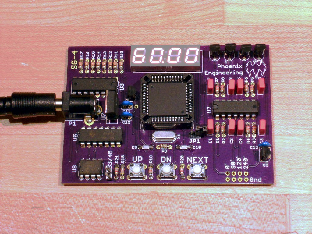

I received the prototype PCBs on Tuesday this week and built up one of the generators. Other than a few component changes, everything works as expected. The distortion improved a little from the breadboard version at ~0.5% (-46dB). The second harmonic is the most dominant.
On Wednesday, I completed the user interface for the frequency changing portion of the operating system. The phases are still fixed at 90/120/240 deg. I should have the user interface for the phase adjustments done by the weekend.
A preliminary video of the generator operation can be seen Here.

To reiterate, I have no intention of selling finished controllers or parts. I can "share" the PCB design through OshPark (board fabricator in Oregon) so that someone can click on a link and buy 3 pcs through them for $43.80 including shipping (~$14.60/pcb).
The parts kit can be purchased through Mouser electronics via a "shared" shopping cart that I created. Right now, the kit is $33 including the uP which is un-programmed. I was seeking someone that would buy and stock a number of uP's, so that I could program a group of them (at N/C), lock the security bits so my IP can't be pirated, and send them back for distribution/sale to DIYers.
All of the parts are through hole (the uP which is PLCC is socketed) and it took me less than an hour to build one, but it does require some soldering skill.
Some additional specs:
All 3 outputs are DC coupled from the op-amps, 5VPP and centered at 2.5VDC.
Freq range is limited to 40.00-70.00Hz for 33 RPM and 60.00-90.00Hz for 45RPM.
Freq resolution is 0.01Hz, crystal controlled (100 PPM) using a 20bit DDS core implemented in software. D to A conversion is done using 8 bit PWM running at 18kHz.
The 3 phases will be adjustable in ~1.5 deg steps, ±15 deg (±10 steps).
When the generator first powers up, the EEPROM will be blank; the uP detects this and immediately enters factory default mode to load all of the default parameters. JP1 determines if the default parameters are 50Hz/67.5Hz or 60Hz/81Hz. Factory defaults can be restored at any time by pressing and holding both the UP/DN buttons while applying power. JP1 is only looked at during factory default mode; shorting/removing it during normal operation has no effect.
Phase calibration mode is entered by holding the UP button while exiting standby mode. There are 6 separate phase adjustments: 90/120/240 for each speed (33/45).
