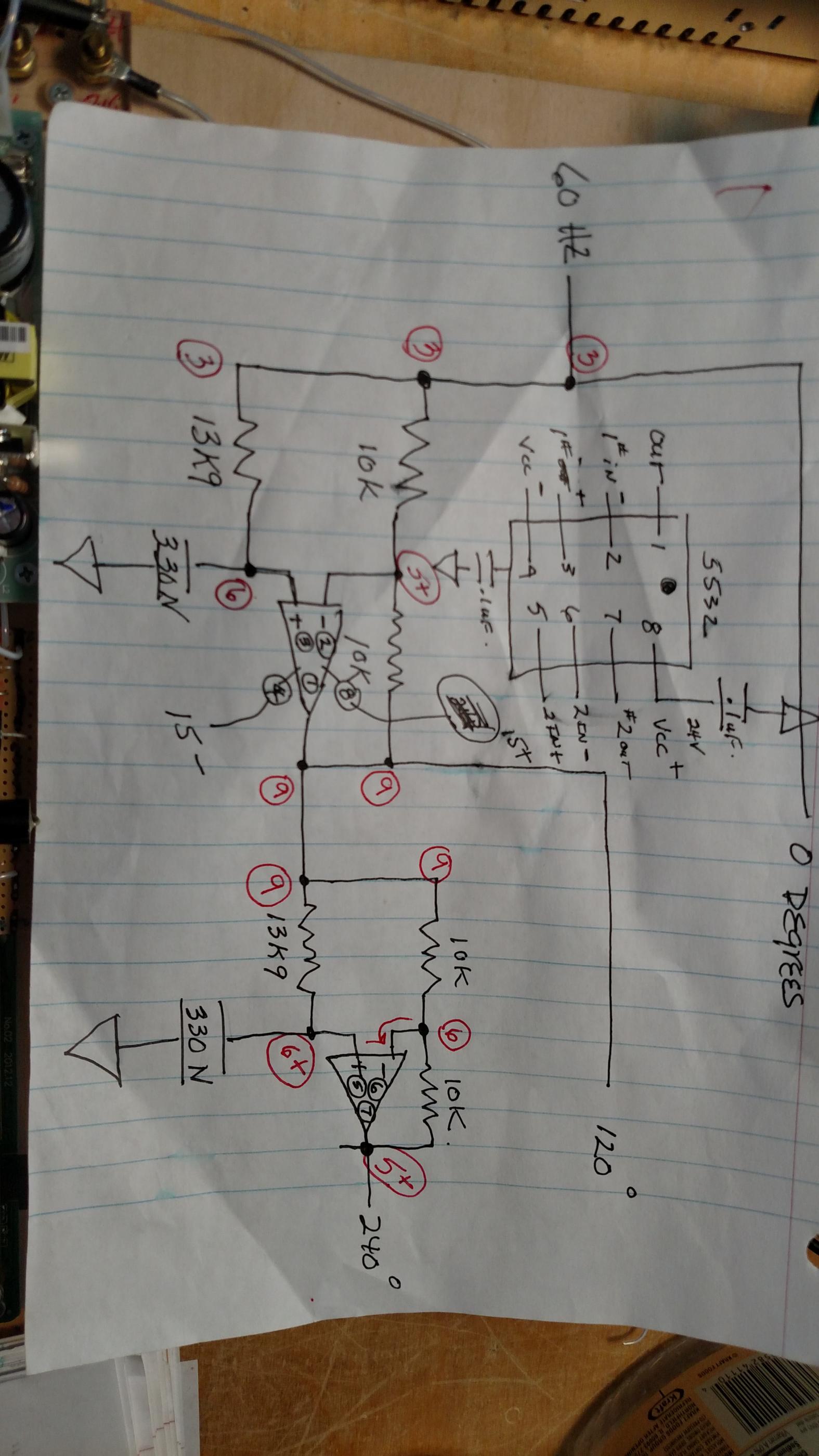

Hi Guys
Got the 3 phase motor working with the old generator. So I built a new Hans 3 phase splitter lower part of post 151. I put in +15 volts to pin 8 and -15 volts to pin 4. Also a .1 cap from pin 8 to ground as and a .1 cap from pin 4 to ground. The rest just like the diagram.
I am having a issue with the output of the splitter. The 0 degree is at .381 volts the 120 degree is at .299 volts and the 240 degree is at .299 volts.
I can adjust at Ralph's voltage divider/low pass filter before the amps but do not know what that does to degrees of the phases??? Any ideas???

Hi Tom,
Which op-amps are you using? If by any chance you're using single op-amps the +ve supply is normally on pin 7 not pin 8.

That's a good point Ralph.
But if that is not the case, Tom has to check the values of the resistors. There is no reason at all that 120 and 240 degrees are attenuated.
Both have a gain of 0dB.

I pushed the circuit thru ltspice and it does take some significant changes to resistor values in order to reduce the outputs of phases 2 and 3 by so much. Changing the cap values only move the phases in time, not amplitude.
Hi Ralph/Hans
I am using a ne5532p Texas instruments. Only using one suppose to be dual.
On the resistors the 10k are all 9.87k. And the 13.9k are both 13.72k. Caps are 317 nf/.317 uf.

Since the 240 degrees has exactly the same voltage as the 120 degrees, the error must be with the first op amp making the 120 degrees.
There must be some bad connection or short circuit.
What is the DC offset at the output of both op amps when you replace the 60 Hz at the input by a short circuit to ground.
And what is the output voltage of both op amps when you apply 1.5 V DC (with a battery) to the input.
Output of both op amps should be exactly the same as the input voltage.
Concentrate on the first op amp, there is the error to be found.

Can you check that resistors R3 and R5 are the right way round, i.e not swapped? This is the only way I can find that corresponds with the results you are getting.

Hans/Ralph
I do not know how to check DC offset. Do not know what it is. In regards to 1.5 battery voltage op amp check do you bypass the 13k9 resistor and put the voltage to pin3 and check output at pin 1 and same to pin 5 output at pin 7. I am assuming this is powered up and no 60 hz input signal.
Texas has their diagram with the + at the top of triangle and - on bottom. Hans has it the opposite. So I just hooked up according to the +/- signs. So the 10k is going to -2 and-6 input and 13k9 is going to +3 and +5 inputs.

I mentioned to remove the 60Hz connection and to apply a short circuit instead, but leave everything else intact.
Offset means, how many millivolts do you measure between op amp out and ground with this short circuit, so this is an offset with respect to ground.
With the 1.5 Volt leave everything in place, remove the short circuit and apply this voltage to the input. Then measure again what voltage you measure at the output of the op amp.
If you prefer, you could also send a sketched diagram with the exact information on pins, power supply and ground connections.

Hi Hans
Connected 60hz lead to ground and measured DC from pin 1 to ground 6.7 MV. Then took those leads and put 1.569dcv on input with 1.563 at pin 1.
Yesterday I tried different op amp no change. The generator was putting out almost 1 volt DC to amps so I put a 1 uf cap in series which got rid of the DC but no change in the voltage drop. I also resoldered the joints all around op amp again no change.
Put in picture of schematic I built from.

All DC measurements are correct, so most connections are OK.
Interchanging 10k and 13k9 does also not bring the ratio from .381 to .299 volt. So the only thing that remains is that the 330nF cap is defect or not connected correctly.
Take this cap out from pin3 to Gnd and put again 60Hz at the input with no cap.
If all 3 phases now have the same amplitude, it was definitely the cap.

Hi Hans
Hans you are one sharp cookie. Cut the ground on the cap in question and voltages are now close. Measured cap and it measures OK go figure. Of So I put in a new bigger size film 330 nf (343 to be exact). And we have success.
Did solder joint twice and cap measures fine out of circuit. It was only a 50v tant cap??? Well it is going in the trash!!!
