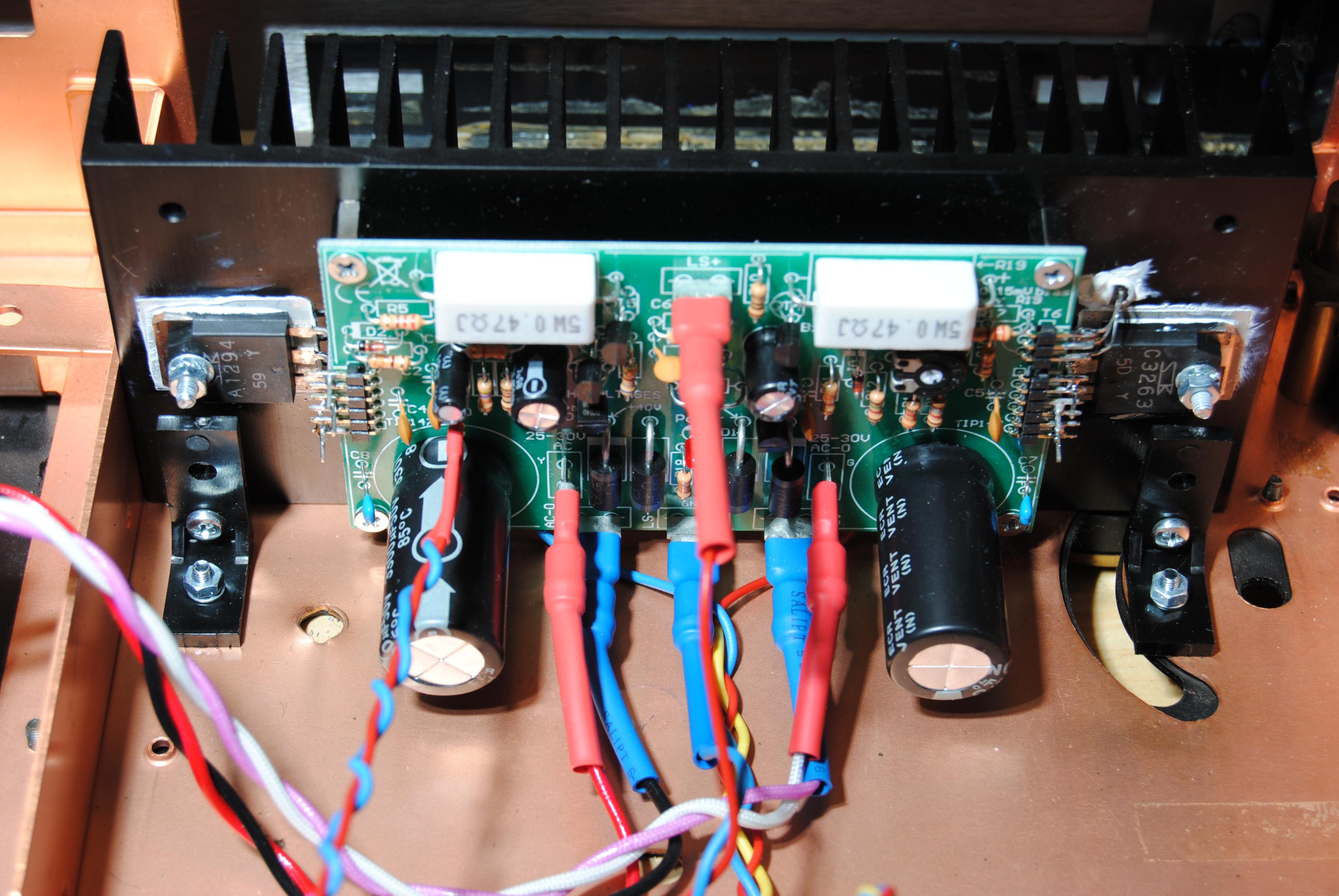

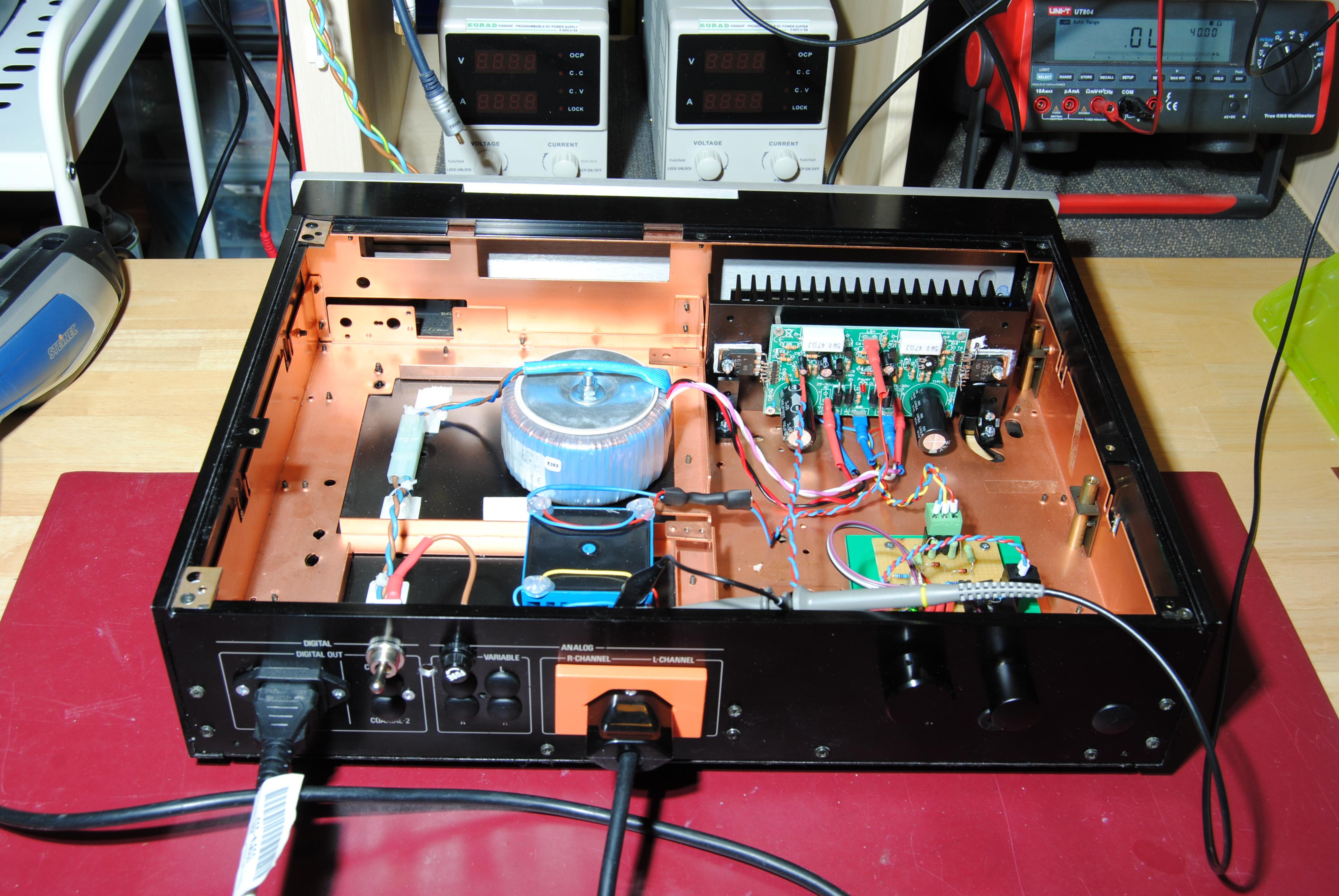

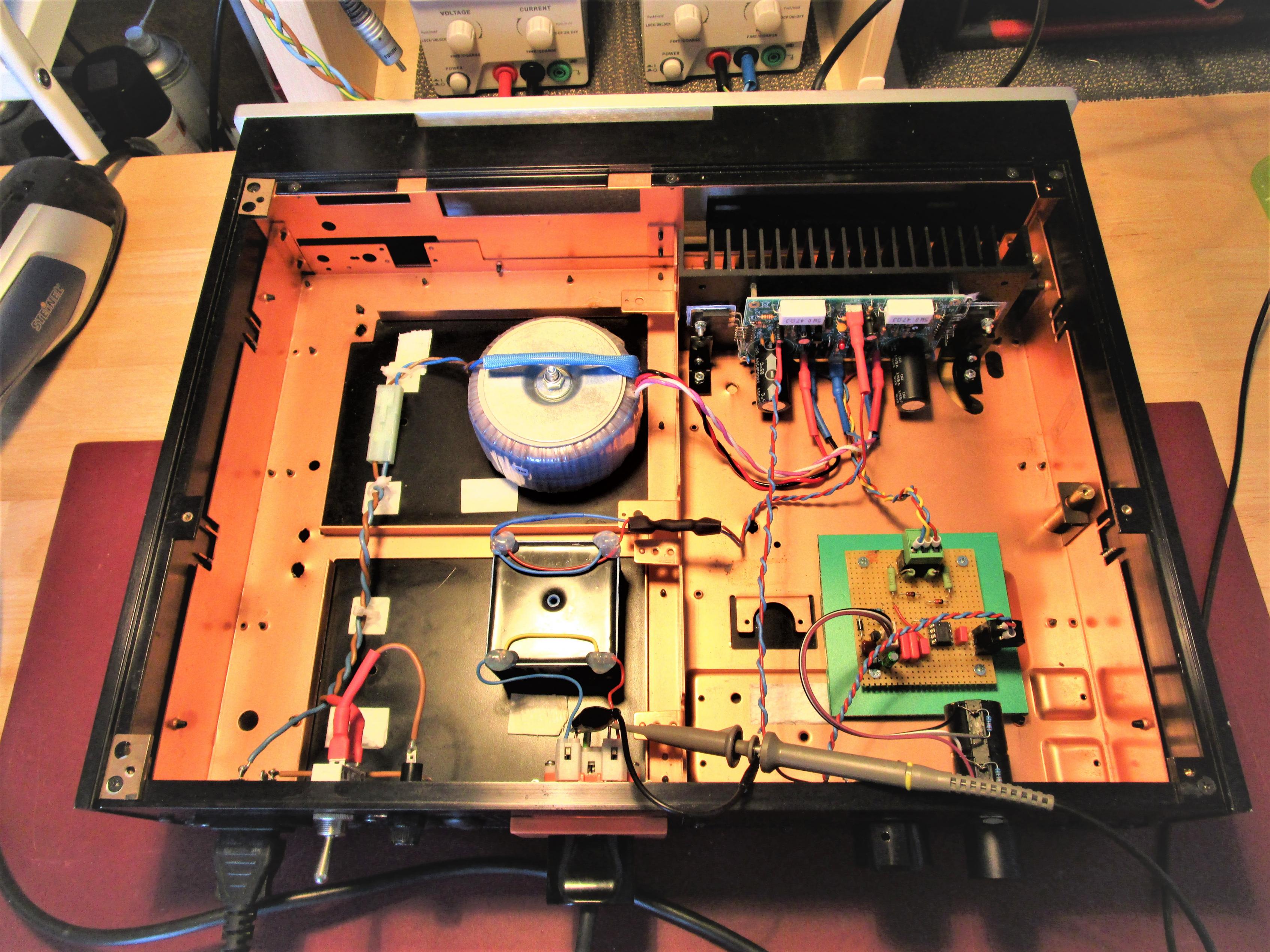

I used well discussed here parts and finished my TT motor controller. Thank you all.

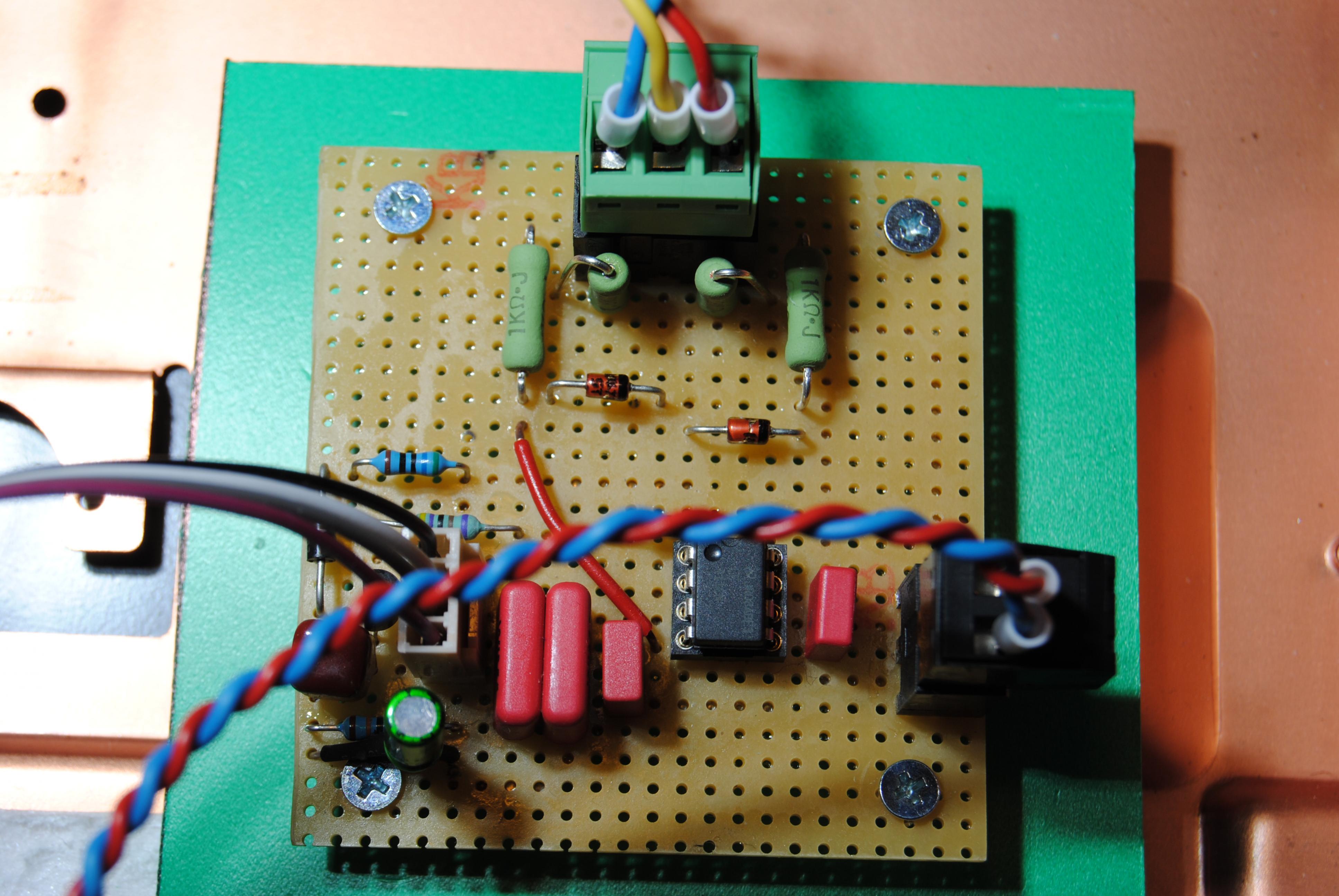

After reading this thread I decided to try a generator feeding a power amp terminated with a transformer.
Initially I bought one XR2206 rig that did not produce good sinusoids and also tried one 555 build with even worst results.
So I decided to build a wien bridge with a fet instead of the usual lamp used to control amplitude.
I finally decided to use a very large Vp fet as it is better behaving as a voltage regulated resistor.
Many experiments where needed before I could find a good solution but now it works as intended.

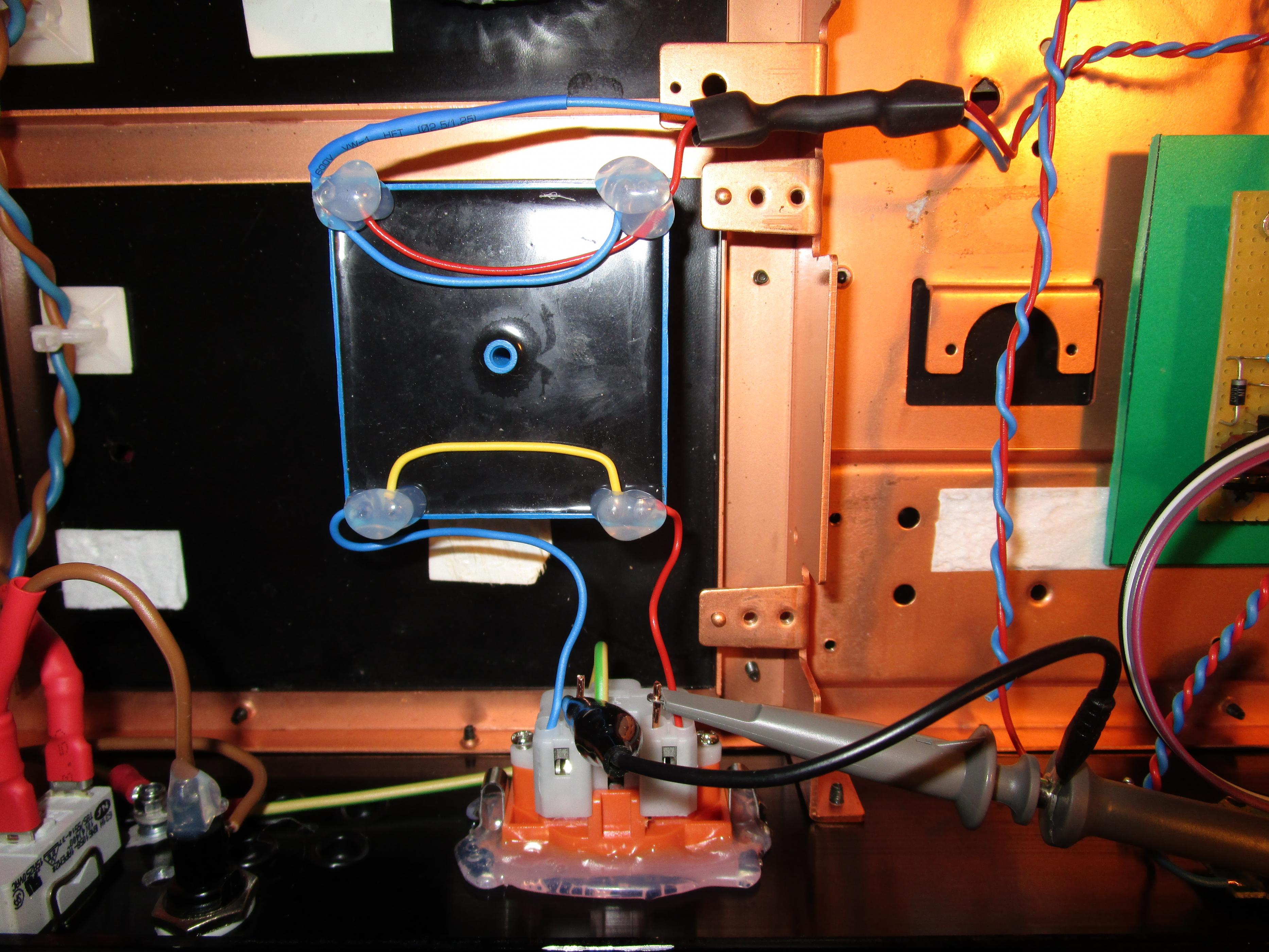

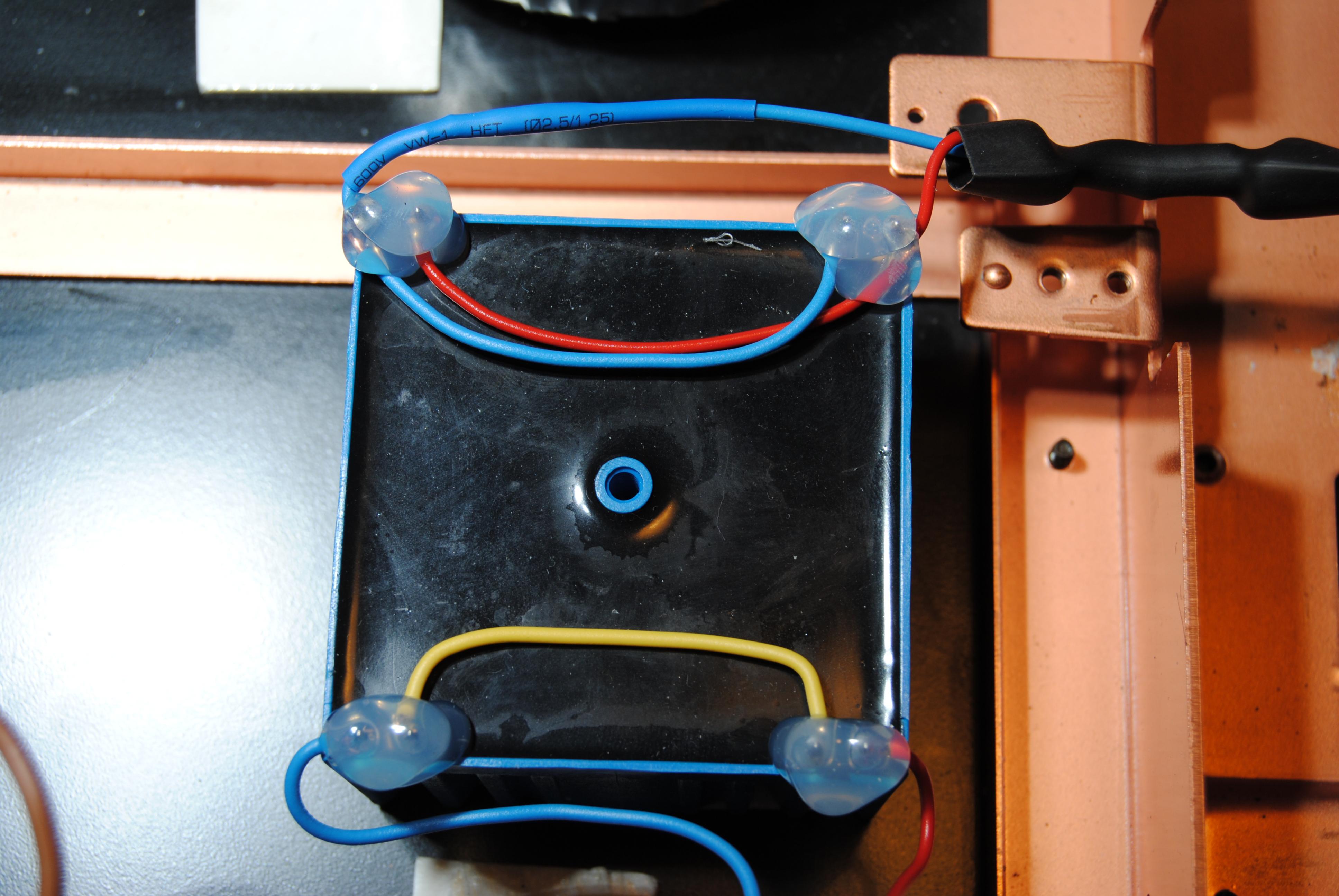

I am feeding the signal through a pot into a 100w power amp and placed a 12VAC to 220VAC transformer in the output.
Now I can not hear or feel any vibrations coming from the premotec, the pitch is perfect as I can set speed accurately and I can control the torque using the "volume" pot installed at the power amp input.
Next action will be to build a phase shifter, add a second power amp and see if it improves the matters even more.
