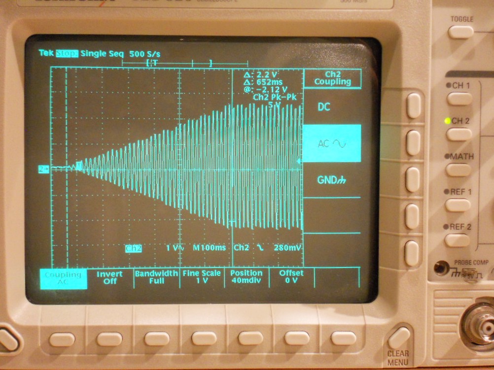

Here's how I completed my soft start circuit. The circuit works almost too well, instant reaction to a bad brown out or not using standby. The 39 R can be made larger as a ratio to make sure it is not too sensetive ( 56 R 220R R, or 82R 220R etc ) . The 2 x 10 V zeners are part of the oscillator so a free lunch. There is absolutely no thinking needed with this circuit. It's just is too quick to be caught out. The 26 V I have is quickly discharged and is regulated. Some allowance has to be made for the PSU used.
I really have no option on my PSU, I have to do this. I am using a DPDT 24 V relay of about 1K5 resistance 1 amp rating signal switching type ( double contacts for less risk of failiure, BT type if UK ). If could run as many FET pairs as needed. Add extra switches to reset as required ( standby ).
The BC327 should be OK run this way. One could use a small power transistor. Vce is almost zero ( 13 mV ) . BC327 is a very high gain, high current and low noise device, my default device for most things.
Here is the gate voltage at 2 second intervals. The first chop is the mains brown out. It has a 0.25 second period to act which usually is fine, any faster might be a problem. The next is standby or speed change which is nearly instant. Gate ripple is 1.7 mV pure sine wave. It is in phase with main output and not directly related to the mains. First 1.5 seconds is mains plug in. The Brown out action is at 23.8 VDC out of 26 VDC. The action is not unlike an ideal comparator with hysterisis of about 0.1 V. Not bad for something not asked for. If used with an unregulated output make sure the upper resistor covers exspected voltages.
