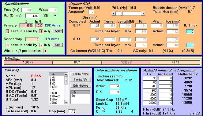

OK, made some transformers for the 801 amp described here: http://www.diyaudio.com/forums/showthread.php?postid=1551490#post1551490
The design is shown in the attached pic.
I learned at least two things:
I can make transformers
There's more to it than meets the eye.
The first transformer I made had a hf roll off around 60kHz, and very nice 10kHz square wave - nice shape and just a little ringing. I didn't do a very good job of getting the margins for the secondaries, as described by Bud. They tended to cover the bobbin end to end. I got better on the second wind, and everything was a little neater. But the performance was worse - 41kHz roll off. OK, let's try a third, neater still. This one had the 3dB corner at about 35kHz.
Now, I'd rather duplicate the first, but either of the last two is probably OK. However, I don't like the variation, as I should think that consistent phase response is desireable for good stereo imaging.
I like these little amps, and I think they deserve some good iron. It was fun to wind up a couple of OPT's but I don't want to spend much more time learning the subtle nuances necessary to get consistent results, much less shoot for a specific target. May have to get a couple of cores wound up. Bud?
Sheldon
Sheldon

Thanks for the reply Bud. I wound as follows:
500 turns primary, in several layers like a fishing reel. Tried to get close to one layer of wire with each pass across the bobbin. No insulation between passes. End to end layer.
Then one layer of high voltage fluorocarbon tape (about 0.03mm) and one layer of friction tape (about 0.3mm).
Then 48 secondary turns, single layer perfect lay, about 2-3mm margin on the ends, followed by the same insulation,
Then 1000 primary turns, then insulation,
Then 48 secondary turns, insulation,
Then final 500 primary turns.
Oh, and I put a piece of the high voltage tape over each lead coming out, where it could contact the other winding.
Sheldon
Hi Sheldon !
Great job indeed, and good results too !
You will probably obtain better (if really needed) hi freq response by splitting the primary so that the first and the last section be half the thickness of the inner one.
I suppose you already tried to use "SPLIT" button in the green area ?
I can't check myself cos I'm touring in CA
This night Ventura, then to the north along the coast if there are no fires
Yves.
Yves.
