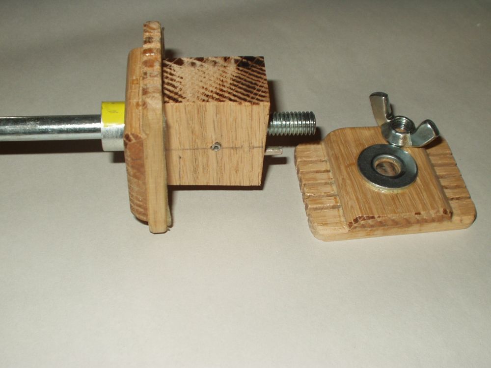

blindsjc,
Here is a pretty simple to make winding form, that can be used for open wall, paper section, or bobbin with walls, winding. The wood is all oak sheet, with the grains at 90 degrees between end panels and supports, for strength. The center section is glued together and final sanded (and is actually square, though it does not look like it in this pic).
Hardware is a long bolt with the head cut off, a screw lock collar to hold the back plate up against the center block, and three tension pins. One in the central block back end, into the plate held by the collar, one through the bolt and out both sides into the central block and the one you can see that locates the removable plate.
We use these wooden winding forms exclusively now, having moved from all metal ones .They are cheap and easy to make, with simple tools and materials from your local hardware supply store, if that is what you call them where you live.
This sort of winding form will eliminate many of the difficulties you will run into while learning this art form. All of our hand fed winding machines have drill press chucks and the long bolts we use are 8 mm in diameter, so they fit in and can be clamped using the drill chuck key to tighten it .
Bud
Bud
Hi Bud,
Thanks friend, this will fit perfectly with
the diy winder that I'm building, I was lost
in how to keep the reel secure while winding,
your idea kills the problem.
Take a look:
http://server6.pictiger.com/img/688711/picture-hosting/diy-winder-.gif
At the (A) will be the source of copper wire.
The wire pass in a pressing wood (D) with a
soft clothe that keeps it in some tension.
And then is winded at the (B) where I will
use your solution.
Finally, the (C) is a mechanic counter that
works when the (B) is winding to keep track
of the turns.

blindsjc,
I am going to assume you are left handed and plan to sit between the tension device and winding arbor?
If you actually need a tension device you may find that felt pads, the very fine felt used for grease seals in some equipment, squeezing from both sides will be best. You will not need any more tension than that supplied by your fingers guiding the wire, for most wires.
You will want a drag on the spool also, just to keep it from over running and jerking.
Eventually you will put a large diameter pulley on the winder and a tiny one on a 1//8 horse power brushless AC DC motor. This will cause you to learn how to build a solid state infinitely variable motor controller, using a guitar amp Wah pedal as the potentiometer.
Then you will be like the rest of us.
You should not spin fine wire spools. If you leave the paper wrapper intact, mount a ceramic eyelet on a piece of wood and clamp the wood on top of a plastic bucket, to confine the wire whip between spool and eyelet, you will have a better dereeler than a spinning wire spool. Twisting the wire is not important here. In fact, after a number of battles with magnet wire, trying to get it to do what you want it to, you will begin to feel satisfaction in twisting it
If you want pics of simple production equipment, as you try to find answers to the problems that you will face, I can provide them.

Hi Guys,
The wooden form is to support the bobbin, very snugly, to keep the wire from deforming the bobbin during winding. This will help keep the bobbin from being deformed later, after it is off of the winding form and the wire begins to relax and change the pressures within the winding. We use onlycommercially available bobbins as our transformers are all CE 6500 safety standard rated.
blindsjc,
blindsjc,
