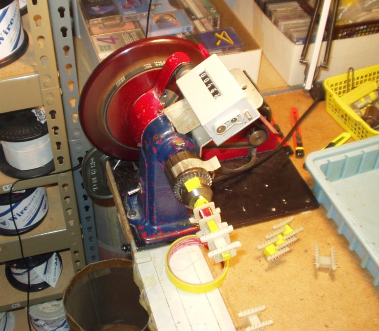

resident said:
Yves, your winding machine is really great! :bigeyes:
Does the meter count backwards too?
You're welcome !
The meter was bought as is, and, no it can't count backward.
It receives pulses from the Hall effect sensor.
When I need to roll "backward" I flip the bobin :xeye:
I have downloaded your files but I didn't find any schem for the meter. Also I can't open the .png files. What program is this?
Can't tell, I copied this files from another site, Paint Shop Pro can open'em.
Yves.

Thanks Bud for all of the information!
I'm thinking seriously to transform that sewing machine into a winding transformer machine 🙂
The motor works great and it has a pedal to control the speed!
I need to find some small wheels and a meter to complete it! :smash:
My plans is a small wheel after the motor and a bigger one after that. So "action" won't be so hard! Like it'll be directly from the motor....
I'll try that Fender/Marshall winding order maybe for a Bassman or Showman clone! It'll be great if I can wind it and have a good result!

resident,
I design for flat (-.5 dB) at 60 Hz. This puts me at -3 dB at 40 Hz which gives plenty of low end power. This is the portion of the signal realm controlled by reactive impedance matching.
This is the addition in parallel of Rl and Rp and then adding the primary DCR in series to that sum. Then divide by 2 pi and the frequency you are interested in and this gives you the amount of inductance you need for - 3dB at that frequency of interest.
Core material has a hump to it's permeability and inductance is tied to this hump. Utilizing this hump to obtain the required inductance Vs frequency Vs power is part of what you must learn. Too much inductance is as bad as too little, but the sweet spot is fairly broad. We can cover this later. For now, use Yves calculator, as it is quite good and will teach you the correct range to be in, for best performance.
Your plan for a small pulley to large is a good one. Use as thin and flexible a belt as you can find. Here is a picture of our hand guided style of winding machine. The stand is a cast iron plain bearing pillar. The main shaft is tapered for the three jaw chuck. The large flywheel is made from phenolic, is very smooth and has a hand grip edge, out side of the pulley. We have them made at a local machine shop for $50 each,
Having the hand grip available and smooth will improve your winding ability enormously. Do not be tempted to use wood here as it is just too abrasive. Also, note the woven white fiberglass tape loops on the table edge and the same white tape background up on the table. All are important and the coil wire is fed up through the loops and then through the winders fingers for control. The motor is an 1/8th horse AC/DC brush style motor.
Bud
