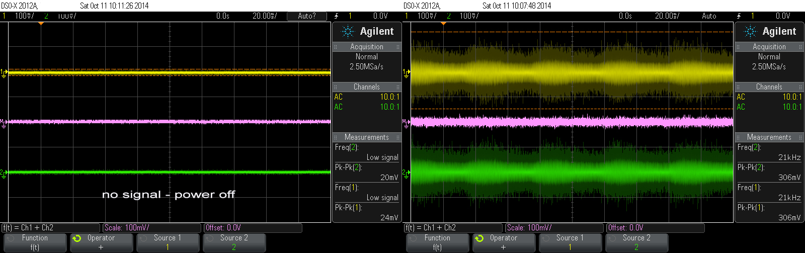

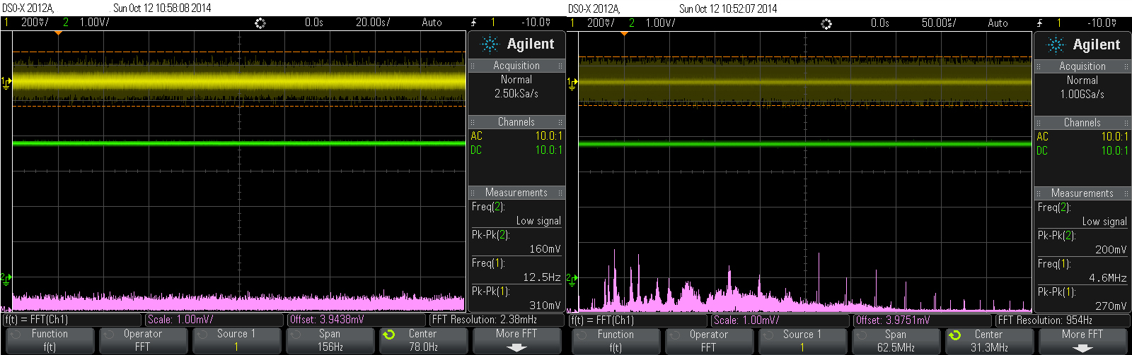

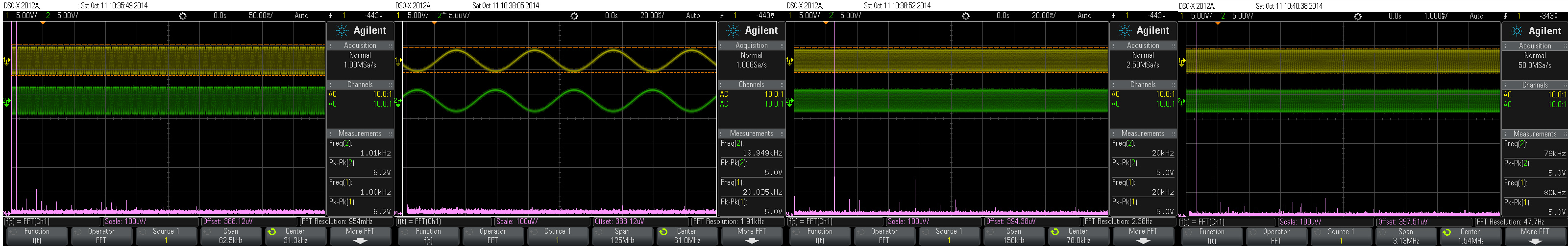

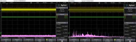

I think this is the right way to measure the noise on balanced outputs (one probe on each of the differential lines)...
Added the differential signals, the noise is low as approx 50mV for a approx 6Vpp useful audio signal. Please note that no filtering is in DAC analogue post processing signals.
I took also some FFTs in this measurement configuration. The test signal are -1dB. I may say that it looks quite remarkable, with noises under 100µV for 5vpp on outputs...
Welcome your comments...

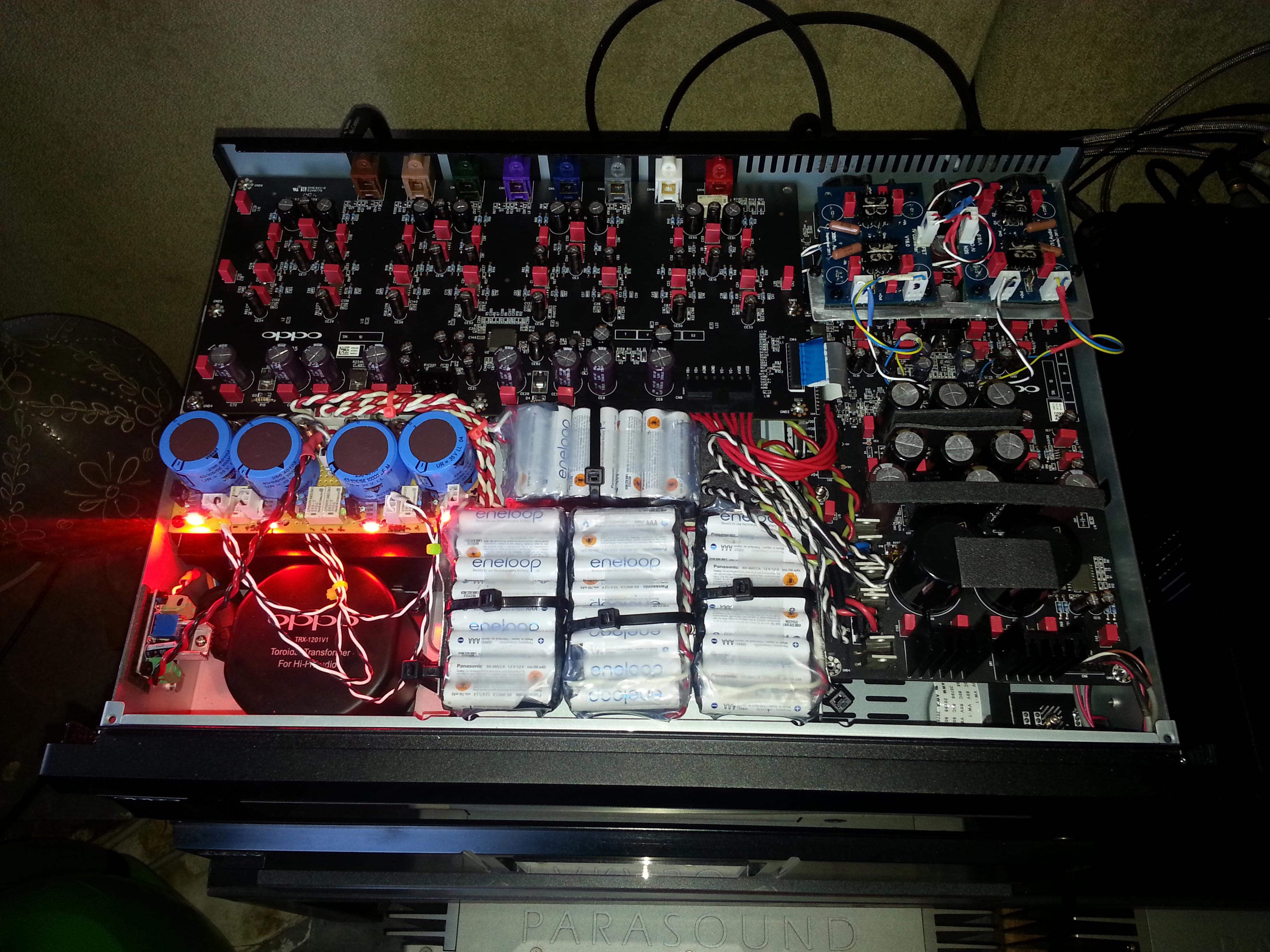

Hey Coris,
The 4+4 implementation sounds impressive... that inspires me to try this one day in the future...
So far, I have been persuing the SEN route and have fully implemented it.
So far it sounds awesome much richer and true than the stock. My description is that when I hear truly high pitched sounds, I do not have to brace myself for it sounding harsh the top.
The midrange sounds more multidimensional and the bass more committed and precise rather than vague.

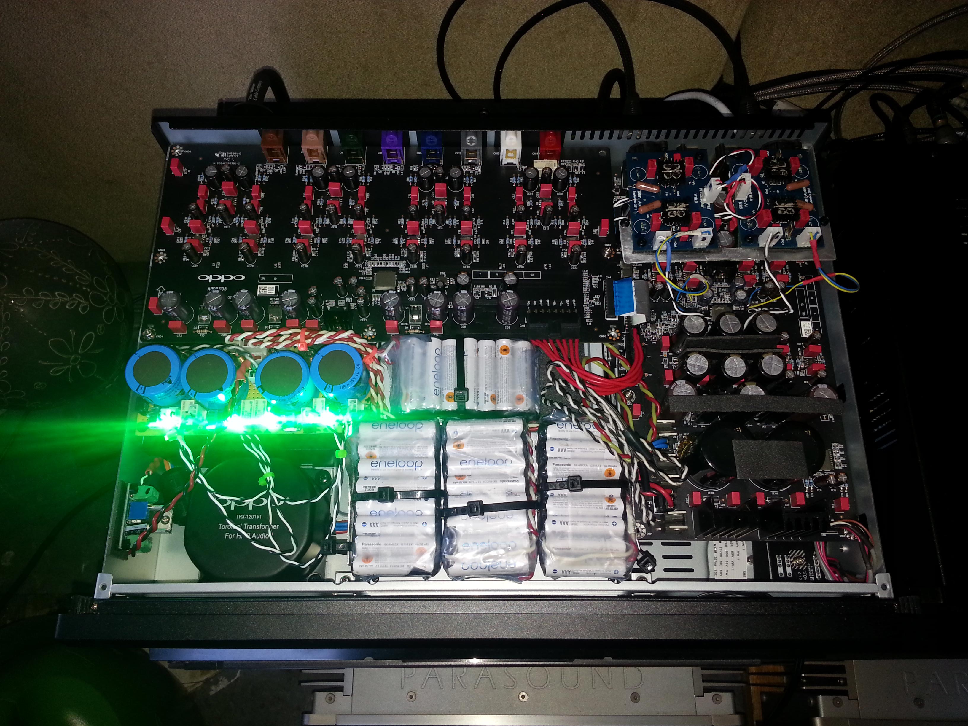

Installed a new set of balanced outputs so the original is still in place and operational to allow comparisons.
LEDs fully operational - Amber... batteries charging, Green - playing
LC filter circuit in case there is any distortion/noise from the battery power supply.
Getting used to it...
Future plans... have Coris' batter clock module ready to be installed - can't wait.

Well, well... you may have now a brilliant sound...😉😀
It looks like there is not so much more place for the clock board...
Else, yes you may experience 4+4... Do not forget to adjust then the I/V parameters...

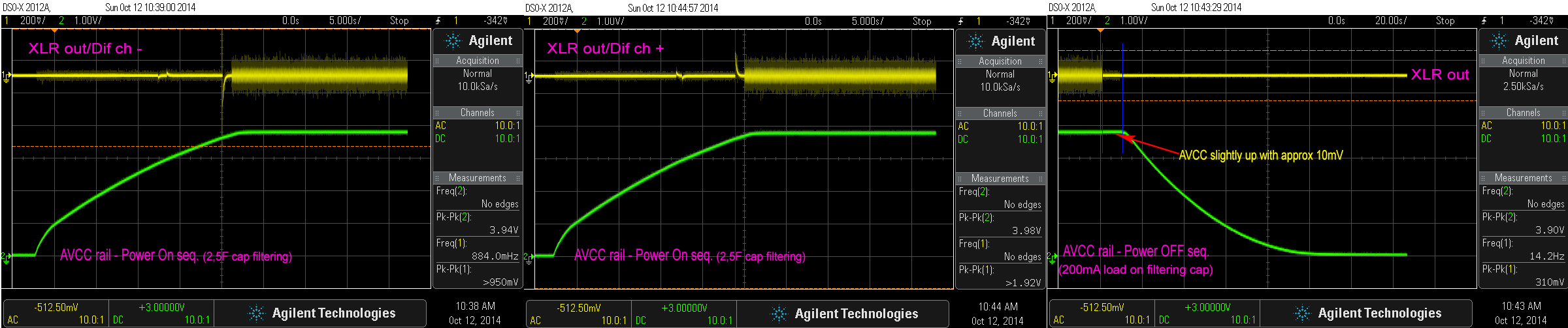

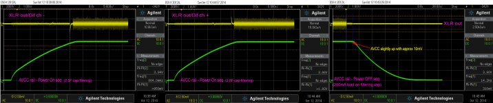

Some more detailed measurements on Power UP/DOWN sequences, and about HF noises on XLR outputs.
This time I was more accurate, and I have connected the probe via BNC connectors to the XLR output pins.
It seems that he modulated noise I have seen earlier (previously pictured), it may be caused by measurement issues. The modulation to be seen in the previous scope snapshots is about 50Hz, and it seems to be the usual AC main captured noise. The same modulation is gone in this measurement setup. The residual HF noise from the DAC (no filtering in signal path) it looks like continuous (no modulation), and it is located/concentrated in the 20-30Mhz area. There is no any special noise/signal in the low end of spectre (150Hz).

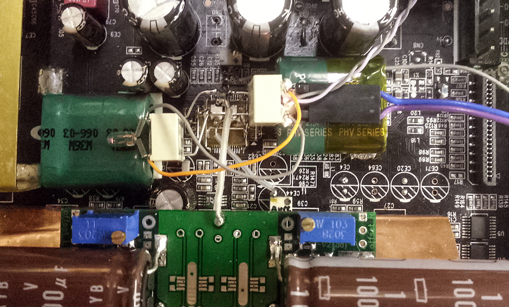

The second power rail for the analogue stage of the DAC chip (1,2v) have got its very large cap too...
A fully remarkable improvement for the soundscene dynamic, and its definition/resolution. Very precise location in space for every single sound element. No more confuse location for the low end spectre sounds, but only precision. Increasing in dynamics it just make the music be felt, experienced as in a life event, just in front of a band, or in the first row in a concert hall. Very impressive!
What is to be seen in the picture is only experimental. I have already in mind a dedicated PCB/layout for this analogue power stage of the ES9018 DAC. Very low noise regulators on board as these or even higher capacities too.
The only problem with this mod is that the power pins of the chip have to be disconnected from the original PCB (lift it up)... Well, for me there is not this a big problem...

A very small board with two lowest available noise regulators on it, and the decoupling caps (in Farads range) for AVCC and VDD L/R (fixed 1,2v and adjustable 3,3v) of the ES9018 chip, will be available soon as a single PSU module. With two such modules there is possible to completely power the ES9018 DAC chip, on all its power pins (analogue/digital), for the highest sound improvement level...
A complete and fully differential (balanced) stage, I/V & final buffers, with ultra low noise regulators on board, and optional choice for filtering, or straight signal path output, will be available too, quite soon...
I would like to point out on something about eventual noises appreciations in video stage of the player. There are many factors which contribute to such noises on the picture. Part are sourced by the device/circuits itself, and part it come from the qualities of the material (digital signal) used for tests, or test procedures, or even the subjective visual appreciation of the user himself.
As usually there is not enough with only one modification to cure or solve an issue. or to increase dramatic the quality level for the device functionality.
An important source for noises in picture/video it consist in quite high thermal levels of the main circuits involved in video stage processing.
I have named it in a previous post, mainly as a joke, about an "ultimate" modification for this player. But beyond the joke there is a very real fact: cooling the environment the video involved devices is working, improve a lot the quality of the picture. There is a very simple modification, but very efficient for the quality of outputted signals.
The main processor low thermal working regime is essential for increasing the signal quality for both audio and video stages. There are two ways (both should be used) to establish a optimal thermal regime for this main device: a better heatsink (it will transfer the most of the thermal energy from the chip to the near environment), and a airflow to remove the heat from the enclosure. Only one component of this system is not enough for optimal result. Initially the Oppo designers thought right to use a fan in 95 model. Only the implementation of the idea was wrong...
In 105 model, the natural air flow is hardly realized inside the enclosure, and therefore inefficient to do a good enough ventilation. Also the heatsink for the processor is under dimensioned.
I strongly recommend this very simple, but efficient mod (see the previous post) to lower the thermal working regime for the inside components. Lowering the enclosure inside temperature as much as possible it bring to all other modifications a new level, and leads to quite high overall results.
Mainly I was focusing along the time on modifications to improve the sound of this device. Improving the image stage came as a consequence of the other implemented mods in my player. Part of these mods was presented here.
As for sound, I may conclude, after a long series of modifications in this area, thant the best ever results come from the improved power system for audio stage, a better clock system, a better/cleaner power for DAC chip, and improvements for the post DAC signal processing. But the biggest improvements for audio it come from the 4+4 DAC output configuration for stereo output. When this 4+4 configuration is directed to the differential/balanced outputs, the improvements are even higher.
Most of the users of this player never use the headphone output. Two pair of the DAC outputs channels are dedicated to the headphone out... Quite stupid, in my opinion.
One can decide which kind of output prefer (balanced or unbalanced) and dedicate all the DAC output channels to the chosen final output. In 4+4 configuration the DAC it give its highest quality level... Well, with some other improvements around it...
I`m working now to design and produce a dedicated PSU module for ES9018 power rails/system. After successful experiments with very large capacities on the DAC chip analogue power rails, I decided to do this mod in a real professional way.
