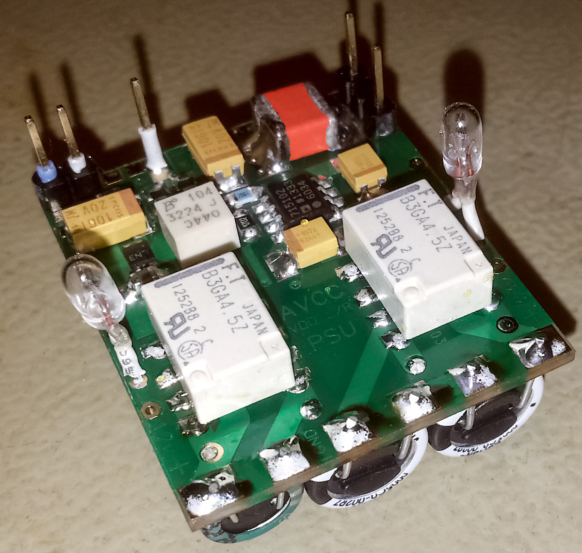

The final version of my AVCC/VddL/R PSU is now up and running...
It use a total capacity of 2,5F (60mOhm ESR) for AVCC, and 3F (80mOhm ESR) for VDD L/R. The regulators: AVCC - ADM7151 (adjustable), Vdd L/R - LDLN015 fixed 1,2v Input power: no more than 5v. Discharge circuits are protected by resettable 200mA fuses. Board dimensions: 35/30 mm
The module power lines are independent, with separate grounds. The grounds are to be connected together at the power ground point(s) of the DAC chip, using of course, the shortest possible connections.
Two such modules it can deliver the low noise power for the whole ES9018 chip.
It use a total capacity of 2,5F (60mOhm ESR) for AVCC, and 3F (80mOhm ESR) for VDD L/R. The regulators: AVCC - ADM7151 (adjustable), Vdd L/R - LDLN015 fixed 1,2v ...

Hi Philippe,
I have placed the caps after the regulators. The caps role is more as decoupling caps for the DAC chip`s power rails. Well, a so huge capacity it can do the job as everything... But it looks like the best role is to simulate a battery for the powered device...
The actually role(s) of these very large capacities in this configuration, it can be discussed quite much. The fact is that it improve a lot the sound performances of the Sabre chip.
I was myself quite sceptic and enough prudent in the beginning to use such caps. I did it gradually, using bigger and bigger capacities (but small dimensions). I have observed that the quality of the sound it improve every time, as bigger the capacity was. This my observation was also confirmed by another member here, RayCtech. There are also some limitations in using large capacities, and one is just the longer needed time to get these caps charged. I found these values I use on my board as enough practical for the purpose.
I was also thinking that such capacities it may be a serious challenge for any regulator device, and of course I have read the datasheets of the regulators I used. In theory no any producer recommend using of Farad capacities at the regulators output. But what about to try it? it works well, no harm and the DAC power rails it benefit of a very well simulated battery power. It seems that the regulators role in such "design" is more as charging device for the huge capacities, than as a regulator device. Well, it may not be just necessary to use very low noise regulators in this configuration, thinking that the Farad cap it will kill any possible noise. Well, I`m not very convinced of such thinking way, so I prefer to use the lowest possible regulators for this task. Of course, paralleled with some good quality small capacities.
There is no any timing issue whatsoever. Well, there are some clicks and pops while the Sabre DAC it get the power increasingly in a slow way. But these noises it exist however while a fast power up sequence. That for Mute function and relays on the device line outputs... The problem is that the power up sequence when using so large capacities it exceed the delay time of the designed protection functions of the player. But I have establish my routine to start up the player first, then the amp, after a while...
In the beginning I could not know of course, how ES9018 it will behave at this slow power up sequence. I took some risks... The chip accept well such "power on sequence", as it accept the over-clocking "torture"... Just a wonderful chip design!
At least this DAC chip do not need special power up sequences for analogue rails. As I could notice so far...
The loading of the 3F cap it take approx. 15sec. There is not only the charging time a possible issue for a regulator device, but the discharging too it may be more dangerous, as it keep a tension on its outputs, while the input is gone. Well, it seems that the designers of the regulators did a very good job, and the devices are quite well protected. At least these I use on my board... However, I do not want to play with it to switch it on and off without discharge first completely the Farad caps...
As a conclusion: everything it works just fine in this configuration, and the results are quite spectacular when powering ES9018 so.

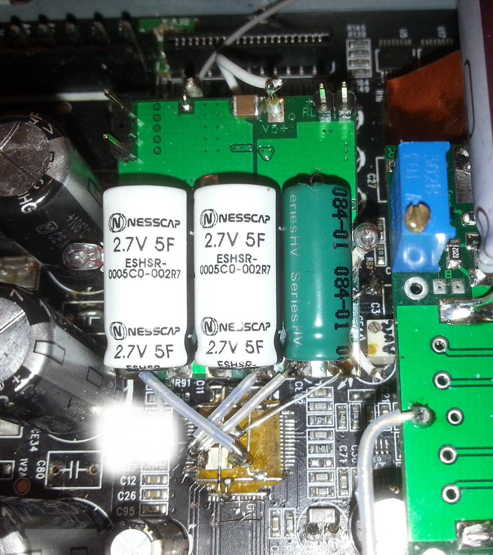

Implementing the Sabre PSU board...
So, the board in its place, connected to the ES9018 chip.
I used the existing/original AVCC regulator, and modified it to be adjustable for a 5v output. This it power my Sabre PSU.
I think I may precise and correct some informations in my previous post.
I have tested my PSU with a lab power supply, which it have large current capabilities. In this configuration my PSU it came up to the normal levels, in approx 15sec. When using the power configuration existing in the player, my board it need 35sec to finish the charging of the large capacity caps (for AVCC, while VDD it come up in 5sec.). This because the LM1763 used in original AVCC PSU it limit the charging currents in its particular way.
It looks like the large capacity caps I planted on my PSU board are better quality, than the caps I used in my previous experiments. The discharge time using the same type loads is longer (up to 2 min.). The PSU board is provided with a port for connection of an external load device/lamp to signalize the complete discharging of the caps.
However, the charging/discharging time is a marginal aspect for the functionality of the PSU board, when using these very large capacities.
The increasing in quality for the analogue power rails of the ES9018, using these very large capacities, is very obvious for the outputted sound quality...

As one may notice from my previous post, for improving (in my way) the power system of the DAC chip, it involve a separation of the DAC power pins from the original power system. This mean a delicate operation: lifting up the involved chip pins.
In my previously published pictures one can observe the connections of the power pins of ES9018, are made using soldered solid (silver) wires.
I may say that in the last time I have developed a more professional technique which allow this (power mod) operation to be more easy done, with higher quality results, and less risks. I will publish a picture about, when the main component of this mod it will be produced, and the modification implemented.
