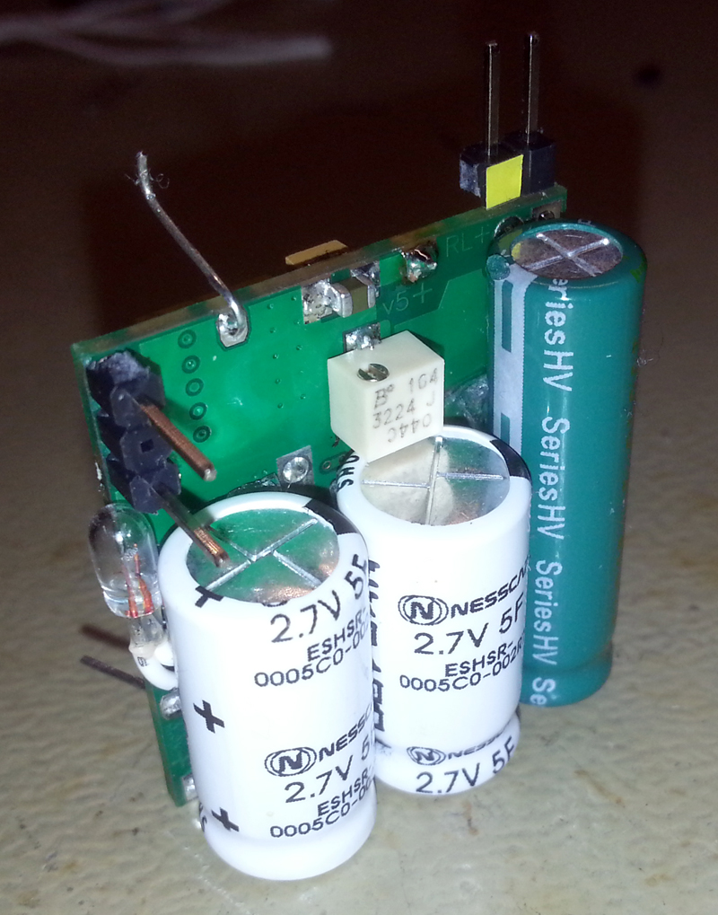

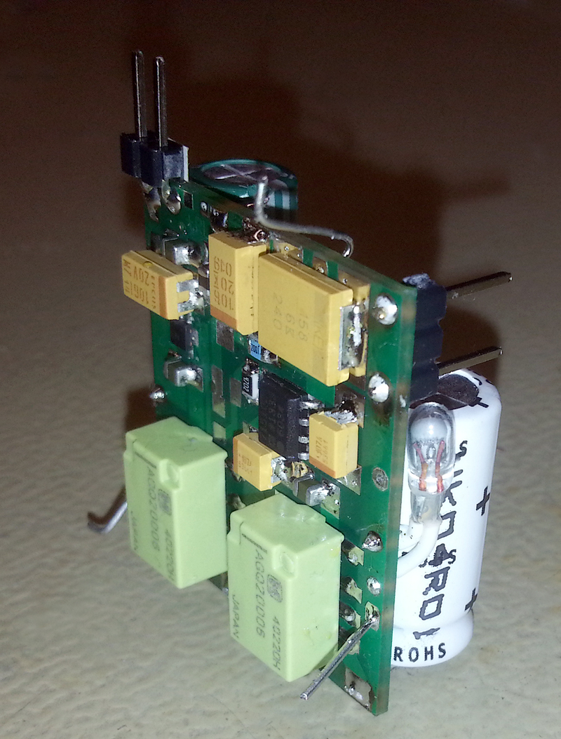

First I want to advise about some aspects for everybody who may want to experiment with such capacities on AVCC-VddL/R of ES9018 (or whatsoever device).
The huge energy these caps can store, it may be dangerous if one do not take some precautions. A short heaving these caps as power source it mean a 10A or more. Such currents just blow up and burn everything in its way.
The original regulators on 105/105D, and even 95 it support the rush in currents, and work well with such caps at their outputs. But, the most important here is to isolate the DAC chip from the original power rails on AVCC and VddL/R, before doing any experiment which involve these regulators. If it happen something wrong and the regulators fail to keep the right tensions, then the DAC chip may be damaged. The AVCC is 4v tolerant by the book, but VddL/R it have to be exactly 1,2v...
So, isolate the chip from these power rails, mount these Farad caps in right places, and observe the regulators to have the right tensions on the outputs. Use some loads to verify that they are working well. Then and only then, if everything is safe, connect the DAC chip to these power rails.
When using such capacities, there is a must to have a (fast enough) discharge circuit connected at once the system is powered off. Please take into consideration to correlate the current capabilities of the relays to the discharge circuits. The relays contacts can easily be welded if to high currents, and then the low impedance of the discharge circuit can be at the regulators outputs...
I do not think the Mute signal used by the output relays it may be the right one to control the discharge relays and its circuits.
For such control the best way is to use a power line which is up at once you press the power button, and goes down at once the player is turned off. I will suggest to be used the power line (15v ) which activate the analogue power relay. Another power line it may be that used for USB ports of the device.
Please have in mind that the quite slow ramp of the AVCC and VddL/R, when using such powering way, it produce some spikes, which are audible on outputs, if the amp is already up and connected while power up sequence. So connect or start up your amp/preamp after a safe delay of time.

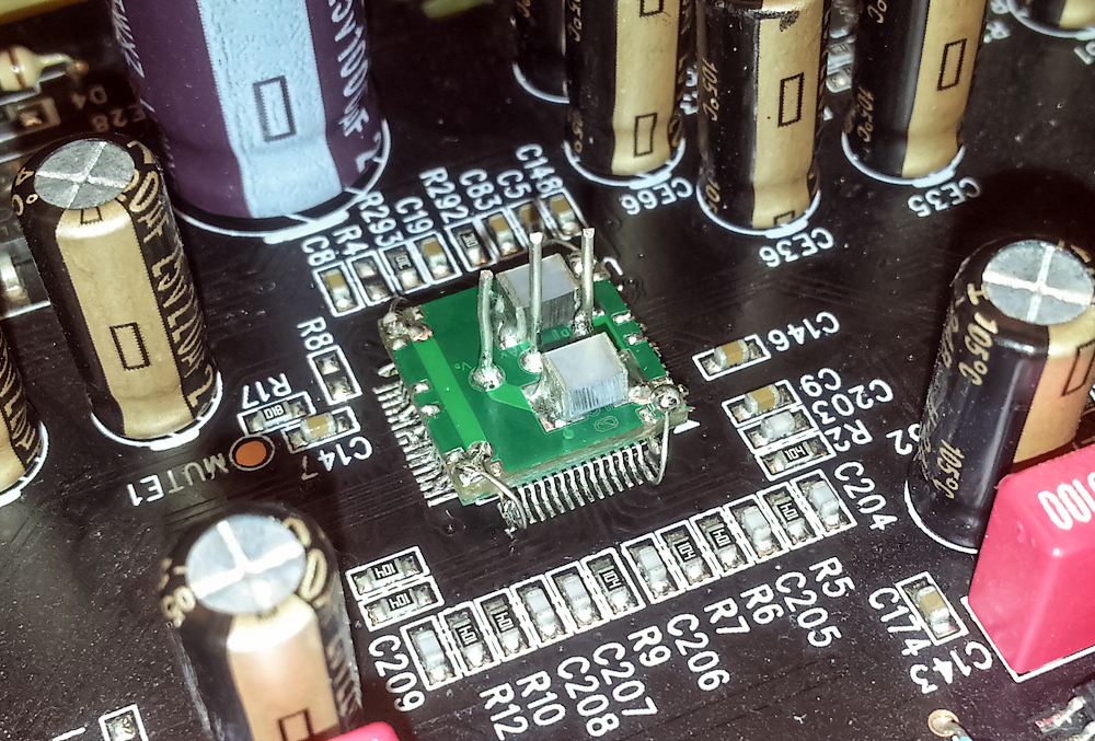

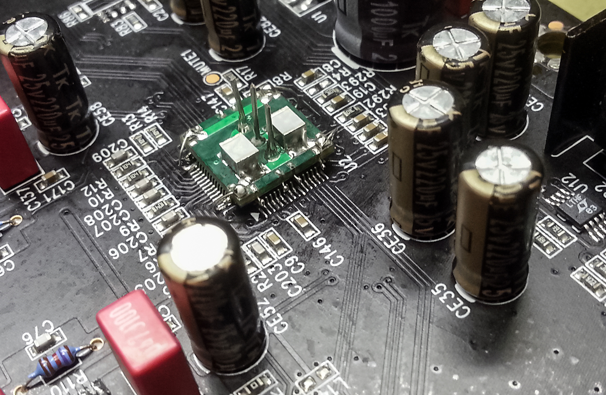

First step in my Analogue Power mod for ES9018 (a more professional approach...).
The small 4 layer PCB it help to connect the chip`s lifted pins to AVCC and VddL/R connections points, as to the AGND. The board is glued on the chip and its bottom GND plane it is also a shield for the new power connections. So, the analogue pins it can be connected further to a different/customized power system.
As you may guess, I will connect to it my large capacities PSU...

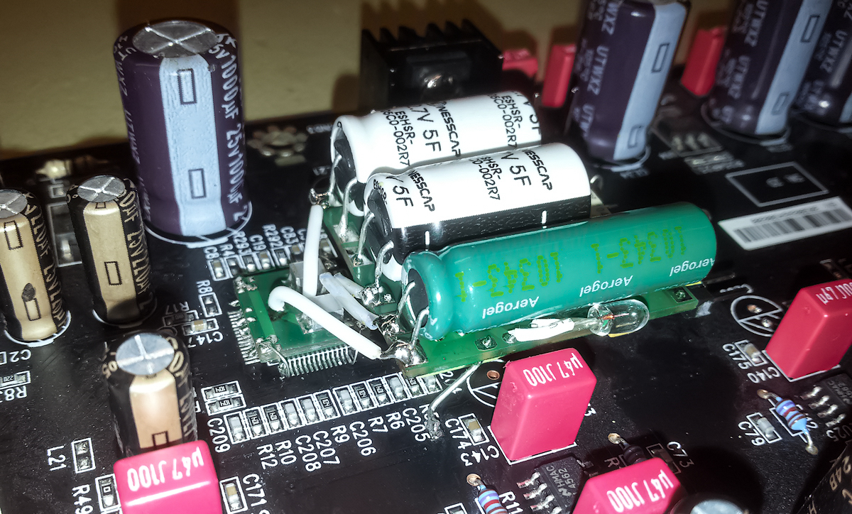

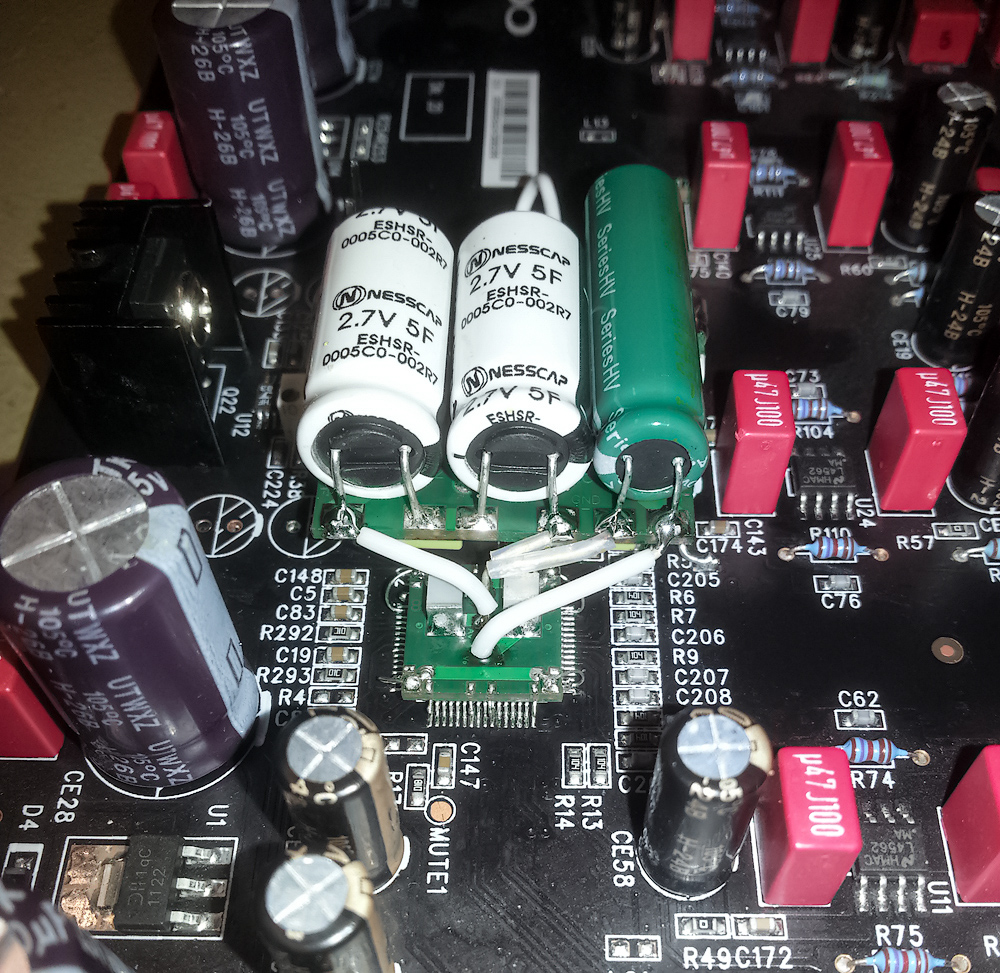

Here is the complete modification/implementation of the Sabre Analogue PSU.
This modification is done on the multichannel board of a 105v model.
I used this time a 6F cap for VddL/R - 1,2v. Silver wires connections, no longer than 15mm. The final version (a little bit smaller) of the PSU board (populated) is also to be seen here.
The original regulators on 105/105D, and even 95 it support the rush in currents...,
