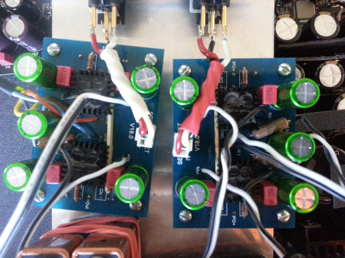

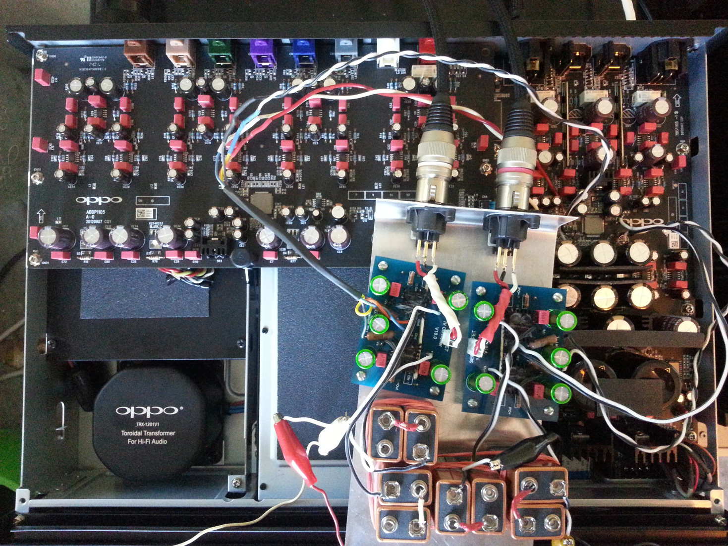

Oppo with SEN I/V
Having some fun with the SEN I/V in the Oppo.
The images show the test run to make sure it works and sounds good and it does.
Permanent power supply now to be investigated...
The info about SEN can be found here:
http://www.diyaudio.com/forums/digital-source/195483-zen-cen-sen-evolution-minimalistic-iv-converter.html
More mods to come

Nice work, we're curious to hear your before and after comparison of the sound.🙂Having some fun with the SEN I/V in the Oppo.
You can find the AAA tabbed NIMH rechargeable batteries online for less than a dollar apiece.
Erichttp://www.batteryspace.com/aaasizeseriesbatteries.aspx
Only worth it if the batteries have the lifecycle simlar to the Endloops... seem to be the best.
PM me the link if you have it.
Will try to do some more careful listening and comment later, but first impressions;
I still have the stock balanced I/V output for comparison although not level matched, but I gotta say it sounds very open/dynamic and more spatially expressive (soundstage)
Complex passages do not get messy and is seems easier to follow individual instruments.
There are still upgrades/treaks to be done to the SEN before it of finally installed.

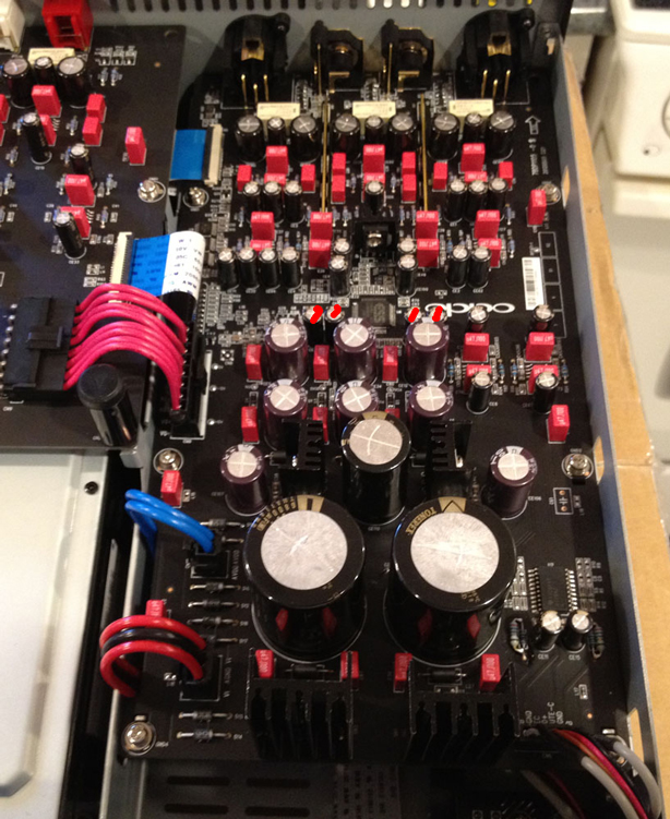

😡I just find out that the "SILMIC" caps used for AC coupling on the 105 boards are a Elna type ones...
I'm quite late to this topic, but after observe the picture of the stereo output board I was quite disappointing with capacitors type at the PSU rail near the active parts: TK??!! WTF are those caps??😱
For PCB "dimension issues" with caps just take a ride with Nichicon Fine Gold series...
And what about the opamps used at the output stage; what model/brand??
Forget it, I just read the 105 use LM4562. A bit mid bright to my taste. An OPA1612 or AD826 can sound more balanced, as many others that I don't listen yet. Be aware of BIAS current in OPAMPS... to avoid abnormal DC offset at output stage.
For my point of view its a very upgradable player at output stage.

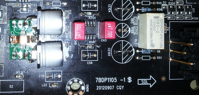

Hi Coris,
Really good work on the clock...
Wrt the preDAC caps, I ended up installing 4 Nichicon CG Aluminum Organic Polymer Capacitors 6.3V 2700uF for the higher capacitance as suggested...
These are SMD types and larger than the original caps so installation had to be creative. I chose them over the Nichcon HZ due to their lower esr and higher ripple current.
After 2 days burn in, they have added another level of richness to the sound of the sound. Instruments sound more complete now and the continuity between the base lines and the higher registers is smoother.
Thanks for the suggestion... very worth while.

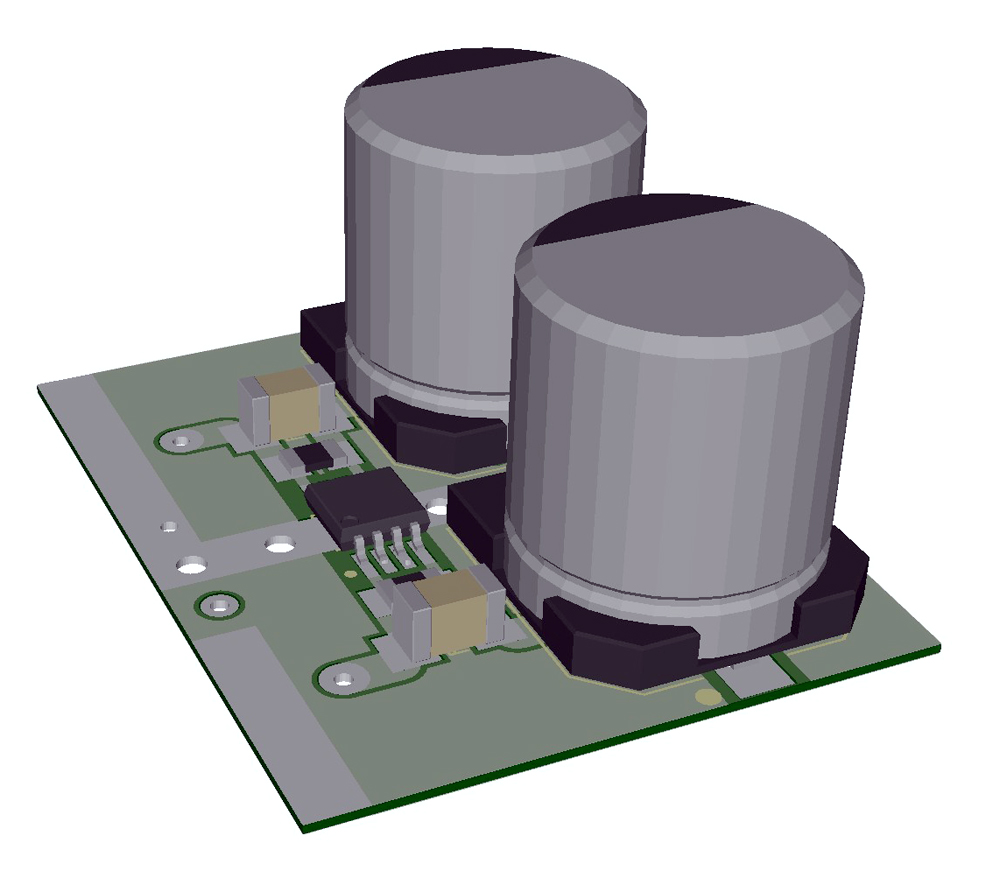

Recently I have experimented with OPA1632 as I/V for balanced outputs. Very good results! I have used the MSOP (with thermal pad) version of this chip.
The balanced outputs stages use the same opamp configuration (around opamp chip) for both I/V and final buffer. So, it came up the idea to have a standard module which it can be used to replace the opamps for balanced outputs in original design. Even more, such (standard) module it can be used to replace the original I/V stage for unbalanced channels too.
I have just designed the small PCB and send it to production. My module it will have two versions, for MSOP and SOIC packages, and will be available complete equipped and tested, or as a bare board for own customized configurations. The module it will perfect fit the foot prints (through holes) on the original board, and it will use the power lines available around the opamp chip on the player stereo board. It is meant to be mounted using very short bare wires as terminals which are to be placed in the holes for feedback resistors and decoupling caps in original design. The whole original/old components (opmps, and its around resistors/caps) have to be removed to make possible the properly functioning of this module. I will come back with more details and pictures, when the finished module it will be assembled and mounted in place.
The pictures here shows the prototype module (mounted on a MSOP adapter board, and the 3D model of my already designed module.

My battery powered clock board (with divided 216Mhz SAW oscillator.
Hi Coris, which chip did you end up as the divider by four? Cheers, Joe
