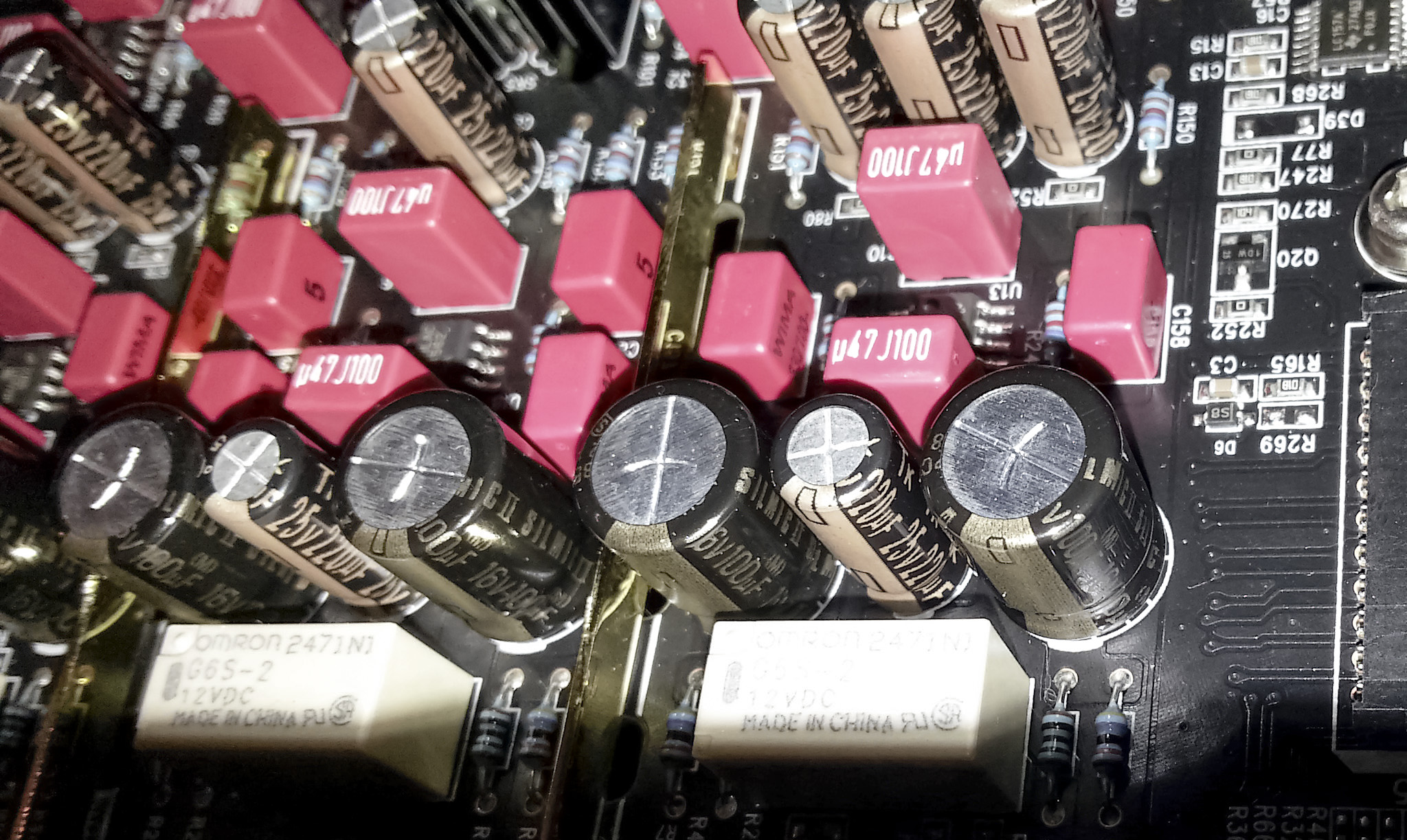

A closeup of the 103 audio board.
It seems to me that 103 have not AC coupling on outputs... Those caps around the opamps are for sure decoupling ones on power rails. It looks like the designers were thinking to improve the outputs of an more expensive player model, mounting those AC separation caps on output channels...
Yes... maybe you right. Then it could be the other ones AC coupling... It looks like we are caps detectives...😀
103 is a much better design....
Can you please develop this statement?
I also think the layout looks better but the design ? I doubt that please explain.
There are NO ceramics in the audio path.
Including power supply ?

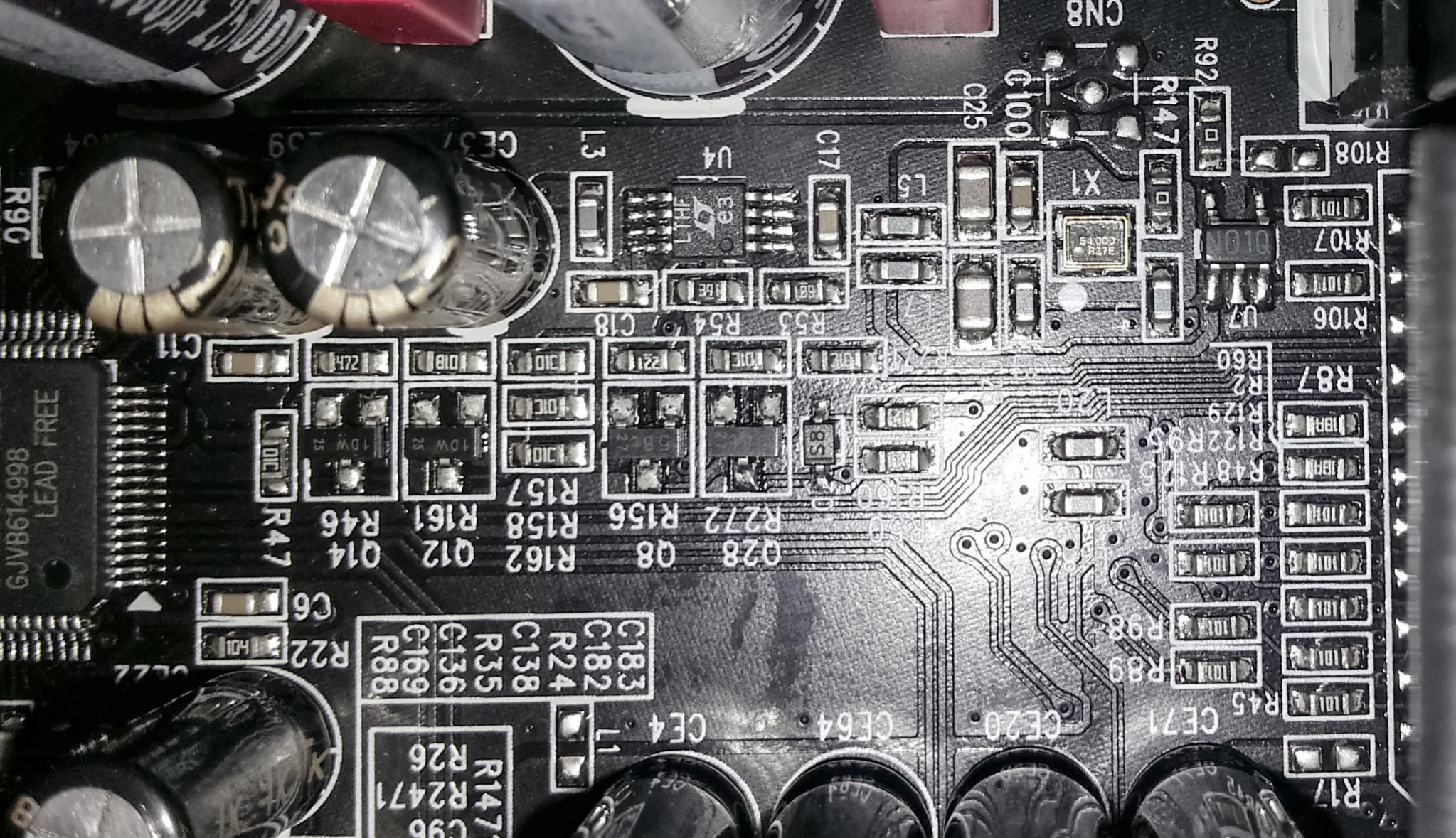

Two (unofficial) pictures of inside 105: clock area for stereo DAC and final stage - output caps...
One can observe in the clock circuit, a little more care from Oppo designers to supply the oscillator with more clean power from a low noise regulator right near to it. But disappointing the frequency of this oscillator: 54Mhz...
The same as in 95 model 😕
