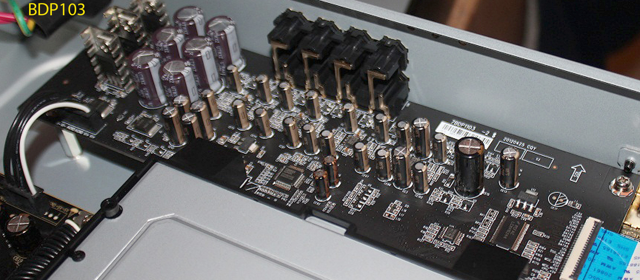

Does anyone have details on the output caps as it's hard to tell from the pics? Are they electrolytic and what is their value?......

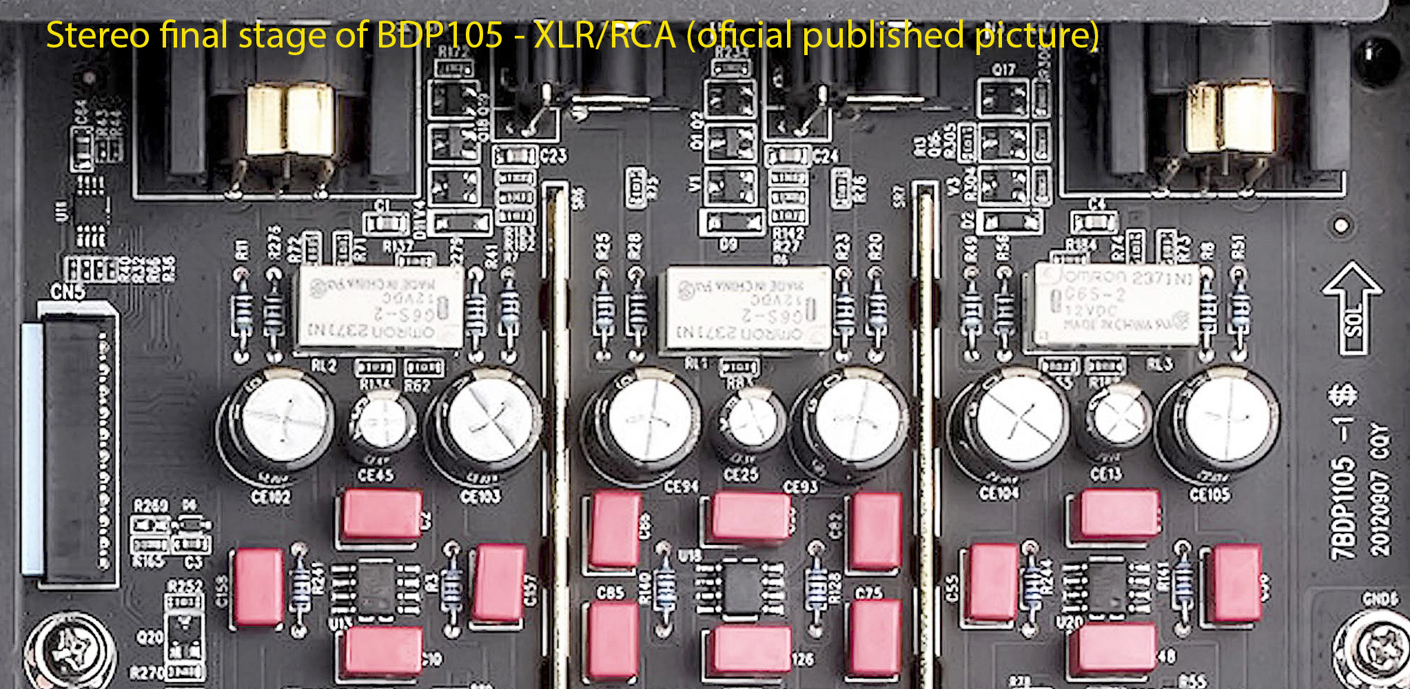

As you can see in the picture here, It seems that the final (isolating) caps are not very special ones. I guess they are of 680µF capacity, and for sure electrolytic.
WIMA (the film red ones) caps are quite low capacity and used to decoupling the final opamps, filtering in the signal path, and so on...
Another sign of proof design should be the using of such WIMA film caps (or another ones) to parallel the isolation large capacity caps, for an much better frequency response for the output signal....At last is not to be seen in this picture...
Coris, that's what it looked like to me too - a big electrolytic on the output! Not good.

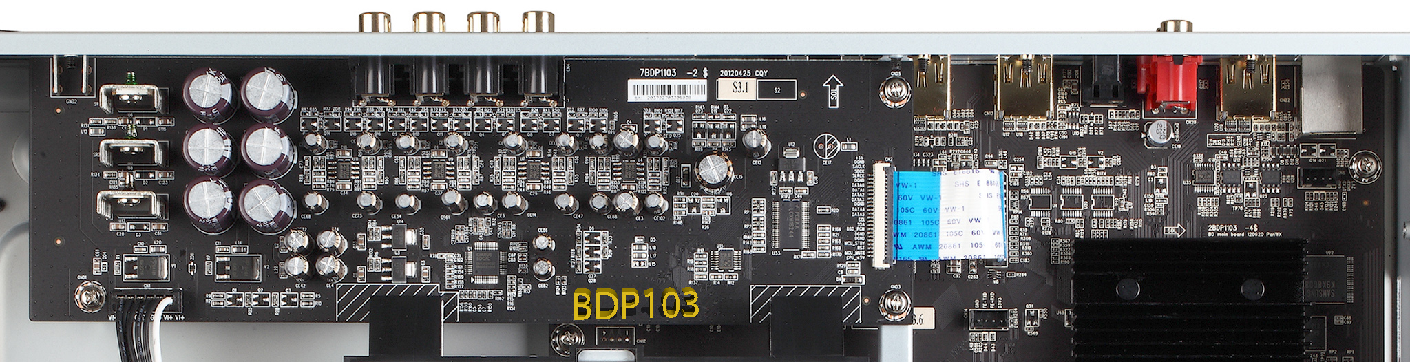

Does the 103 have a similar output ac-coupled output?

OPPO's answer ,quoted earlier in this thread ,said WIMA...... a film type cap.
Which post number was that?
The answer I found stated they used Elna and no mention was made of the type.
BDP103 do not have ESS9018 DAC... I can not be sure about the output coupling in 103. Looking at the picture, it may be it may be not... But it seems to me that they used the same design type for both those last players.
Else such isolating caps in AC coupling in most cases are electrolytics, because the need of a large capacity at a low price...

Oppo use Elna and WIMA caps in theirs machines. Elna for electrolytics and WIMA for film.

Also, my Xindak DAC-5 had WIMA MKS 4 output coupling caps.
From listening, I am of the opinion that with the WIMA's

Appears that the 103 uses Nichicon caps in the dac/output stages, which I personally prefer over Elna. I find Elna's to be far too unreliable to use, even if they *maybe* sound a bit better for a given purpose(which I believe they don't, after caps are well broken in). Elna's are particularly short life in hot environments, which I expect the 105 will be.
As for the dc offset- in this sort of design, even very sloppy selection of parts will end up with totally insignificant output offset, unless the design is appallingly bad. But UL hates anything without dc blocking on output/input, so most makers use them even when they are not at all needed.

IMO there is no point in using the ess9018 DAC and then using WIMA coupling caps.
