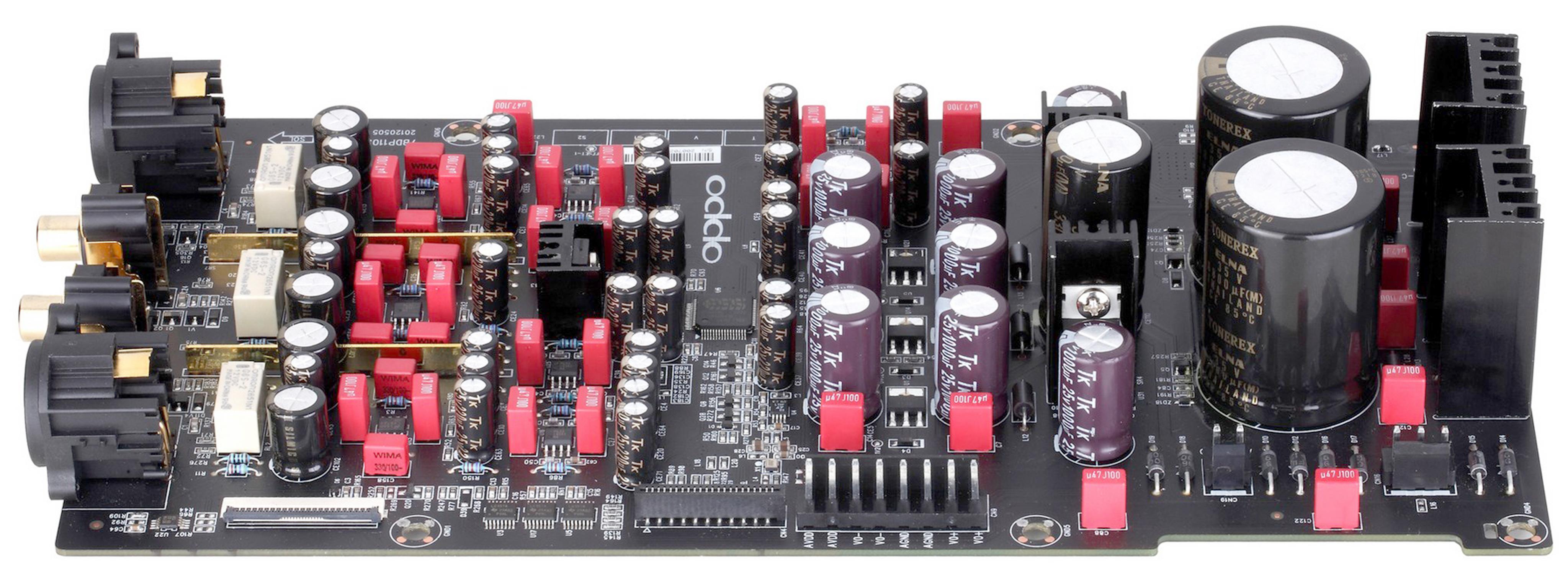

New pictures published by Oppo. It seems that the final caps (AC coupling) have an 4 figures µF capacity and 16v. Producer of the caps: SILMIC... I could see something like 400 (last 3 figures) on one of those... It may be 1400µ... 2400µ...
It could be enough for an low end of the audio spectre... But is not possible to be seen an paralleled cap for better high end of the spectre... I can not agree with this kind of design on the output line signal path, coming from an ESS9018 DAC...

I just find out that the "SILMIC" caps used for AC coupling on the 105 boards are a Elna type ones...
Coris, what are your thoughts on how best to improve the output stage?
Simple capacitor bypass?
Transformer?
Transformer?

Well, transformers to output the DAC`s signal is also an idea I have since a time ago... I really do not know how it works (sounds), but it seems that they who are using so, are satisfied. Is a really drop of signal in this way to do it, but I think is worth to be try it. Technical speaking, specially in 105 model to use transformers is very difficult (to have the player enclosure completely closed after...). Not at least, this is a very expensive choice... And is more suitable for stereo output... I think one may drop this idea.
Before conclude to bypass/remove the final caps, one may take some measurements, to appreciate better such improvement. Not least, one may hear first the sound of the player hot it is out of the manufacturer.
My main idea is to bypass those caps, but how the mod is to be done in details, is a little to earlier to say. Examining the board and see what kind of circuits/design were chosen by Oppo, is a priority, before find the best way.
One may see first what about the DC offset before those AC coupling caps, and how the final stage works.
I can see also on the boards pictures that Oppo still use some RF filters right before RCS/XLR connectors, an divider after the AC caps, and so on...
The main thought here is "less components in signal path is best". Why they chose to load this output signal path with all kind of filters and ferrite beads, caps and so on, is enough difficult to understand. The signal it may look well on the oscilloscopes displays, but is for sure not best sound out of it...
In my own design I have not any filters at all after I/V stage, and the only caps are some of few pico on the opamps feedback. I succeed to lower to 32mV the residual noise from the DAC chip (very far from audible spectrum), while audio output signal it swinging from few Vpp up to 28Vpp.

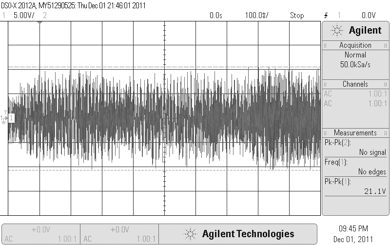

I found those my pictures published earlier in this forum. It were measured on the RCA output of (mod) BDP95.
One it show 21Vpp (high dynamic sound/orchestra) and another one 5Vpp (80Khz sinus played through DAC, from digital file)...
But I will measure again and I will present it here soon.
I'm a bit concerned about the presence of elco's in the output of the 105. They might be Elna Silmics, but they cannot be anything near as good as film caps.
Could it be that these are actually polarised, I mean non-polar caps with a voltage put across them? Would that make sense? And, if so, how much better would film caps then still be in the same location?
Yes, is right! Those AC coupling caps should be at last unpolarised. To have there film caps is good for the high pass of the spectrum, but at such large capacity (needed for low pass) is very difficult and it will be very big... Those caps shouldn`t be there anyway.... This design (AC coupling) is wrong! I just can not understand (with the informations I have for moment), why they chosen this way to output the signal. It were very well about this aspect, how it were in 95 model... I can not see this as an improvement at all.

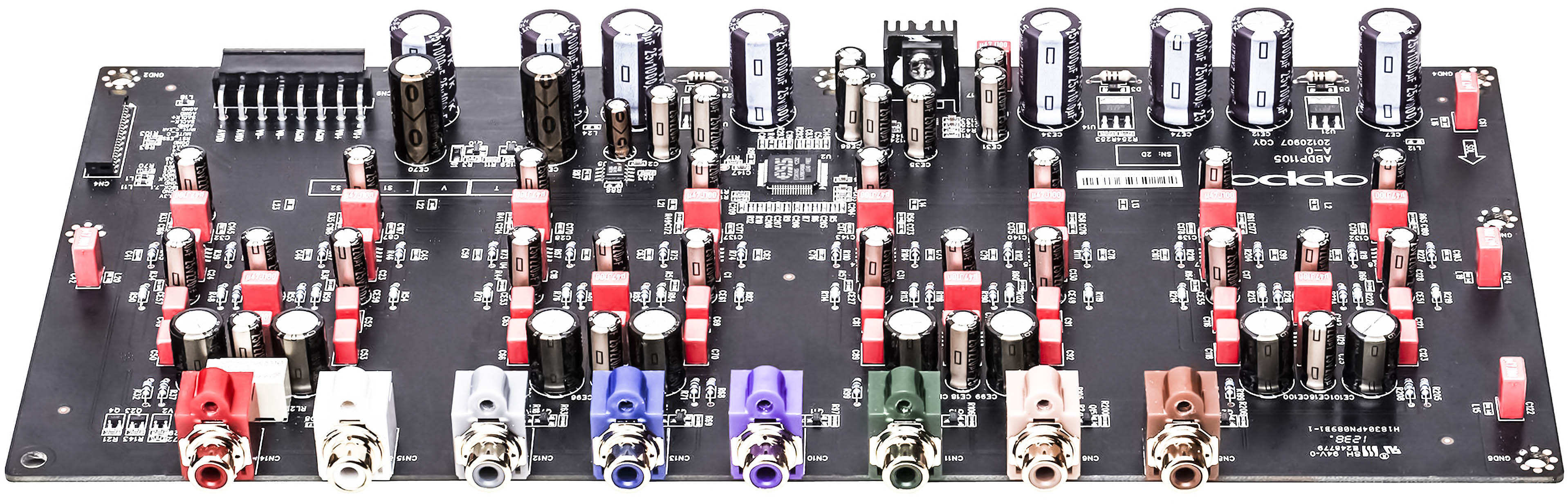

there seems to be 3 coupling caps in each analog output channel: one after DAC, one between filter stage and the buffer stage, and 3rd cap in series with the output connector.
