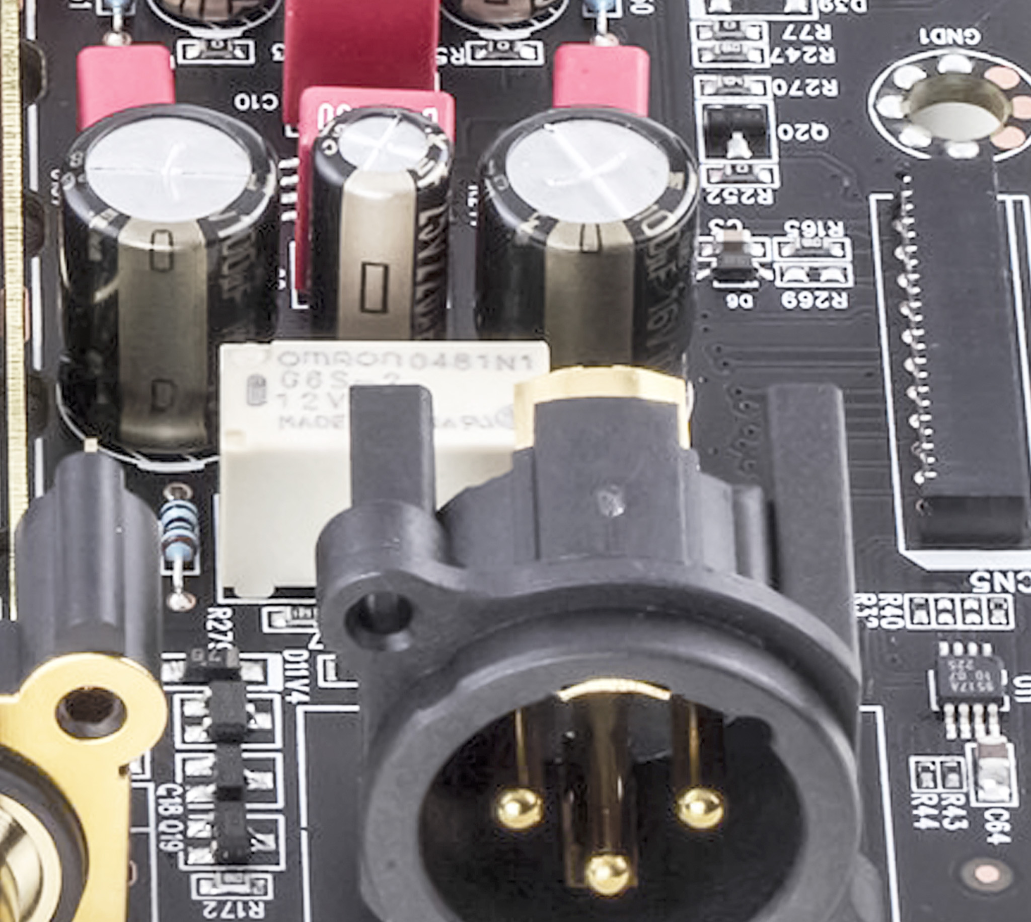

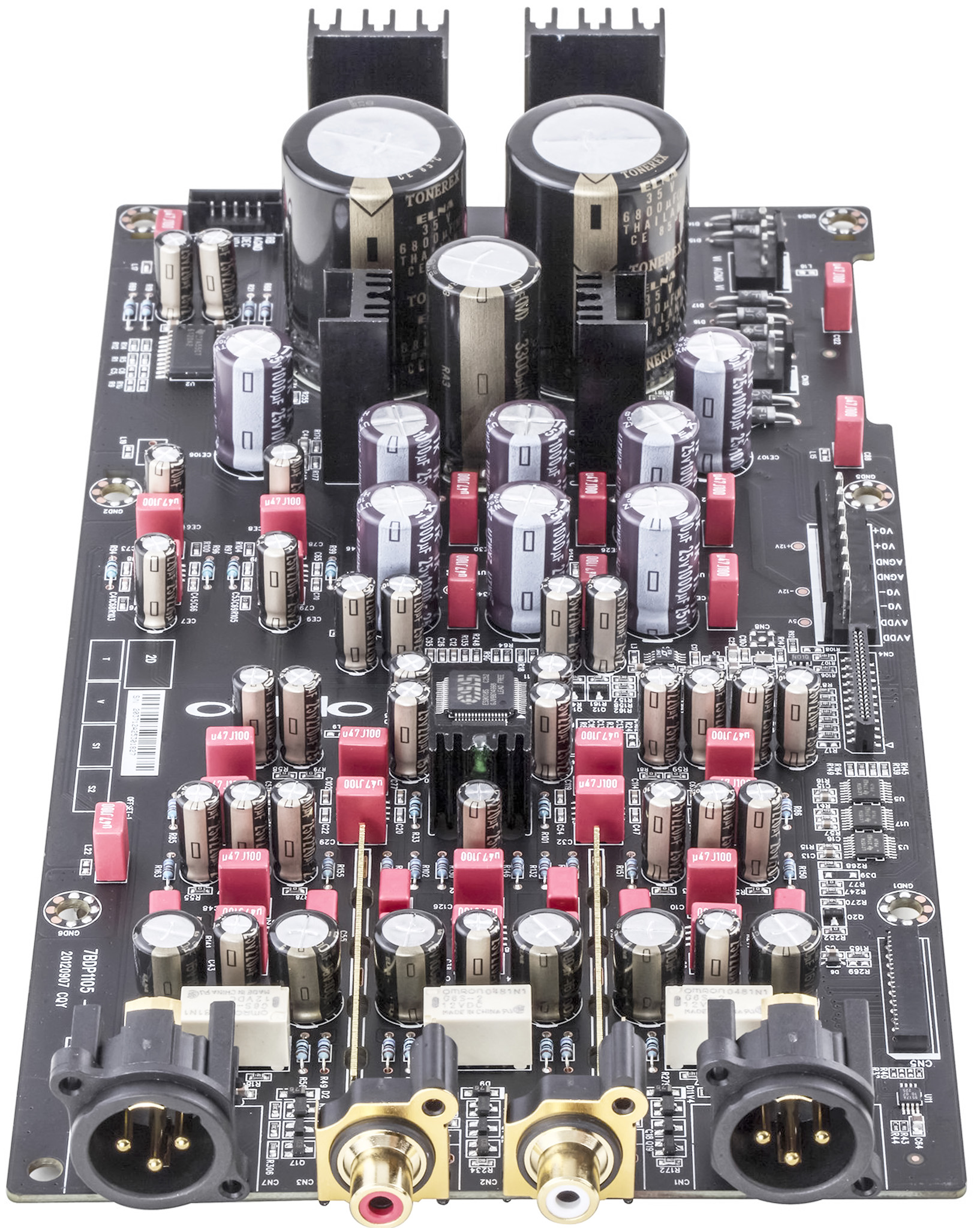

There were published some new pictures of the analogue stage of BDP105.
Now is possible to see what kind of capacity have the AC coupling caps... Just 100µF...
Is quite nice that Oppo care much to give more jobs to the modders. It will be enough work to be done with this new model too...

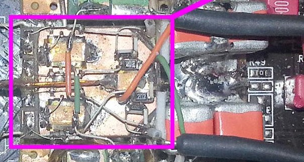

This belong to an moded analogue (stereo) stage of 95... Is really very small.
Is just stupid to use something else than DC coupling for this analogue output (XLR/RCA) in a quite high end player. At last they should use non polarised caps. Such approach should look much more professional, than only throw on that outputs some usual 100µ caps.
With today components technology such design is just wrong!
What do you think a good quality eletrolytic cap does wrong as Coupling Cap ?
My exsperience is they are fine as long as there is a few volt on the input off the cap.
Actually I prefer them instead off MKP, MKT etc. Do not the treble from M.. !

Well, it may be quite much to "talk" about, to be answered this question...
First a such cap may have a large capacity to assure a very low pass. 100µ it may be quite right on the calculations, but one hear very well that is not enough... I`m quite sure that your self have experienced the difference, in bass domain, when is about an AC coupling, and an DC one...
An electrolytic cap is made as usually as an coil, and it have many foil turns inside. This mean quite high inductance in the signal path... There are few very expensive caps witch are made other way... Is not in this case we talk about... 105 have absolutely usual isolation caps on that outputs...
Such caps have parasitic inductance, resistance and those parameters are not very stable in time, specially when is to endure enough high frequency signals through... This may be an explanation for that low as possible voltage AC signals may goes through such coupling... The polarisation of such caps it present some parameters for the AC signal in one way (+), and not the same parameters for the signal in opposite way (-)... It is this good for an high fidelity signal which will goes through such caps? I do not think so at all...
Therefore the right design in this area is using non polarised caps...
The AC coupling caps in Oppo design of 105 model are not paralleled (as is to be seen in the presented pictures) with another small capacity caps, but with much better ESR/ESI parameters to improve the high pass of the AC coupling. Is this good for the signal high end spectrum? I do not think so at all...

I see highly optimised PCB layout, good ground segregation, steps undertaken towards reduction in cross-talk and... wide, thick PCB tracks that are optimised to produce correct impedance loading with the chosen decoupling capacitors’ values & types -> to provide good power supply rails' decoupling.
The reason for sound coupling capacitors is to provide DC segregation between the source and the amplifier / pre-amp. It had to be done. If you don't like this solution - remove the caps.
Many high end HiFi solutions REQUIRE these capacitors – the owners flatly refuse to use any component in their sound-chain that can cause any potential damage to their bellowed 100K + set-ups… OPPO does not want to be liable for any potential damage to 3rd party equipment AND does not want to bear repair costs under warranty, for their players as the result of direct coupling and potential damage back to the output stages inside the players.

Coris, I am a capacitor expert, and have long suggested on coupling cap free designs, BUT in the case of the 105, you are in error. The caps are necessary (unfortunately) but they are the best caps for the job that would fit. Ceramic caps would be FAR worse, sonically, and polypropylene caps would be too large.
The ONLY way around the caps is SERVOING, or changing the circuit design, and in my opinion, is not worth the change in performance, at least for this design.
