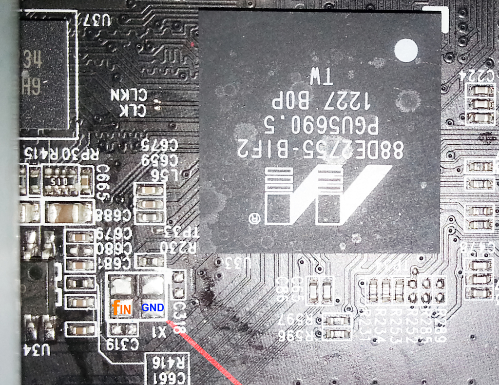

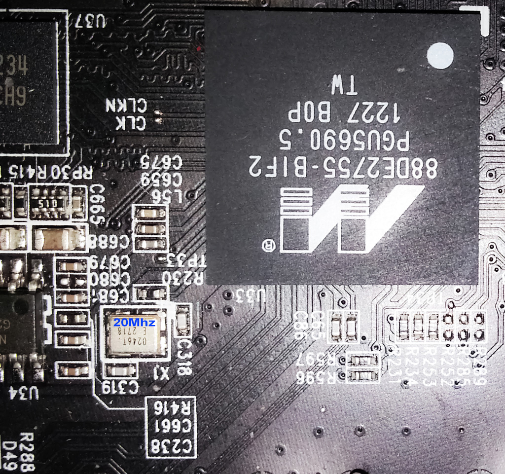

Using SAW 54Mhz oscillator divided to clock the main processor, I can notice also improvements in picture stage. The divider I use for the moment is not very performant. Even though there are improvements for colors, contrast, and black level.
