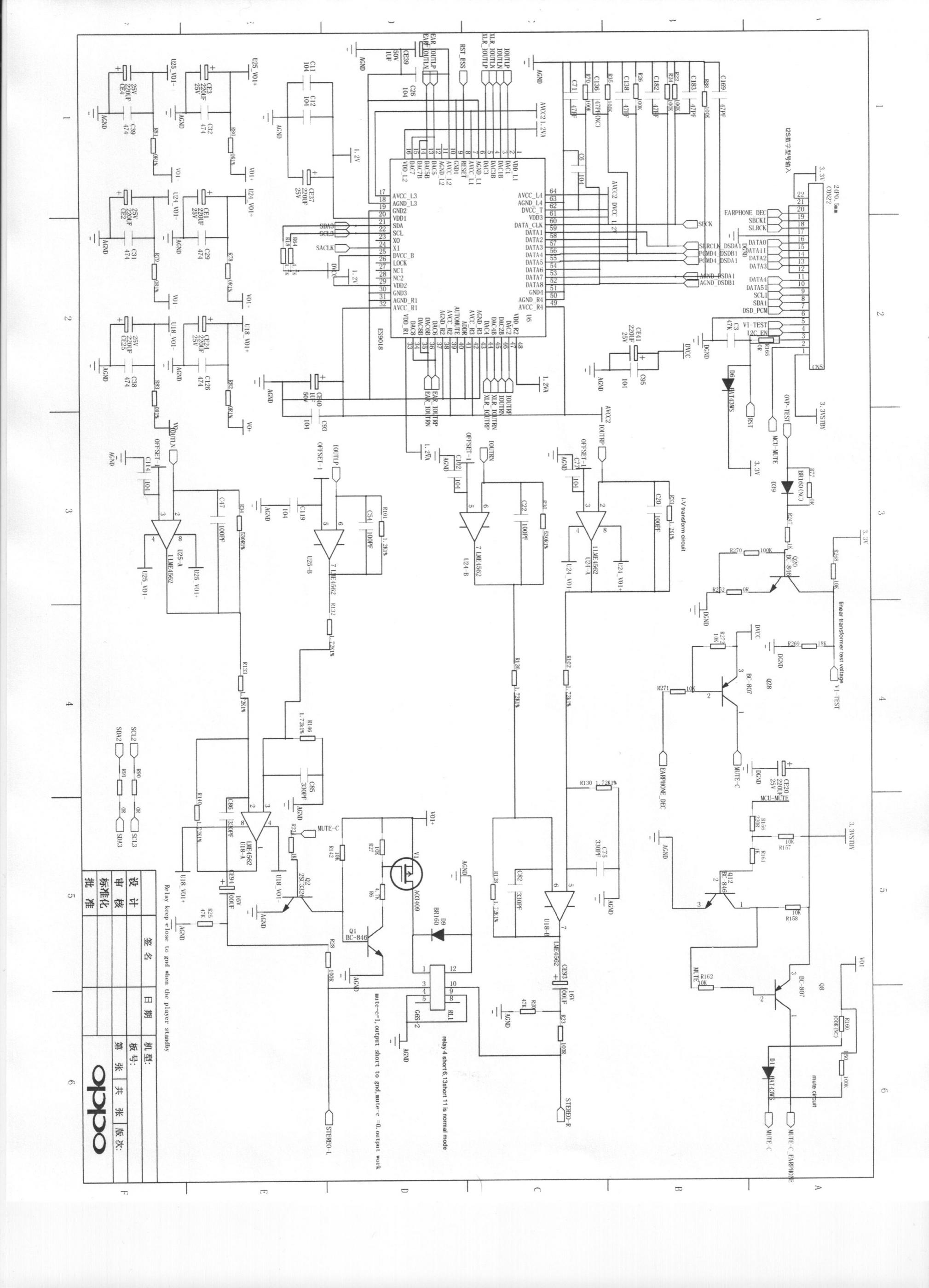

Thanks John for your schematic. Very nice and unexpected contribution. 🙂
Is really the last model here! A little bit of it... better than nothing.
It is what you guys were talking about RECENTLY? I have donated a schematic to make things clearer for everyone. Coris, we are not 'fools' yet we can learn from others.
Thank you, never thought I would see this.
It certainly answers one question - what happened to the "lost phase" and I see that "EAR" has been paralleled up. This is useful to know. Currently I am paralleling up the "XLR" and "IO" - but now have the option (as I suspected) to disable the headphone I/V and get back to the four phases the Oppo 95 had. It may be that in my post-DAC implementation (no opamps or "virtual earth") zero feedback, I have that option back with beneficial results.

AC filter almost burning, why ?
Dear all,
I tried to replace the AC socket by an old (but unused) schaffner filter (fn 323-6/05).
I left the house with the modified oppo in sleep mode, but, after 3 hours, my daugther gives me a call "Dad, it smells terrible in the house, like burned plastic". It was the filter.
Stand by mode consuption is 0.5W ... So I don't really understand what is happening. Is the switching mode supply throwing such a high level of noise ? Can someone gives an explanation ? Doesn't it means that a filter that will stand the power is a must ?
Best regards.
Philippe
PS thank you John for the shematic, btw does someone know where comes the 104 and 474 short cuts for 100 nf and 470 nf respectively ?

John Curl,
Thank you very much for the schematic. It will help our discussions.
So using the schematic, we can say that resistors R34, R101, R30, R33 should all have the same value, for example 866 ohms, 1%. This will allow the two differential outputs to be subtracted properly, and the noise canceled properly out of the DAC.
Eric
Eric
IOUTRP, IOUTLP it have 1,2K (R33,R101) on I/V feedback.
IOUTRN, IOUTLN it have 0,53K (R34,R30) on I/V feedback.
I (current) OUT (DAC output) R/L (right/left), P/N (positive/negative phases of differential out).
The positive side of the differential signal is out of I/V converter 2 times bigger level than the negative one on both channels of only stereo stage. Not headphone out, no multichannels out. Just this stereo one. How it may be subtracted the two differential outputs in this setup? How the noise it will be canceled properly this way? The main reason of using differential is actually noise canceling. Isn't it?
I still not see the clue/benefit of such process of the DAC differential out in stereo I/V stage. And what for only stereo?
Waiting for more ideas about why this chosen way.
