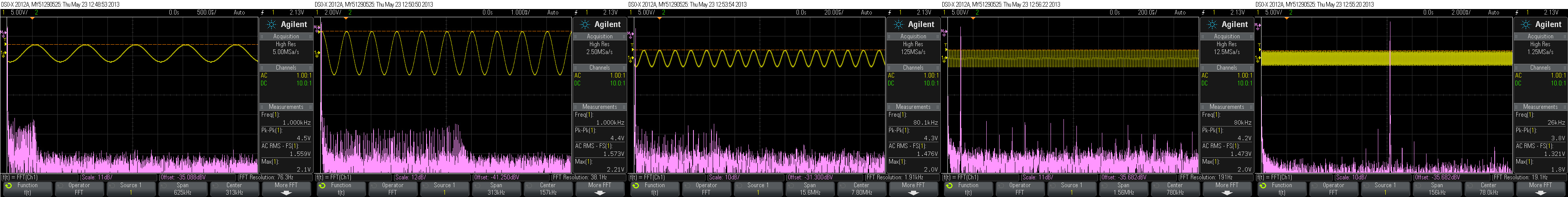

Now it come some documentation from me...

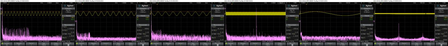

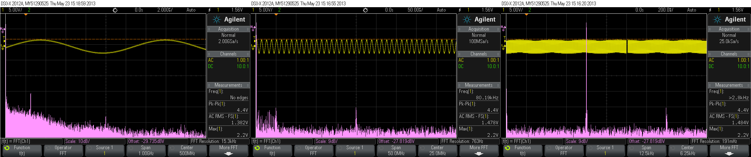

Maybe I should precise before this "dispute" began here, that this setup with 20 ohm resistor it was an experimental one. This kind of setup it may not be functional of course, because some facts: necessary too much gain after I/V, which it increase the noise in the system, offset issues due to the same very high gain, and few other negative things.
Even though all those negative sides, I could not notice (perceptual) bead sound (FM radio like...), but very good quality one.
I think to present you here those results and "a vous" to analyze and comment.

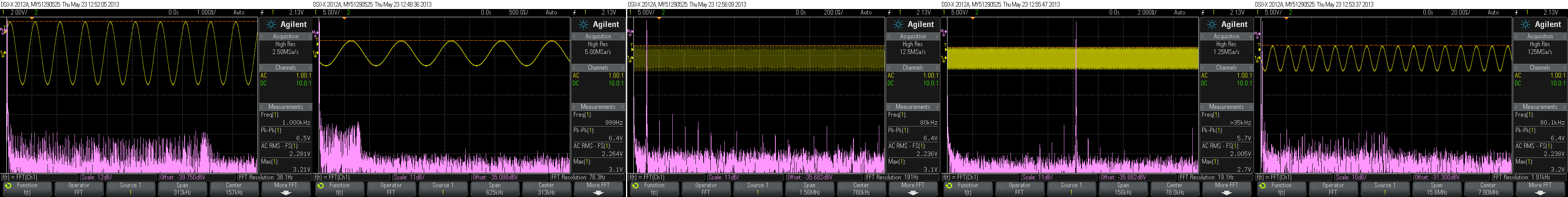

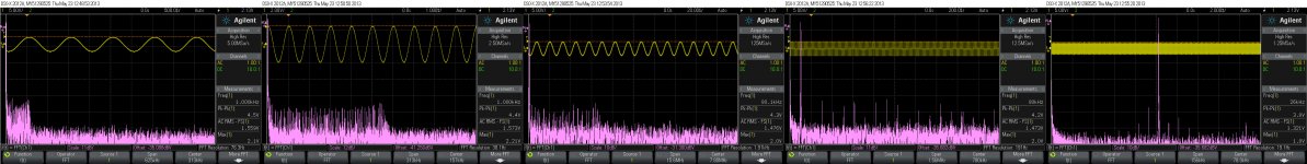

There are scope plots for the ("worst case") 20 ohm (feedback) I/V resistor setup with x50 gain on final opamp, on the Stereo stage which were modified like this, and a "witness" one which is Front L/R stage very intact and with similar quality with the original stereo one.

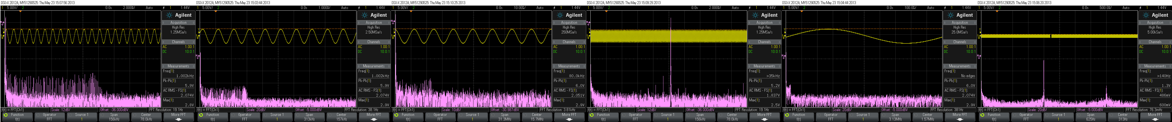

Then the same measurements with an 750 ohm I/V resistor and 1,3 gain on final opamp (the same procedure, comparing with Front L/R stage).

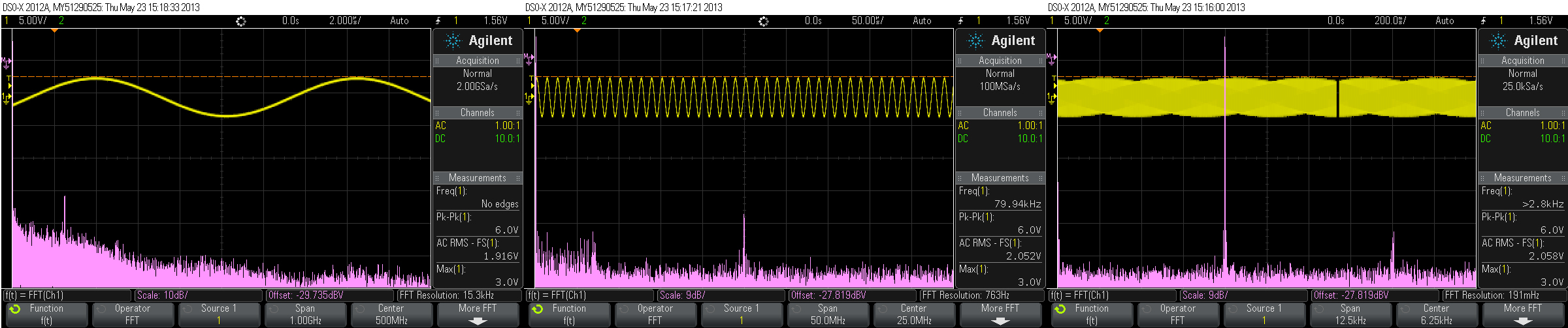

It were used for test 1Khz and 80Khz -3dB wav files (192/24) which were played back as normal on the player. The scope is set mainly to High Resolution Acquiring data, but it is used in some cases Normal too..

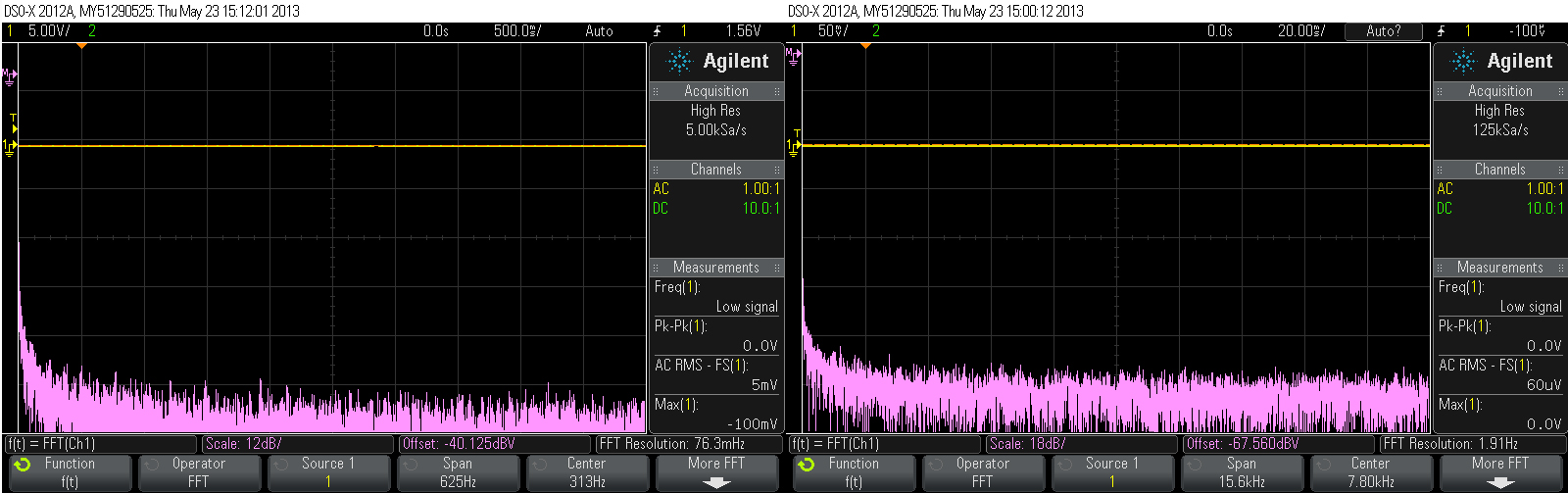

I use 108 Mhz clock for the DACs, divided to 27Mhz for the processor. This is an temporary clock setup, which is not very performant (specially the 27Mhz part one). There are first some plots of the clocks outputs, to make you an idea about how my scope it works with those clocks and the quite standard frequencies.

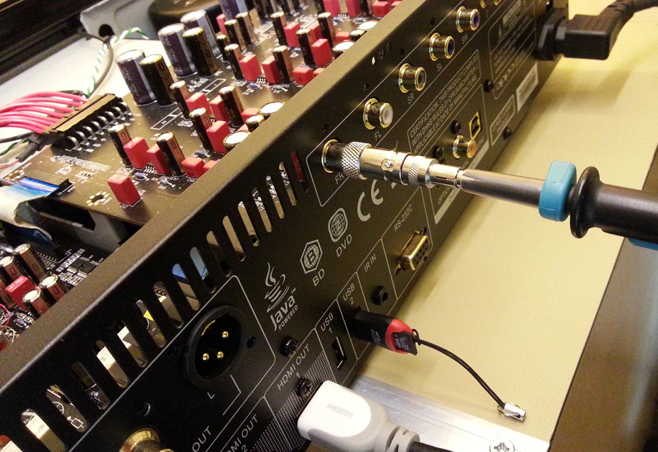

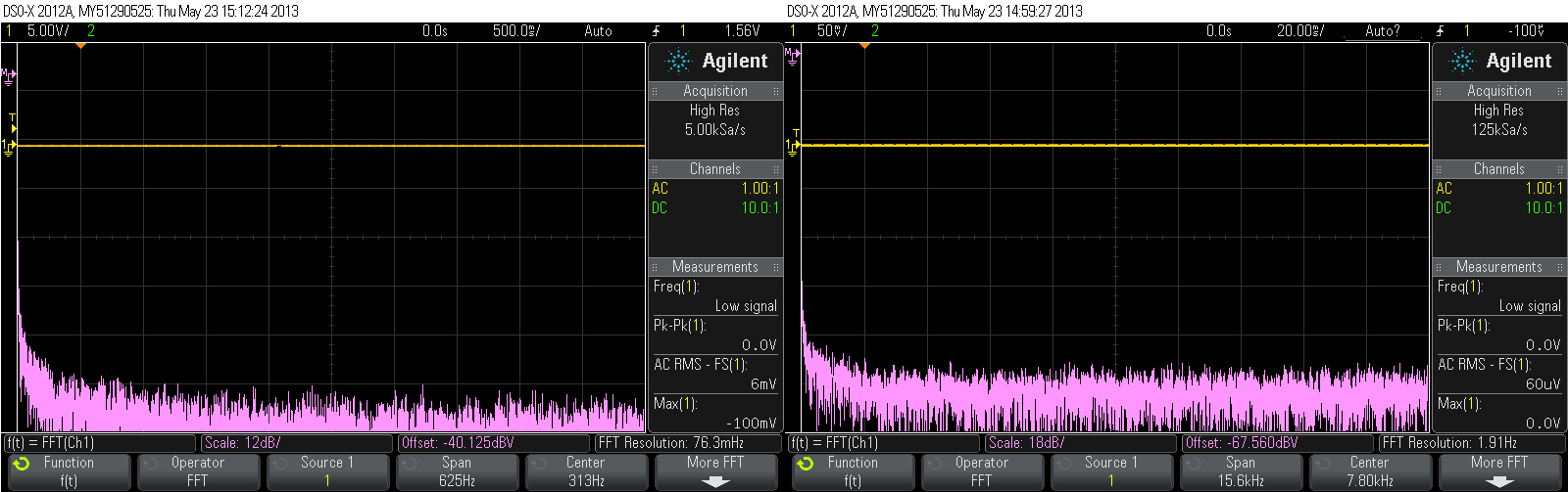

For the same reason I publish here some plots with the noise floor of my scope (shorted probe, 4mV scala (lowest not software amplified level), and so on. Also a picture of the measurements setup.
It will be quite many pictures, so many posts which it belong to this main one.
To see better the pictures, please download and zoom it.

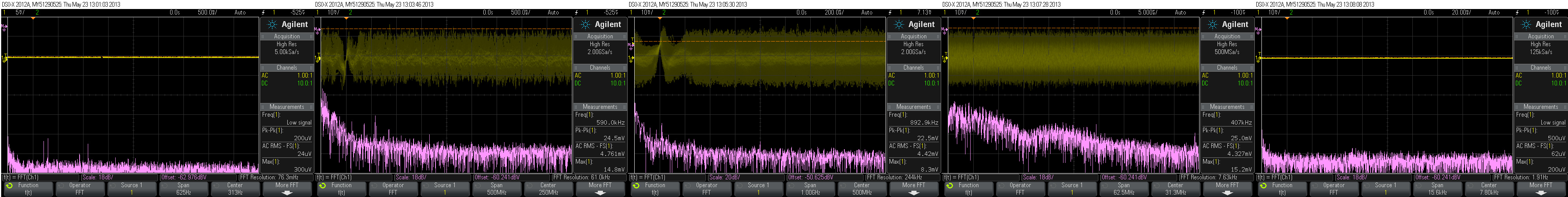

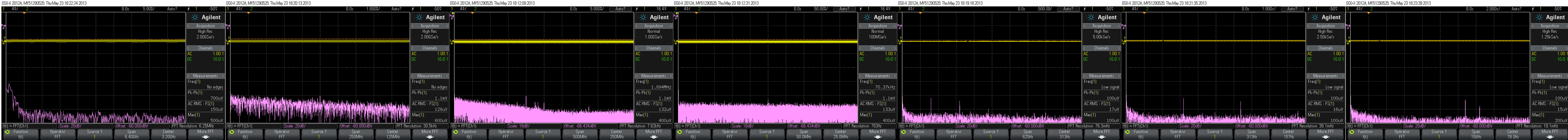

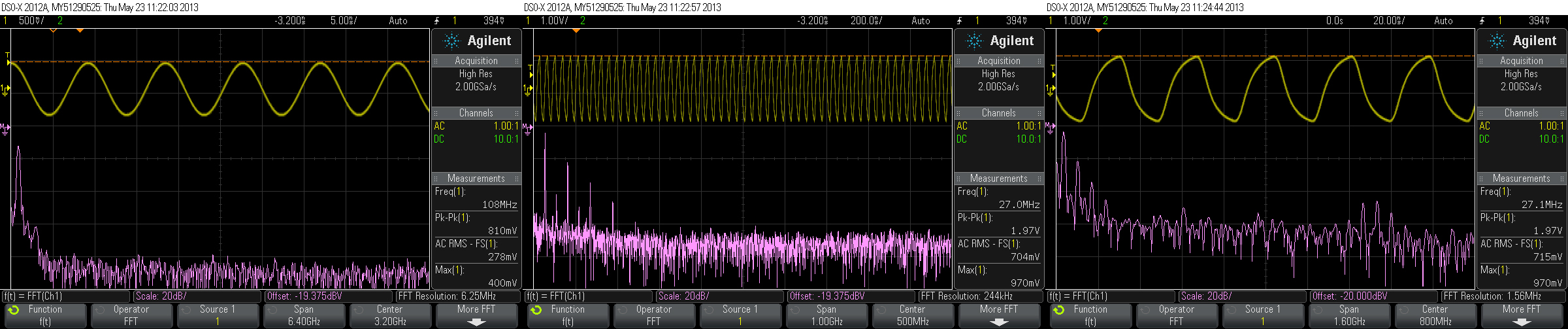

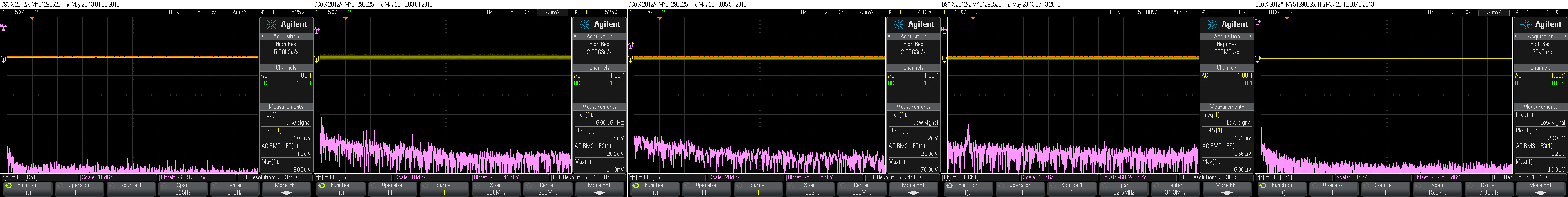

20 ohm I/V resistor and x50 gain on Stereo and Front L/R (High resolution Acquiring). Noise Floor of the outputs and with signals.
750 ohm I/V resistor and x1,3 gain on Stereo and Front L/R (High Resolution and Normal). Plots for Noise Floor of the outputs and with signals.
PS. My first comment is that are not big differences between an "bad" I/V setup and a "good/normal" one...
