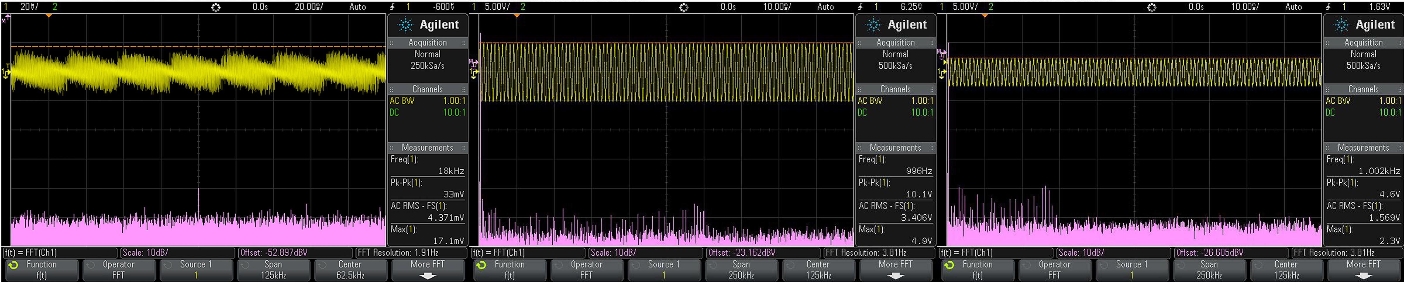

Here are few plots of some measurements.
In the first picture, first plot show the noise on the 105 RCA-stereo outputs. This stage is modified as described in earlier posts here (no filters).
Second plot is the useful signal on the same output. The third plot is from the unmodified multichannels stage Front L/R output. This output is identical with stereo as signal quality.

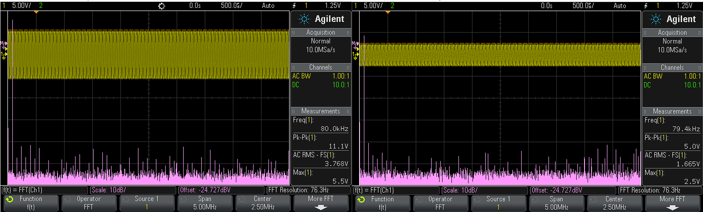

Second picture plots show the playback of a 80Khz signal from an wav generated file. On Stereo stage out, and Front L/R out.
The DACs are clocked with 108Mhz oscillator, which then divided to 27Mhz goes to the main processor. Higher amplitudes belong to the Stereo stage.

Coris,
you haven't specified which digital oscilloscope you are using, but you may be running at eight bit sampling (or somewhat more if your scope can do this). This is fine for identifying 2 MHz noise, or large 80 kHz noise on top of the signal, but will not be sufficient to do a modern analysis of the player. The player is outputting effectively 16 - 24 bit signals, which are then filtered to produce a smooth output (not to mention the upsampling aspect and technical details of the Sabre DAC). For a full analysis, you would want to bring your player to an audio precision analyzer. (Maybe you could find one at a local university).

The scope is DSOX 2012A, 8 bit vertical resolution. I'm not supposed to do a deep/full analysis, or an in depth review of the entire player stages. Such demanding and huge time consuming task I may let it to specialized entities... I have made only few empirical measurements, to compare and show to the sceptics what about few simple aspects between an modified stage and an unmodified one.

That is a very nice oscilloscope. It has a high-resolution mode which significantly cleans up the display of waveforms, and should also give you up to 12 bits, and therefore much lower background noise on your FFT calculations.
I do share the concerns expressed by others about increasing the high-frequency noise in the circuit when you remove the capacitors from the output sections. The dramatic reductions in the feedback resistor in your I-V stage may lead to reduced signal-to-noise ratio. That is not to say that these modifications are incorrect, only that they should be considered carefully. None of us can hear your system.

Thanks for your considerations.
Reducing the I/V resistor it may indeed reduce some noises, but it need increasing of the following stage gain. So, the noise it may come back in the system... Even more, increasing the gain of the final stage it increase its offset on output (at last at the op amp type i use). This it may do it necessary to put back in place the AC coupling caps... It is a big dilemma here, so one may try to find the best compromise, if possible. I'm quite surprised by the fact that the DAC residual noise get much lower when that resistor goes very low in value. When in "voltage mode" that residual noise is just huge. The need of higher current on DAC outputs it seems to make it function better in one way... And this it may be in accordance with the remark of the father of this chip...
I`m not very sure about what caps you mention to be removed from the outputs. If you refer at the AC coupling caps, then those have nothing to do with the noise in the system, or the filtering function. They are there only to isolate/separate the DC levels from AC outputted signal. But, yes they have a filtering function too... It "filter" in a negative way the useful audio signal. You know, I just experimented and put it back a better quality (non polarised) AC coupling caps on that output, after I have modded this stereo stage. It were just horrible to hear the sounds with those caps there...
As one may notice from the plots published, the HF noises (with an arround 50Hz component), it have in this case 32mV. This level it is really possible to be lowered even more, without impact for audio signal. I did not yet this to have the worst case scenario, to judge the improvement. The amplitude of useful signal measured in the same place is in this case x366 higher. So the difference is huge. Never ever it will be possible to be heard that audio component of that noise out of the speakers (in normal listening conditions, or even in absence of the audio signal), but it is a benefit for the spectre quality of the rest of the outputted signal. Anyway this subject it may be discussed further on quite much...

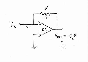

Joe: I know its hard to keep up with the meanings of all these hip internet terms, but its clear you have no idea what trolling is. if it was all about the reaction, you wouldnt be on my ignore list (meaning I wont see your reply). if you mean that I have a history of calling you on self promotion in the OPPO threads and similar handwaving behaviors as Coris, then yes I have form, but thats not trolling. i've stuck pretty consistently to my views, they just happen to be in disagreement with yours.
btw Coris, lower feedback resistance = MORE feedback, not less. I guess thats another explanation for the 'improvement' down the drain. thats opamps 101, its clear you arent clear on Ohms law either to think its the IV resistor ... its true its value impacts on the amount of voltage gain created in the feedback loop; i'll give you that. but its not a current feedback opamp and the ESS isnt really a true current source.
you dont think its logical that less gain = less noise? and less resistance = less johnson noise? seems pretty straight forward to me, but while noise itself is lower, SNR is much worse, as you have illustrated.
yes, but the resistor does not convert the current from the DAC in an inverting opamp IV convertor (your schematic example), it presents no load to the dac at all, it looks like a short to a virtual ground. a dac IV resistor is technically a resistor that sets a load point for a current output DAC and the voltage is created across the resistor to ground (or to whatever the load is, basically across the resistor), this loads the dac and drops some voltage (so there are losses)
is this correction constructive enough for you 🙄
lets forget for now that the current flows the other way, from ground, anyone who is considering mentioning that 😉 lets stick to old conventions for the moment, dont want to confuse matters

Coris,
Here I was talking about the original capacitors in the output filter stage on the op amps, not the output coupling capacitor.
I also still think that you would benefit by using the high-resolution mode at the frequencies below 100 kHz that we have been discussing. This would show a much clearer signal without scope artifacts, and also should show a significantly lower noise floor on the FFT analysis. This would reduce the concern of your critics, although the measurement would still not reveal the actual very low noise floor of the device. Try it.
Another strategy that you can pursue would be to study the noise on a -60 dB 1 kHz test tone. This way you wouldn't need so much dynamic range to capture the noise on your oscilloscope FFT. You would need an active probe, or a +60 dB amplifier.
