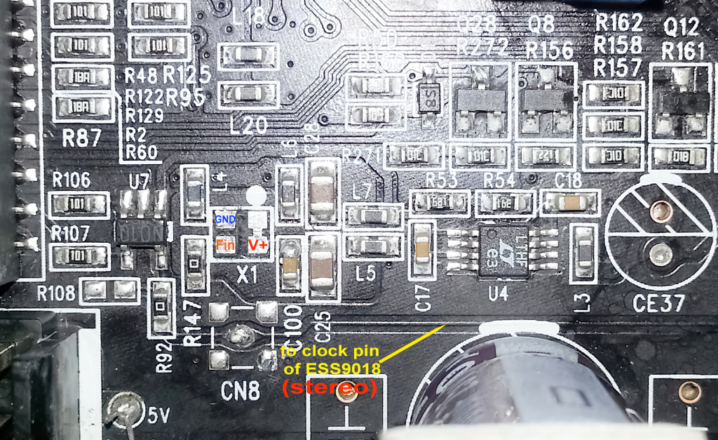

I have already tried with big success an 108Mhz (standard) oscillator for Ess9018, and then divided by 4 to get the clock frequency for MediaTek chip. (One may not forget that I`m running already my 95 on a 125Mhz clock for the DAC...)
It works wonderful this 108 Mhz as main clock, and I'm using now my 105 player clocked this way... Also found it the right I/V opamp. Just beautiful so far.
In fact I`m working now to find a solution to use the same main clock frequency for QDEO chip too. I actually found it the solution, I got a step forward in experimenting this, and it works. I'm only waiting now for having the right components in place, then some tests, and in the final, I intend to design a master clock kit for 105 (based for moment on an standard 108Mhz oscillator).
This project it may take a while I suppose. I will have the custom made 108Mhz SAW oscillator not before the end of this summer... But at least this is my plan for now.
PS. I think it may be designed a better (looking ) stereo stage too...

BTW, I may say something (positive ) about the original clock stage of the 105 model.
As I said before, the clock stage in 105 is quite elaborated design, and now I have the prove that it is.
I was thinking (having the 95 model in mind), that placing the clock very near ESS9018 it will be better... There was not true. The best way the DAC works (when about clocking) is to have the oscillator mounted in the place the designers have originally decided. It looks like this actual design it were optimised quite much to get the best in functioning of this tandem: oscillator - DAC. I do not use the original power system for the clock oscillator (I`m using battery). Even though I have powered the oscillator by my own, its place it still be best (grounding/clock output) in the original place.
So, a positive remark here for the Oppo`s (clock stage) designers...

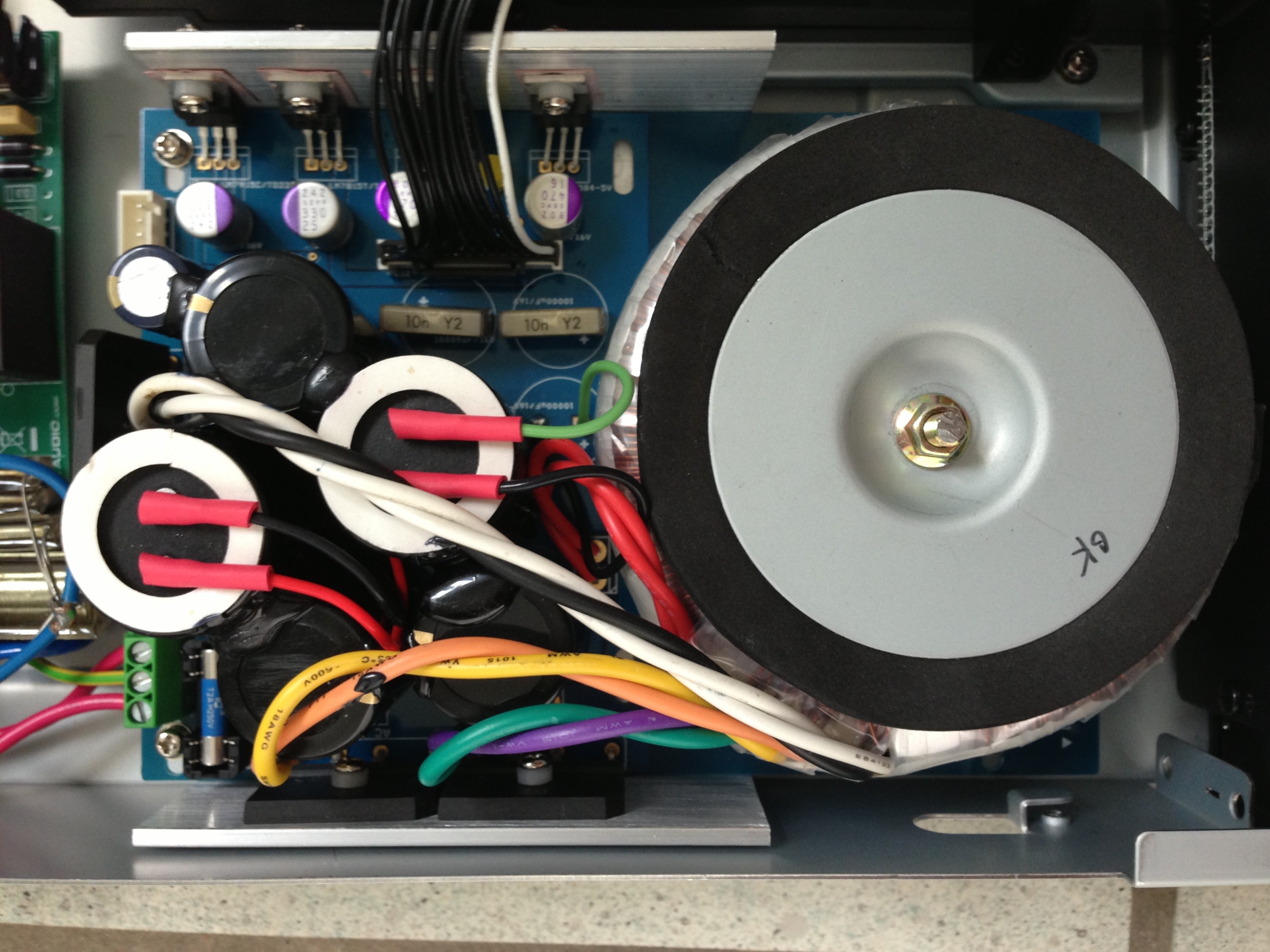

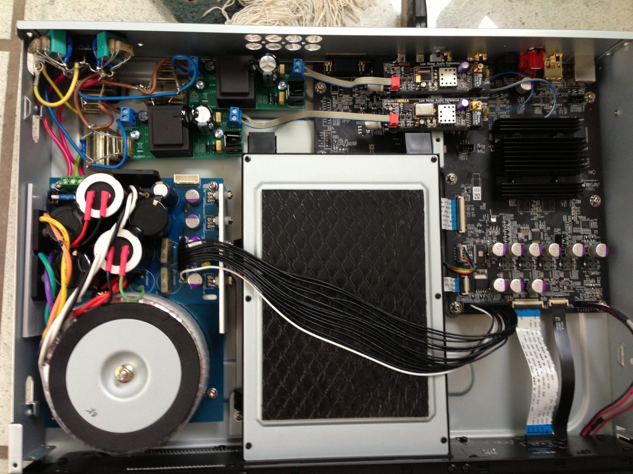

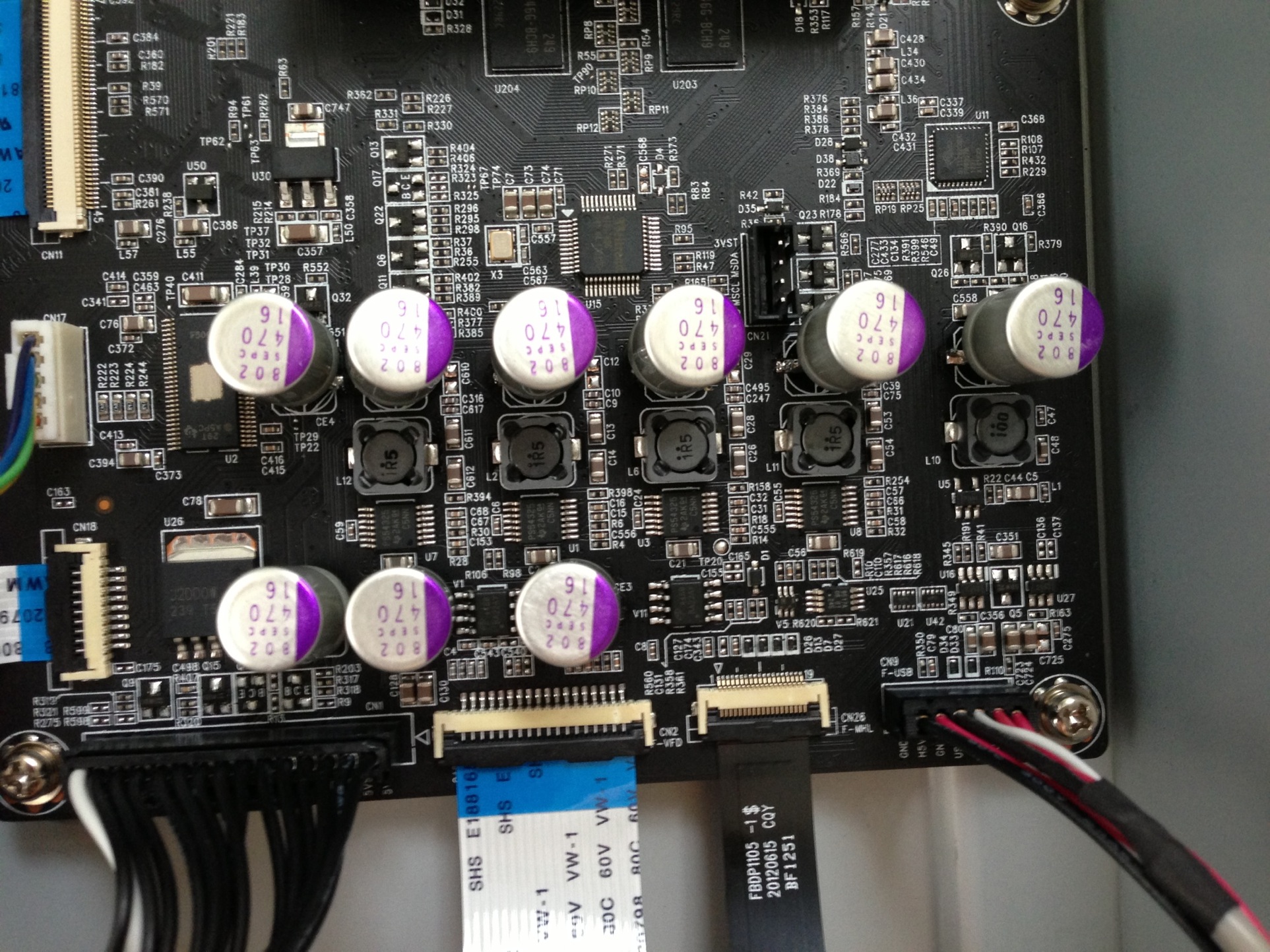

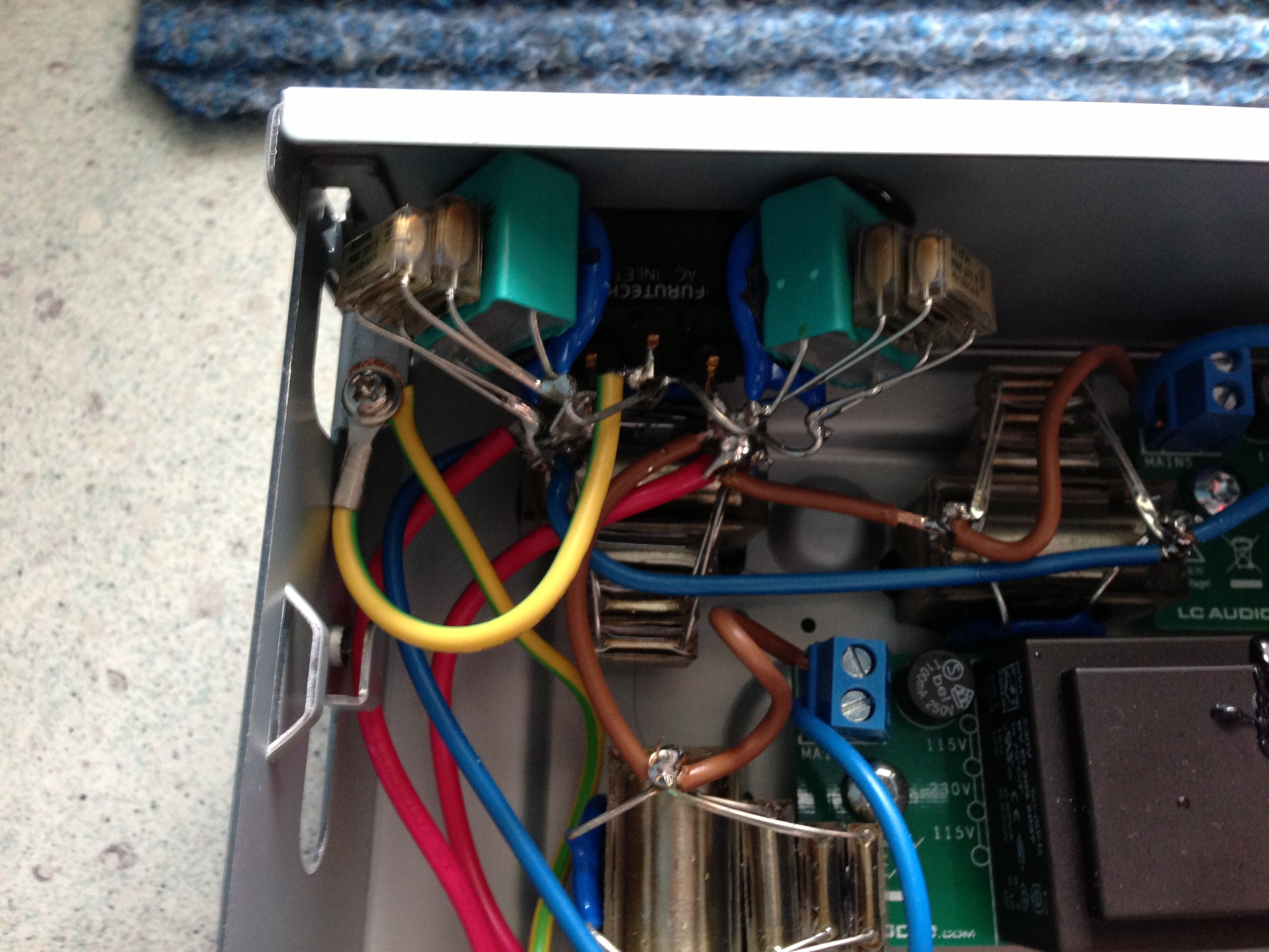

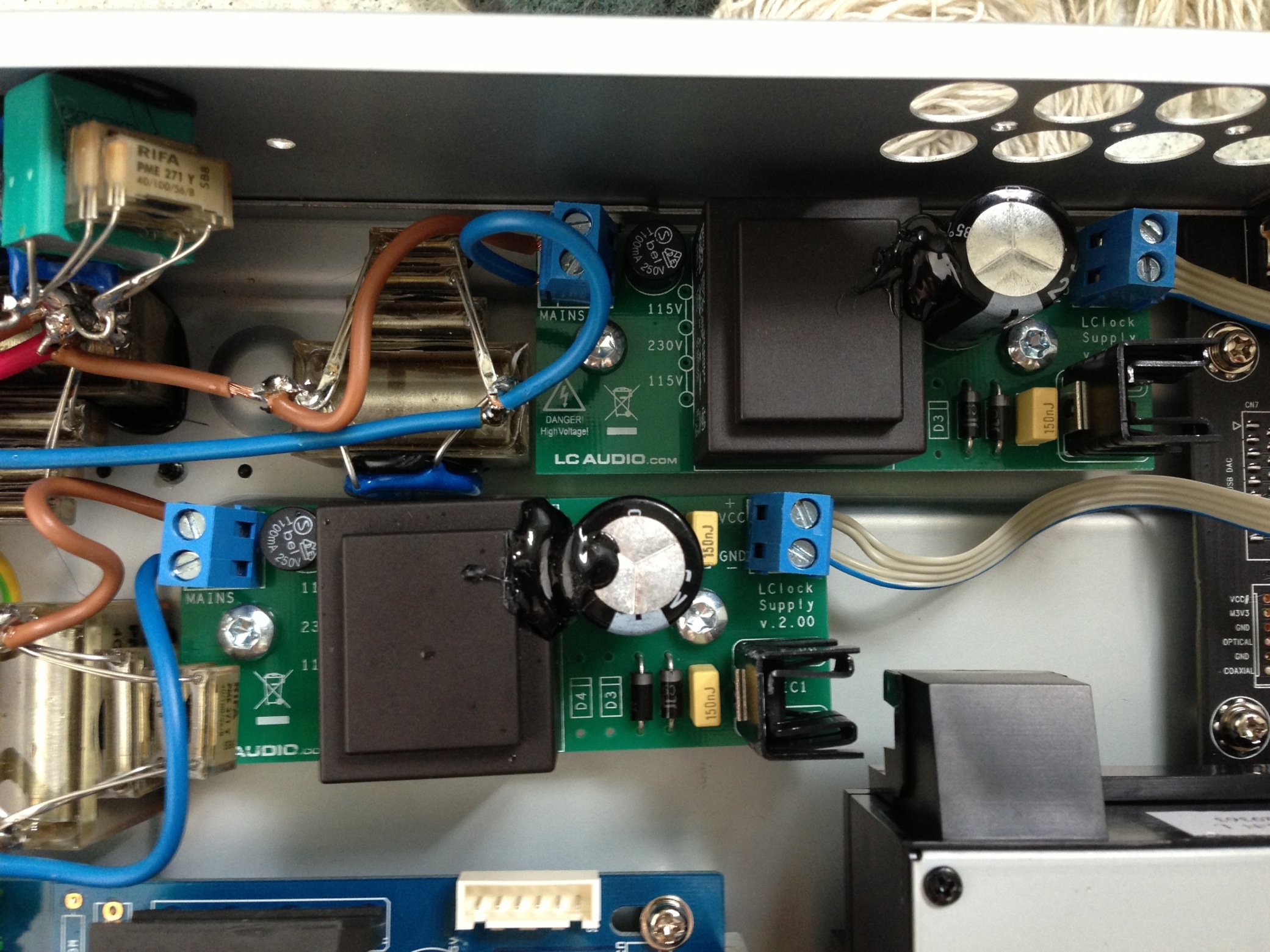

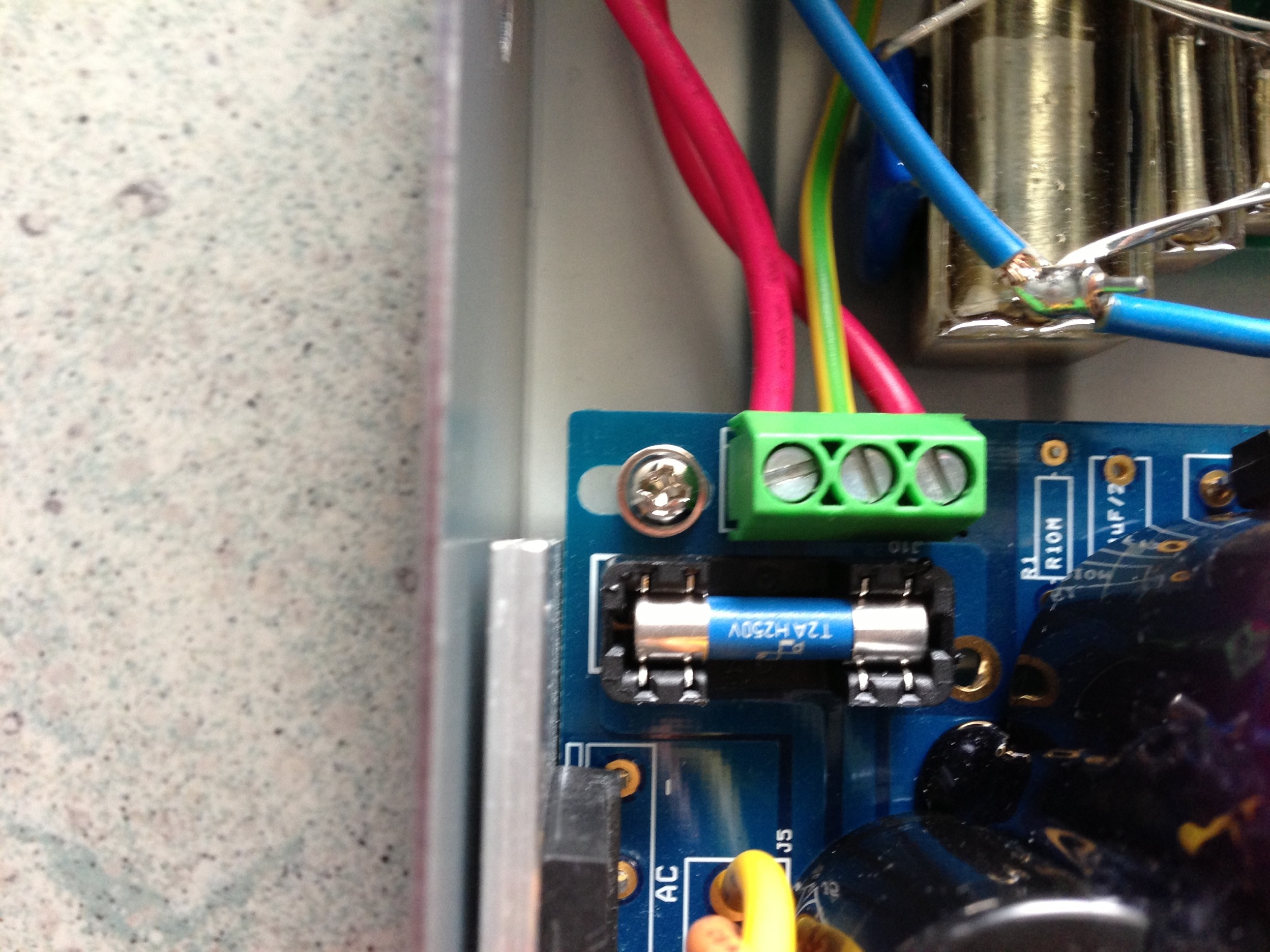

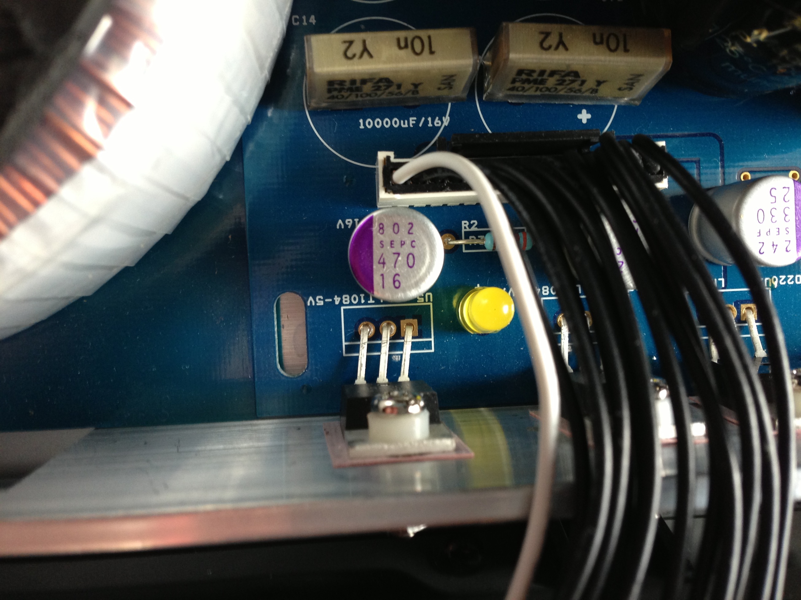

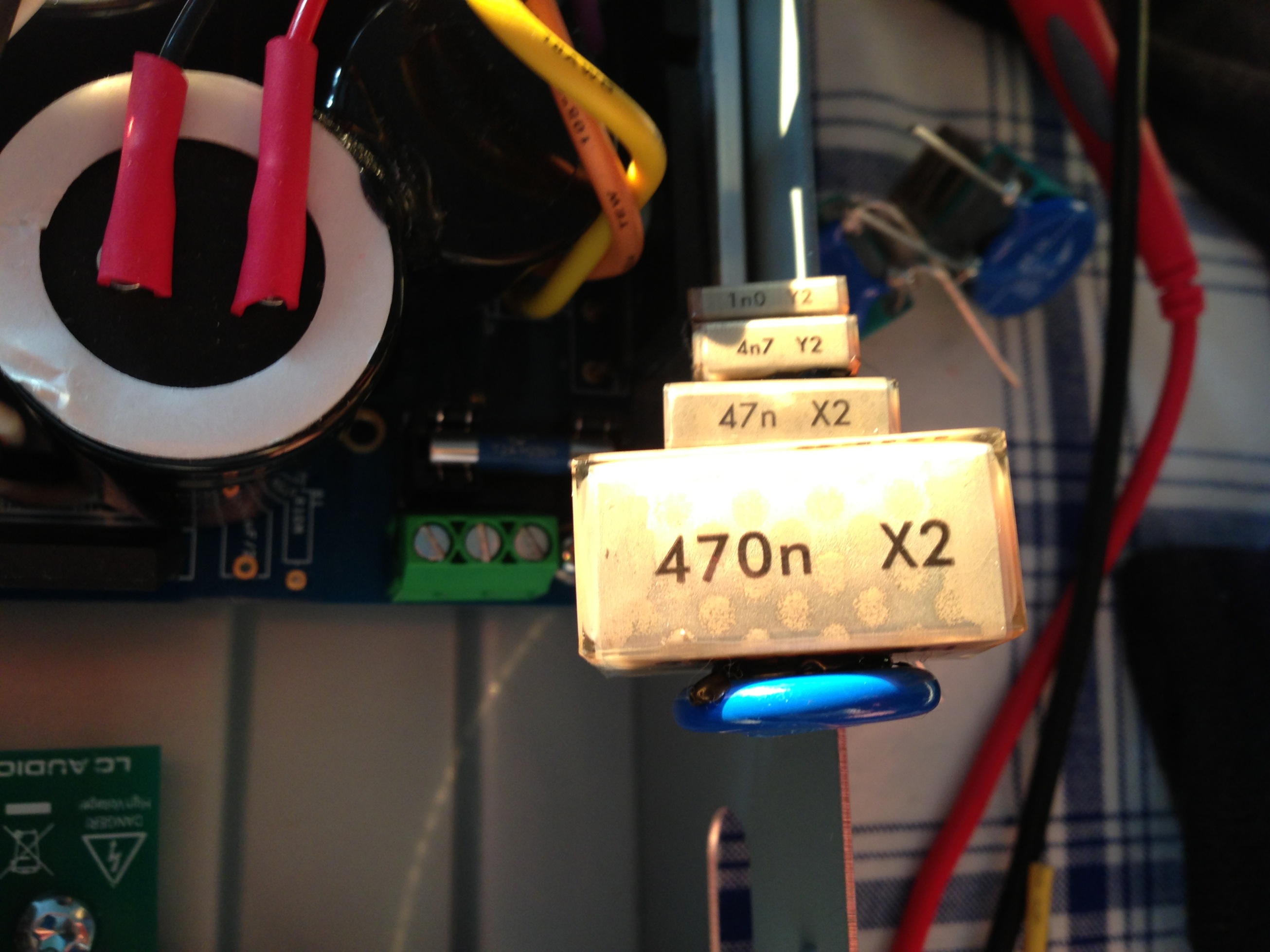

Modding OPPO 103
Hi to all
these are some photos of my modded 103.
I use this player only as a digital transport, the analogue stage was dismout.
- First of all i installed a linear PSU from Jea Hong, but all caps has been changed. I installed 2 20.000müF and 2 33.000müF from Mundorf Lytic, which are quite big and made space problems. Each of them is bypassed with small wima mkp caps. Some small Rifa Pme247 were added.
The small values were changed to oscon SEPC smd with the lowest ESR known to mankind. Use only the 16v version and not more than 470müF.
Then somthing really important, the main fuse. This was changed to Padis Rhodium.

Hi to all
- Next thing was the smd caps on the digital board, all has been changed to the oscon SEPC 16v 470müF.
- Both clocks were changed to NewclassD / Dexas new small size Dclock Neutrino launched in may this year. Both have an own linear PSU. My experience is that the best clock without its own LPSU is nothing.
- Every PSU has its own mini power conditioner in kind of a staggered delta filter between line-neutral / line-earth and neutral-earth.
