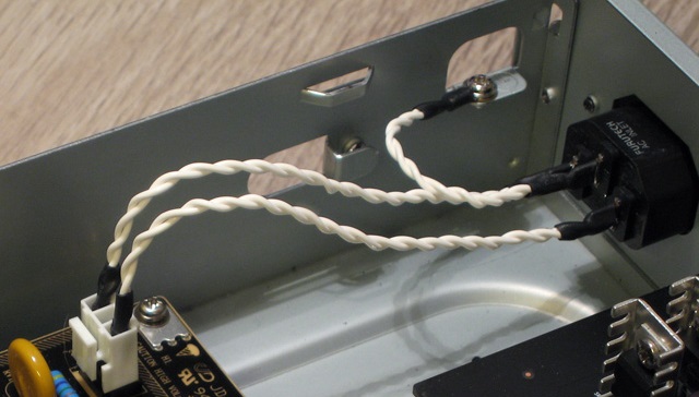

I might like to try bypassing the IEC, or getting a better IEC.
Just be aware of the transformer switching which has Primary windings in either parallel (115V) or series (230V) - the SMPS board can handle both 115V and 230V (and everything in between), but don't overlook the transformer.

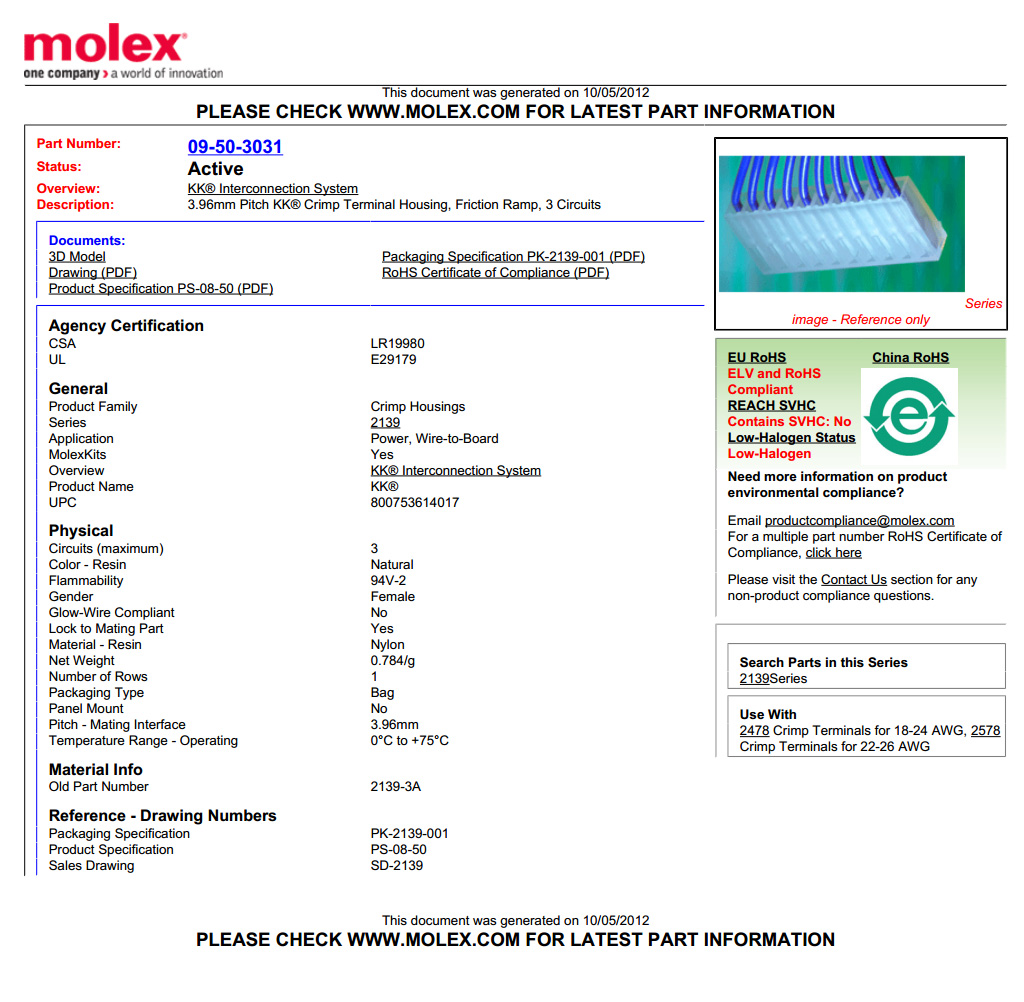

Not looking to do anything fancy here. Can you identify the connector that connects to the board?
Len
I wonder whether some one can identify the plastic connector that carries the power directly from the IEC to the circuit board. I might like to try bypassing the IEC, or getting a better IEC.
Thanks,
Len
I`m not very sure what you refer to about IEC... It seems to me that you think about the power in (from outlet) stage.
From my part, I will recommend to everybody to do not touch this power in (to switching PSU) stage of the player. There is not any improvements to be done in this area. Main power input and AC filtering is definitely not something one may work around on this device. The important improvements come from special care in better filtering and noise removing from the DC power resulting from player`s switching PSU (+5v), and from the analogue PSU.
