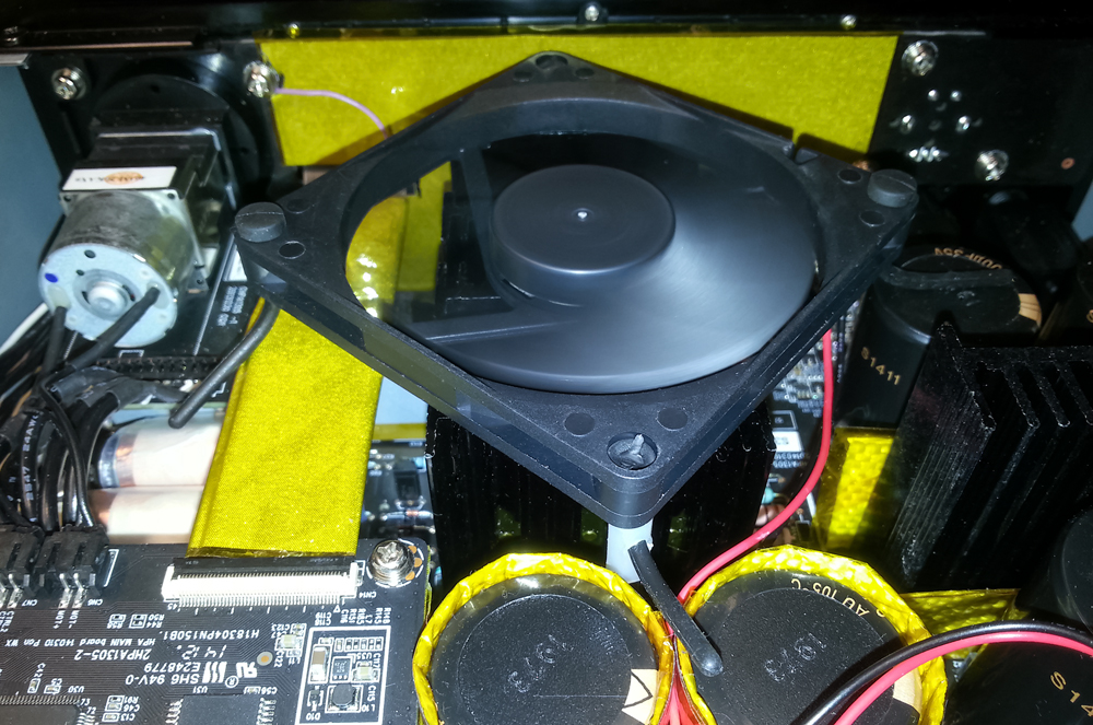

I got today the ordered fan, to experiment a forced ventilation for HA-1. And done it!
The result: a dramatic decreasing in temperature level for the whole device.
As I predicted, only a very little increasing of the air flow (more than the natural one) inside the enclosure, it lower the device temperature with about 20 dg. C.
I had measured before 56 - 58 dg. C on the upper grill, and a 50dg for the whole enclosure. I have now (with the back panel mounted 5 mm far from enclosure), the hottest part (class A power regulators) at 39-40dg, while the rest of the enclosure measure 33 dg. The class A heat sinks measured outside the upper grill, shows 34 dg. The heat sinks of the power regulators for class A amp are outside of the main air stream generated by the fan.
I may say that after the electronic improvements for sound quality, using of a fan inside the enclosure is the next big improvement for functionality of HA-1.
I have to renounce now at the thermal isolations of the caps near the heat sinks. Not necessary at all, at this low level overall temperature. BTW, the room temperature is almost the same as before...
But want about the noise of this fan? Well, in a total quiet room, I can not hear anything at 20 cm far from the upper grill. At 5 cm distance, it is audible a very low noise made by the air turbulences... Quite remarkable!
Some more detail about the fan: I was looking for the thinnest one (80 mm), and without ball bearings. So I have found one on Ebay, for few $. I have determinate the lowest possible power to make it start up and spinning. Using this fan at this very low power, it make no any audible noise at 20 - 30 cm far from it.
The mounting of the fan as is to be seen in the picture is not final. I used silicone dampers, and I may fine tune a little bit more the mounting of it in place. But mainly it will look like in the picture, and it will be placed in the same place.
Quite satisfied about this successful modification...🙂

Forcing the ventilation only a little bit more over the natural way, it have a dramatic impact for the developed temperature inside. If dust it may accumulate inside, then this is quite easy to be removed (blow it out) from time to time.
After more than 6 hours continuous powered on, I had the follow measured (stabilized) temps: Class A heatsinks - 45dg.C, Class A power reg. - 40dg.C, the whole enclosure - 35dg.C. More reasonable than over 50 dg.C as it was before...
If the fan use less than 100mA (my case), then it can be powered from Power ON remote control system of the player (if one do not use this option for the task it was designed). There is there the output with 12v/100mA. The small transformer beside the toroid do the job to provide power to the remote control system.
It will be a mod in this area. I`m waiting now for the produced PCBs.
BTW, I will suggest using of teflon isolated wires to connect the fan to the power, as these wires can come in contact with hot heat sinks, inside the enclosure. Else it have to be routed very carefully.
