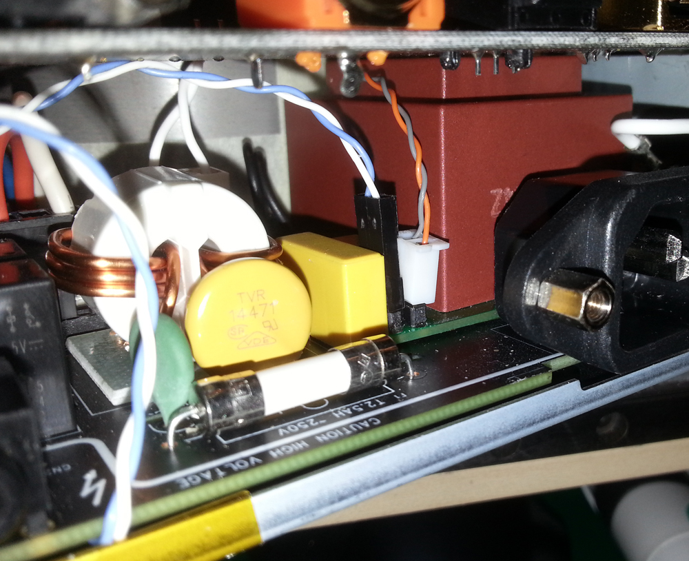

Good to see that you do progresses in your mod work...🙂
As you soldered now the transformers, it may not be very easy to (eventually) send me later your board for the main (and real) mods of the device: replacing the filtering caps, another power system for DAC, battery powered clock system, new configuration for AC coupling caps on inputs, and so on...😉😀
However, one may know that the small transformer inside the HA1, do not have anything to do with the sound out of the device. That is for standby power system, and remote +12v stage...
Hereby is a picture of this modded stage. This transformer it provide now power (in addition to its main standby function), to my installed (inaudible) fan, and for the charger of the clocks board (when the device is off).

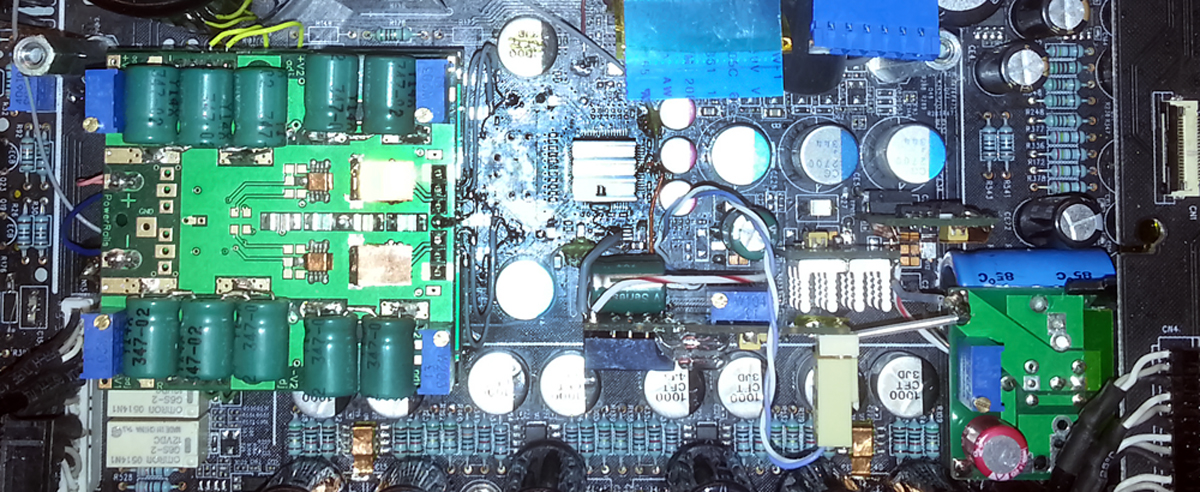

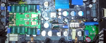

Well, it came the time (for me) to do something with the post DAC signal processing in HA-1.
I just remove it completely the original one. And replaced it with Lundhal transformers (LL1684).
The simplest approach, with the best ever results. Hopefully, these transformers it fit very well into the available space (after removing the filtering caps in the area).
I preferred to remove the opamps to unload the +/- rails regulators, lowering so a little bit more the heat dissipation.
I have to admit that this passive post DAC signal processing is the best way to connect the DAC outputs to the rest of the amplifying chain. In this case the class A amp inside. This approach it fit very well especially to this device, as it is quite critical the heat dissipation inside its enclosure. The only cons to this mod is the price of the transformers, and a lowering of the overall output level with approx 4 dB. Lower level output is very easy to compensate it from the amplifier. I use now the HA-1 in bypass mode. The sound/result is just in another class of quality...
My device it have now the follow mods:
- improved the whole filtering in power system
- all Schottky rectifier diodes
- improved all the inputs AC coupling
- improved the whole DAC power system
- centralised battery powered clock system
- improved ventilation (active/inaudible)
- and the last one: Lundhal transformers for post DAC signal processing
I think I may stop it her...😉😀

Here it is the fully modded DAC stage in HA-1. Both power system for DAC chip and the post DAC signal processing (using my fully differential module).
The advantage of using active circuits for post DAC processing, over a passive stage (transformers) is the better control (fine adjustments) to fit the inter-stages output/input levels.
I will try to make my customised transformers to fit exactly the levels needed for the best performances. Until such project it will be realised, I prefer to use this active stage. The SQ is however excellent, much better than the original design.
